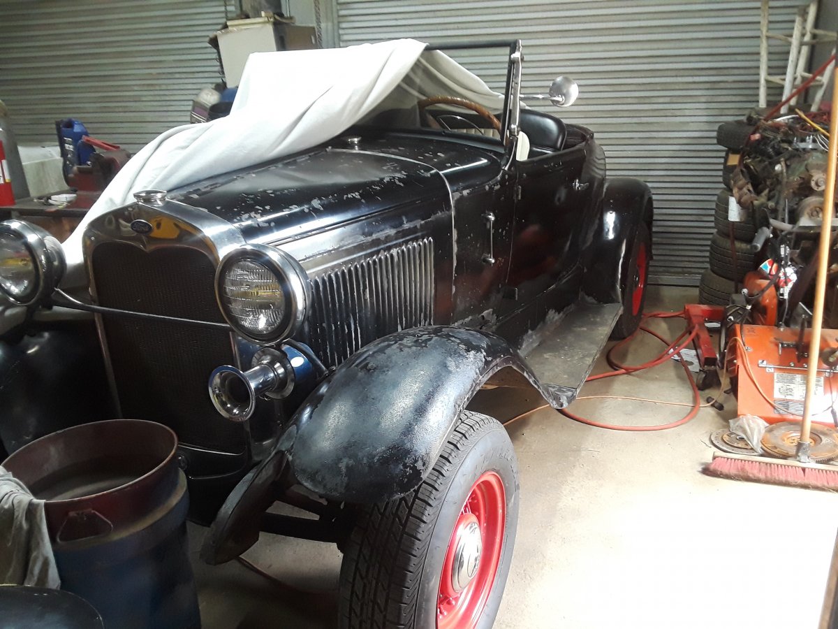

    If that is your Model A, what do you need another frame for? It's got perfect patina, just needs a dropped axle and a de-arched rear spring. What's it got for running gear?

  4. WTF really
    Joined: Jul 9, 2017
    Posts: 1,344
    WTF really
    The running gear is all stock I'm not changing the body at all. I love the look. I want another frame to lowwer and flathead v8 so I can keep enjoying it until I get the new drive train done then just transfer the body over.

    If you want another frame to build while you keep that nice roadster together, don't start with somebody else's junk. Find a nice frame for a few hundred, than pick and chose the individual axles and such that you really want. Buying the pile in the first post isn't going to help you any.
    NEVER trust anybody else's mounts and welds. NEVER. Always look them over carefully for poor penetration and cracks. And chances are somebody else's motor mount is not going to be in the right place for your situation anyway.
    But here's the kicker for the whole scheme: what are you going to do about the ***le? Once you have a new ch***is and engine under that body, none of your numbers will match your ***le paperwork. Insurance won't cover that car. Nobody will really want to buy it if they know the situation. Bad idea.
    If I were in your shoes, I'd buy the axles and brakes and work on them cleaning them up and making any modifications. Then buy whatever engine/trans you want and build it. Then next winter pull the body off and switch the drivetrain out before spring.

    I must be nobody i'd buy that roadster in a heartbeat and wouldn't care in the slightest what frame it had. i'd make it mine and insure it to boot.

    Wow, that's a really nice roadster, very cool old paint! I'd leave that roadster together and collect the parts to put a v8 into it while you enjoy it with the banger. Either use that same frame once you have everything or get another nice bare frame to build a separate V8 ch***is. Vern Tardel's book on how to build a traditional Hotrod will help you lots for what you're wanting to do. Concerning the frame under that 26/27 t body, that is a waste of your time and money and the only value you will get if you buy it is learning how not to do things and that what seemed like a shortcut only cost you time and money. I have setup some Model A frames with V8's and built well over 100 32 ford frames. If you would like any advice or help, just pm me. Just to clarify, don't waste your time with that frame. Happy Hotrodding
