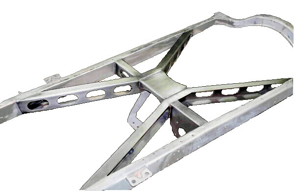

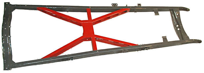

    Did you get the frame from Dagel's? If so, it looks like they sent you a modified FULL FENDER "A" FRAME. It looks like that's the only frame they sell. At $1,600, I'd try a little harder for the refund. If you didn't ask for the cut ins, you didn't get what you wanted. Or you could build a full fender car.
    Here's the price list with a description of what you got. Part #
    [FONT=Trebuchet MS, Arial, Helvetica]DAG-28A<!--mstheme-->[/FONT]​
    http://www.dagelsstreetrods.com/price_sheet.htm
    That's a nice looking cross member, but is it really needed for a Model A? I seem to remember seeing them built with a little less structure underneath. I'm no expert, that's why I'm asking questions. My interest in it would be to put the frame under a '27 roadster. With a kick up, of course.

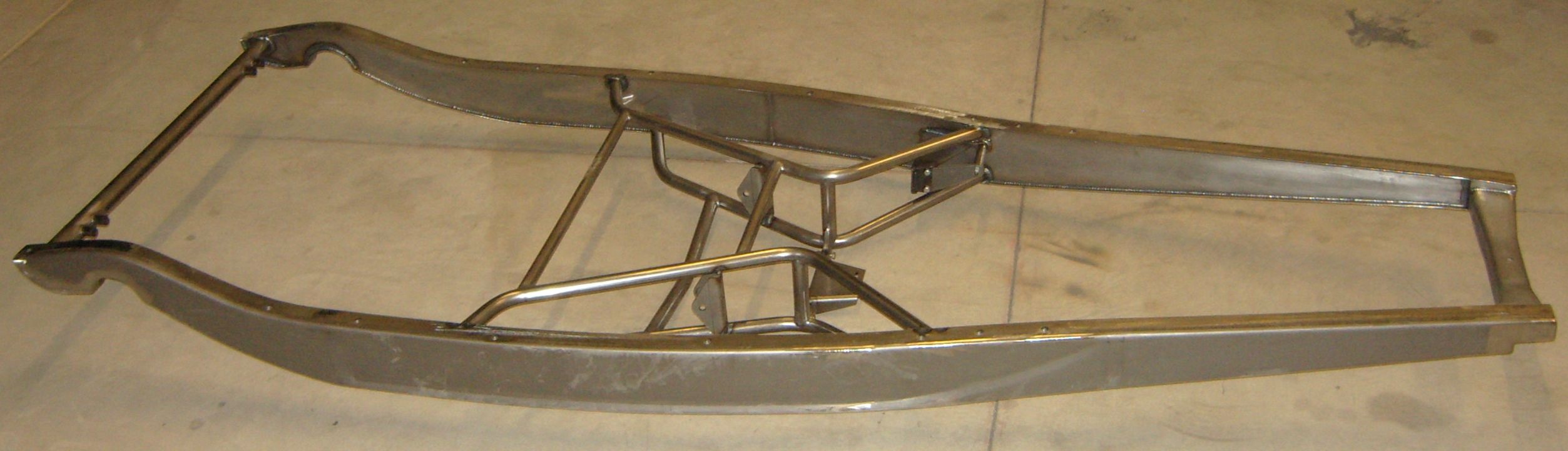

  8. That looks like a cool frame to me !
    Model A rear grafted to a 32 front.
    You might want to put a traditional (tardel style and type) z In the rear to drop you 2-3 inches. Doubt it takes longer than an hour or two.
    The lack of caged nuts would really piss me off
    This one has a 2" step at the rear wheel arch. Can barely see it, certainly not a smack in the face and my wheels aren't 4" further apart than they need to be which personally I think looks like **** when the wheels are 6-8" away from the body.

    metal man is right that Wex got a deuce style frame, just not a traditional deuce frame. The frame you showed Fred is a Model "A" type "repro" frame for a full fendered car. Quite a different thing altogether. The deuce frame is a more perimeter design that runs closer to the body all the way around, and it is quite a bit deeper through the rails and has a natural kick at the rear and a small "sweep" at the front. They are easily identified by the character line running the length of the rails below the door line.
    To answer you other question about understructure, Hell yes! I wouldn't build a Model "A" type frame (or really any other for that matter) without an "X" member. It makes a HUGE difference in the car's road manners, general stiffness, body fit and suspension compliance. The Model "A" was the last car that Ford really built to be flexible and use the frame itself to function as part of the suspension. Putting an "A" together with minimal cross members is a mistake in my book. I even go a bit further than most in that when I work from an original "A" frame these days, I prefer a substantial "X" to boxing the frame. A properly designed "X" does the same thing as boxing by providing beam strength, while also providing support to the rail's vertical strength in areas like the running board mounts. Kills the twist big time too!

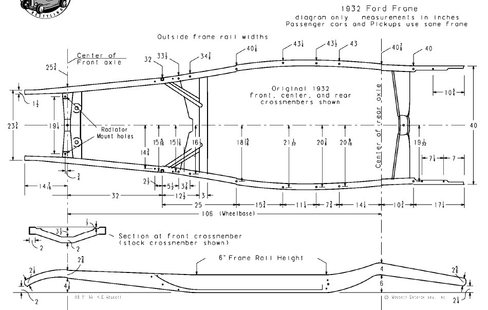

  21. I really don't see an issue with wexs frame, it will not make a ****py hot rod.
    Here's an original 32 frame.
    Pinched in the rear for an A and flat in the rear to avoid the sub rails .
    The drop will come from the arched rear crossmember.
  22. When you look at this one , it has the rear bump up, a c notch and a flat crossmember. This requires the subrail modifications .
    However if you'd measure from the spring mount to the ground on this and from the spring mount to the ground on wex's I'd bet there is little difference, some but little.
  23. Go ahead and print this out then draw wex's frame modification to the rear super imposed over it. Don't forget to put the rear crossmember in.
  24. Now the other issues, and no cage bolts
    Well that's another story and needs to be addressed by the builder.
    As Far as all the other stuff ,,,, well it's just another way to do it.
    If You want a smooth rolling floor, you need the subrails to follow the 32 curves.
    If You want a flat floor with a bump and flat sun rails like every model a had, you need a flat frame with an arched rear crossmember.
    If you want your tires up tight and tucked a little bit, you need the step in.
    If you want your tires out wide and 6 " out from the body , you need the stock 32 rear style.
    It's all in what you want and how you want to get there.
    Mock it up, make a plywood wheel and take a step back and look.

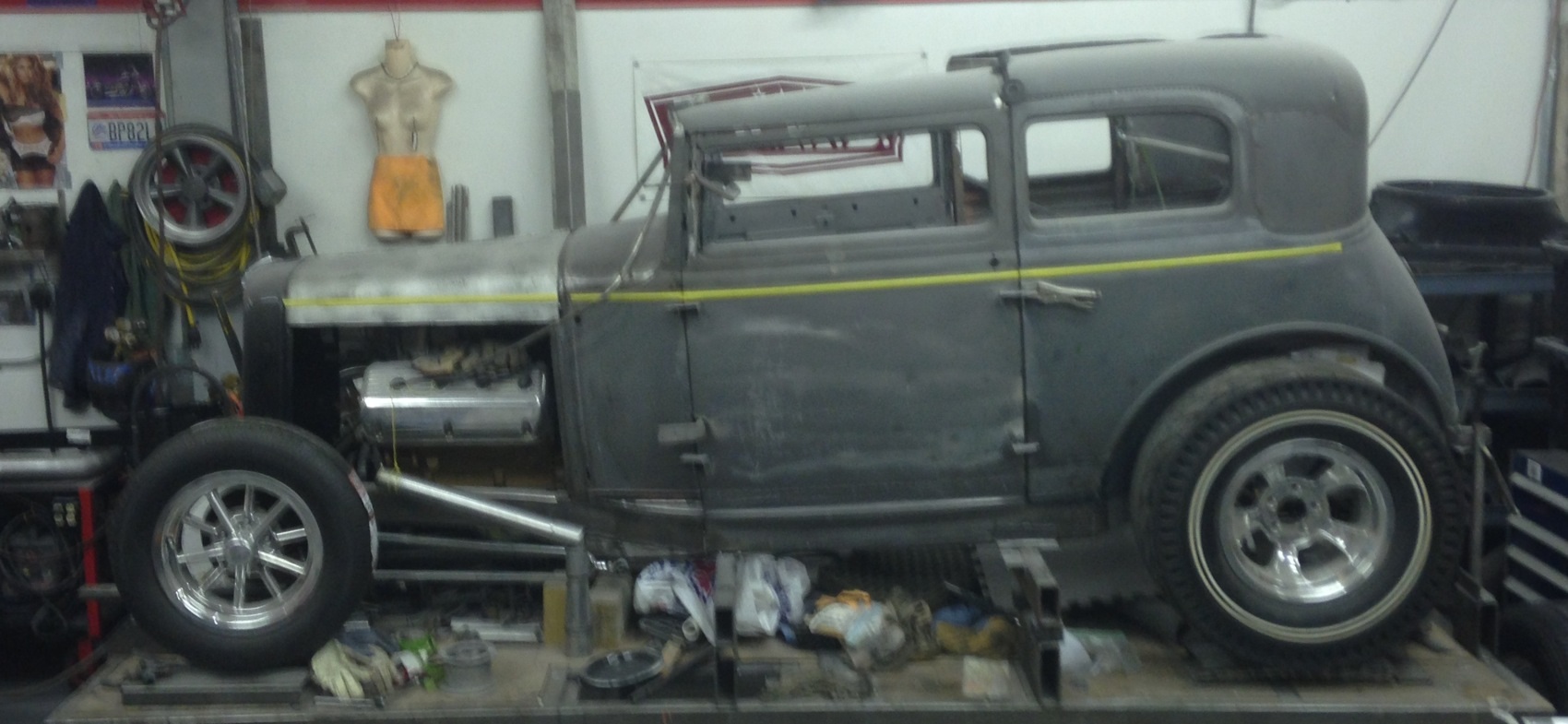

  26. Apparently I can only post 1 pic per post
    So bear with me

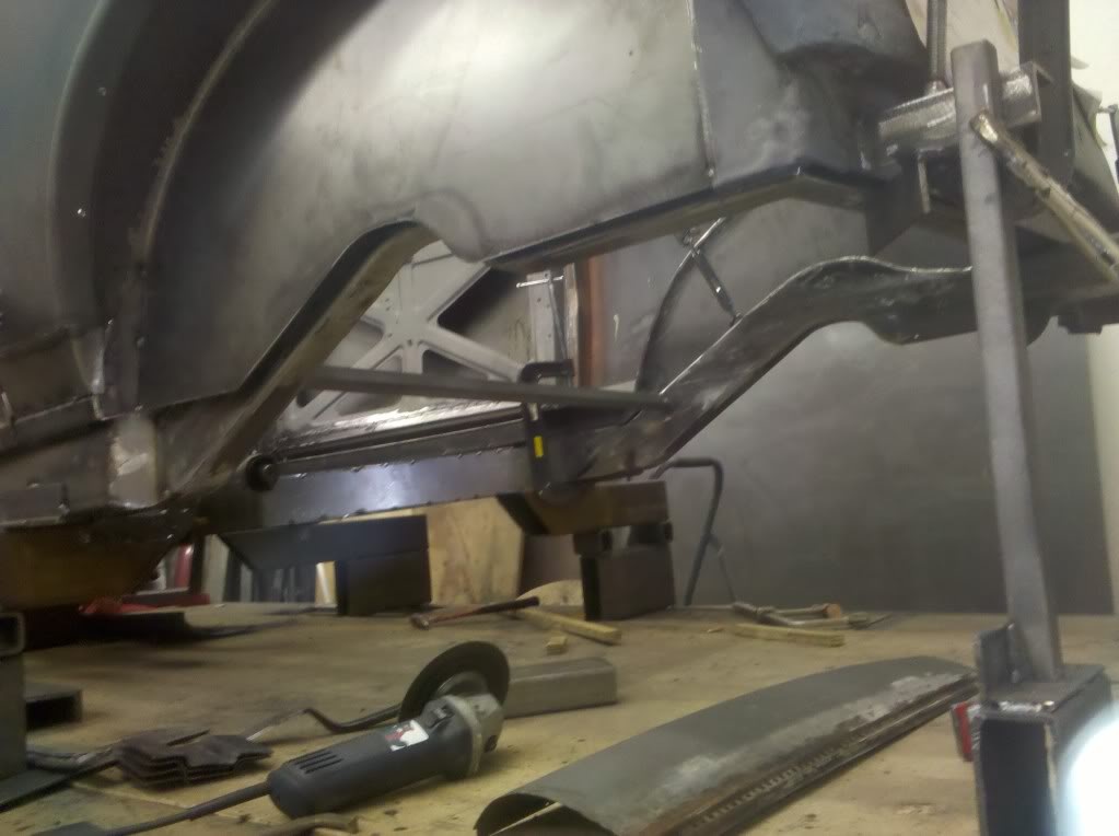

    Here's a better detail of the step on mine.

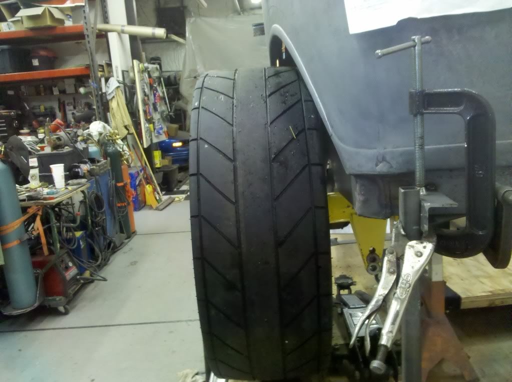

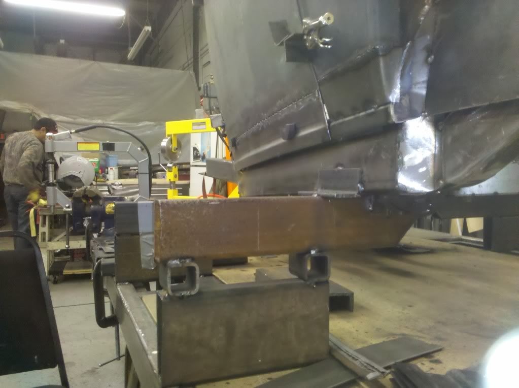

  27. Here's the step.
    And you can see I made the wheel wells and inners deeper to accept the tire and let it in just enough, to make me happy.

  30. All of that to get the tire to sit like this.
    There was no way in hell I was going to have a huge gap from the body to tire.
