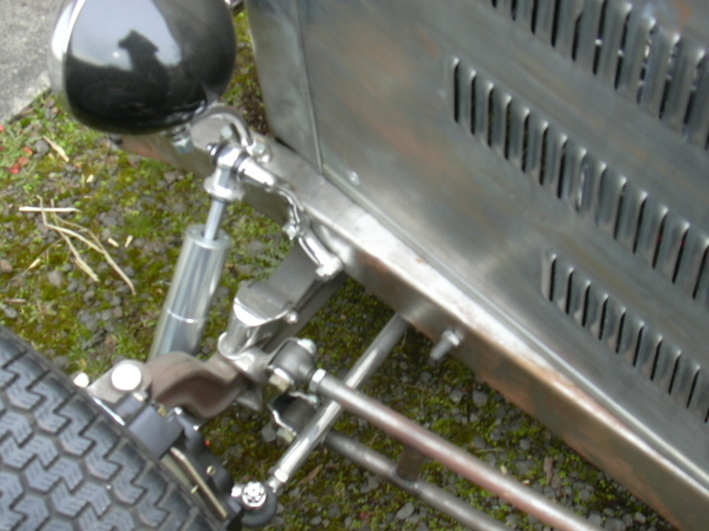

    I am tired of loose teeth after a short cruise in my 32 coupe with flatty 8. The car has stock suspension and examination of the front tube shocks someone years ago installed, are Monroe Sensi Trac AM10028BTO and googles "made to replace air leveling rear shocks". Said to be a gas shock. My buddy thinks these look exactly what Speedway sells. Aside from the terrible choice to use a "rear leveling shock," Bishop/Tardel Ford Hot Rod says to stay away from gas-charged units as they are much too stiff for a light car. Use a conventional tube shock. The tech sheet on mine show 9.75" and 14.75" extended. Anyone have a favorite?

    At rest, the exposed shaft is 2 3/8". The installed height of the shock is 11.75". These look exactly like the gas shock and mounts speedway sells for common ford axle style so the specs are about correct for travel. Collasped 9.75 and extended @ 14.75.

    1 lowr shock bracket loose. Both shocks are not "smooth" when collasped. Stick in the collasped position and eventially extend. (Gas must still be there) Will be getting new P&J ordered after a short drive.
