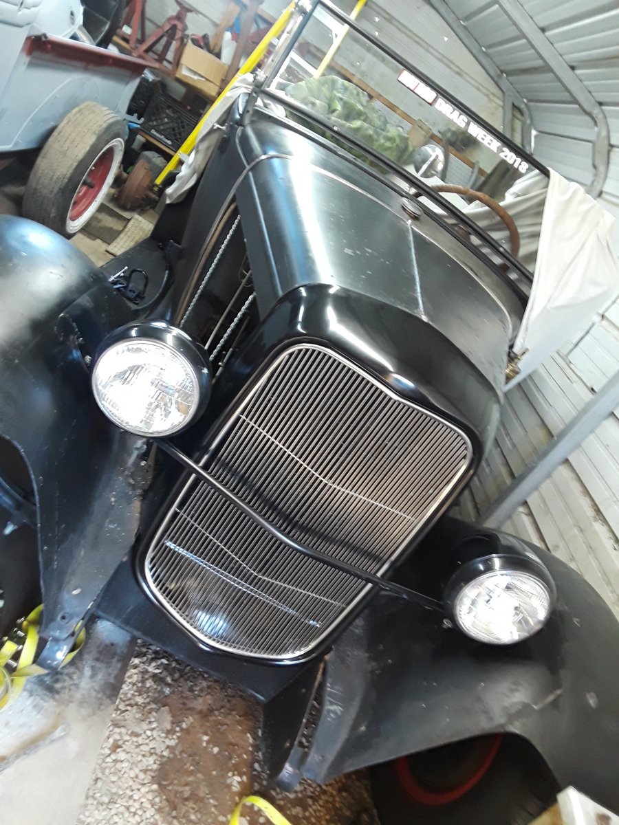

    Just did it today. Got this shell right here on the H.A.M.B. mine is a 30 roadster. 20200229_161738.jpg 20200229_161724.jpg 20200229_161717.jpg
  9. The filer neck on the stock '30 radiator is further back and it will have to be moved. An alternative is to relocate the filler neck under the hood and remove the one on the top of the Model A radiator. Once the cap is under the hood you can use a pressure cap, 4 psi is you have a stock Model A radiator. Now you can either used a filled '32 grill or attach a dummy cap and bezel to a stock '32 shell (that is what I did on my AVATAR). You will also have to modify the attachment for the hinge. The stock Model A uses a rod and the stock '32 uses a formed sheet metal piece.
