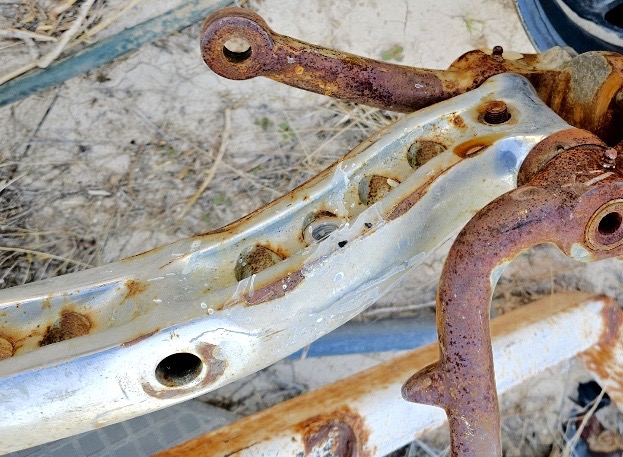

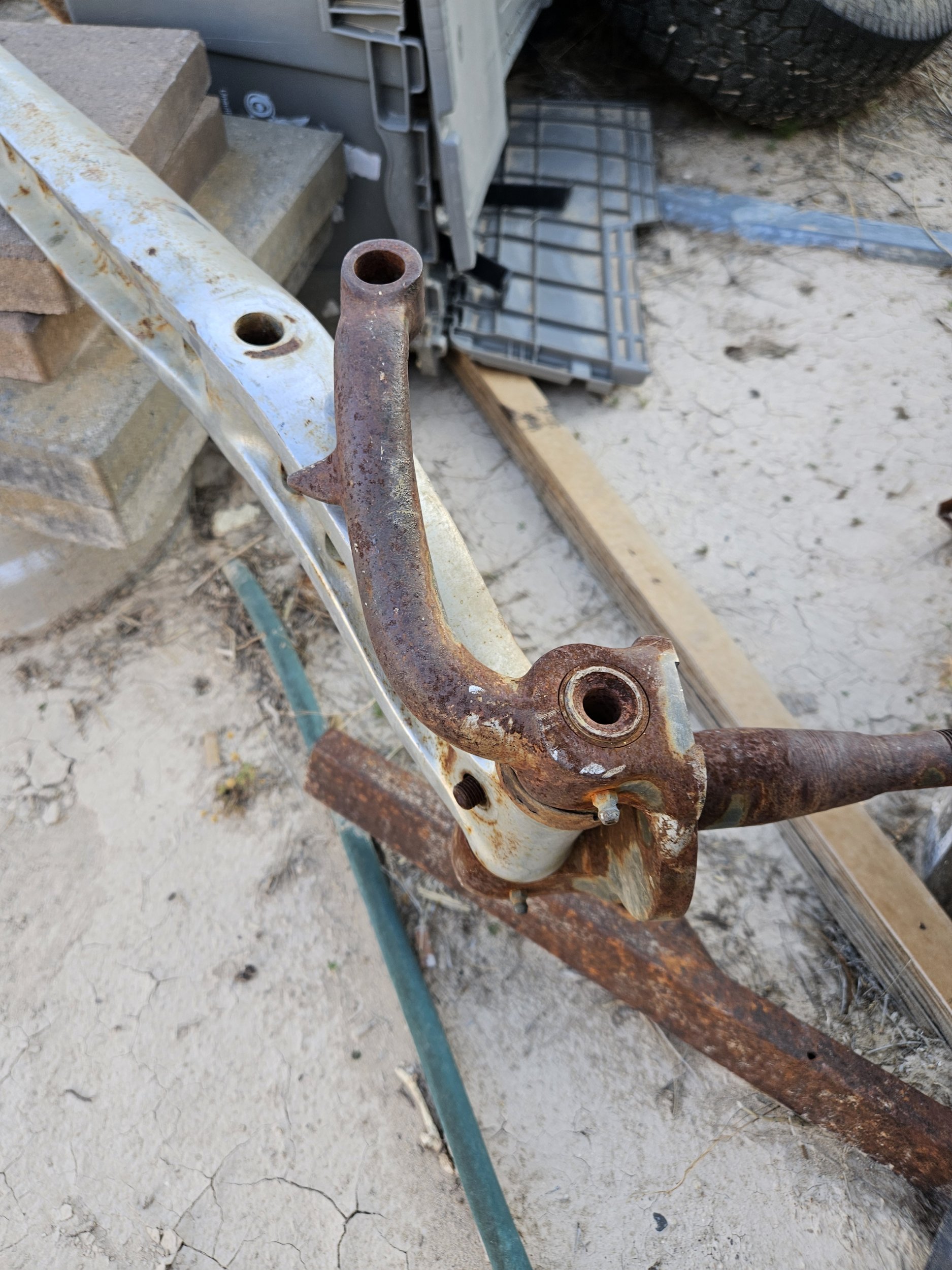

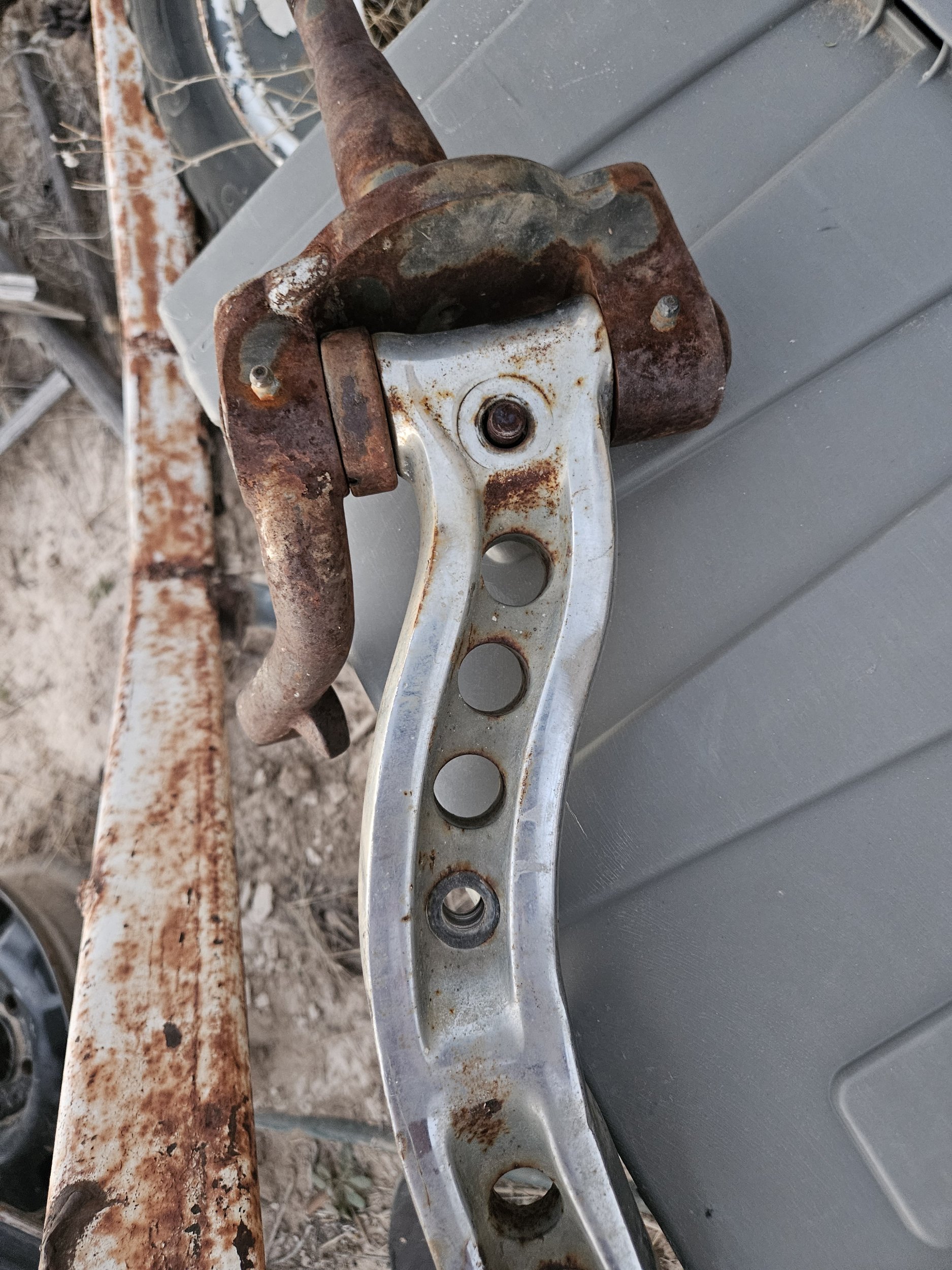

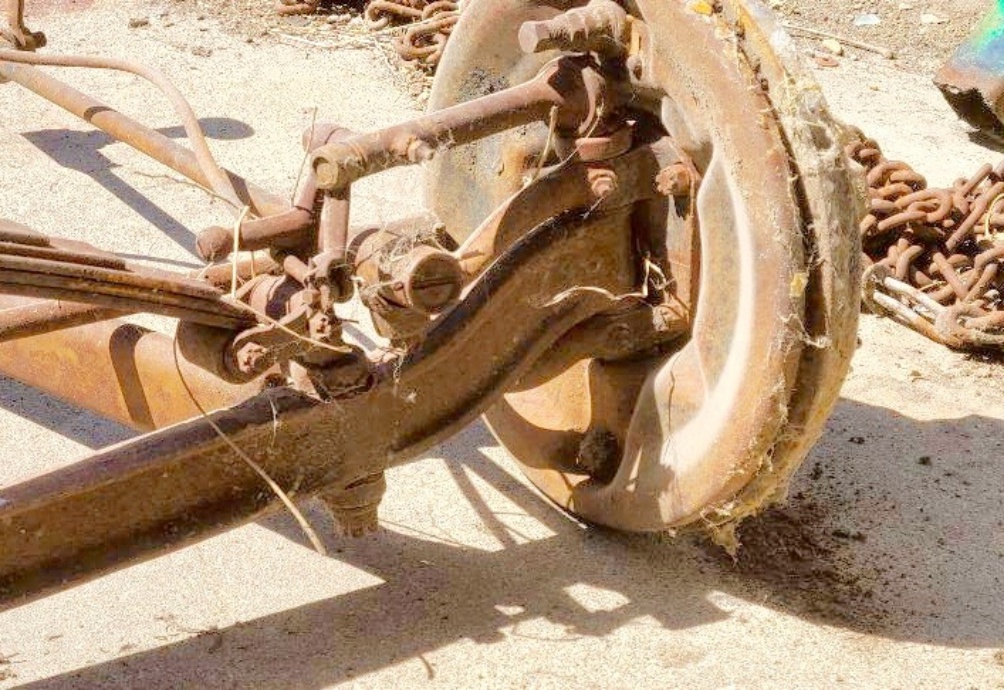

  1. Here's another axle I picked up guy p***ed away had a bunch of junk in his backyard
    Yes I know the spindles have been ground down for where the backing plate goes..
  2. Distance from the kingpin hole to the wishbone hole looks just a little to long to be a 1932 axle . Really need a "flat"photo to see properly.

    alchemy
    No, looks like a 33-36 axle to me.

    I think it's later than a 1932. HRP

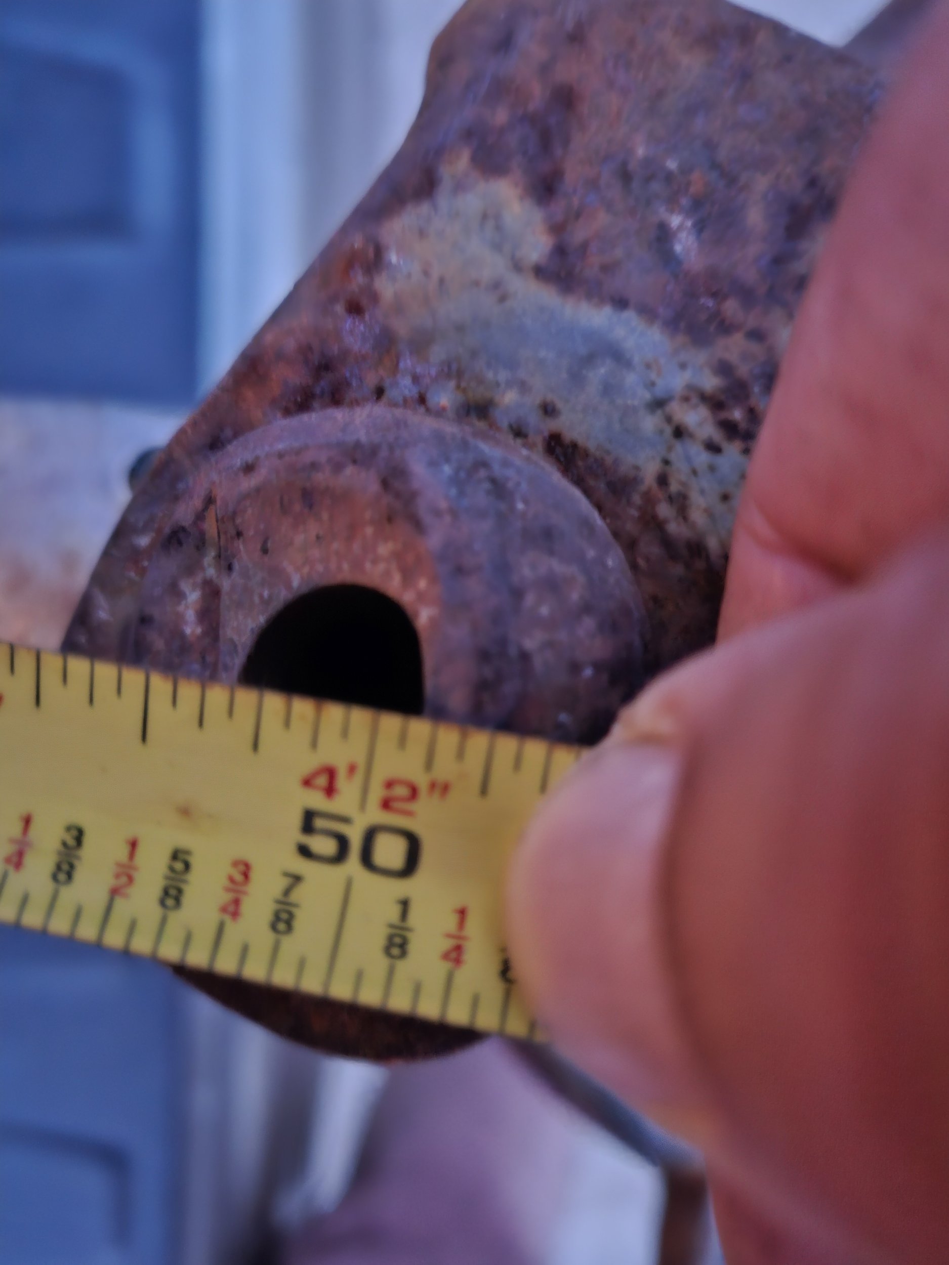

    Two inch spring perch?

    Deuce Lover
    alchemy nailed it right

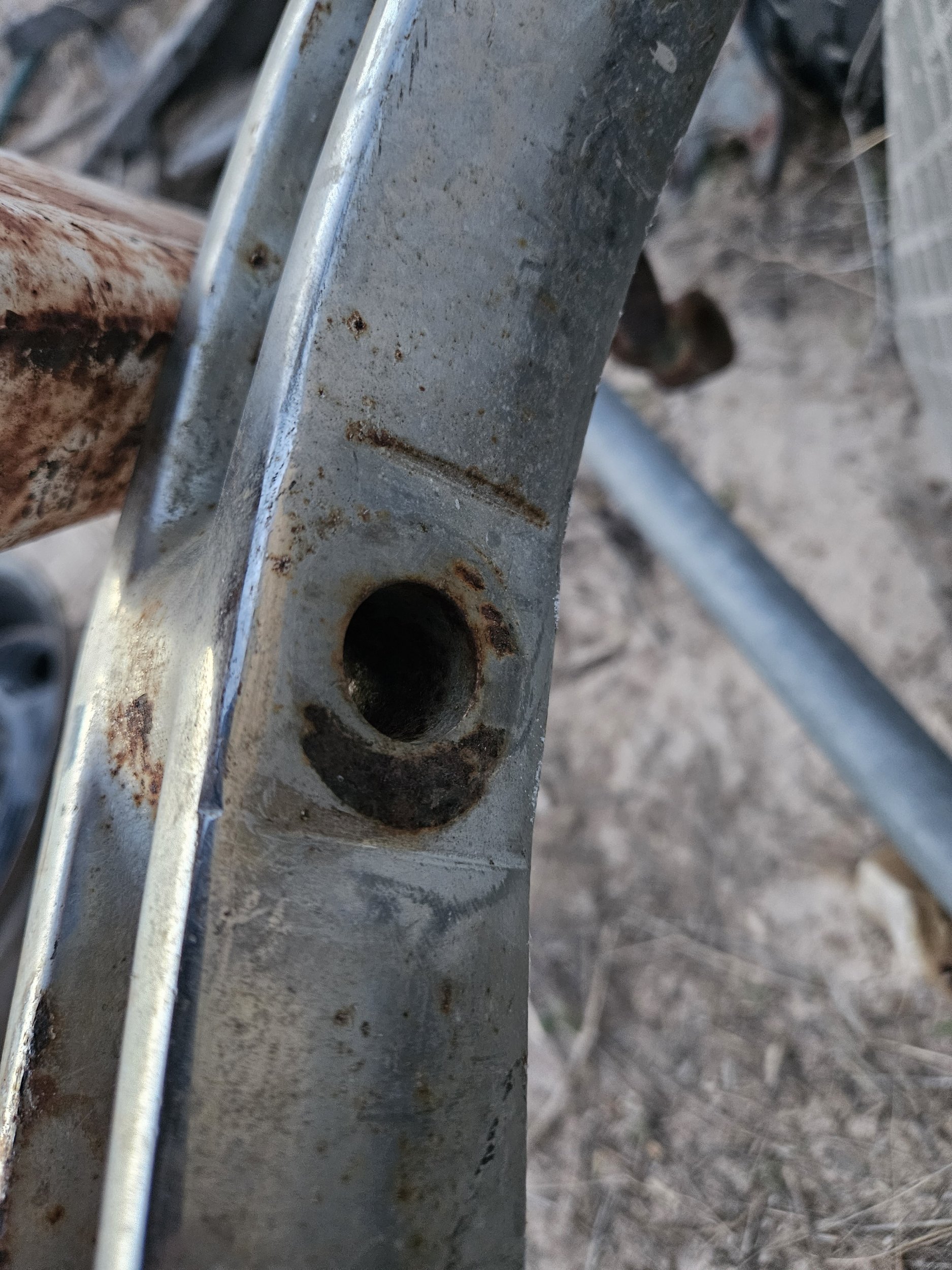

    I think it is a 32 axle. The reason is the radius rod pad looks a little sunken. Only 32 axles were that way. The I feature on the side is blurred but I think that is from chroming prep. I hope I am right as it is an interesting piece.

  10. The whole face looks flattened, real wide edge not thin like regular.

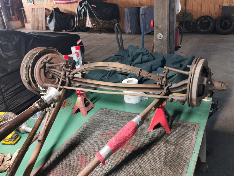

    Here is my 32` front axle.
    Regards Harald

    Hard to tell from the angle the pictures are taken at. Spindle appears to be 1932-34. To differentiate 1932 from 1933-36 axles, need to only glance at two areas - the 32 axle is recessed where the wishbone is attached and the axle from the wishbone mount to the spindle has a compound curvature to it. 1932 Ford Axle #1.jpg 1932 Ford Axle.jpg

  16. I am going to have to look at this better.. I thought I had pic on phone to look at shape from wish bone to spindle.
    LOU WELLS and Fordors like this.
  17. This is a interesting piece
    Looks S to me going to spindle
    Recessed perch mounts
    But why is there taper in center going to.perch
  18. alchemy
    Joined: Sep 27, 2002
    Posts: 22,831
    alchemy
    Cause it’s just a 33-36 axle.
