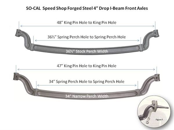

    Forgetting the price – do you want pretty (SO-CAL $250) or original looking rough cast ($600 up). The choice is yours, either way looks good to me and most others. Both will do the job.

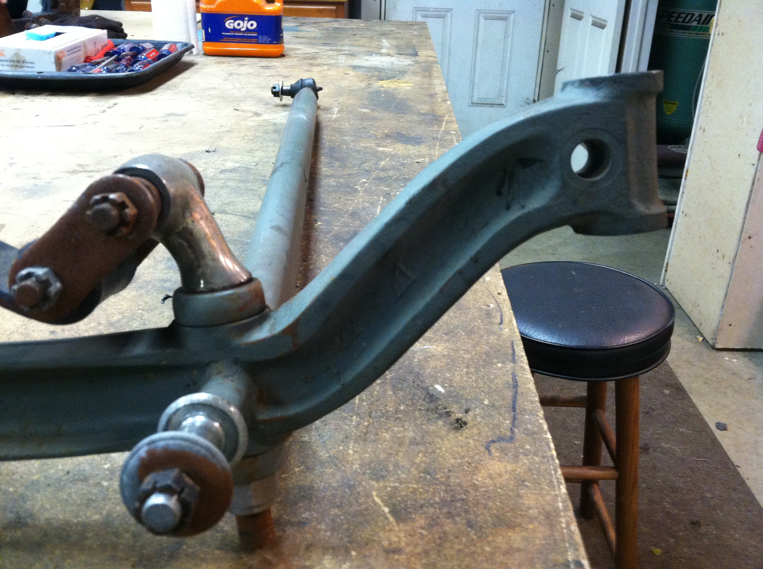

    Just a picture of the 32 heavy resting in my shop. I was thinking of putting it on my A but I want it to look stock so I don't want chrome or the slots.

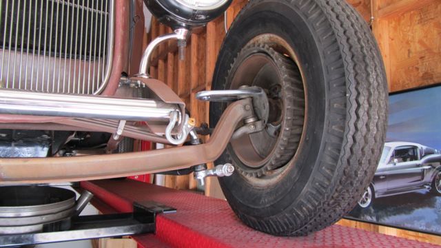

    My 3' dropped Model A by Anson after a summers worth of abuse. Time to paint it, lol. axle1.JPG axle2.JPG
