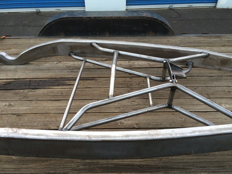

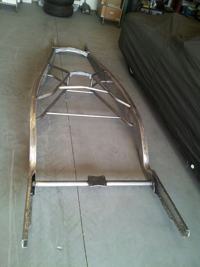

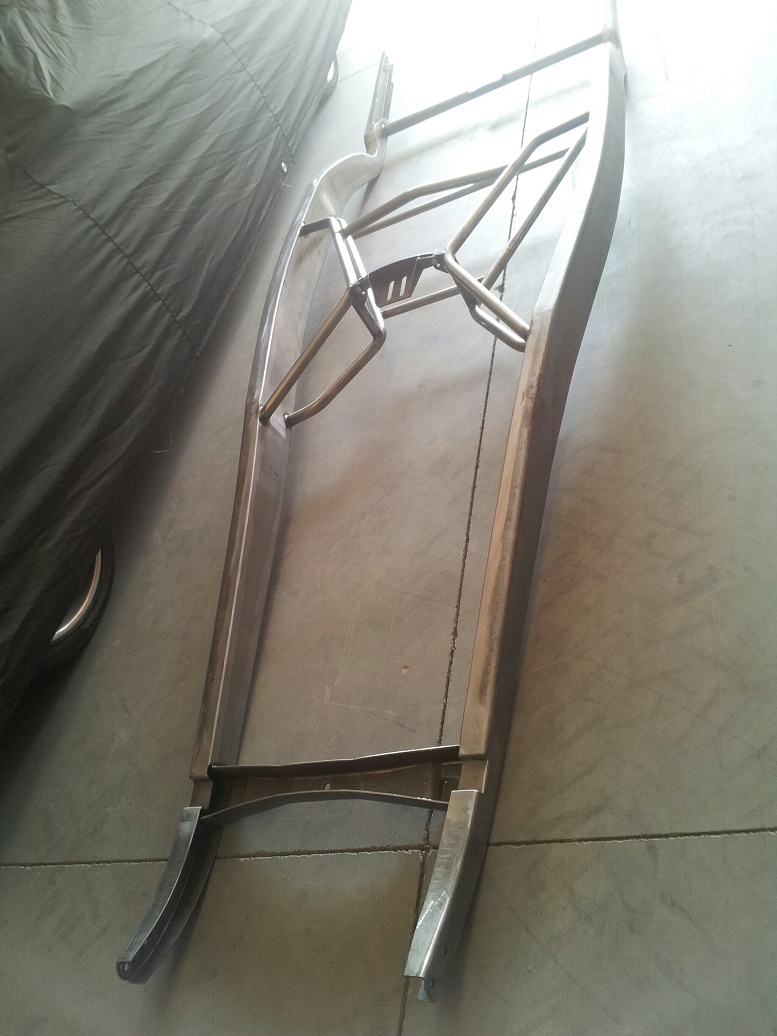

    It has begun. I have finally ordered my 32 frame from Duane Jones in Bakersfield. Duane just informed me today that the frame is ready. I called him to order it last Friday and sent the check on Sat morning. We had a conversation prior to discuss details on the frame and what my requirements were. I selected Duane to build the frame not only for the incredible price but many comments I have read here and other sources giving him huge compliments.
    Saturday, I am going to pick up a 270 Hemi that I bought from a friend locally. It will need a complete build but has a ready to install crank, a new dual carb intake, a new finned valley tray, two Stromberg 97 carb's and some other pieces.
    Here are some photos of the frame that Duane sent me today. I will not take delivery for a few weeks. Duane completed this much faster than I expected and I am not quite ready for the frame yet.

    I have had roadsters for 45 years. They are prone to "cowl shake". That tubing center assembly will not transfer diagonal loads from side to side. You really need a Chassis Engineering real center X crossmember. I can park my roadster in a ditch diagonally and the doors open and close like the car is on level ground. That tubing crossmember is for closed cars where the body can stiffen the frame.
    You can not believe how much nicer the cars feel with a stiff frame under them.

    I took a stock 32 frame and did a torsion test on it. Almost no stiffness. I put in a CR style real X member with a torque box center. It was at least 30 times stiffer. I really could not accurately measure the deflection. I boxed the front and rear sections and ran the test again. No difference in stiffness. All my friends who have built 32 frames used my take on the CR crossmember. They are really stiff. You have to tie the rails together so the loads will transfer diagonally. This requires members with bending strength.
    I would love to hear the results of someone torsionally loading a frame with the tubing crossmember. I am very willing to be wrong.
    I put about 800 foot lbs on the frame and got less than a 1/16" deflection at the front frame horn.

    With that said, I will tell you that I do not plan on driving my Roadster through any ditches diagonally :D. The set up as shown was in my budget. It is a very nice piece for the price. I understand that it is not necessarily the best option for a Roadster but I am sure it will work well for my use. I also plan on running a rubber mounted mid plate at the bell housing which will help with rail flex.

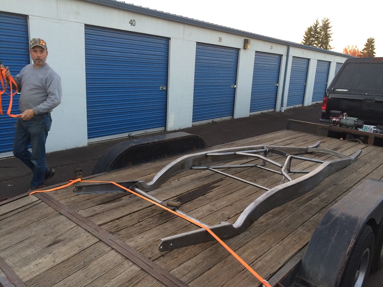

    It is finally here. I have waited a while for this day and it finally is here. I picked up the 32 Roadster frame today. This is the work of Mr Duane Jones of Bakersfield, CA. It is going to be a slow process but one I will enjoy every minute of.
    In case I never say it or forget to mention. I appreciate the comments and suggestions along the way. I do appreciate the experience that some of you have with these hot rods.
