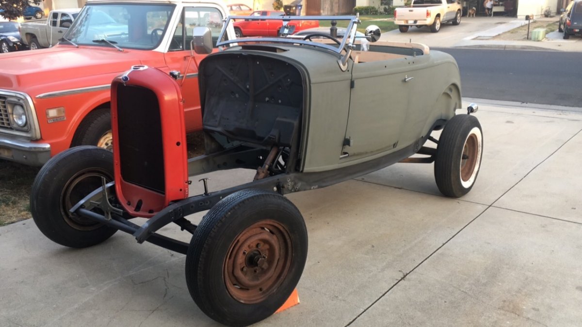

    Nice clean slate, Was that a dustless blaster or just dry media?
  2. ericjustus
    Joined: Oct 8, 2014
    Posts: 262
    ericjustus
    from Chino, CA
    Dustless blasting
  3. She looks solid for being 85 years old.....I like it.
  4. Montana1
    Joined: Jan 1, 2015
    Posts: 2,123
    Montana1
    Very nice build. You must have some really good neighbors... :D

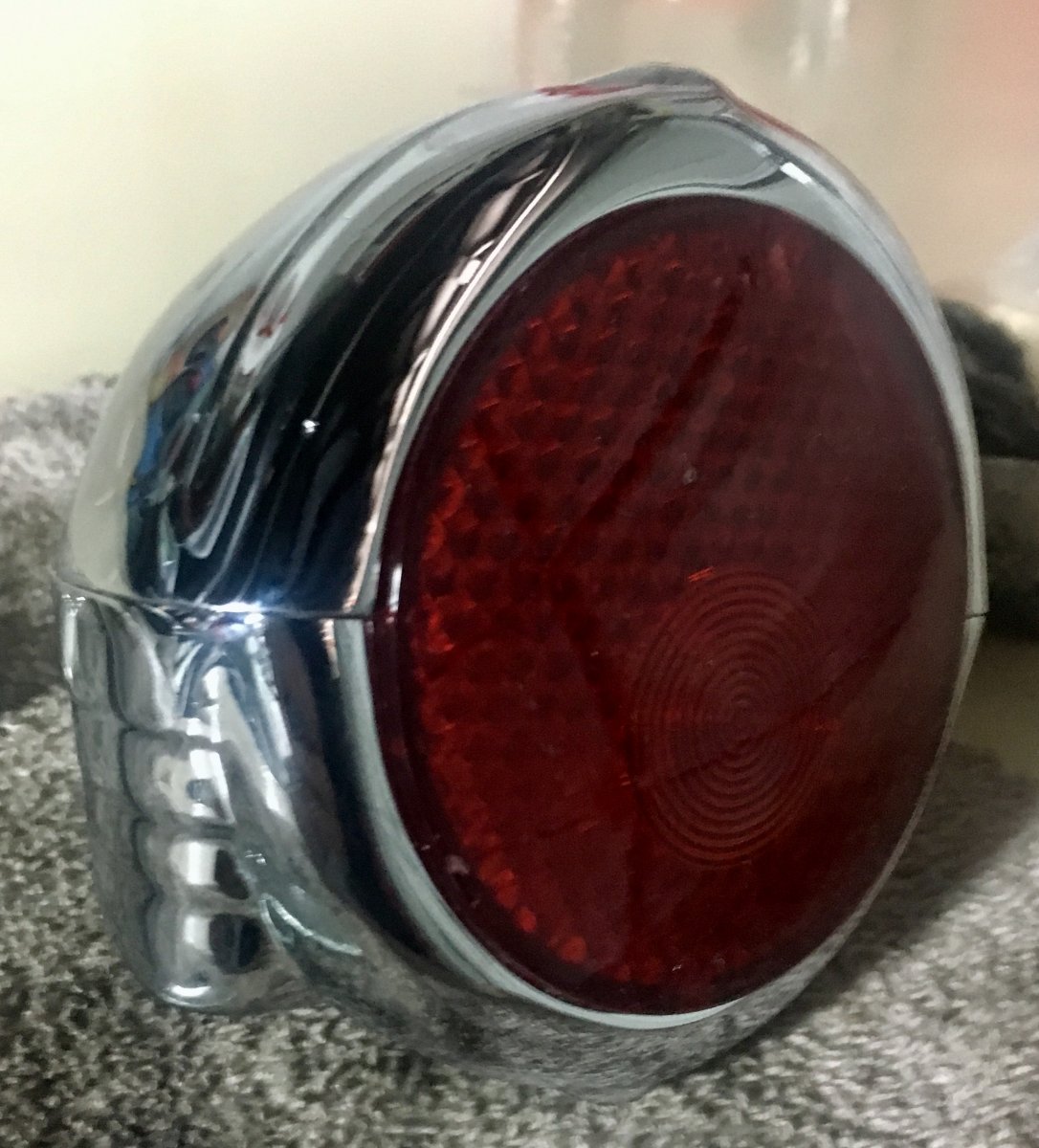

    Finished restoring this electroline taillight. Up in air about using it as it's the only part that would be post '39. :-/

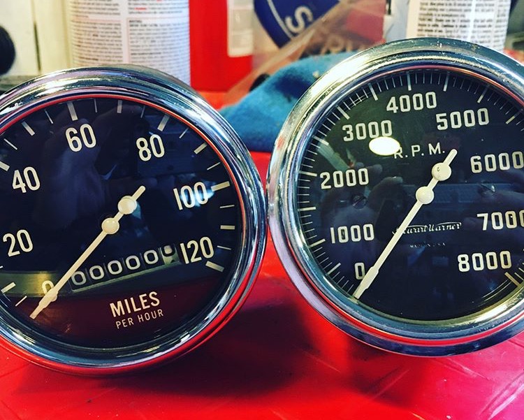

    Dash junk

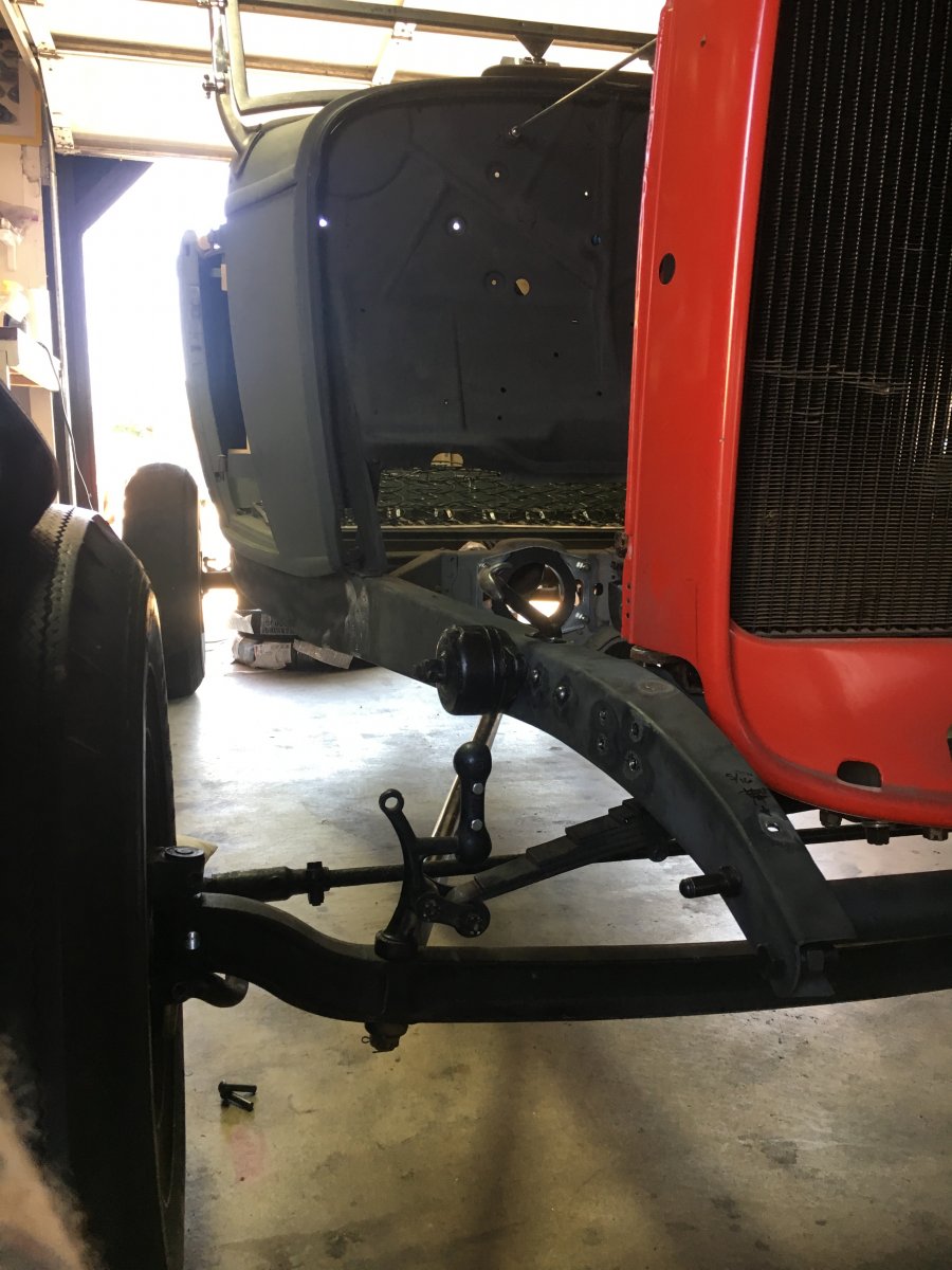

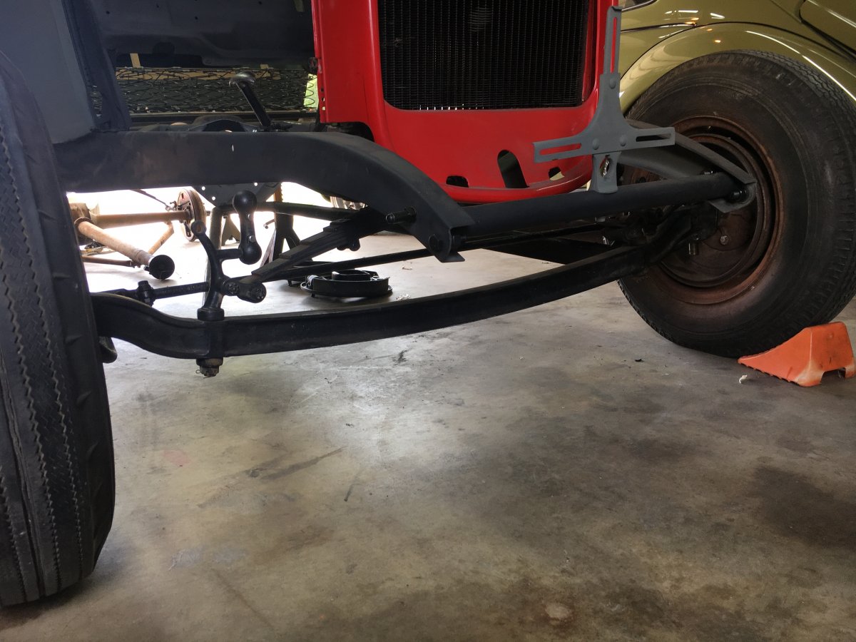

    Rolling components all 1932 now except the 39-40 hydraulic brakes. Small steps.

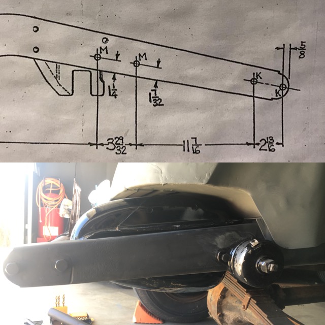

    You can buy a blueprint for a 32 frame ,
    But i forgot who sells these.
  16. ericjustus
    Joined: Oct 8, 2014
    Posts: 262
    ericjustus
    from Chino, CA
    Wecotts. I just picked one up. The cheap side of me was trying to avoid paying for it :)

    the '32's frame dimentions are in the last few pages of wescott's catalog...

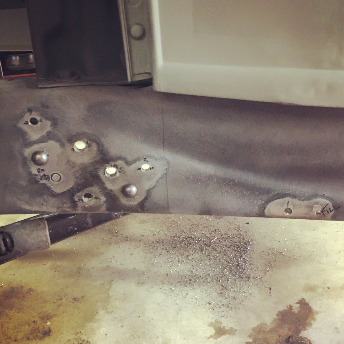

    It started. Barfed up one hole locator and will need weld back up and relocate.

    You can see where the previous owner welded up the frame. I will bring it all back to life but I'm anticipating burning through one too many drill bits! Drilling out old welds destroys a drill bits sharpness amazingly fast.

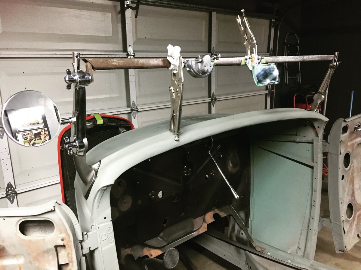

    Starting some mock up for dash shit

    All holes and rivets back in place. Houdaille shocks mounted. Ran out of gas and will get the rears on next weekend and get the shock arms installed. Step by step.
  25. ericjustus
    Joined: Oct 8, 2014
    Posts: 262
    ericjustus
    from Chino, CA
    Got my rear houdailles on. Got the rear tack strip formed and fitted. May have to tackle that again, I don't like the gaps. Lebarron Bonney isn't too sharp with these.

    Maybe too late, but I always get old welds red hot, then drill through them quickly.
  28. ericjustus
    Joined: Oct 8, 2014
    Posts: 262
    ericjustus
    from Chino, CA
    Wish I knew that trick awhile back. Thanks tho cuz idk if I'm done

    1932 pierce arrow dash grafted to the top rail of a stock '32 dash. Some may say this is sacrilege but I just say it's hot rodding. I also don't think you're going to see too many '32's with a full 1932 pierce arrow dash. You usually just see the gauge cluster grafted to a dash.

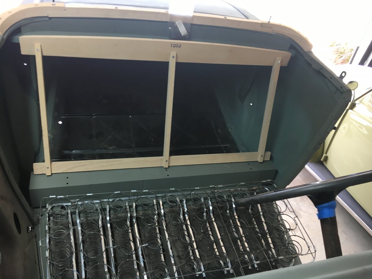

  30. ericjustus
