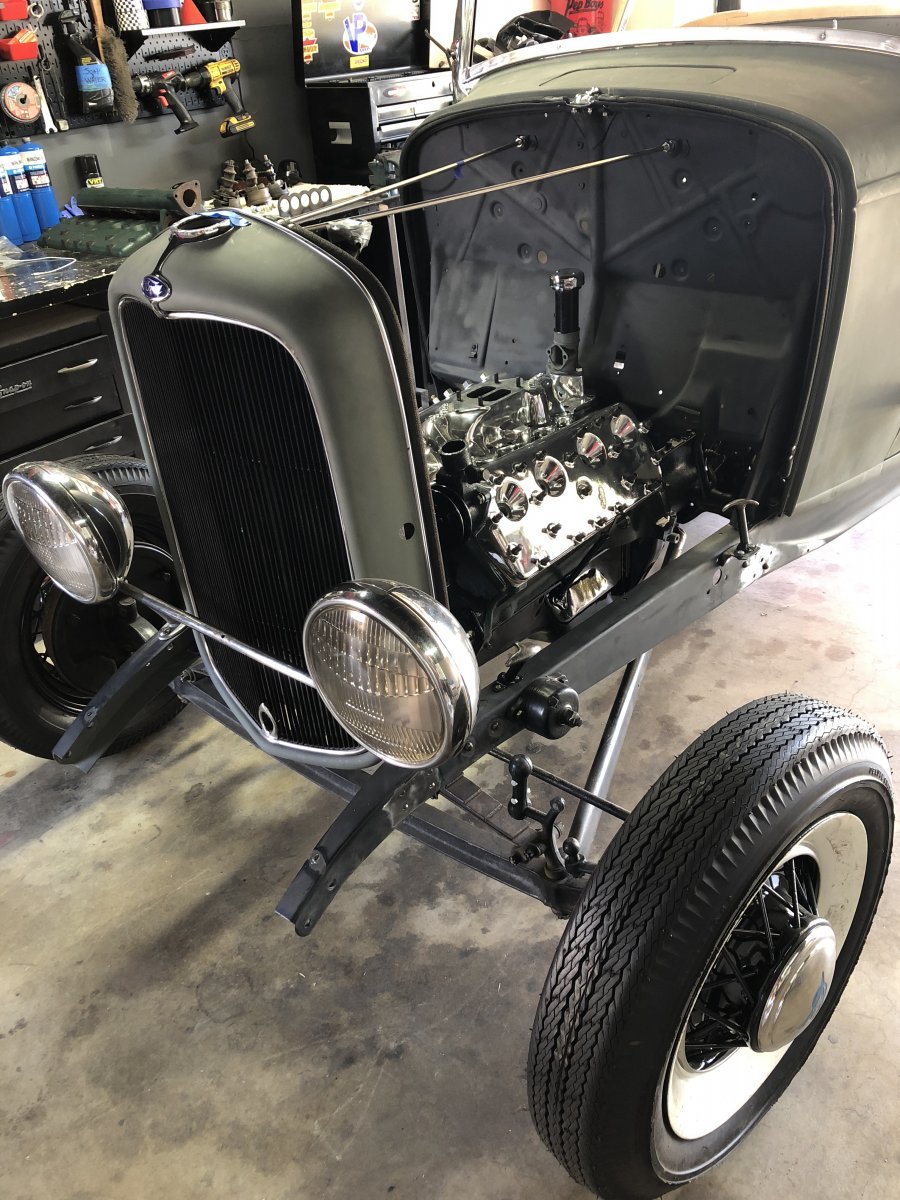

    Almost makes you want to just get it running and not worry about making it pretty.

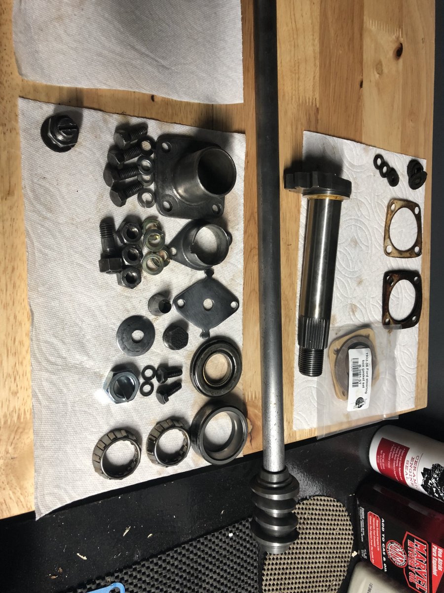

    Got all the little stuff and gears set up for paint/***embly. Two bigger pieces are soaking in the solvent tank. Slowly getting down to my last few greasy rebuilds.

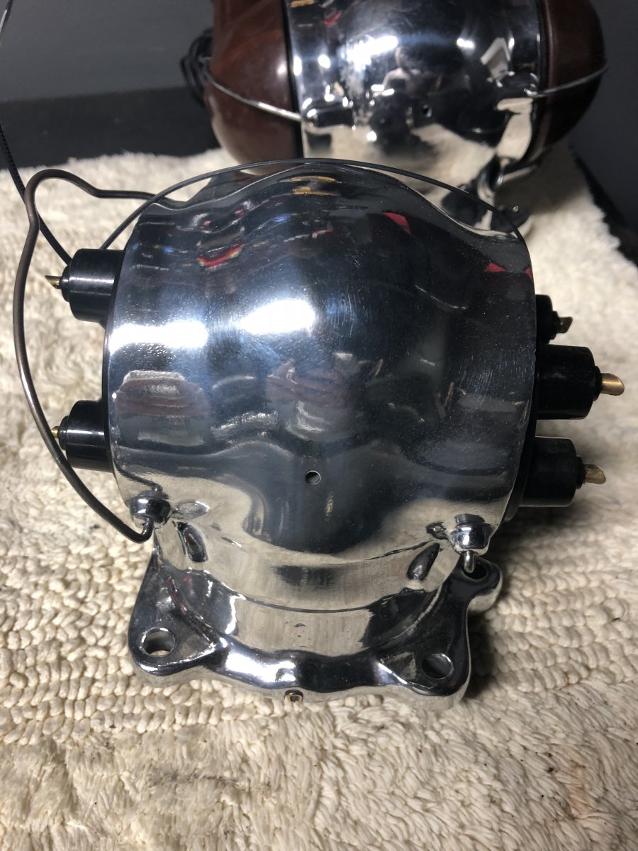

    Time to do a 12 volt recoil and detail a generator

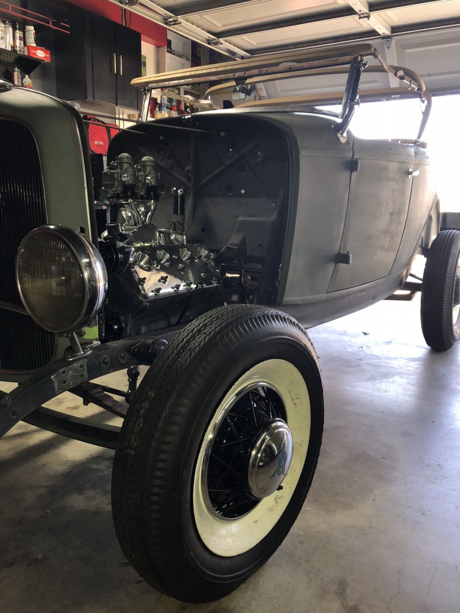

    Looks good to me as is! :cool: Great job on the roadster. I was out to LARS last June and it seemed that all I saw were SoCal type cookie cutter roadsters. Just different colors. Refreshing to see your 32. Good luck with the rest of the build.
    I am glad you left the holes for the side curtain snaps. I want to put them on my Brookville body. If you ever get time I would love to get some specs on their locations.
    StrickV8 and ericjustus like this.

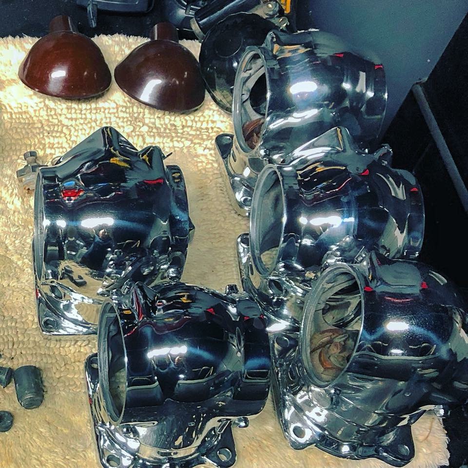

    Fully detailed and painted individually. Time to ***emble.

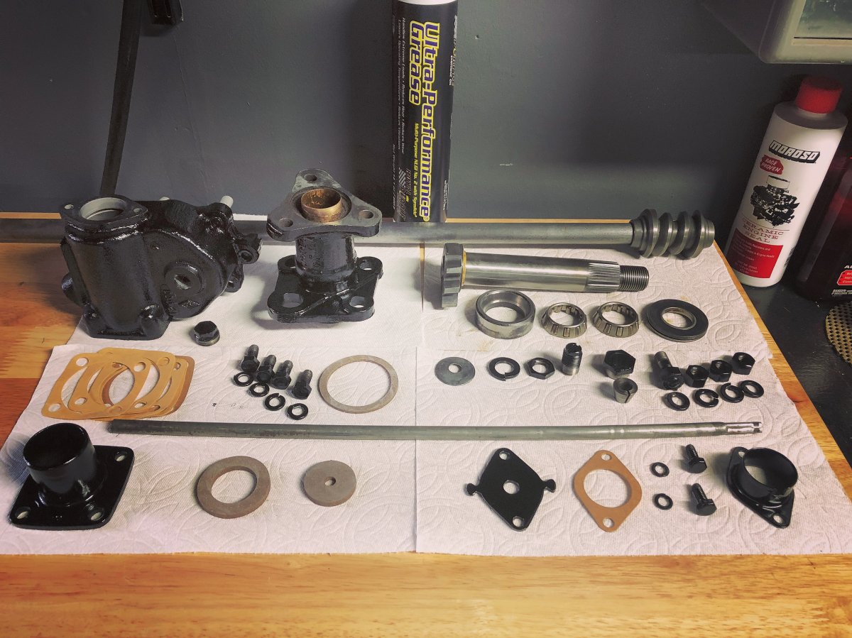

    Nice build. Is the fan on your generator a truck fan? If so what year. It doesn't look like the 4 blade 32 fan. Nice job on the steering gear.
  23. alchemy
    Joined: Sep 27, 2002
    Posts: 22,776
    alchemy
    What are you going to use to seal the sector? When I built my sedan I used an F-1 box with the '32 flange welded on. I tried a felt "washer" to seal the area. Didn't work and the frame rail was always wet and drippy. I rebuilt it over the winter, having a the flange counterbored to fit an F-1 seal into it. So far so good. I filled it with John Deere corn head grease.
    12secvx and Stogy like this.

    Yes it’s a 6 blade 39 truck fan
    Stogy likes this.
  25. ericjustus
    Joined: Oct 8, 2014
    Posts: 262
    ericjustus
    from Chino, CA
    Everything was filed flat and I use a little “snot” for areas like that with all stock rebuild components. I couldn’t go F-1....that’s now how it came in 32,:)

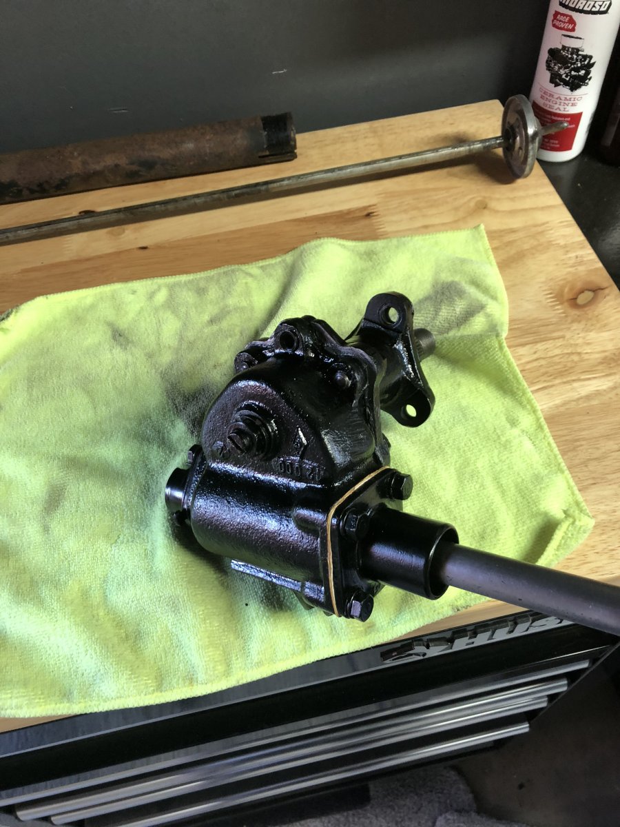

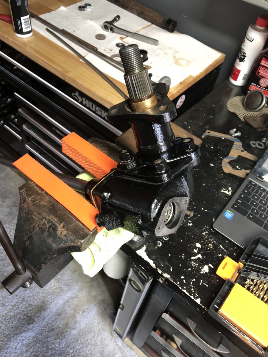

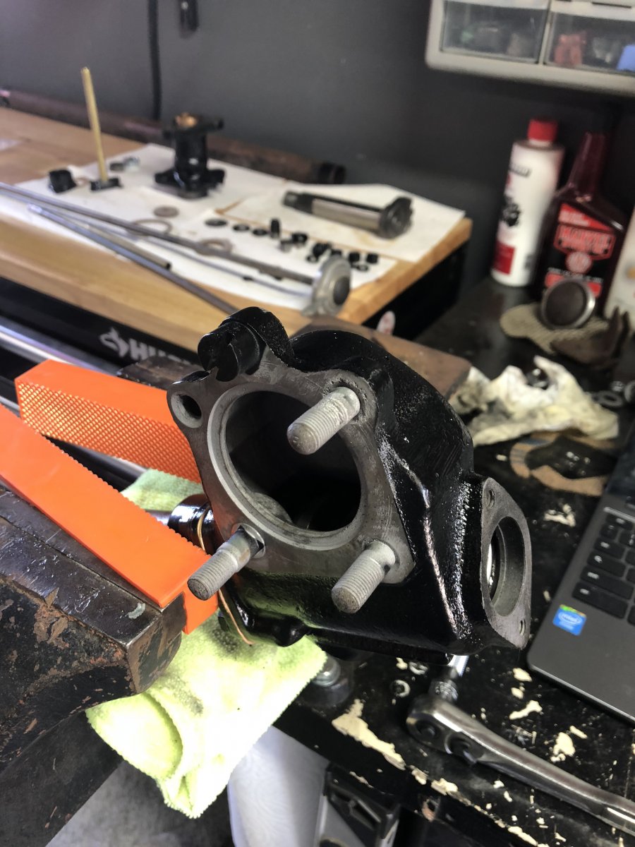

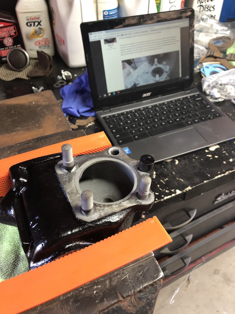

    Dennis Lacy had a build thread for his 32 truck and one thing he did was rebuild his steering box. I was able to follow along and finally wrap this up today.

    Looks like a repeat and nothing major BUT it actually is. This has come out to be rebuilt, painted and detailed. Parts are starting to get their final touches so I would say I’ve at least hit somewhat of the downward slope on this build.
