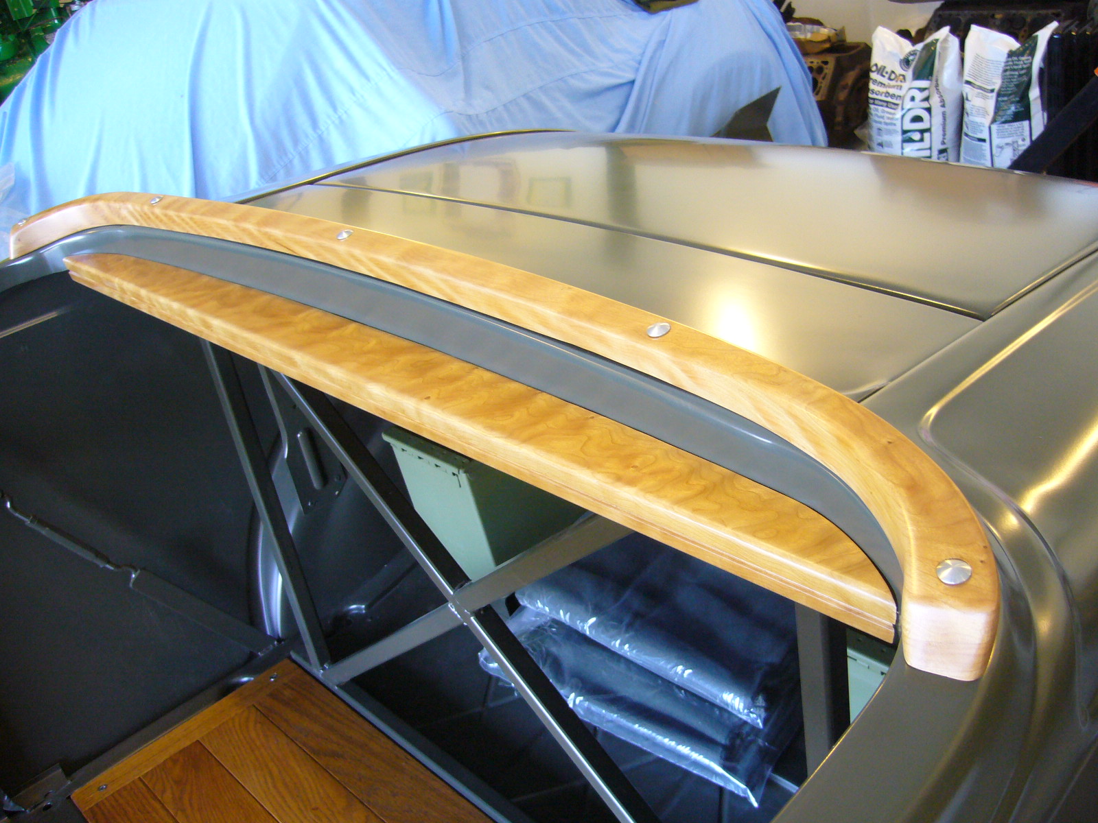

    Part #29 "Woodwork"
    Ervin Beachy showed up this afternoon and installed the curly, cherry deck wood and the wood behind the bench seat. He had previously applied a special finish on it to bring out the woods' natural figure. Then he put on three coats of satin marine sealer to protect it from the sun and rain.
    I know it seems odd to see a chisel and wood chips when building a "street rod" but Ervin used his old english-made Robert Sorby paring chisel quite often when he was here. It's his favorite chisel!
    Just to let everyone know, including you custom rod shop owners, Ervin is now offering the wood floor boards, curved deck wood and the wood behind the seat for the 32 Ford roadster. He now has patterns that fit the Brookville body very well and should only require a very mininal fitting once you purchase them. Ervin offers the wood in oak, cherry, maple and other local hardwood or can supply almost any exotic wood from around the world priced on special request. We could also email photos of the wood ahead of time to meet your approval.
    I used polished stainless steel carriage bolts to fasten the deck wood down. You could also use stainless steel wood screws from underneath, but I like the look of the bolts on top.

    32 Spitfire, That wood is GOOD! Your friend is a very skillfull man, your up-dates look GREAT as always.
