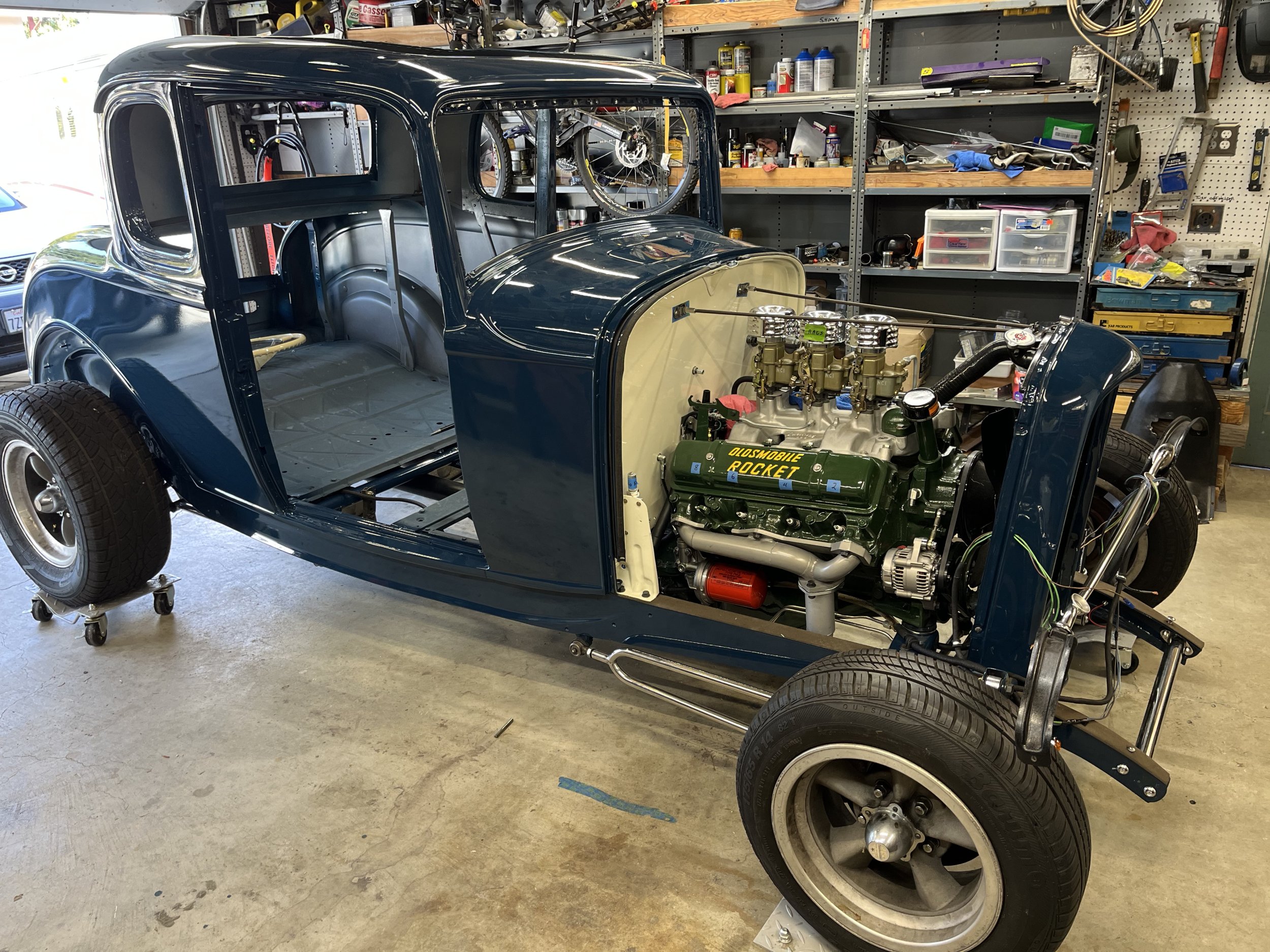

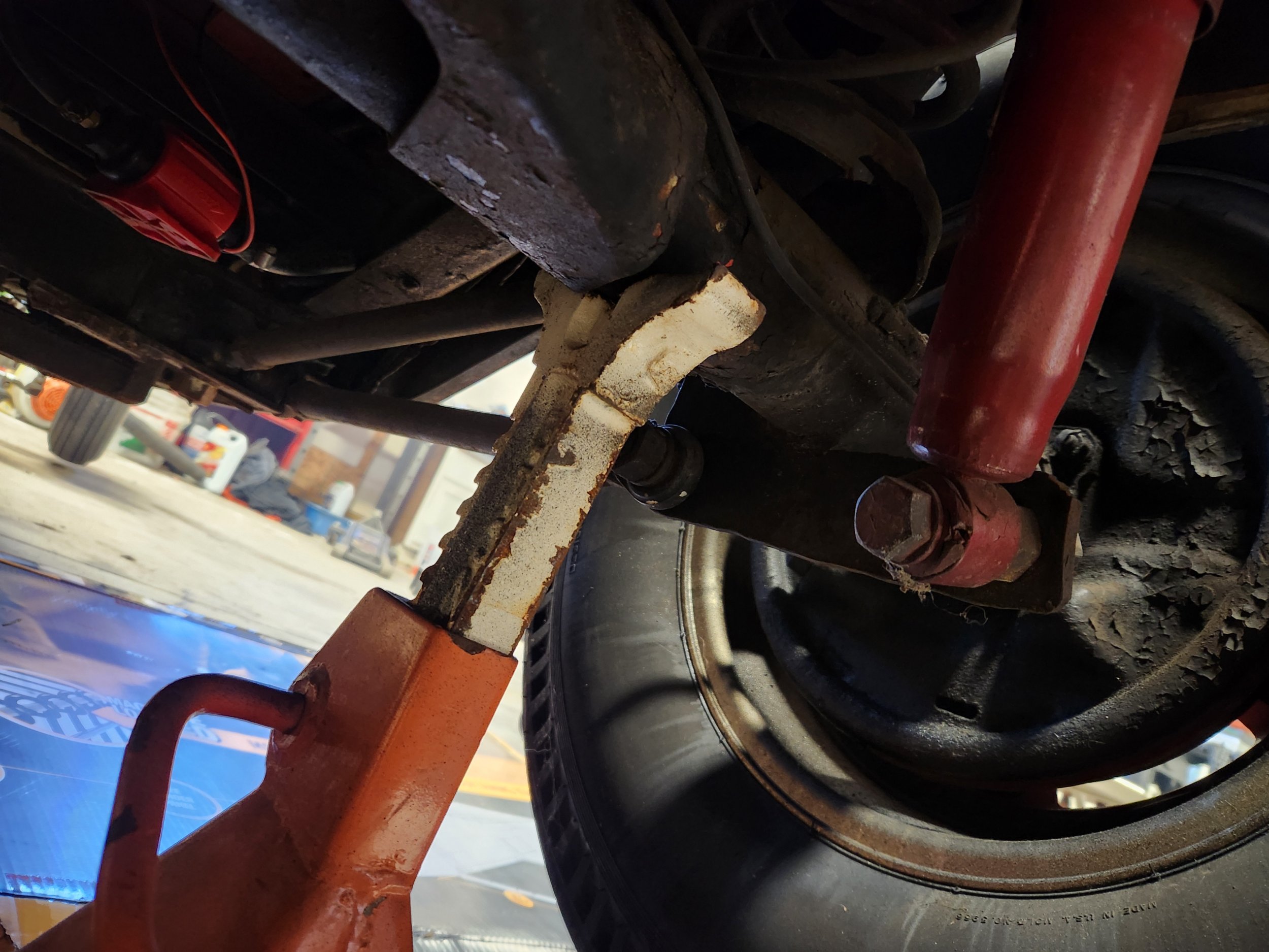

    So the engine is ready to come out as soon as I locate the chain for the cherry picker. I crawled under the back to remove the drive shaft and took a real good look at the back end. What I saw was an oldddd home made 4 link set up. The bars have eye bolts welded in and the nuts on the bracket bolts holding them in are back welded. Tiny little coil springs on top of the axle tubes with old worn out shocks. I will take pic's of the old school mess tomorrow. Also noticed the p***enger rear wheel cylinder is leaking as well.

    20250104_125402-1.jpg So it appears to have a 9" rear end. Here are some more pic's. 20250104_125439.jpg 20250104_125521.jpg 20250104_125521.jpg

    Isn’t that 57 Chevy?
    Make your photos full size, not thumbnail.

    Not sure alchemy. It has a center section just like the 9" in my Chevelle.

    Sure is a '56 '57

    Glennpm what are the indicators I should look for on the rear end? Also DuraGlide according to the internet the 350 with 6" tailhousing is 27 something inches long and the T10 is 24 something.

    Are the flanges where the backing plates bolt on squareish, or round with the top sliced off?

    Doing some research it appears to be a 57 Chevy rear end. The 55 and 56 didn't have the drain plug. I will have to clean the tubes to find the numbers to know exactly what we have.

    thats a 55-64... check for posi... they were real liberal back then...if you a 9'' the 3rd member hangs below the 2 nuts.... so if you can put a ratchet w/ extension on the two bottom nuts it's not a 9

    if it has weld marks for spring perch... it's pre 58

    looking closer, looks like weld marks where they cut off the control arms... so now i say 1958-1964

    IIRC it is a posi unit after doing a small burnout and leaving to tire marks. I'm gonna have to pull the body so I can get in there and take measurements before I cut out all the old suspension and prep it for new 4 link set up.

    Look on the front of the dropout. If there is a large P cast into the driver's side, it's a posi.
