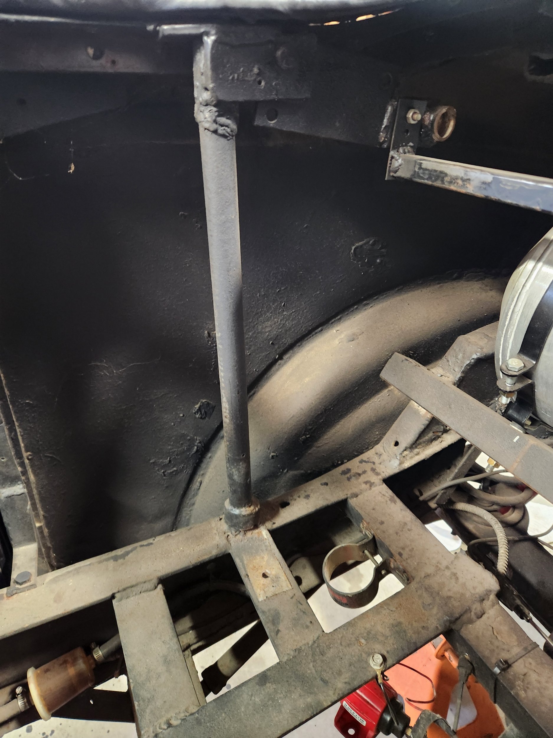

    Alot of progress today. Unfortunately the body is not coming off the frame. It's welded and bolted together. The clutch is fried hence it slipping. Looks like I will have to pull the rear end out and undo the antiquated rear suspension and install the new improved parts. Not a big deal. 20250110_115007.jpg 20250110_133504.jpg

    Those are some seriously traditional welds...

    MCjim yes they are! I looked it over real good and if I do anything I will grind them down and MIG over the top. I will know more once I pull the floor out and see the rest of it. Tomorrow I hope to pull the floor, remove the T10 and yank all the wires out of it remove the dash to see what is hiding under it. Also hope to get the flywheel off the motor and on the stand. I'm curious of what is inside.
