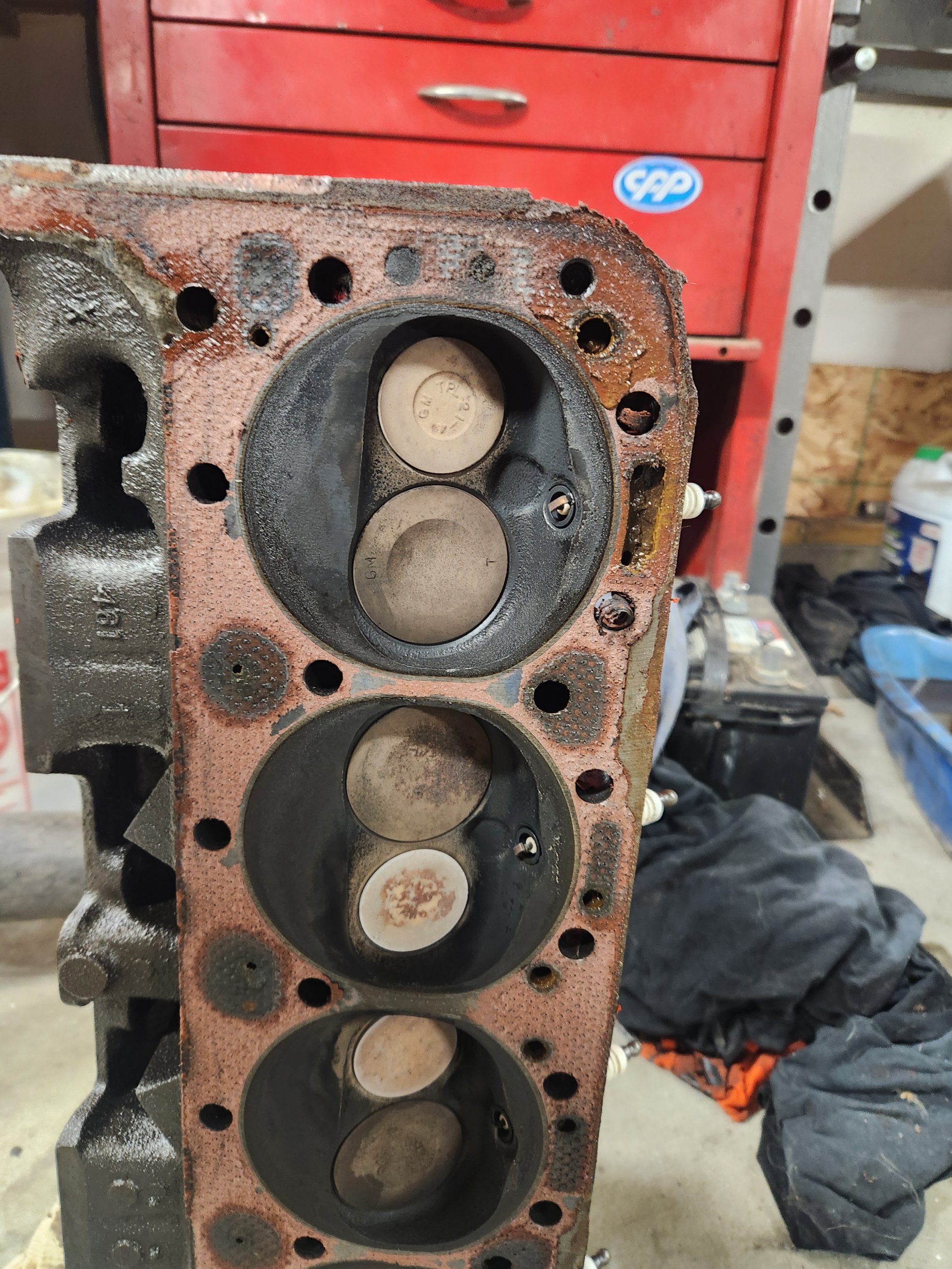

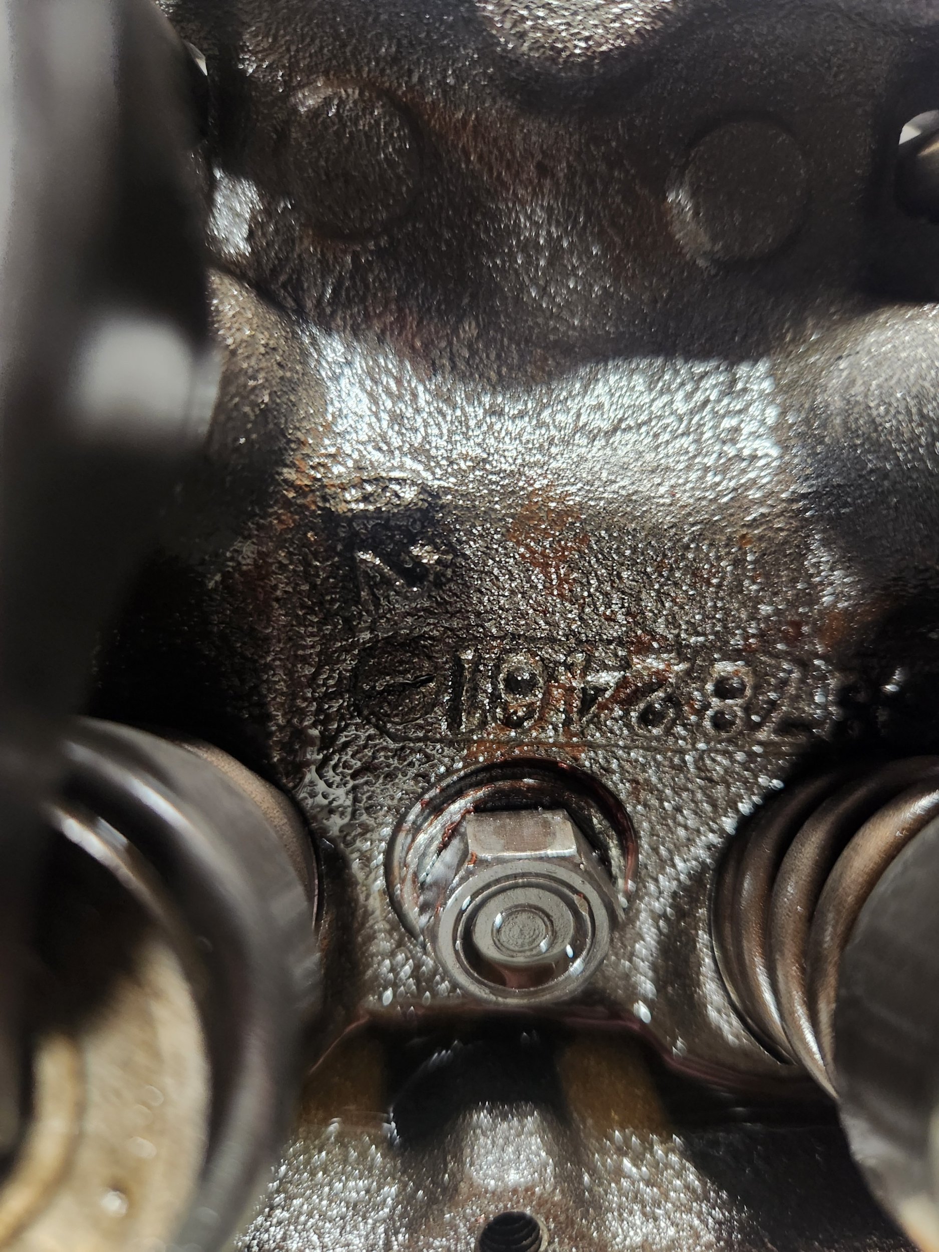

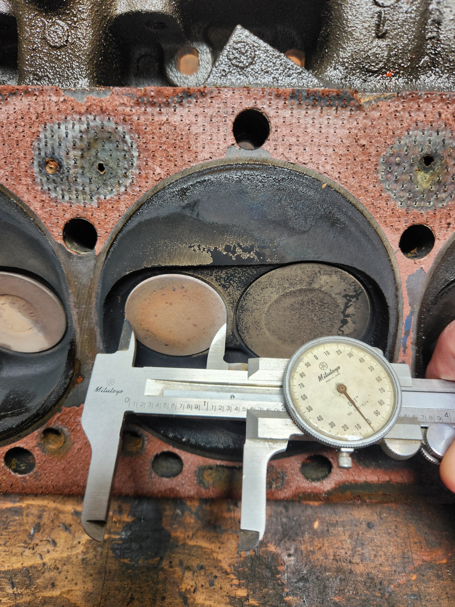

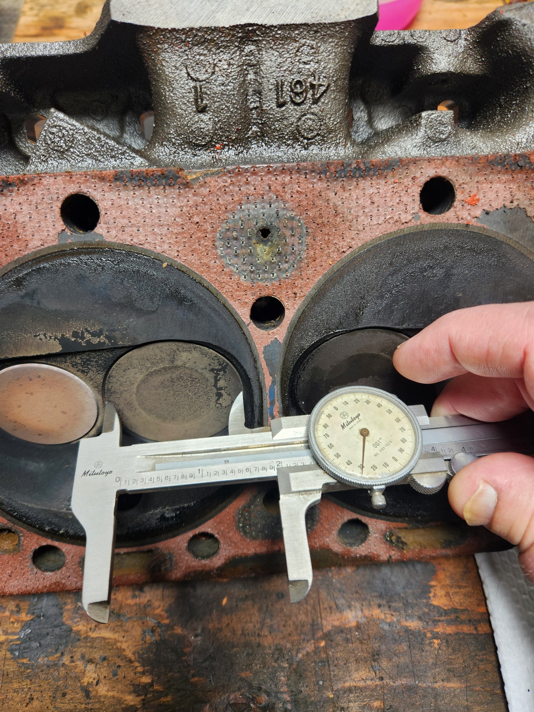

    I think you may have 1.94 heads. They shared the same casting number. 2.02 heads the valves almost touch.. here’s a pic
  2. DDDenny
    Posts: 23,422
    I planned on saying that very thing Mark, also a bit odd that someone installed the "461" (early/mid 60's) heads on that "010" block.

  3. pantodd74
    Joined: Jun 29, 2023
    Posts: 146
    pantodd74
    The intakes are not 2.02's. I had my apple crown royal gl***es on that night. I will measure what they are and report my findings. Ya'll have some good eye's!

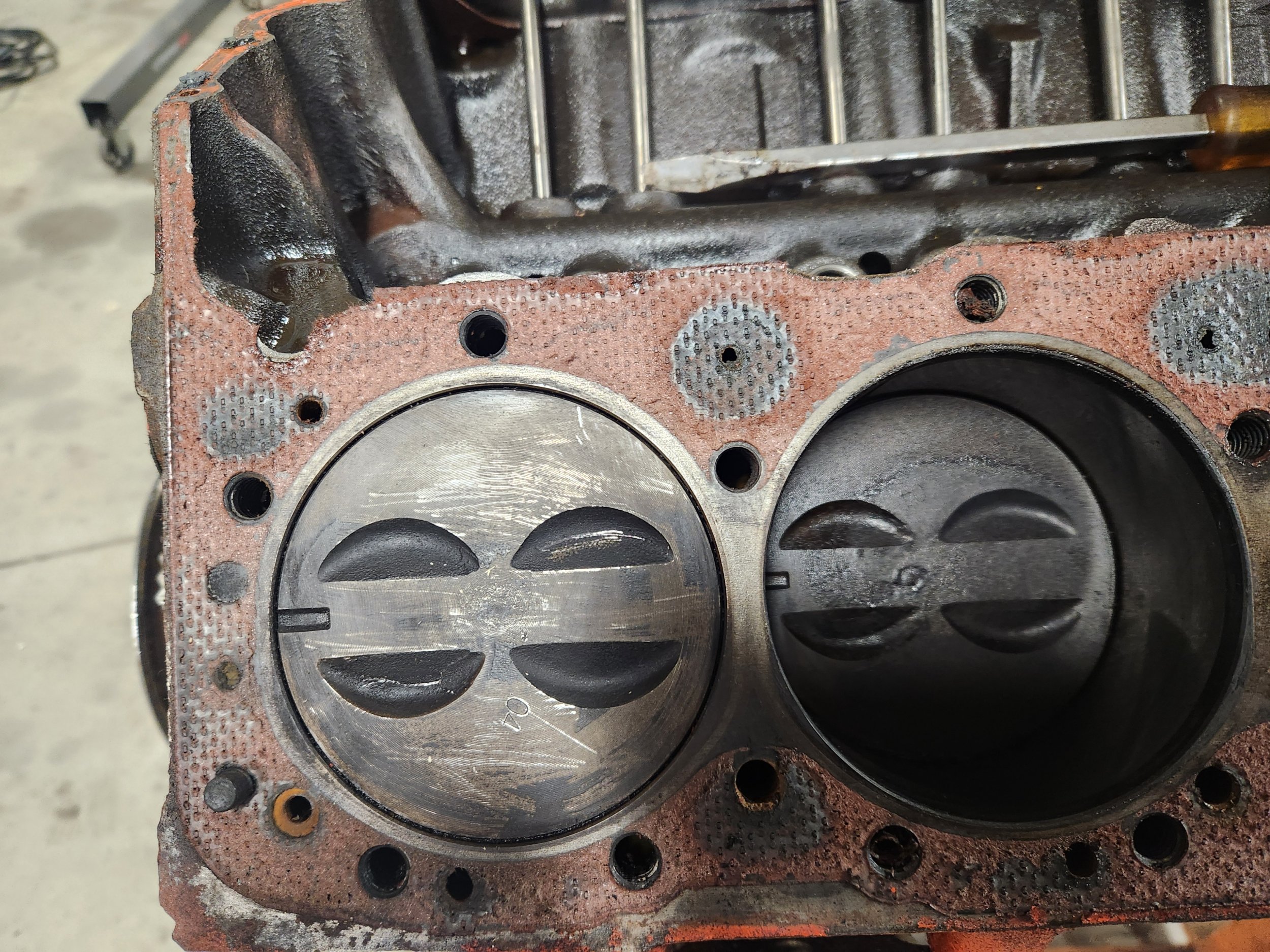

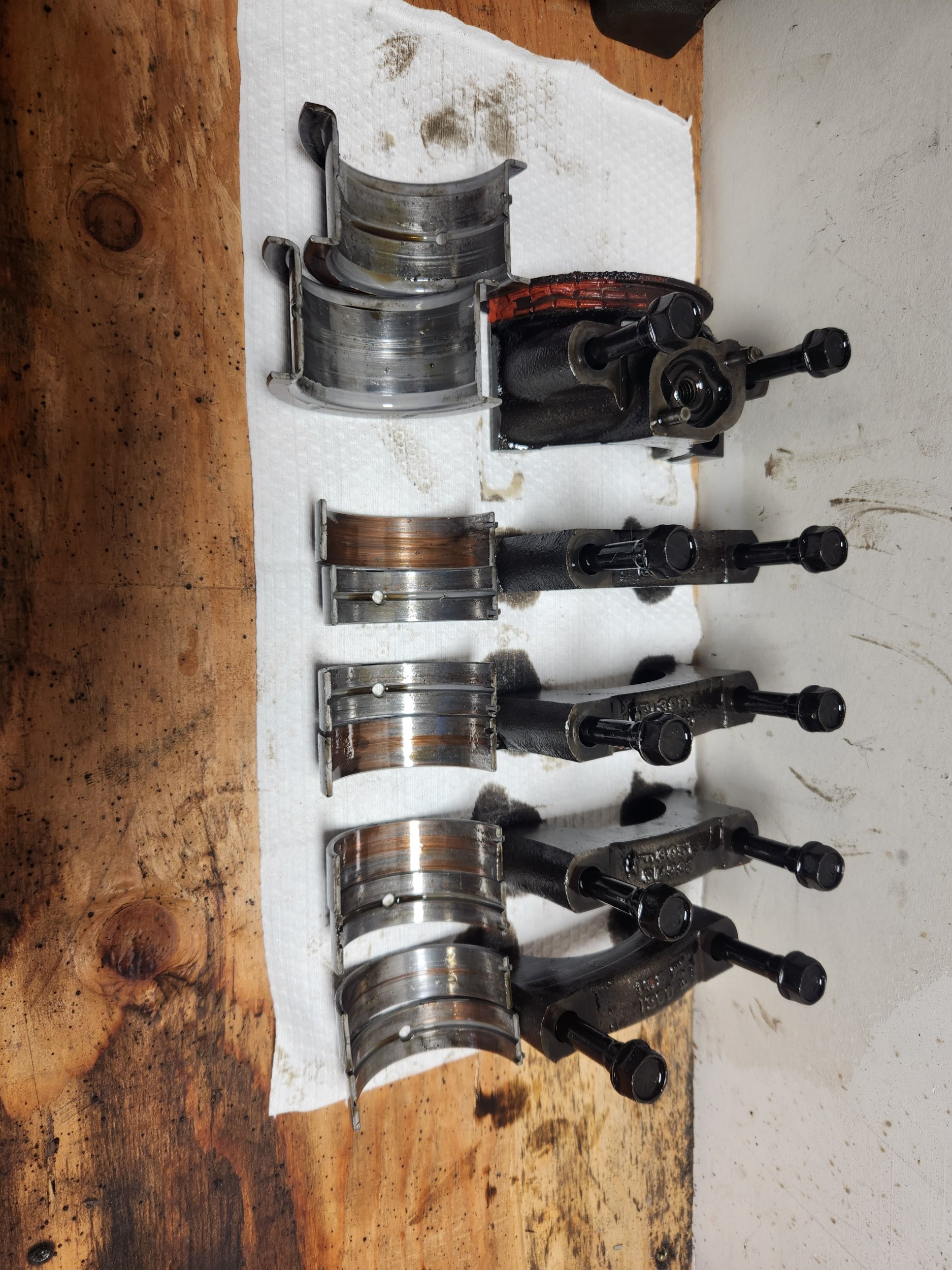

    Before work yesterday I installed the #1 and #2 rod piston sets and rotated the ***embly. **** did a great job. Everything clears the block and rotates without issue. So tomorrow I will install the rest and make sure it's all good. If your looking to build a stroker **** is the way to go.
    Tow Truck Tom, Outback, rod1 and 2 others like this.
  16. RodStRace
    Joined: Dec 7, 2007
    Posts: 10,861
    RodStRace
    Make sure to check oil pump/pickup and cam too. Good to hear of parts that work right out of the box.

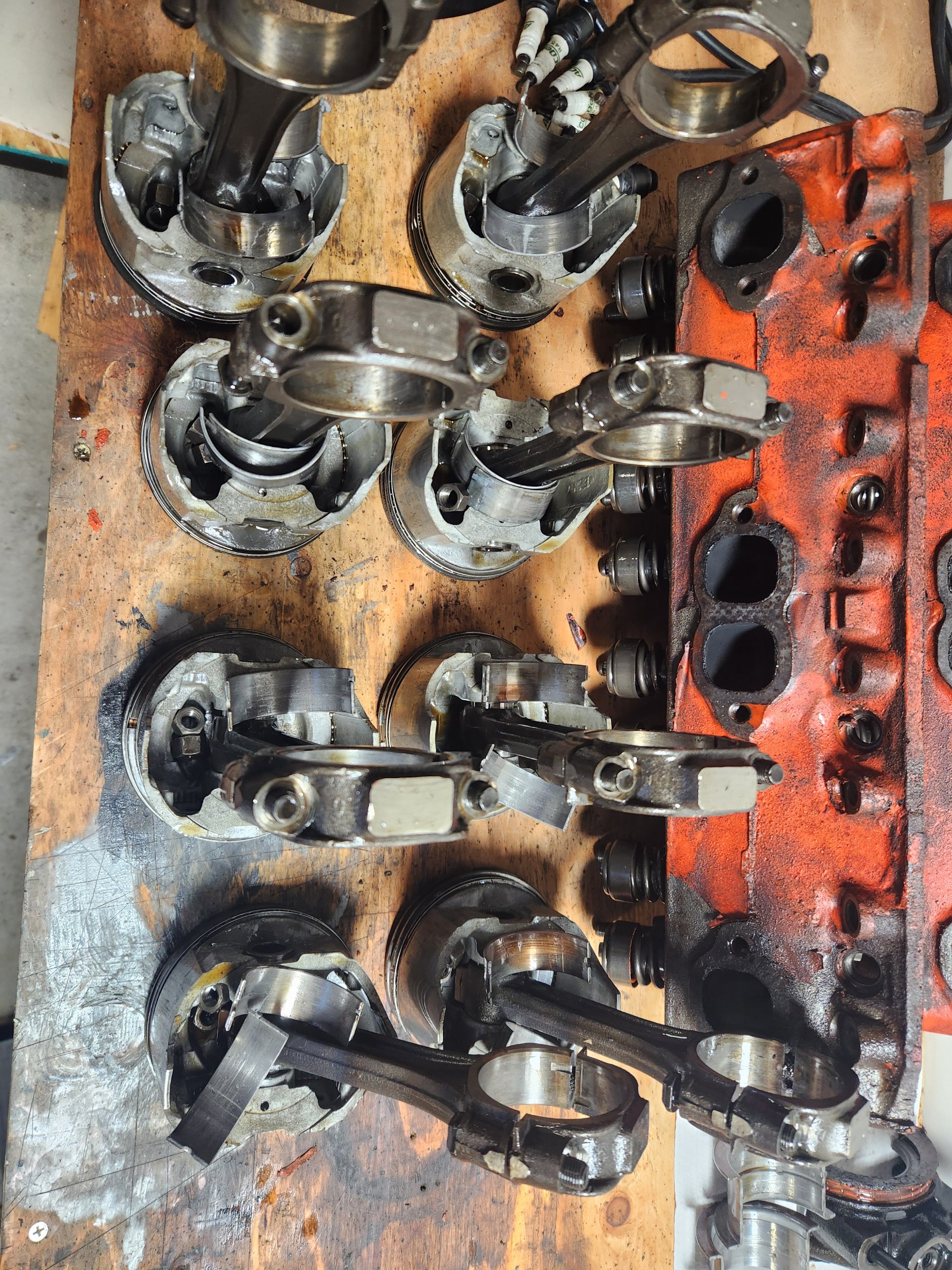

    So today I got the piston and rods installed and all rotates without any clearance issues. Time to take it all apart, clean it really good again. Install the main studs and crank for a final torque. Then install the rings and set the pistons and rods back in for the final time. Then complete the short block. This week at work I will take the heads for a good cleaning and get them ***embled. Hopefully have the long block finished before we head to Jamaica!
