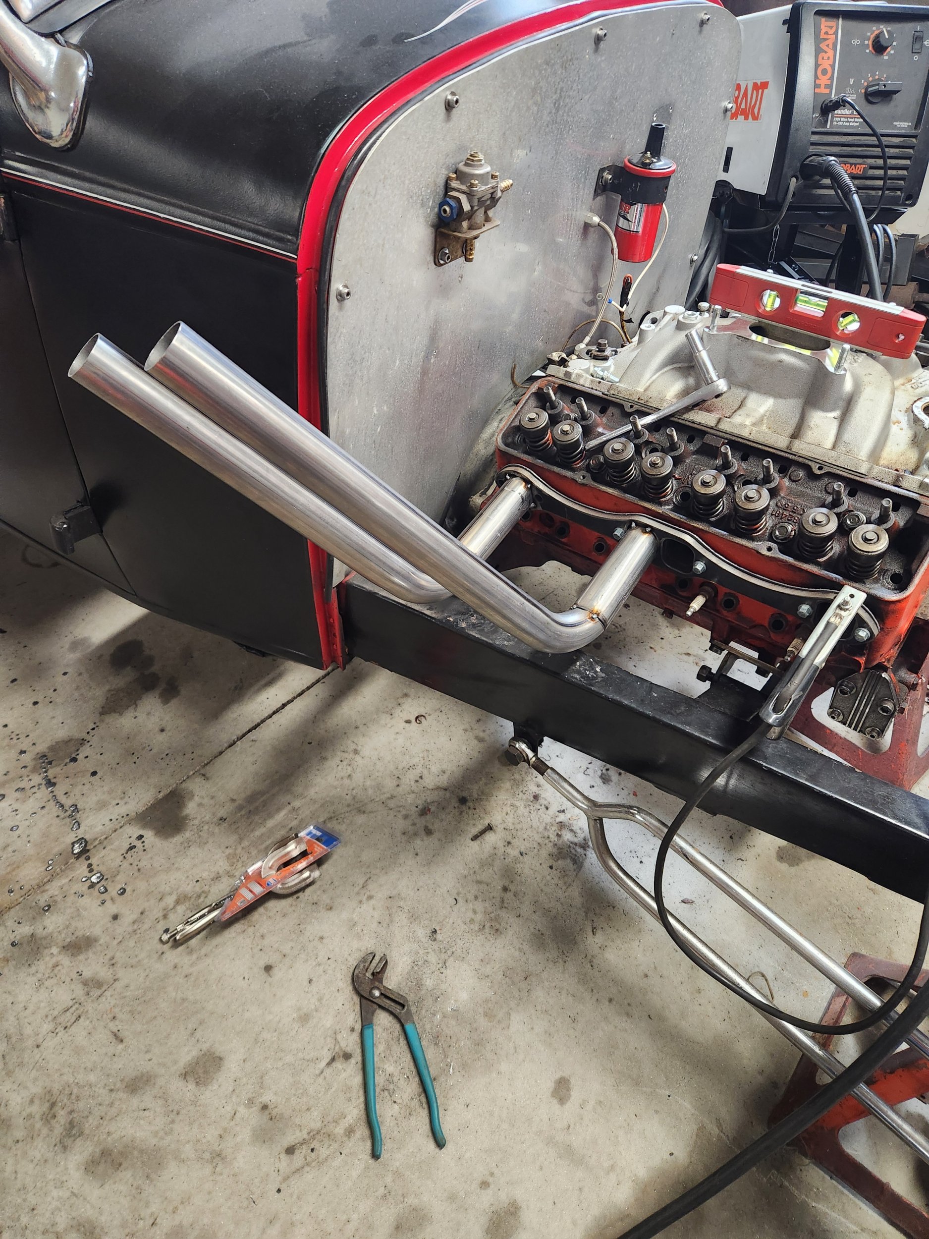

    20250425_204837.jpg Well this is as far as I got last night with the exhaust. After some feeble attempts I finally figured out how to mimic the angles and lengths. Cut a 15 degree angle at the flange and shape it to the opening. Then about 5 inches straight pipe to the cut upward angle pipe. 20250425_204812.jpg

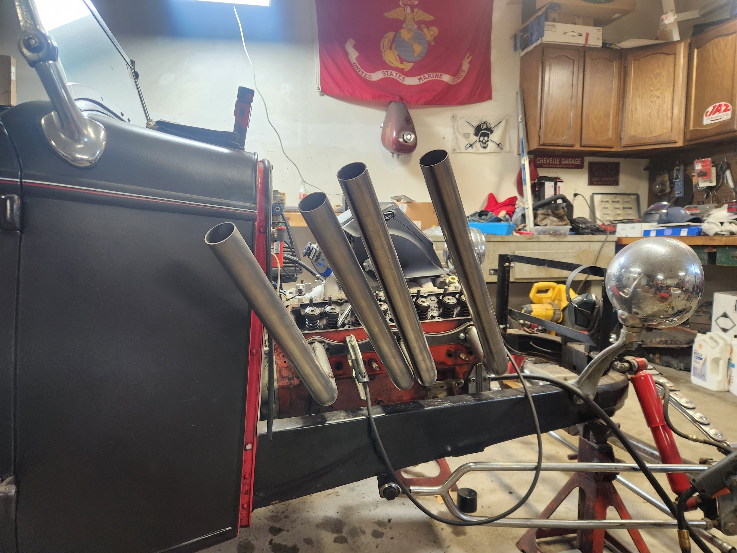

    Been a while since I've posted anything. With the weather changing and work that needed and needs to be done take priority over the car. I did manage on May 20th due to the weather get all 4 pipes mocked up. I haven't touched the car since. New pool liner, heater and a lower deck refacing with new cabana have take up my free time. Here is a few shots of the 4 pipes tacked in. 20250520_104433.jpg

    Your wife wanted that? At least you won’t be able to hear her complaining about it after you start it up.

    Finally, some one that may have the balls to run zoomies bedside's me. Now I don't fell so all alone.:D
    :):cool: Love the build brother.

    Do you actually drive a rod with those pipes outside the fairgrounds?

    Yes that is what she wanted. We will see how long they last after the first start up to break in the cam and the first drive.

    I bet a bull riders 8 seconds will last longer than your wife sitting in the p***enger seat with those pipes spewing fumes and noise into her face.
