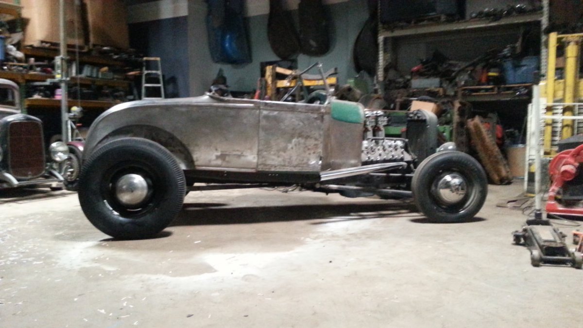

    pic for inspiration

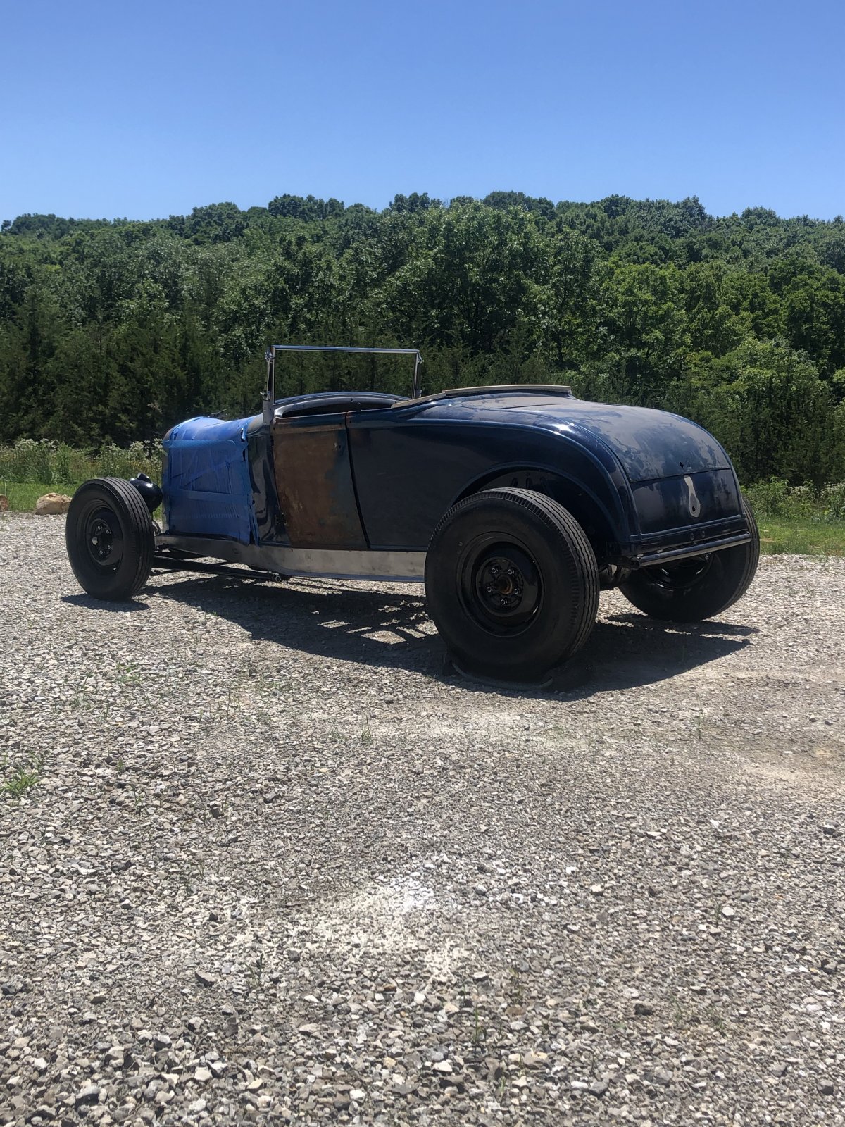

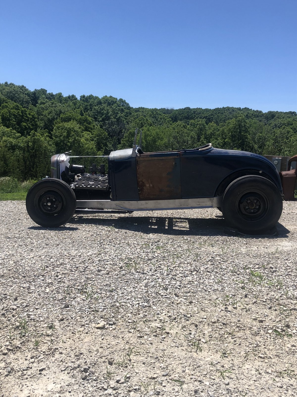

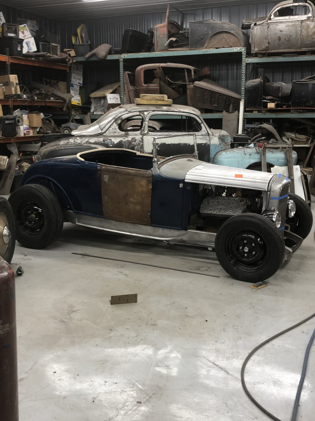

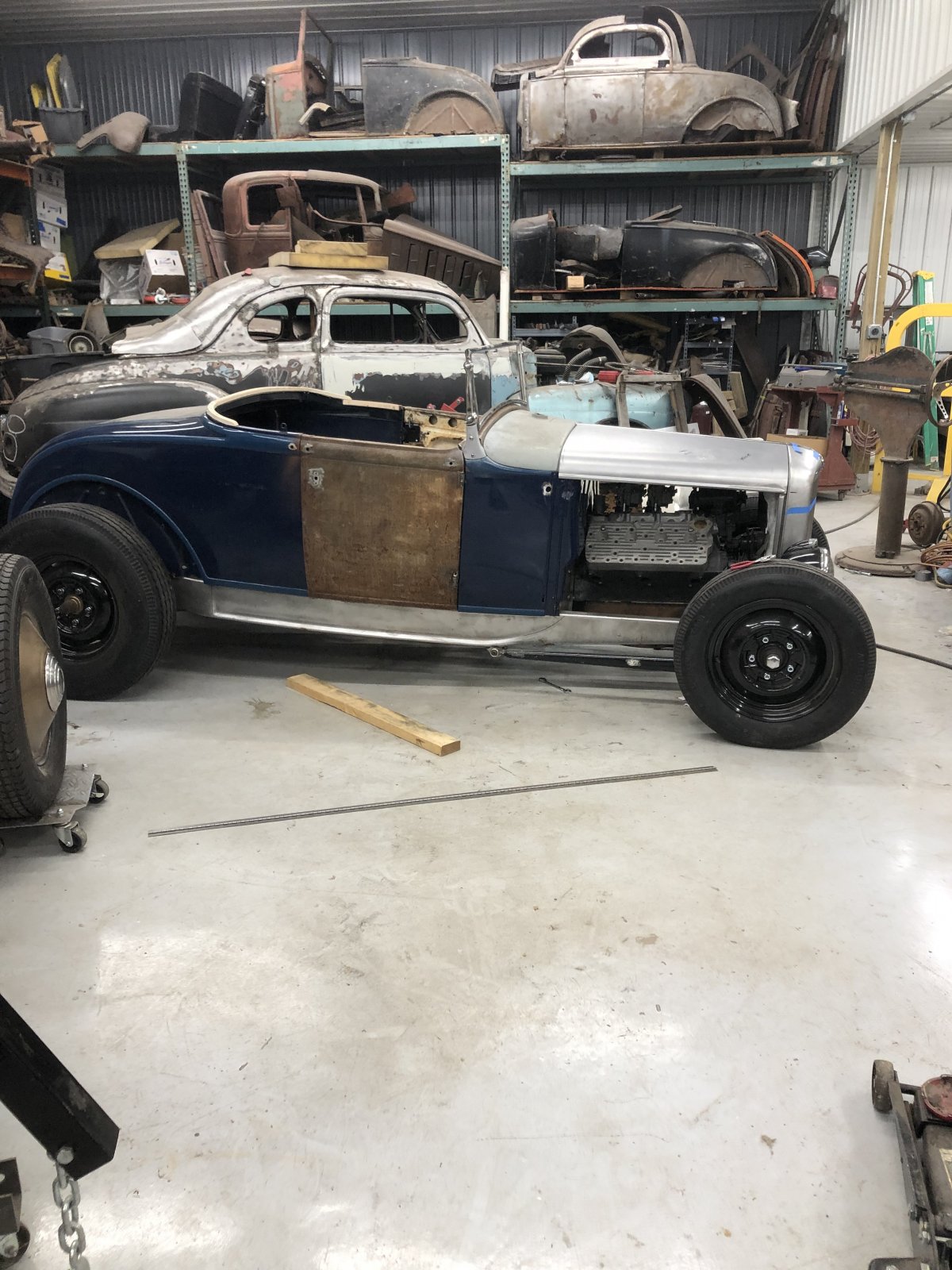

    49728EEA-8E5B-4F61-9143-58E5D4305188.jpeg D11B155C-8B4A-49FB-AF9E-5D3E96855E30.jpeg 6B340883-70C9-4F8E-8CE5-C0127337ABBA.jpeg 6931B471-6670-4D83-9BA7-F43DFAC33AF2.jpeg 8ABC0EFF-C4FF-43C0-83C1-5BE3442031D4.jpeg 8A7B2F9E-E2DD-45BB-AF04-CDA43CA6F5A8.jpeg A74F6B14-0253-4449-94FC-3F7AFB83EDC0.jpeg Here is one I am working on at the moment. I bought a frame but ended up moving the rear crossmember forward so the body sat more to my liking. Kind of wish I would have come another 1/2” or so to be honest. 35/6 rear on stock wishbones with upper torque arm added. 1953 Merc engine and trans going in it. Sound pretty close to what you are doing so if you need measurements I may be able to help but since the front and rear horns are bobbed I would have to figure a consistent point to measure from in relation to a stock frame.

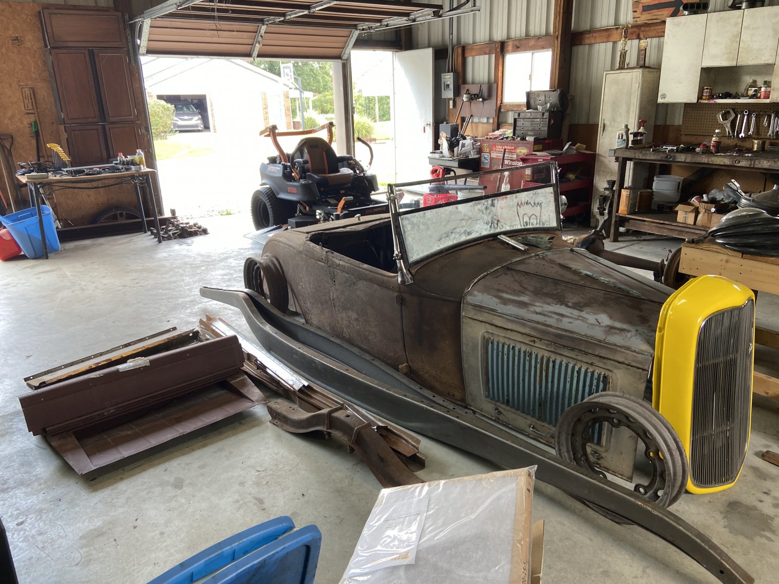

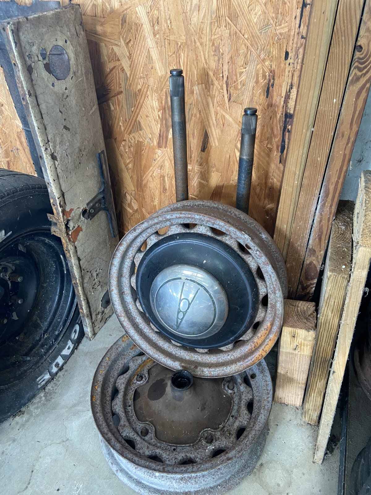

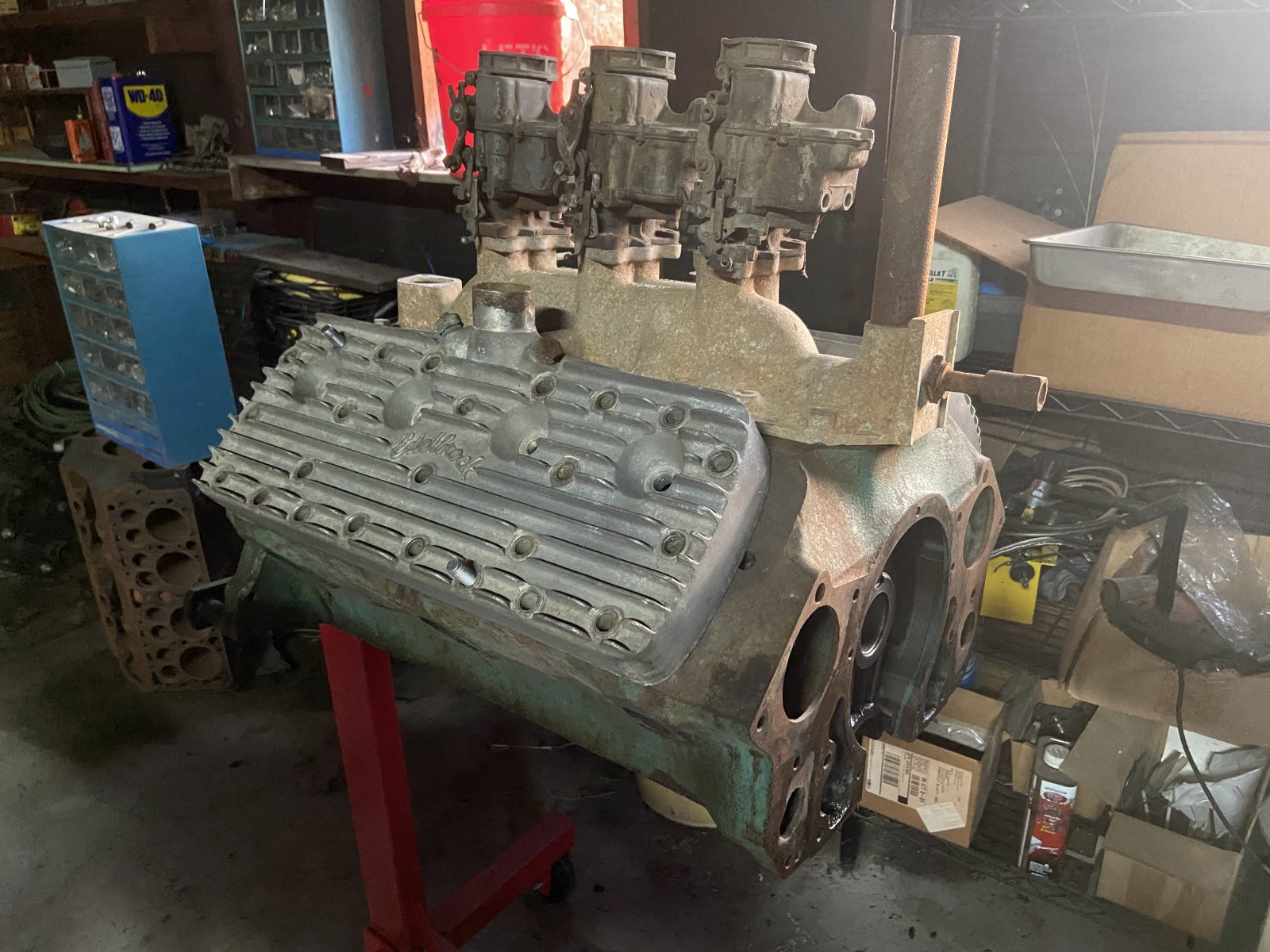

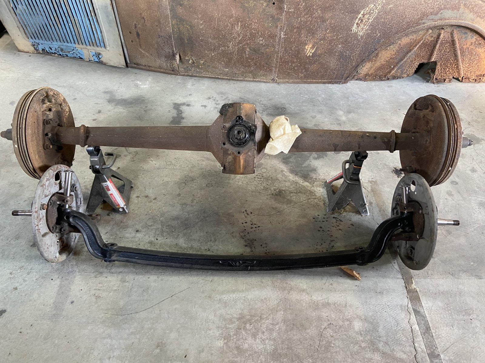

    DD8ED28D-CAB6-4A82-9301-2A416D871D5C.jpeg 0CDC3FC9-D5F7-4E17-9188-9D8F253B4E1F.jpeg 3B94EA57-5305-4EB2-9E23-7070969F3097.jpeg E735B75F-1B82-4633-86F4-9CA73AB1C710.jpeg
    i have a lot of work to do..

    It is a 32 style 4 piece hood that is 33" at the center hinge. The grille is lowered an inch, the rear crossmember is pulled forward an inch to 105" wheelbase. It is running 7.50-16, and 5.50-16 Auburn Radials. Still waiting on the hood sides, but this is what it's getting.

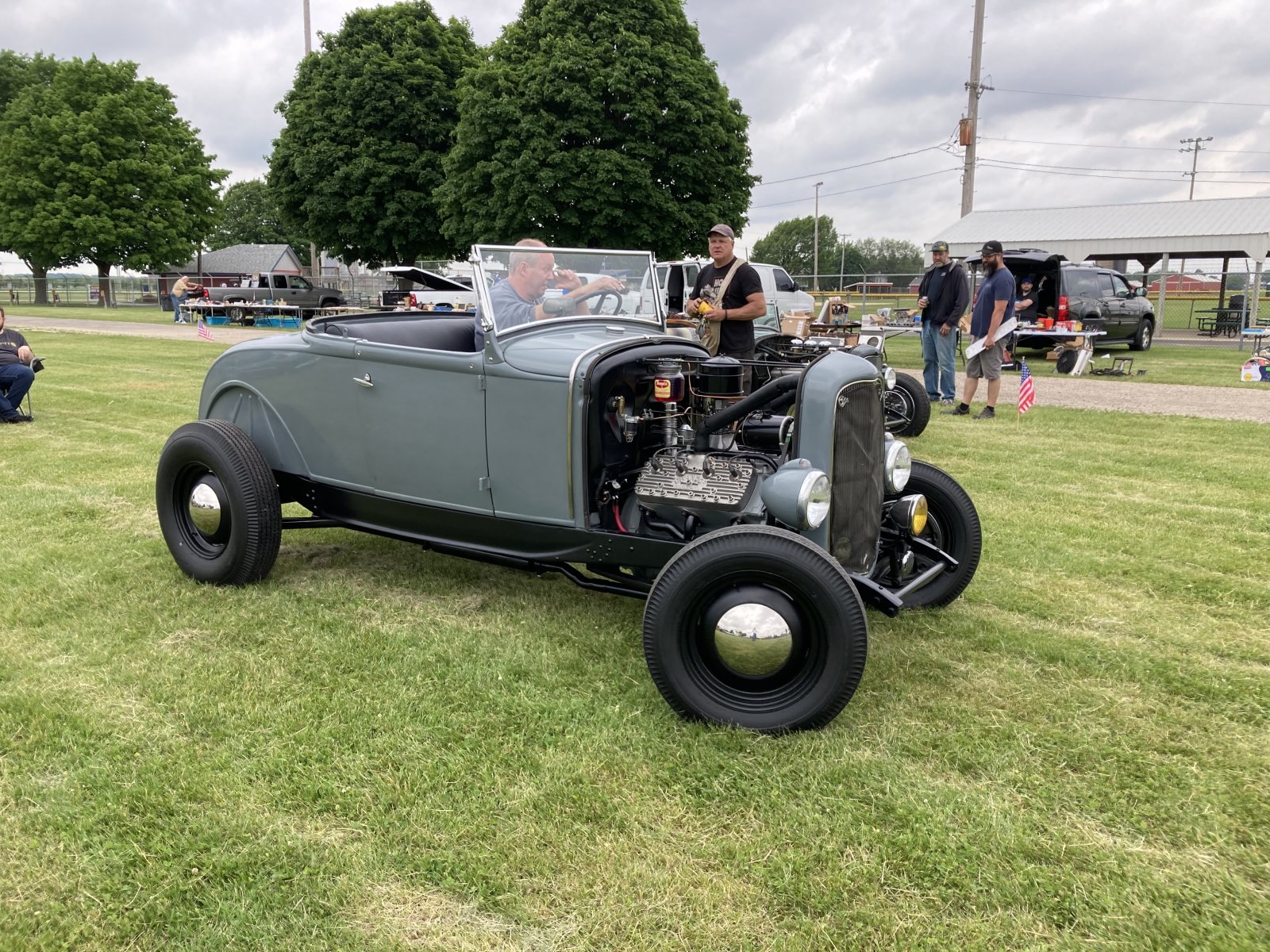

    Your inspiration picture is my 1929 roadster and it does have the great look thanks. That roadster is on a original model a frame that was Zed in the back.
    It looks like you have a great collection of goodies for your build .
    Here’s a few of my favorites @banjorear on the top and flathead Timmy on the bottom.
    I would search for a original front crossmember for the front and will have the front motor mounts for the flathead on the crossmember. I also would put rear crossmember in original location . The only time you needed to relocate the crossmember is if using a original 32 body. With the model a body you can center your tire in the wheel well and mount the body . This way you will have your location for a number of items for your build The rear mounted in the crossmember ,engine mounted on front crossmember using 1932 mounts sold at Bob drake. Then mount your transmission to the motor to get a location for your center crossmember X member or K member. So I will ask what transmission and are you going open drive or closed torque tube meaning the driveshaft .
