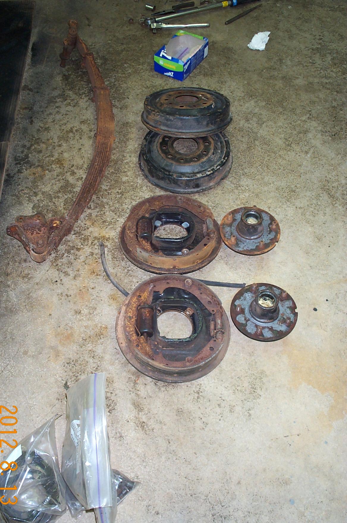

    Rear axle is coming together.
    Pics are of b4 and after blasting the bells.
    The axle ends have been repired where there were grooves from normal wear.
    New housing bearing and races along with new end seals.

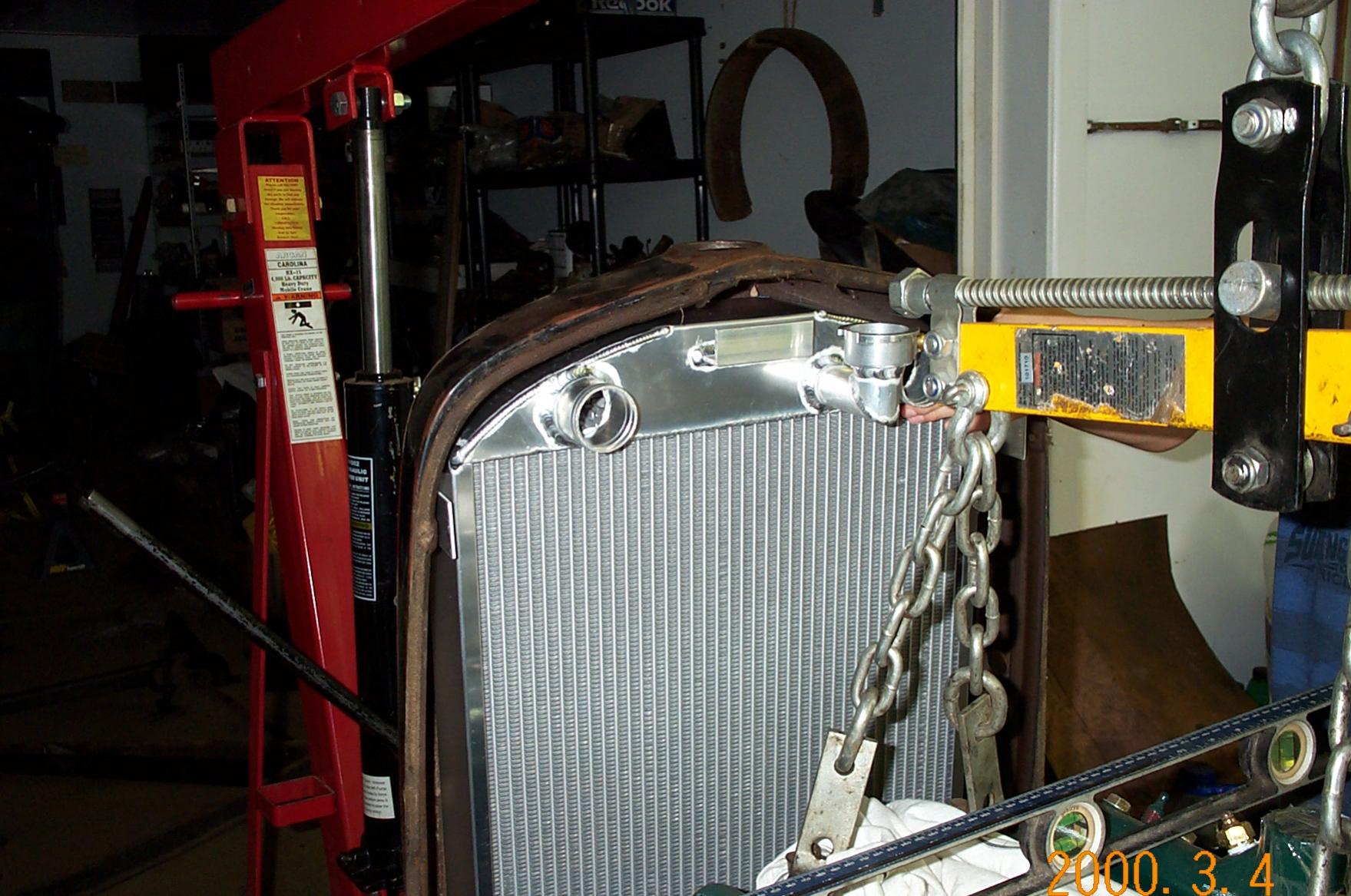

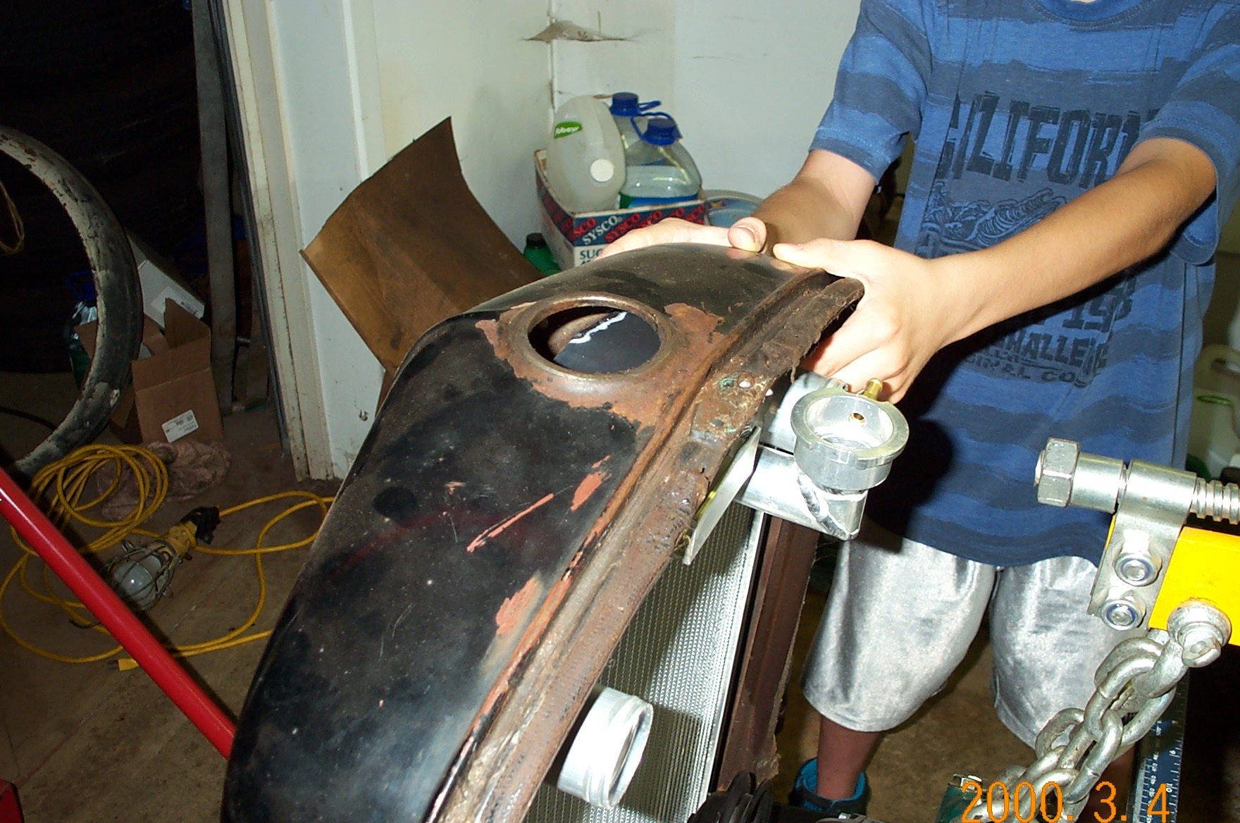

    The postal lady delivered my Superior rad this morning. After waiting almost 3 weeks for it to arrive!
    Boy, was I happy. Took it out of the box...did some quick mounting and added the shell and my heart sunk....it appeared not to fit. BIG BUMMER.
    Pictures of sending it back and waiting another 3 weeks raced through my mind....ugh!
    I took pictures..called Charlie at Superior. Sent him the pics and he wanted to know what was wrong. It's obvious what was wrong...the rad is to short. Then he calmly, simply pointed out their rad bottom tank does not drop below the mounting flange like the stock one does.
    Oh my....duh, red faced!!!!
    I went back out set it back on the frame added the grill shell.....everything lines up nicely. A little t******* on the mounting flange cause they are liberal with it...a litle tweaking of the shell mounting flanges and....have a happy day and remember not to panic!

    Put a few hours on fittin that rad in the frame.
    Seems we're making it way to complex cause we still haven't drilled a mounting hole?
    The new rad mounting flange is wider than the stock one and setting it w/o t******* the flange sides to settle into the mounting crossmember surface doesn't work so good.

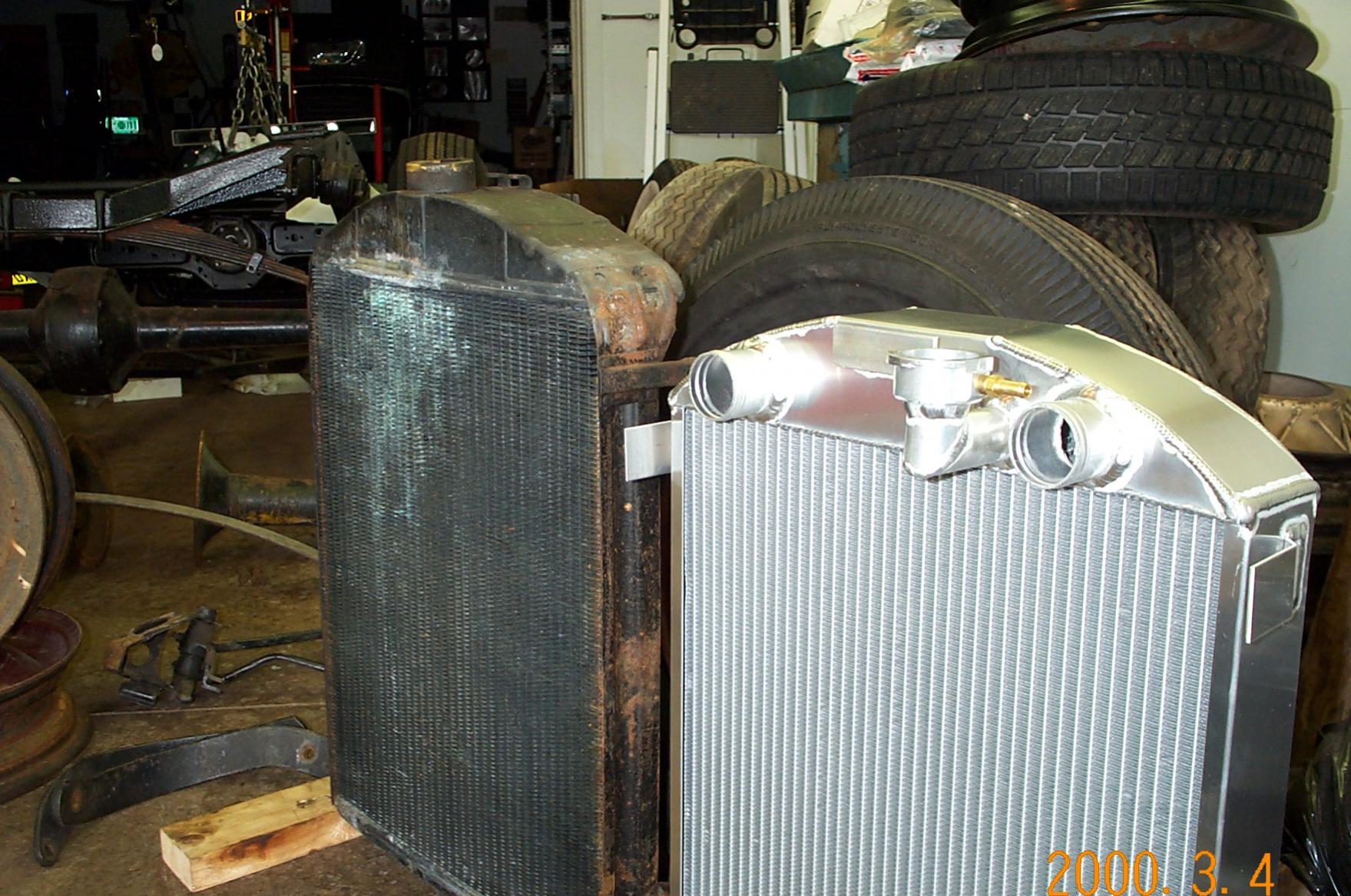

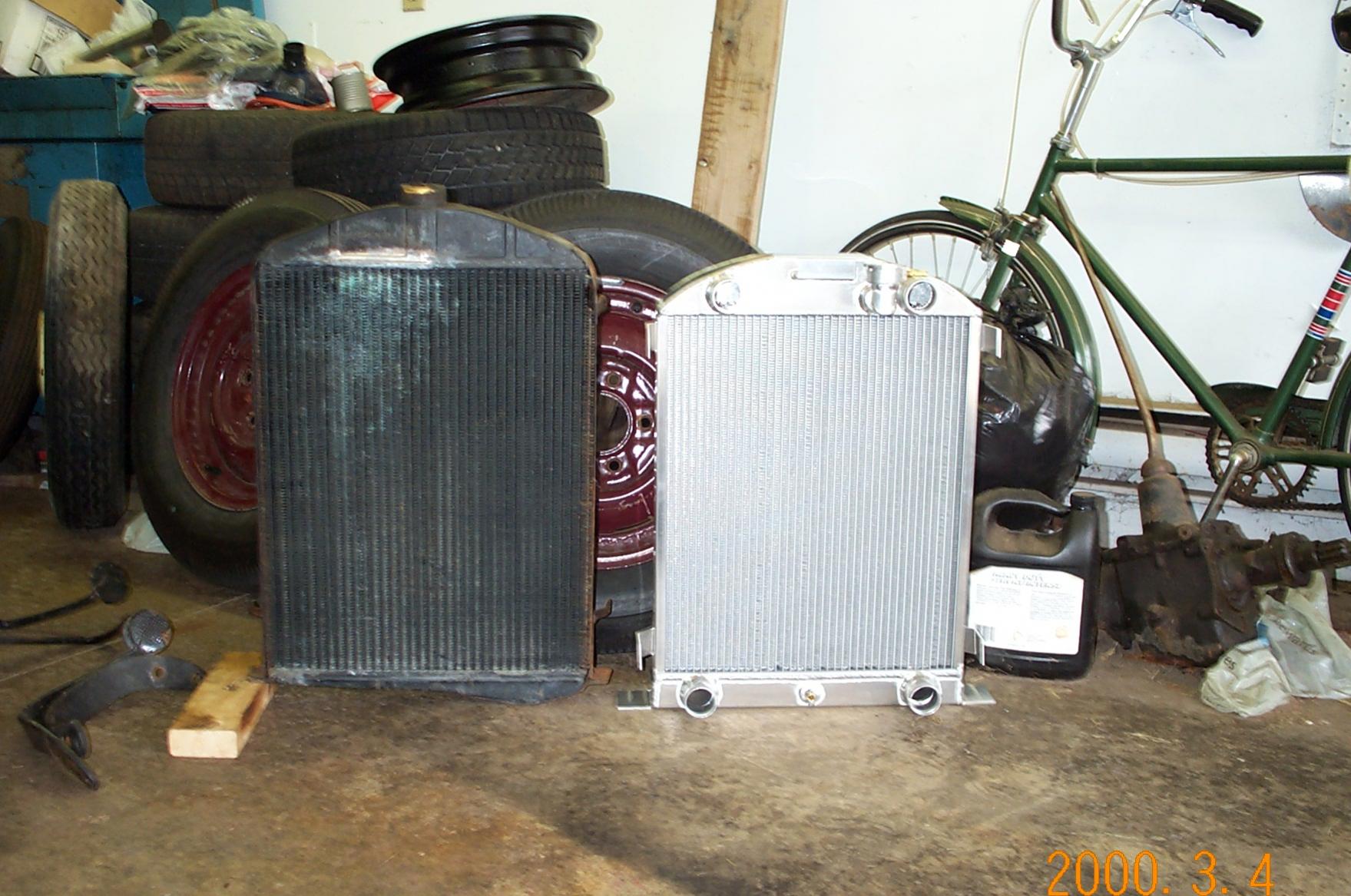

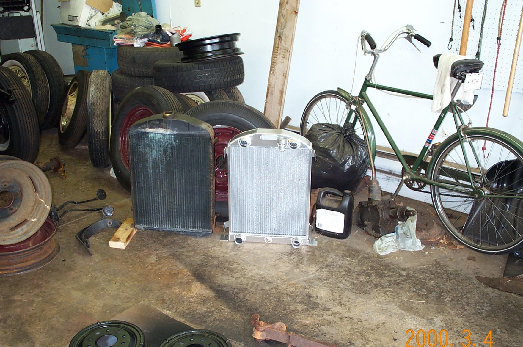

    Ok....need some help here.
    I have my rad from Superior. They built it with the lower tank above the mounting tabs/flange.
    As I see it...this now causes you to have to raise your engine up to try to even up the bottom water ports. This also causes the Tardel motor mounts to want to rise above the inside frame rail and in raising the front of the engine it pulls the trans mount away from the K member at the bottom?
    I can't be the first one attempting this.
    I'm using truck water pumps. I'm lining up the centre of the rad to the centre of the front crossmember. The rad shell fits like it does with the stock 4 banger rad so I have to ***ume the hood will line up correctly. I do not have the cab body on yet to see if there will be clearance issues there?
    Ideas/suggestions?

    One more item forgot to mention.
    I am not able to align the crank hole with the pulley centre as the pulley will then be hitting the bottom back and lip at the rear of the front crossmember.

    The rad is fine. Well, in the sense that it is going to work after I correctly set it in place. The rad shell helps because it sits on the frame like it did wit the 4 cly rad.
    HOTRODPRIMER, I haven't pulled my firewall out....not sure I want to...so, maybe placing the cab on is my option.
    I was doing things the wrong way round.
    I now understand with the help of XIX32 what I was doing wrong, thanks Mark.
    This 59A engine was built with a AV8 '29 roadster in mind. I have '49 truck wide belt water pumps installed and a single crank pulley done up to mate up to the pumps.
    In this app, it no longer applies.
    I need '48 wide belt pumps and a stock 59A (double) pulley, which I have, to let me drop my engine to the correct height of 2 3/8" from the centre line of the crank pulley to the top of the frame rail.
    The back pulley will be behind the lip of the crossmember and the front pulley in the well of the crossmember and with the front pulley I can now add a gen/fan combo.
    So, all is right with the world again. Hey, that's hot rodding!
