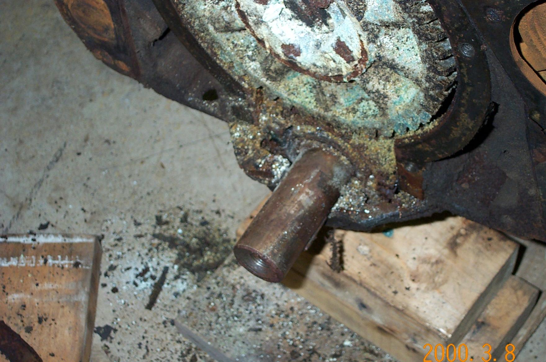

So here is the culprit. This what I have to get at and remove. Looks like I'll be pulling a pan.....ugh!!!!!!!
Yup... Pan off. No big deal .hopefully it's not too tight on there, and you can carefully tap it off. It's tricky, but persevere and you'll get it off without damaging the timing cover side of the rope seal.or you can use the opportunity to change to a full circle seal if you wish.

Alright, I'm still thinking about removing this crankshaft spacer sleeve. I'm trying to do this w/o getting into having to remove the pan and I've come up with this idea. If I remove the cam cover....I should have enough room to weld this piece on. Then use my puller and with any kind of luck.....it comes off.
Just pull the pan AND the cam cover, and tap it off! all this farting around drawing things and posting them on here..you could have had it off four times over. stop thinking...start doing! sheesh!
lowsquire.....the reason for this is I have been told by the engine builder that these don't necessarily come off that easy. He tells me they are cold pressed on and are tough to come off. Sorry for being so **** about it!
Yes they can be tight, but mainly if they have never been removed before. If you weld to it you will likely destroy the ropeseal from heat anyway .. Meaning pan off ! I just think it's worth trying first. Sorry if I sound harsh. Trying to help.
lowsquire....I know you are and I appreciate it. Sometimes I overthink things when I am not able to do something right away. The spacer has not been off the crank....so, I expect it to give me all the trouble it can!
Yes, I pounded on it for a good 15 mins. At first it wouldn't budge but I gave it a couple of really hard smacks and I saw it move. It fought me all the way off. I just hope I can seal up the front and rear and pan again! I don't like how the two sides of the gasket came off the rails of the block at the very back. They were stuck on there pretty good.
