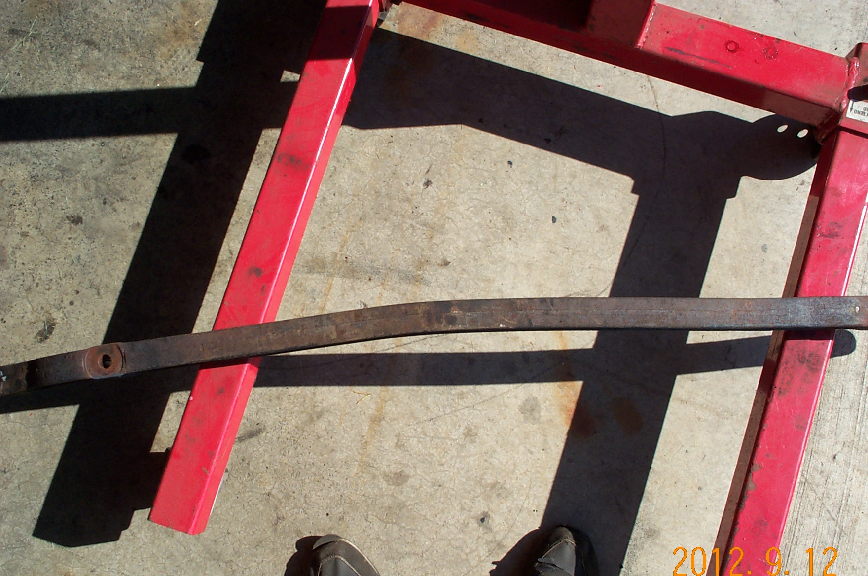

    Speaking of which.......I removed, blasted and painted all the leaves of the '32 pack.
    I took the main leaf to my spring shop and had them reverse eye.
    Got it home and Oh, oh! it's to short. Great, now what?
    I take the full pack back to my spring shop along with one old extra '32 bell.
    I had taken the measurment from centre to centre on the bell spring perchs...... very close to 47 1/2".....the spring is like 43".
    After a lengthy discussion and head scratching we came up with....get my '34 rear spring pack tear it down and use the main leaf from it and not reverse eye but remove lots of leaves.
    I get home and tear the '34 pack apart and guess what.....yup, the main leaf is almost identical in length (attached pic) as the reverse eye '32 main leaf. Once I had all the leaves off the '34 pack and the main was still attached to the axle I noticed it seemed awful flat and pressing down on it it still had not much give.
    This tells me:
    a) the spring shop did right on the reverse eye
    b) it streches that much
    c) I can use the reverse eye leaf as is along with the rest of the '32 spring pack.
    Right now, I'm a happy camper again!:)

    More '34 main leaf spring info.
    Seems that after closer inspection.....the '34 has a bigger arch as well.
    This allows for the stretching to get it over to the other spring perch.
    My '32 with reverse eye has lost that arch and will only flatten, which may not work.
    I've now decided to wait until my driveline is installed to configure my rear spring setup.
