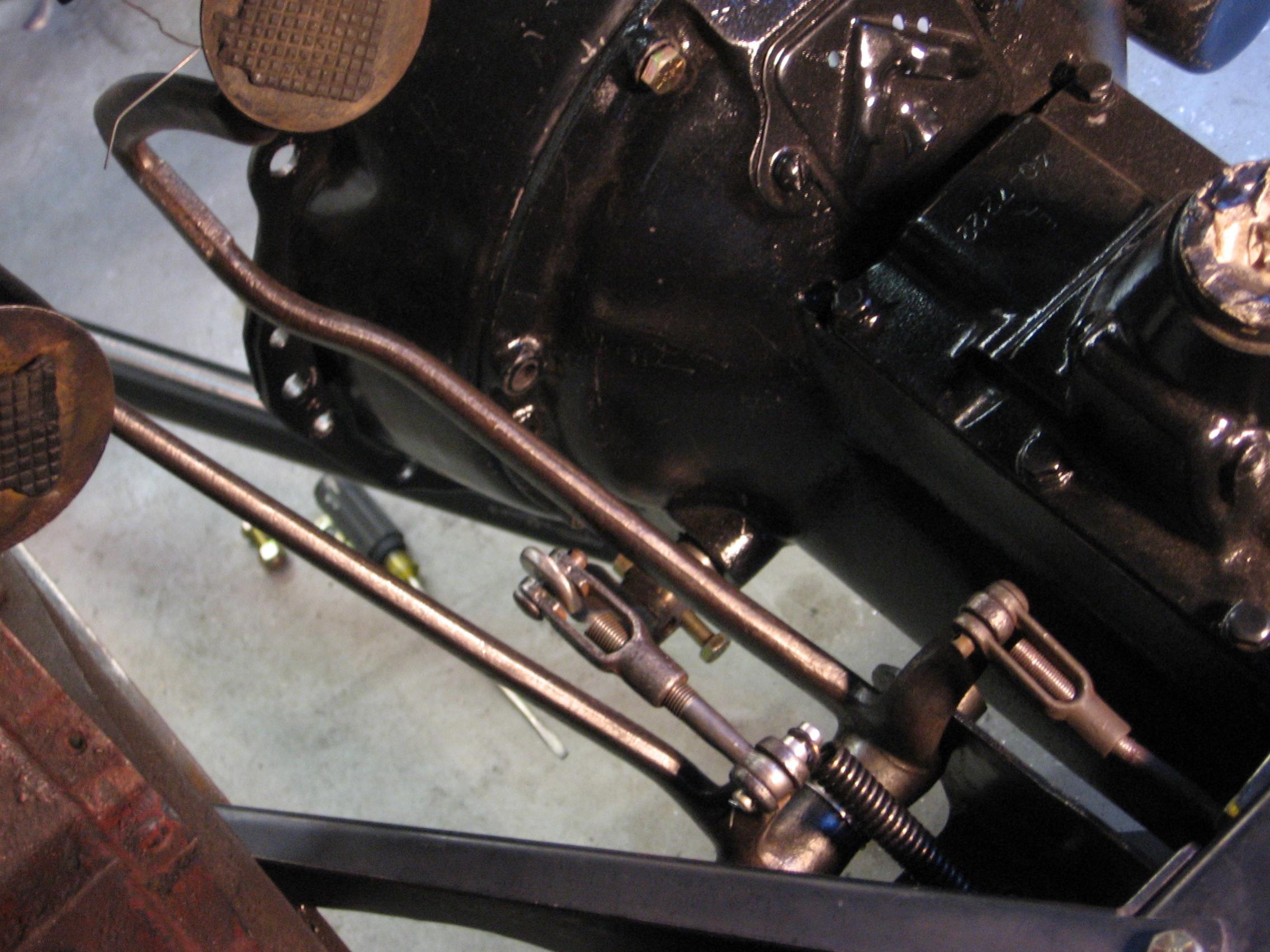

    Here's a few pics for ya. This one is slipped in from left side. If you slipped it thru the right side, the middle hole for the release fork would be off. You would need to fill and redrill it...no biggie.
    The lever leans toward the rear about 25 degrees when the hole for the release fork is vertical.

    Here's a pic of one installed with 32 pedals on a 32 "k" member. It's quite a bit different than a 39.

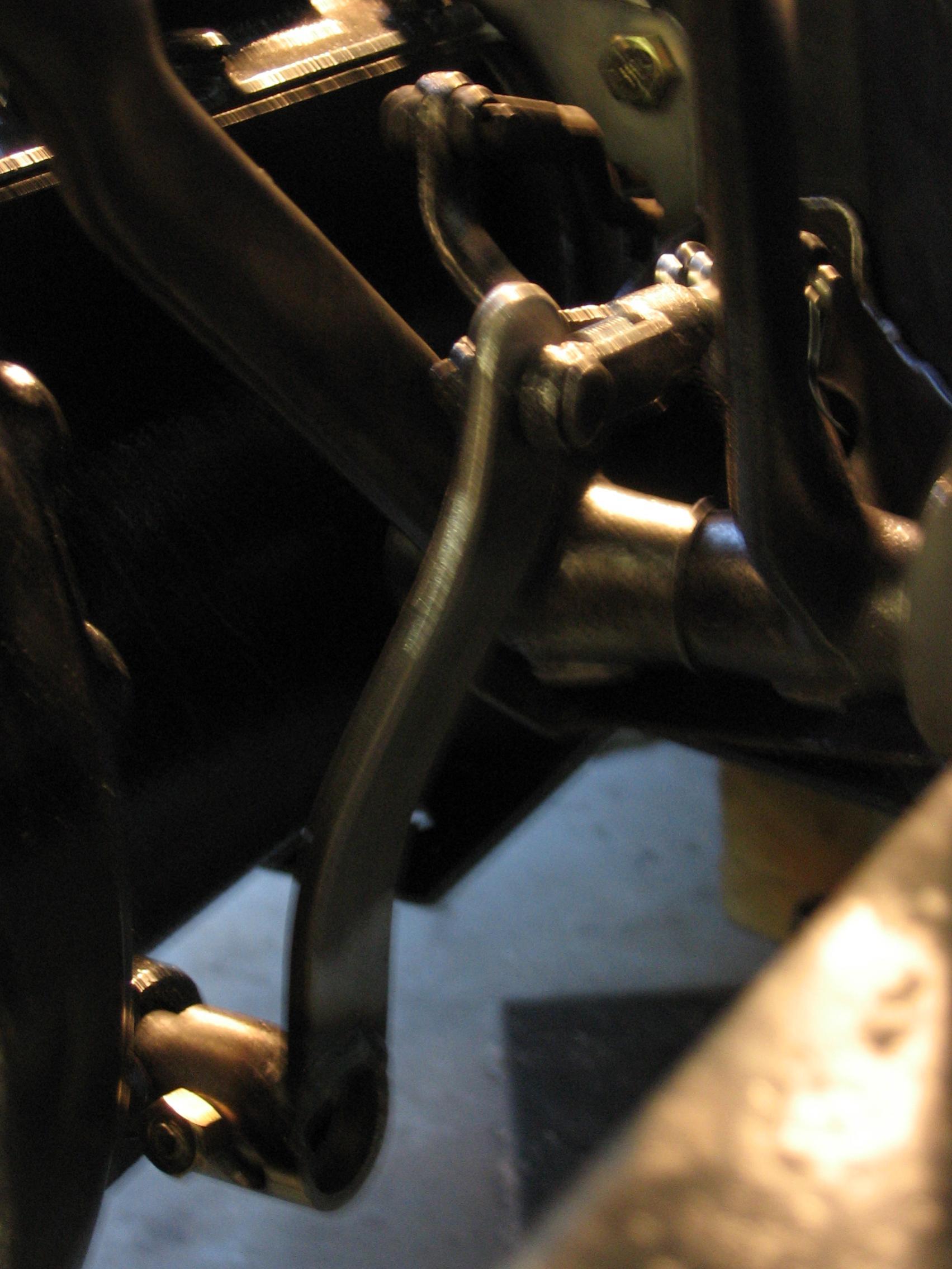

    I just took some snaps of my gennie RHD 32 clutch setup. This is all 32 stuff in a 32 ch***is.
    The rhd setup is a bit simpler than LHD, effective lever length is the same as far as I can tell, but with less sideways offset.
    I tried to measure the length, and I would say it matches the dimension quoted above.
    Mart.

    Grim,
    Looking at Mart's excellent pics, I can see there's almost no offset if any to the arm so it would be quite easy to fabricate if you use the length and 30 deg rotation shown on my sketch. You could even use a small piece of 5/16" i.d. tube at the clevis end and put some taper and shape to the flat bar for a more period look.

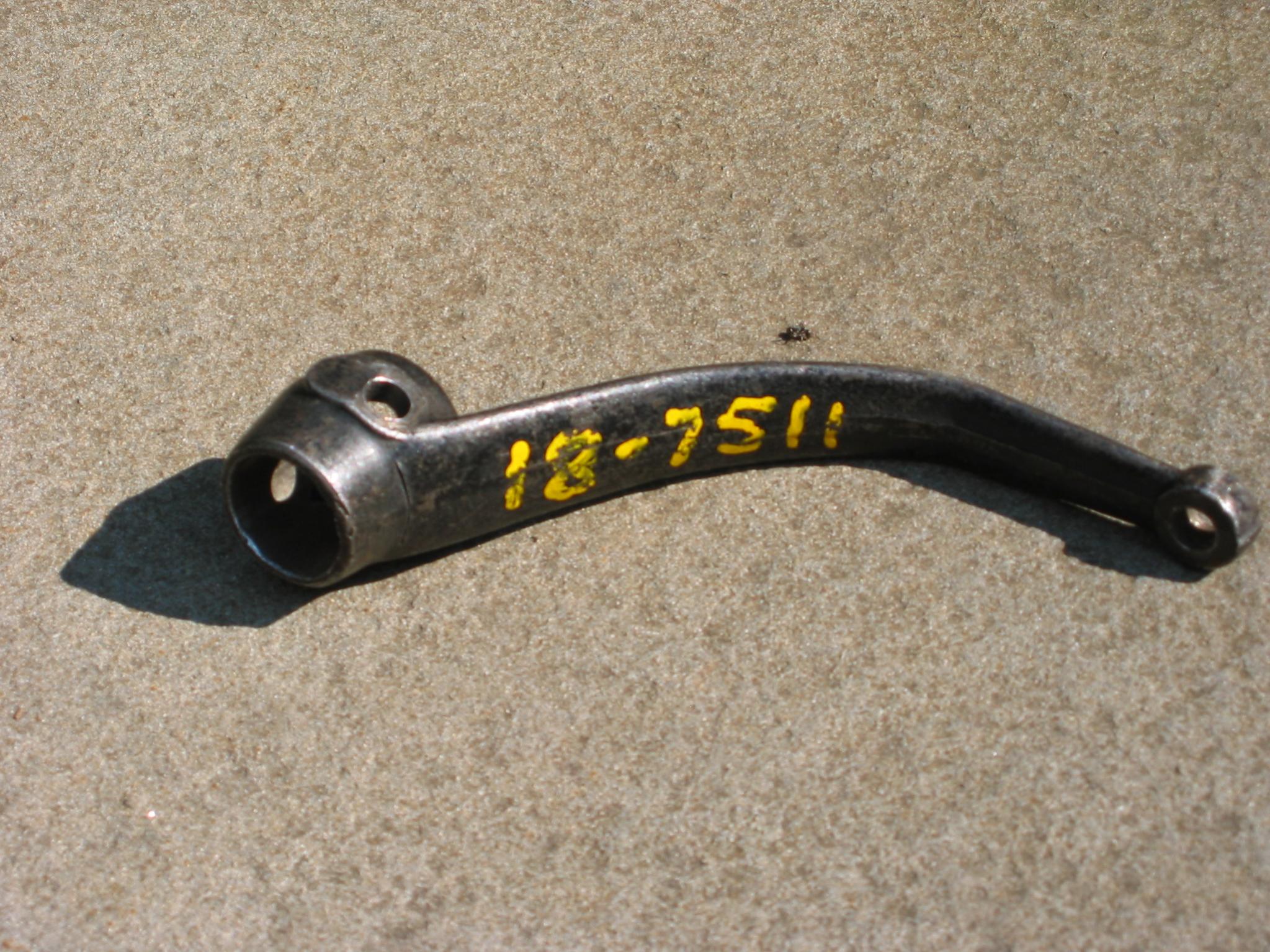

    These pics might help the 32 arm is about 4-3/4" centre to centre the other arm which is a '37 to '39 I think is about 3-3/8 centre to centre. The orientation of the pin I slightly different. I think I would get two '37 to '39 arms and do a cut and join.
    Al.

    32 clutch arm without the pedales.
