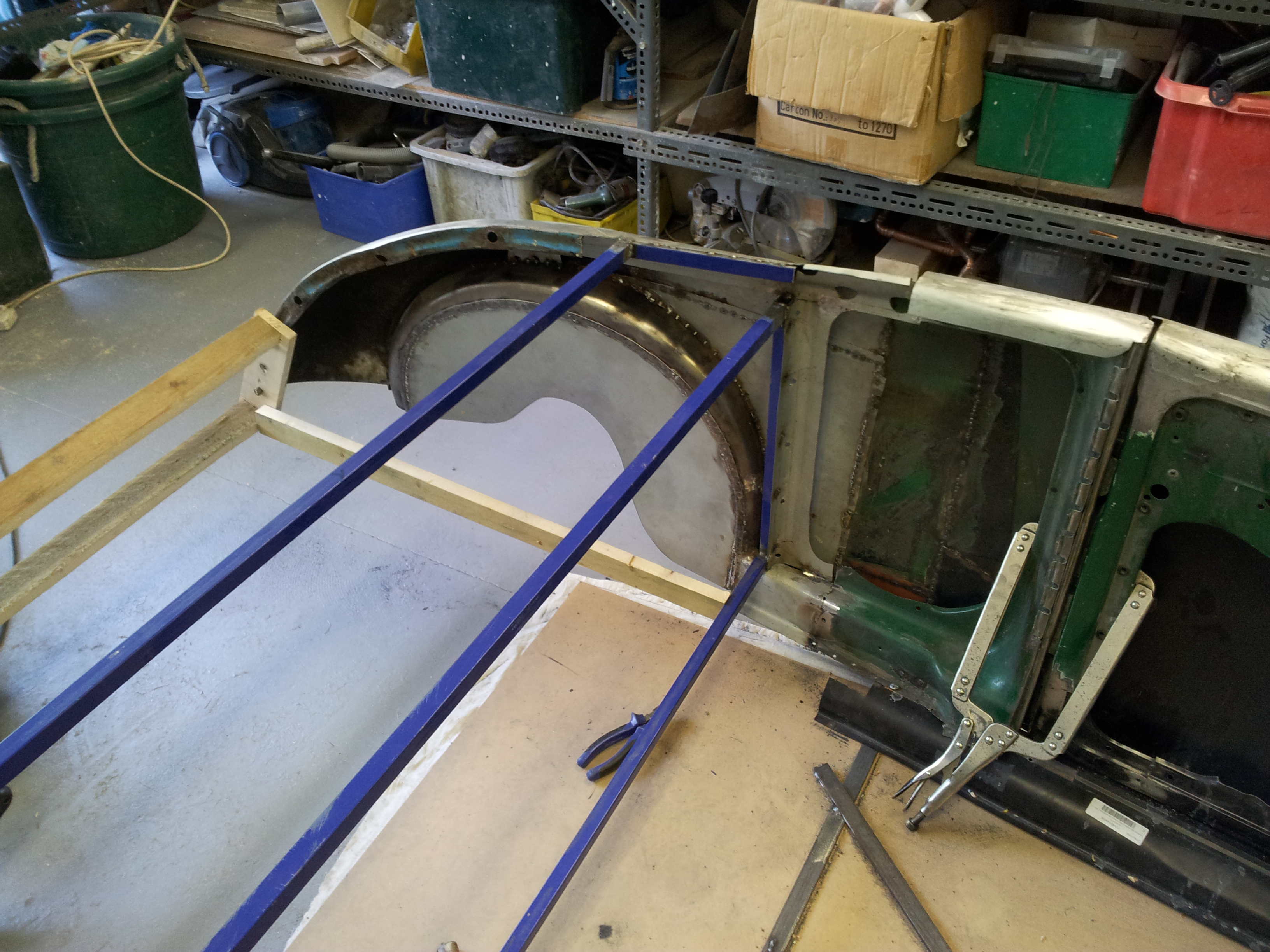

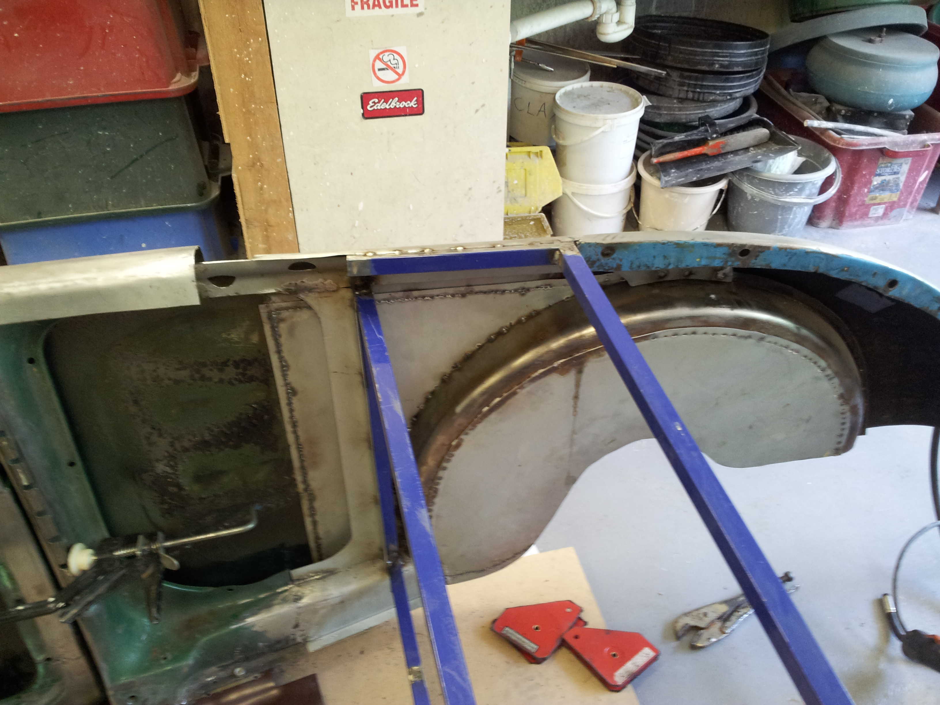

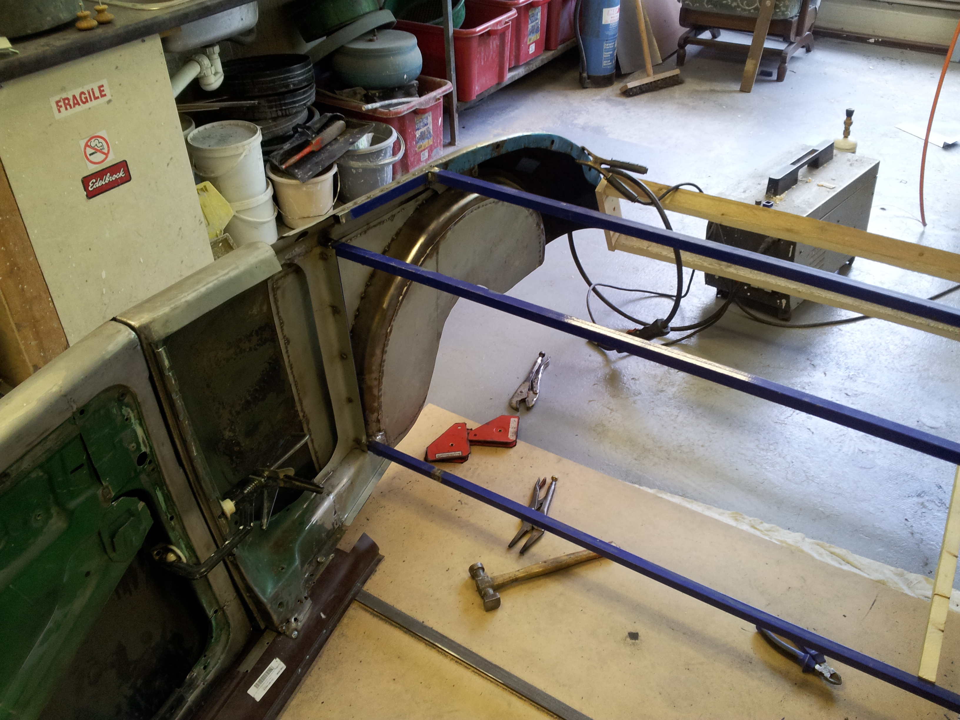

    Ok, so I constructed a framework of tubing in the position of the rear bulkhead and also to take the upper deck panel. 20130523_144612a.jpg 20130523_144619a.jpg 20130523_144629a.jpg

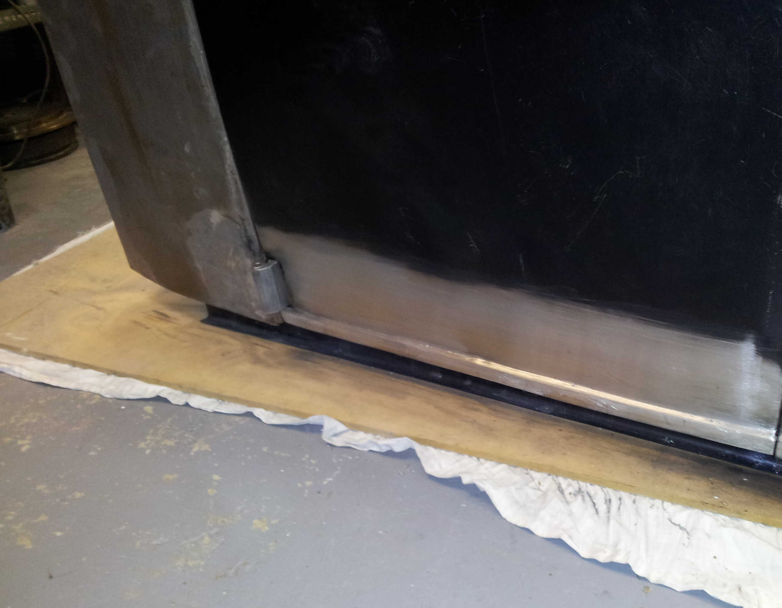

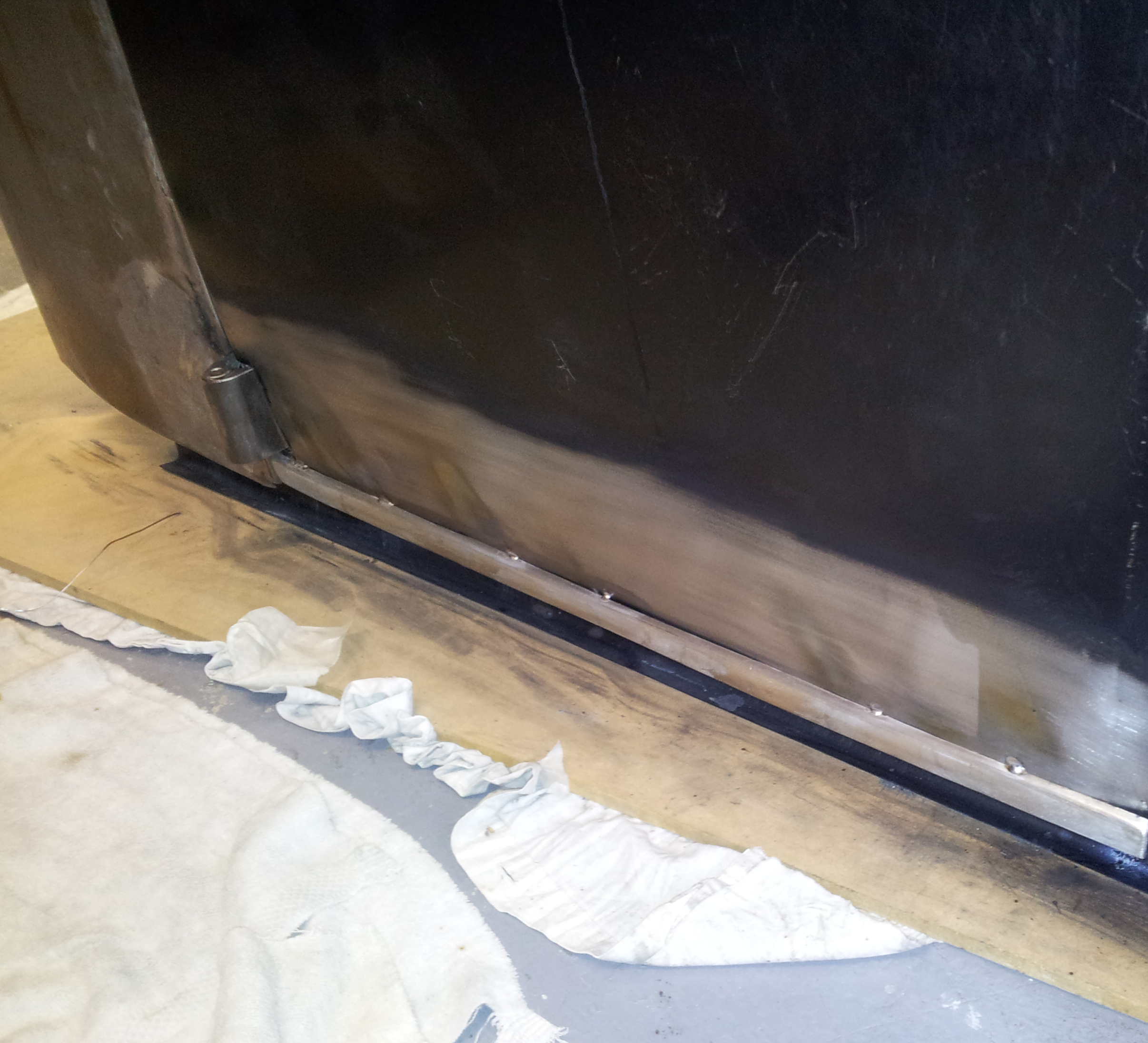

    For the upper deck lid panel, I got my local sheet metal shop to put a couple of folds in a piece of sheet steel. It's the only time I got some work done elsewhere. 20130524_112541a.jpg
    This panel then sits on the frame that I had previously installed.
