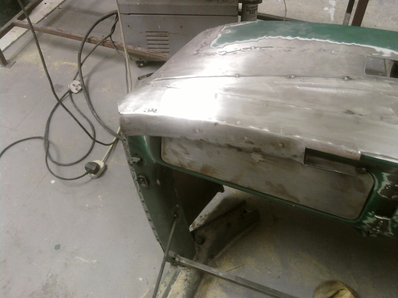

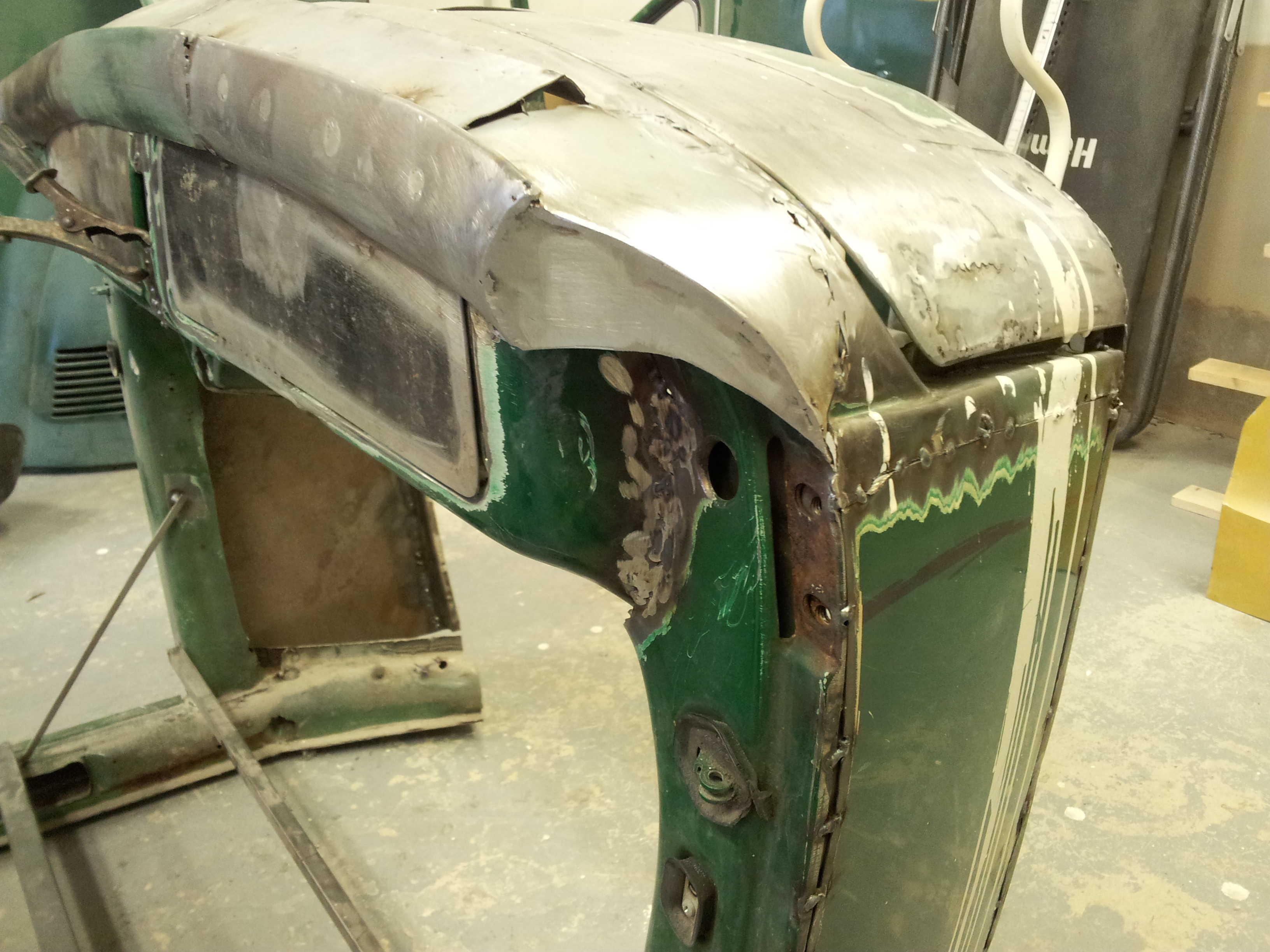

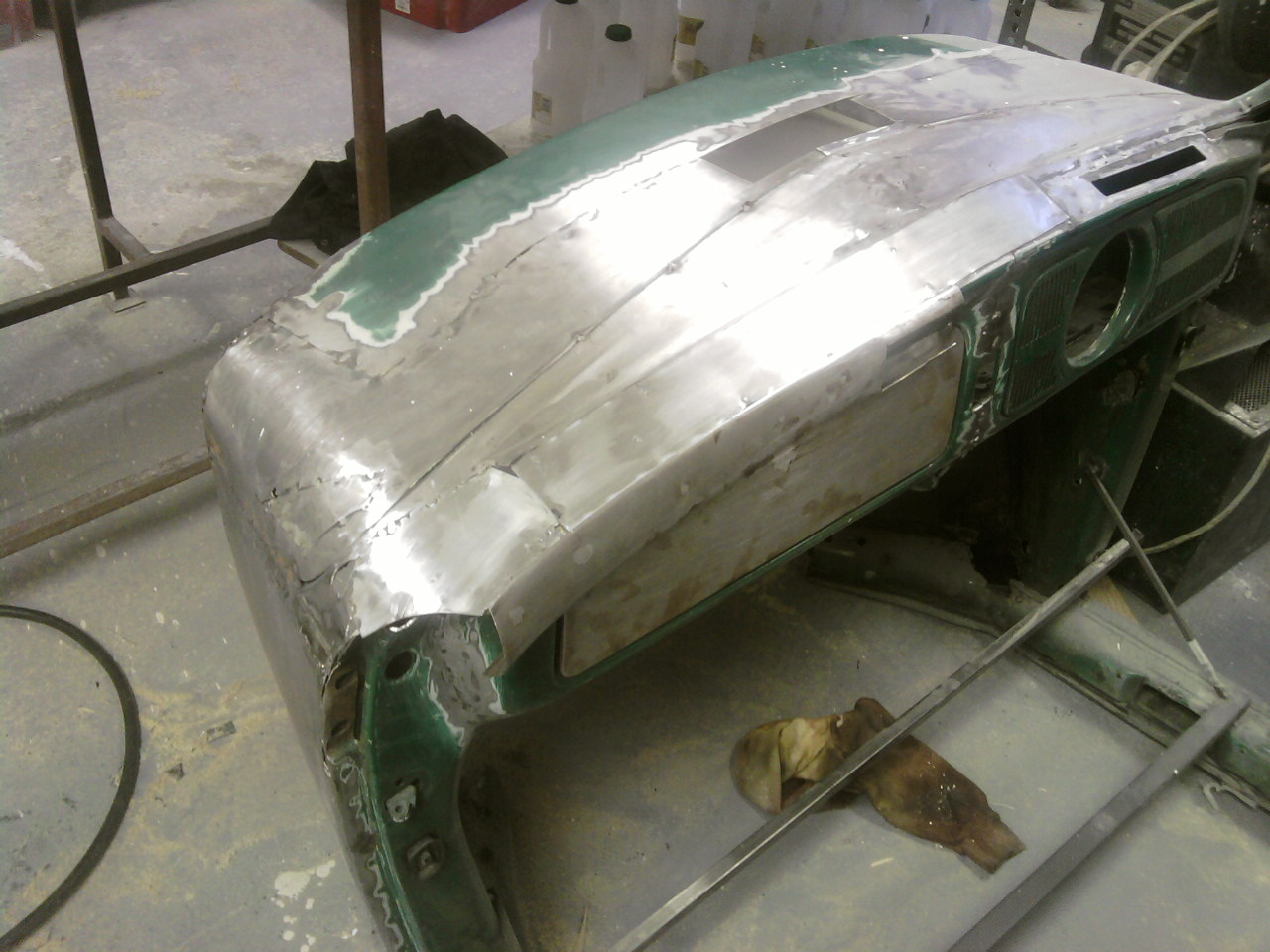

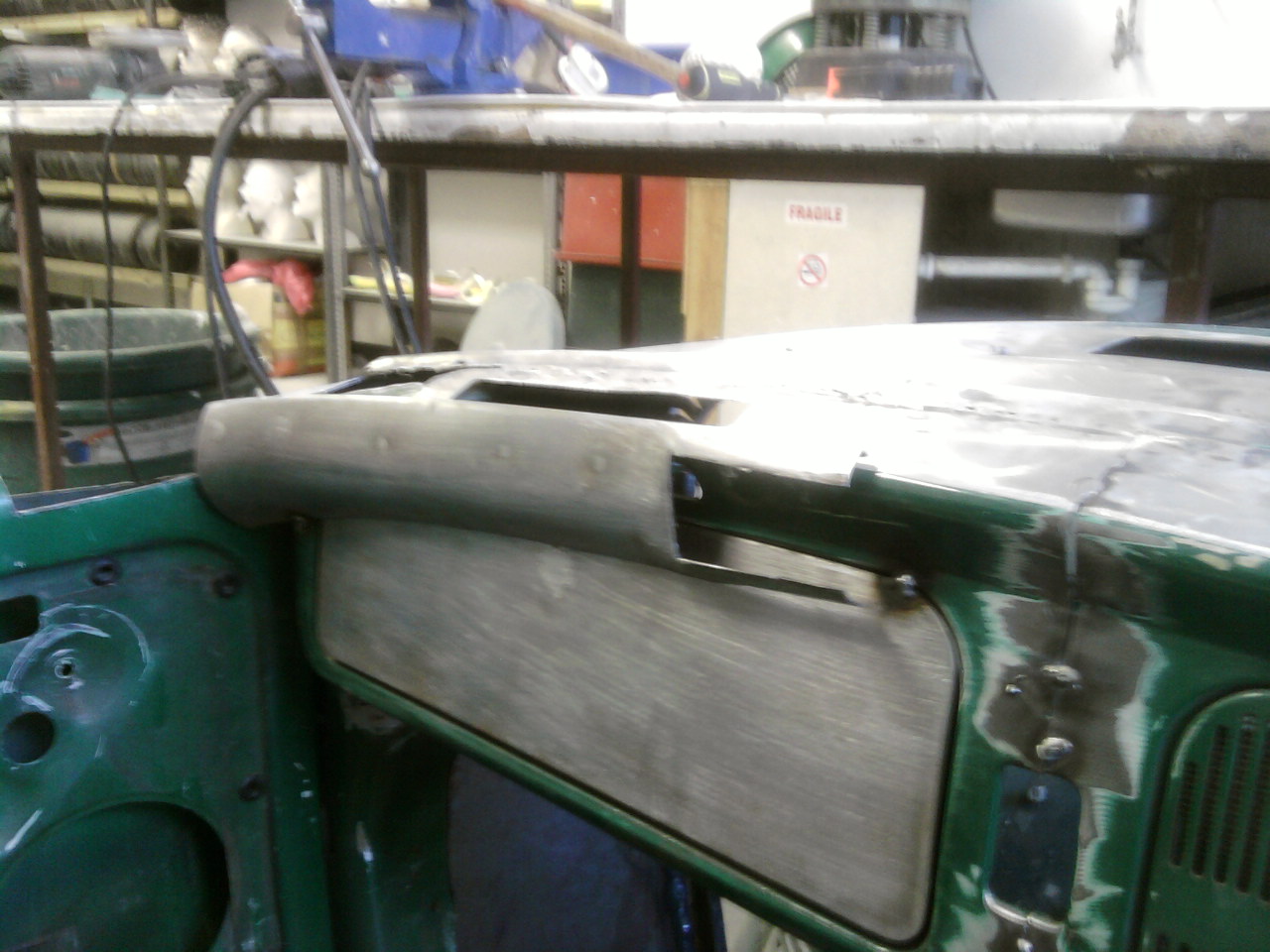

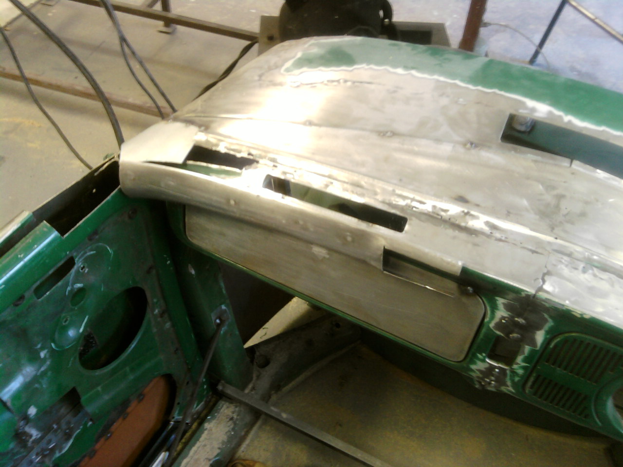

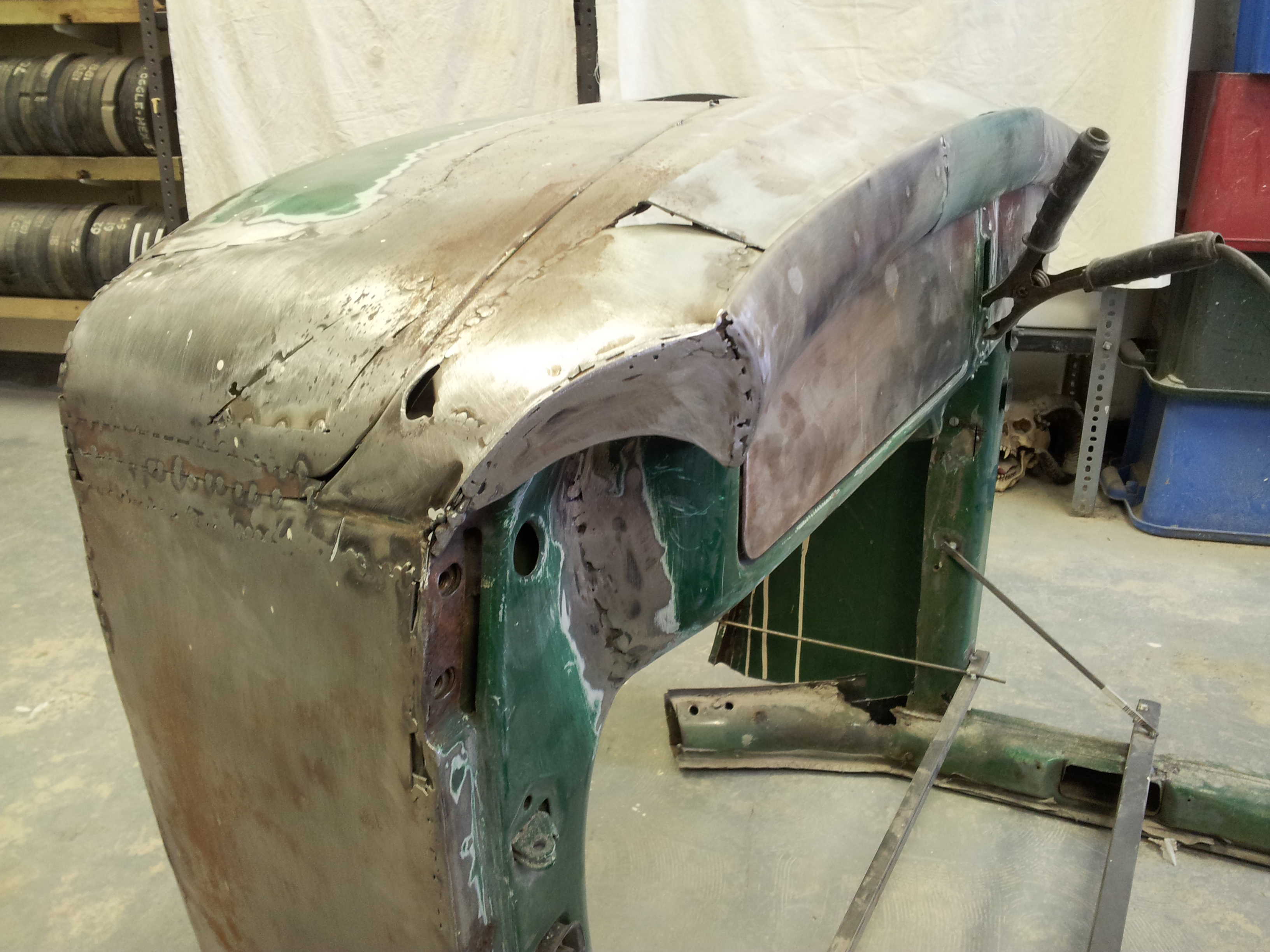

    Next I tackled the area where the screen post had been.
    To create the shape that runs across the top of the dash, I used the piece of the Beetle that runs across the top of the windscreen. SP_A0371.jpg SP_A0372.jpg SP_A0373.jpg SP_A0374.jpg SP_A0376.jpg SP_A0377.jpg SP_A0378.jpg SP_A0379.jpg

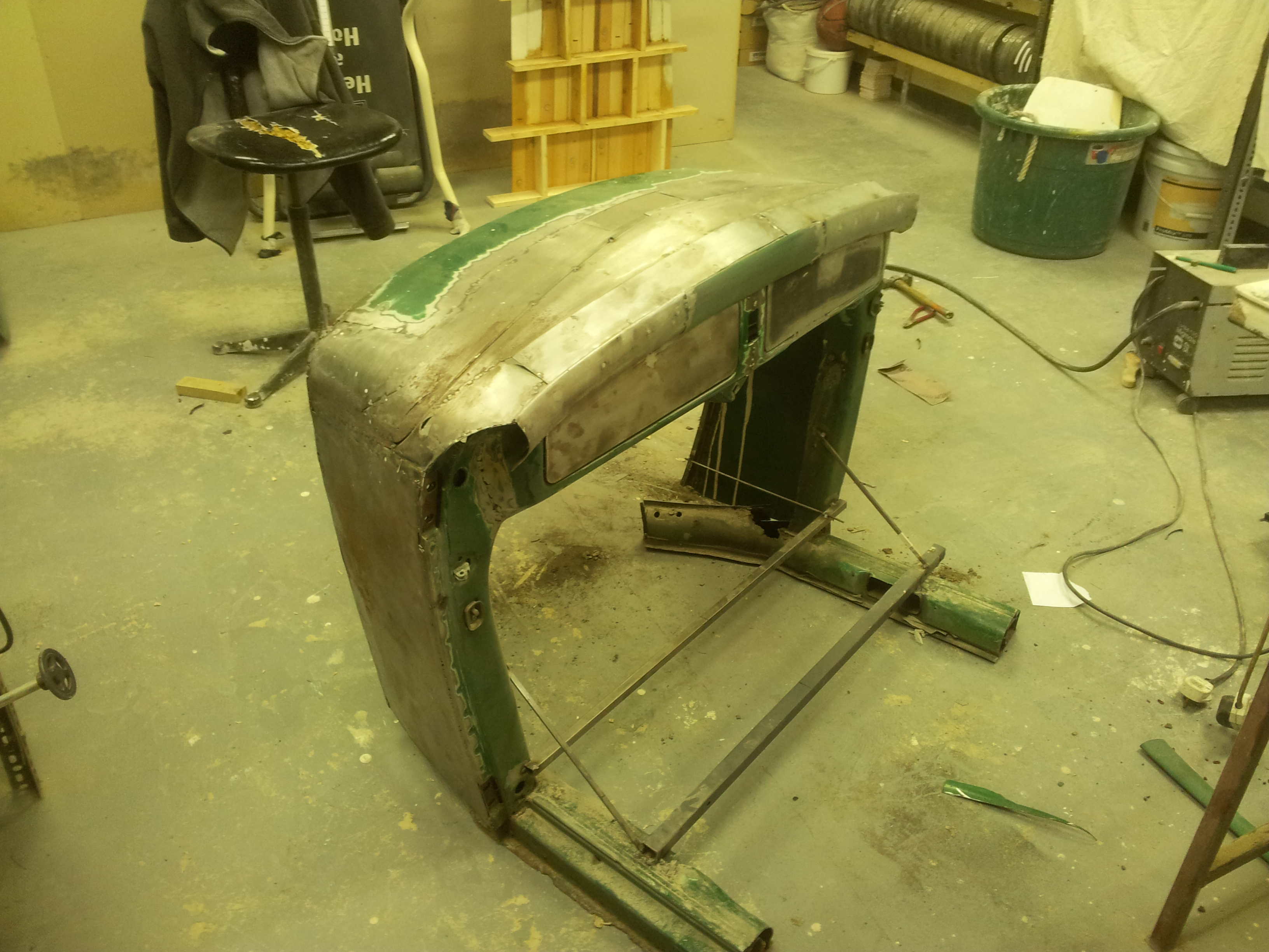

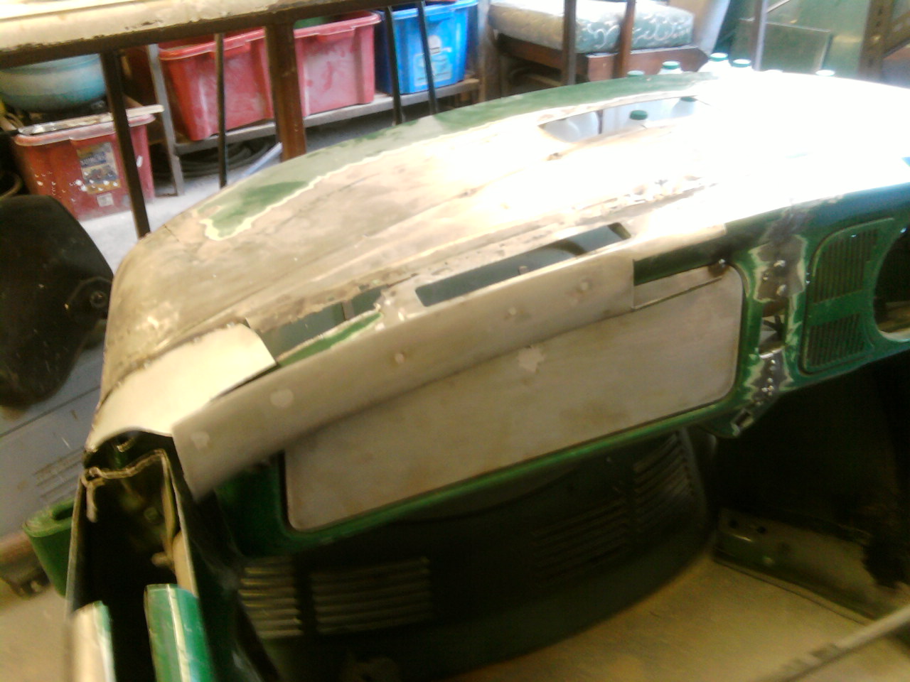

    I bought a glovebox door from your side of the pond Stu, then welded it in to make a flat dash, so this car could be left hand drive. 20120211_121310a.jpg

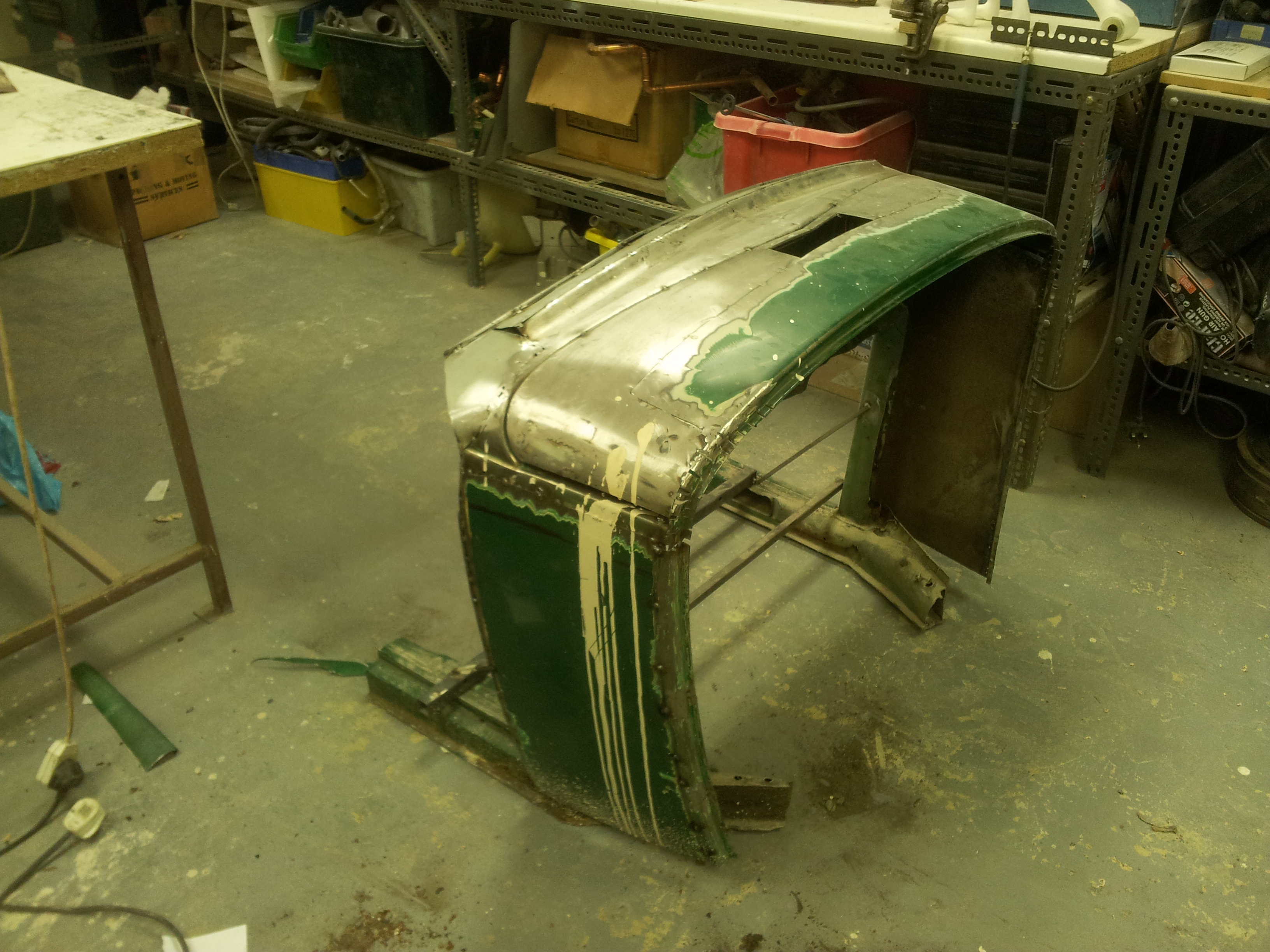

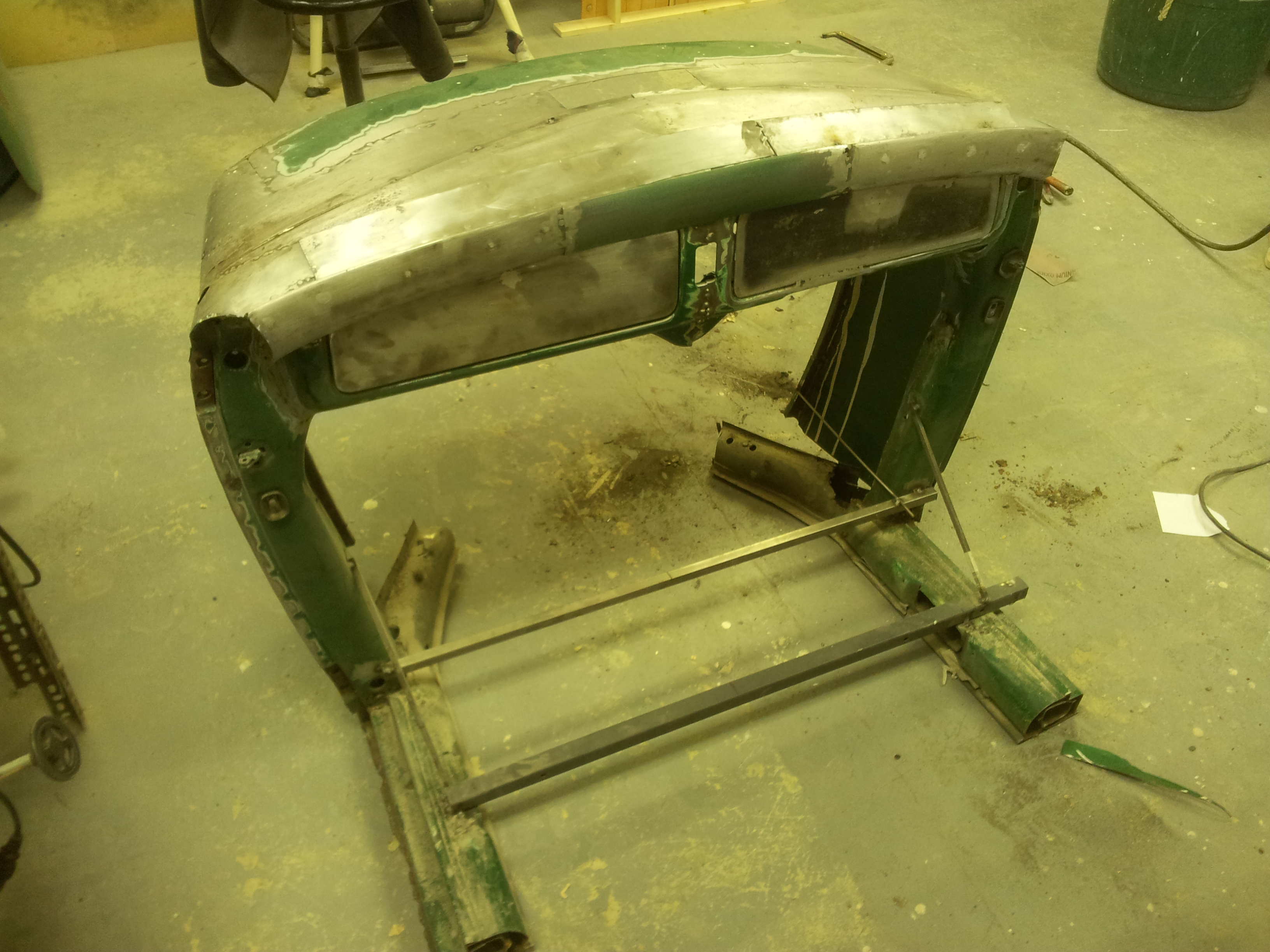

    20120211_184622a.jpg 20120211_184641a.jpg 20120211_184706a.jpg 20120218_134105a.jpg 20120218_144206a.jpg 20120218_181147a.jpg 20120222_145452a.jpg
