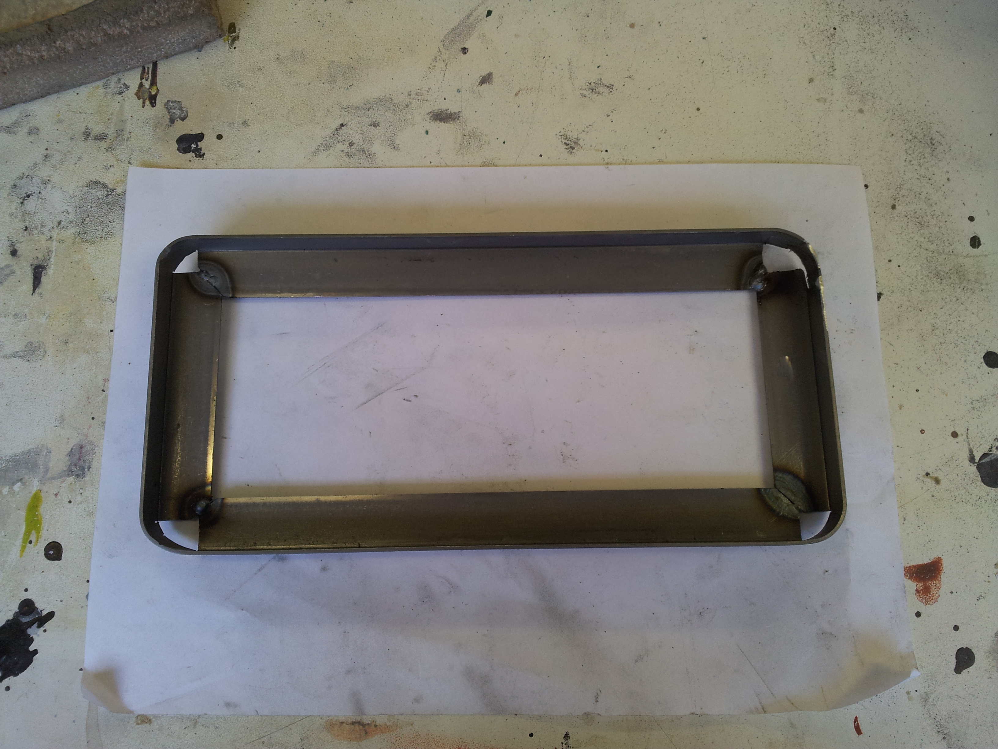

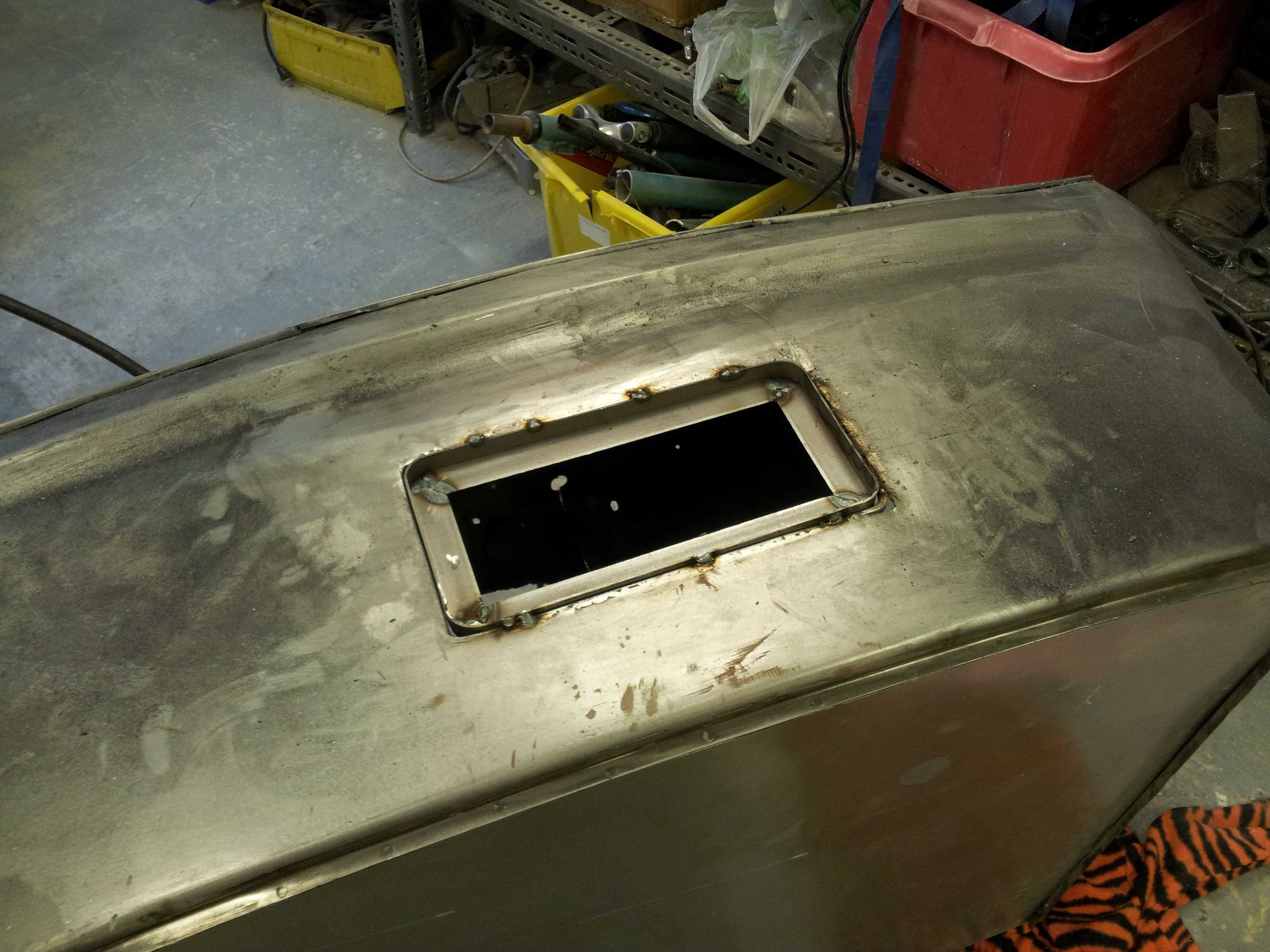

    I notched a piece of angle then bent it into shape.
  3. english gent
    Joined: Jun 20, 2012
    Posts: 226
    english gent
    from England

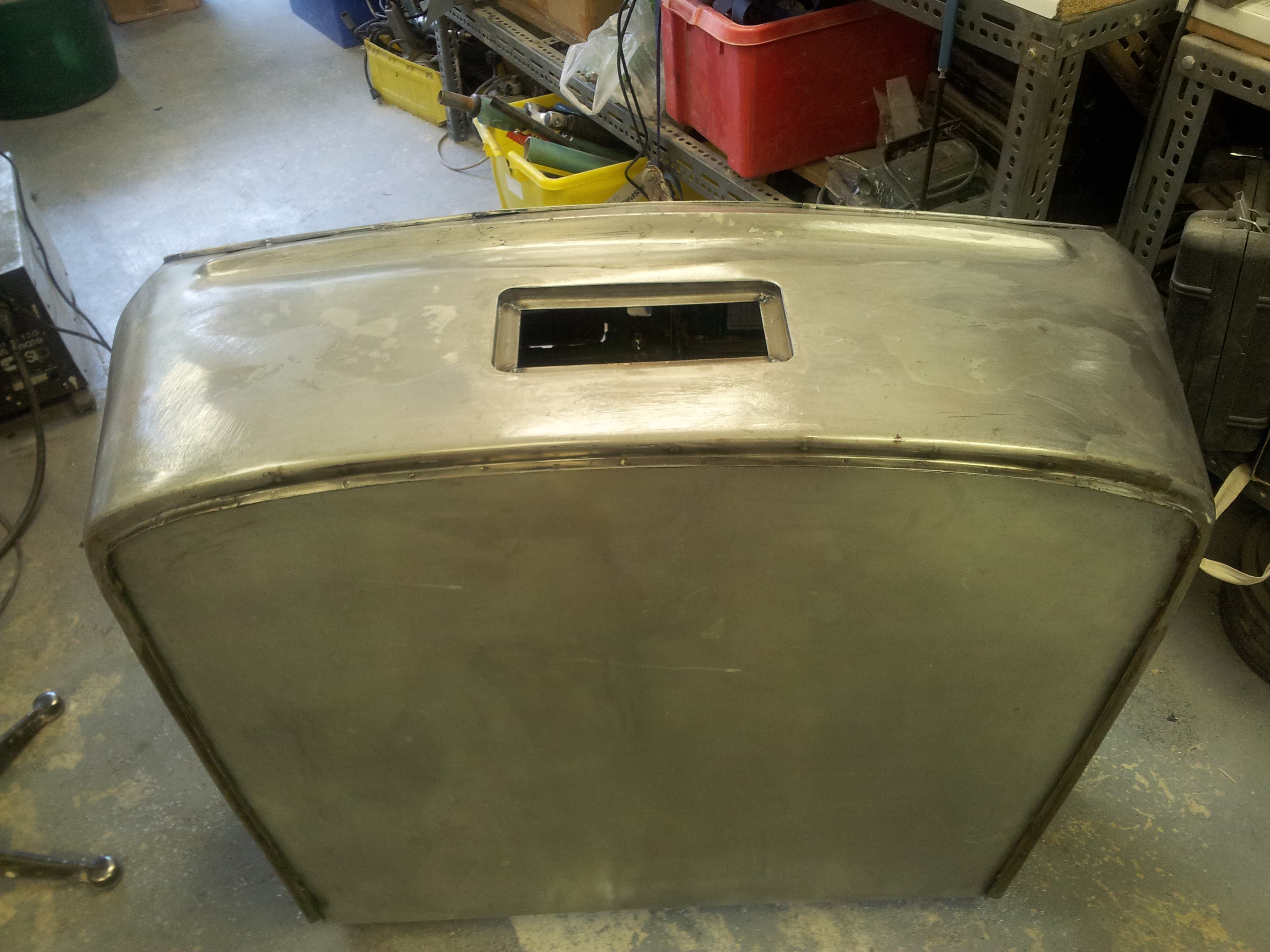

    I then dropped this 'tray' into the hole for the cowl vent. 20120922_173454a.jpg

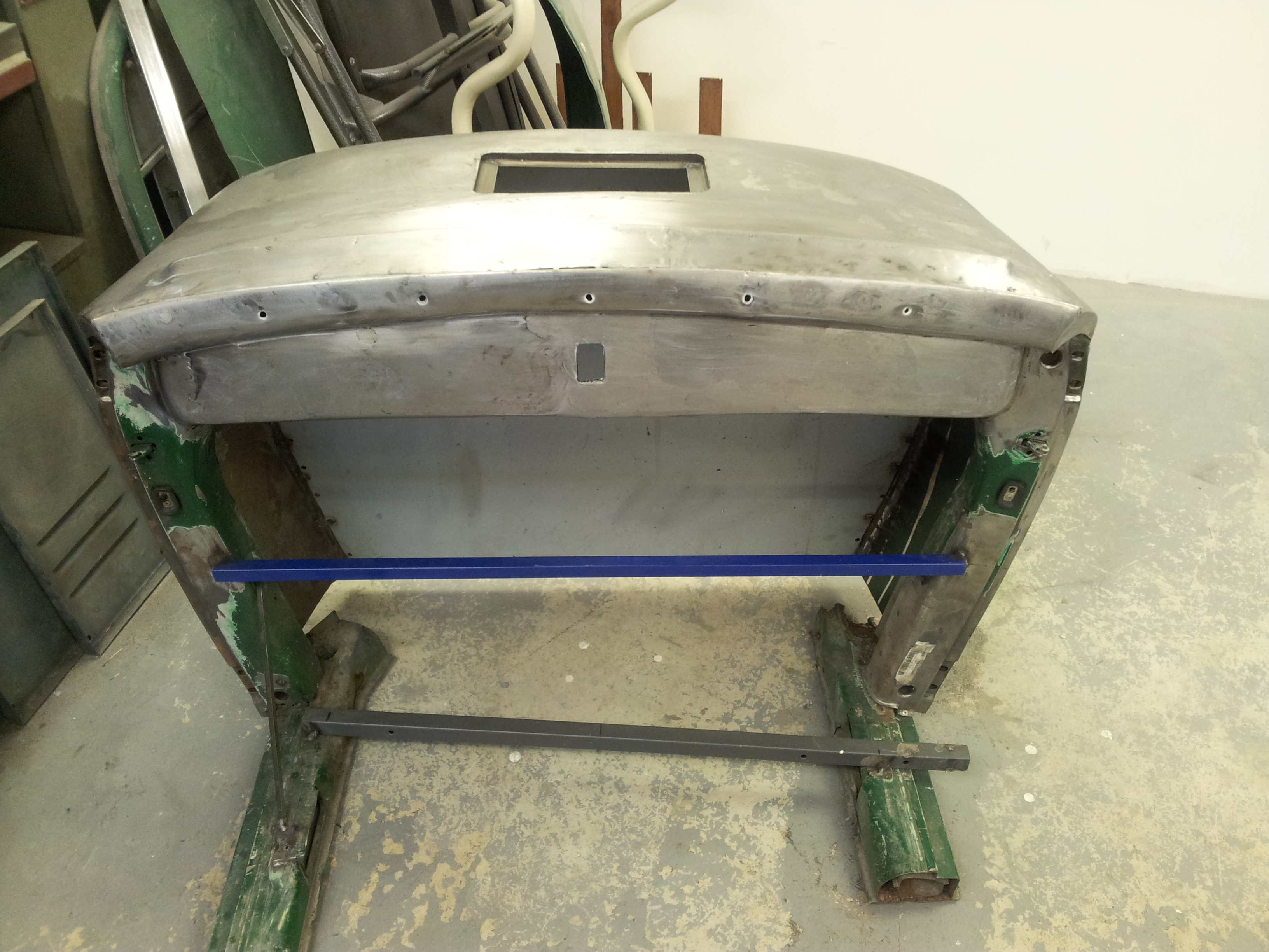

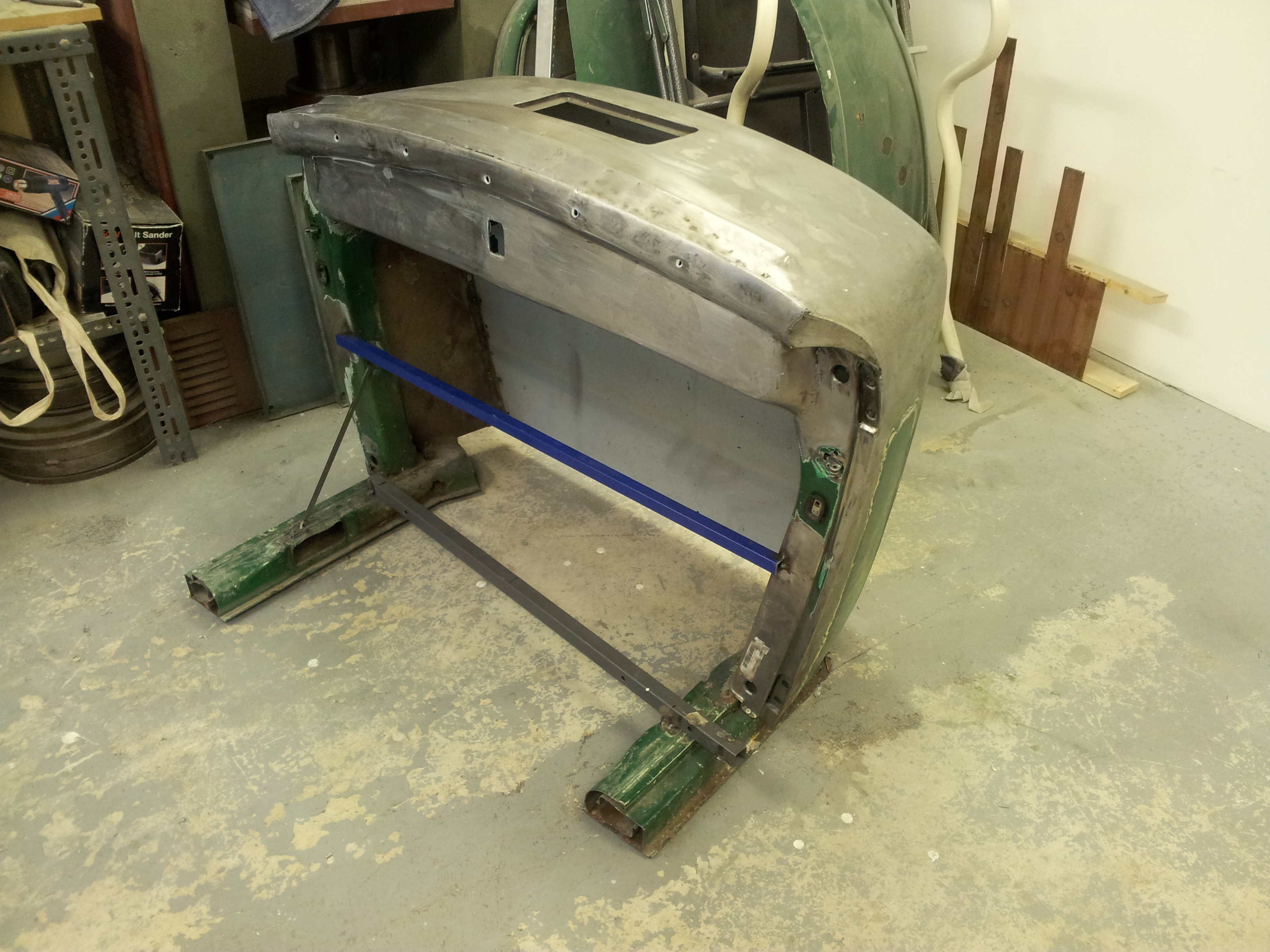

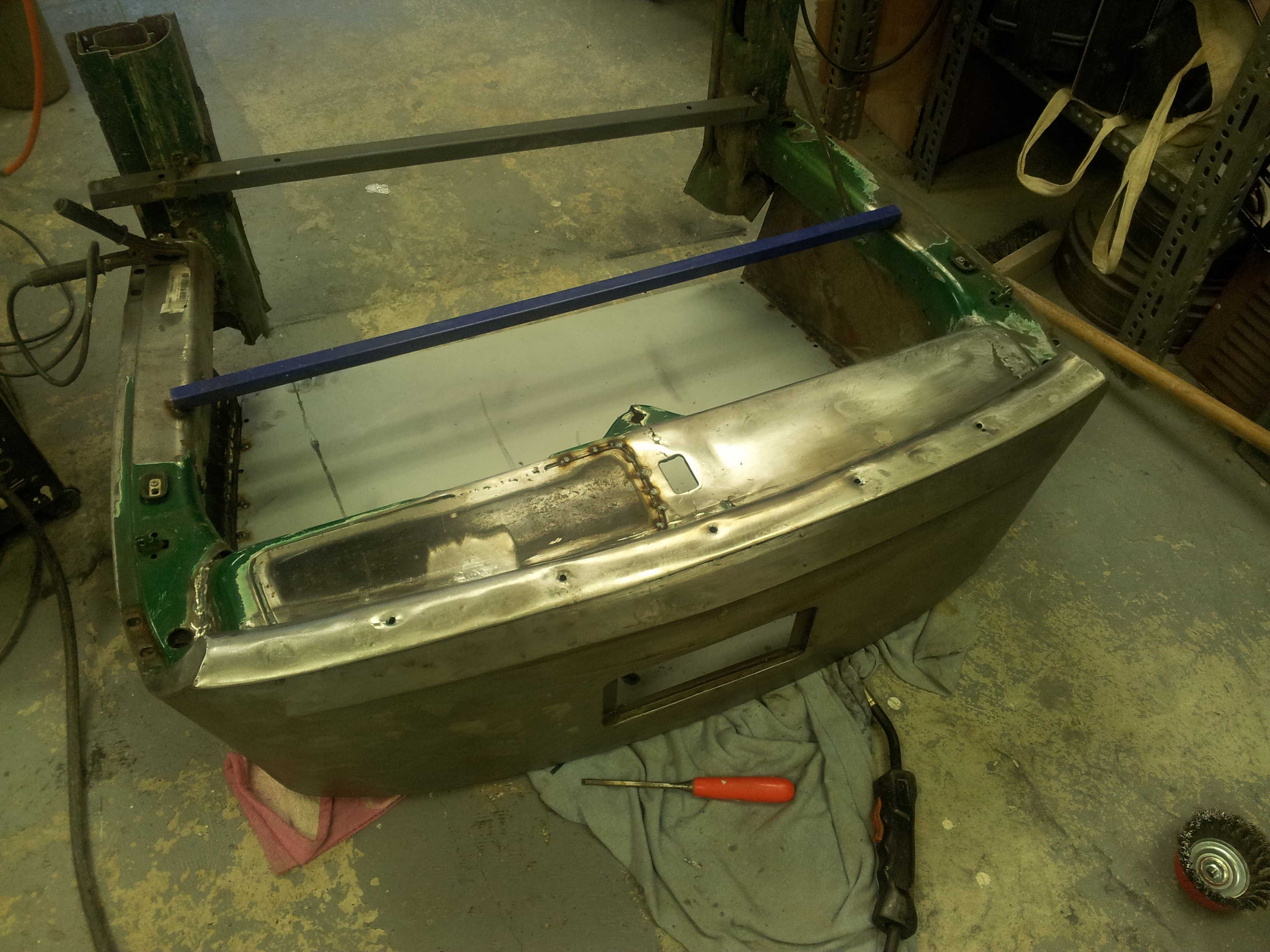

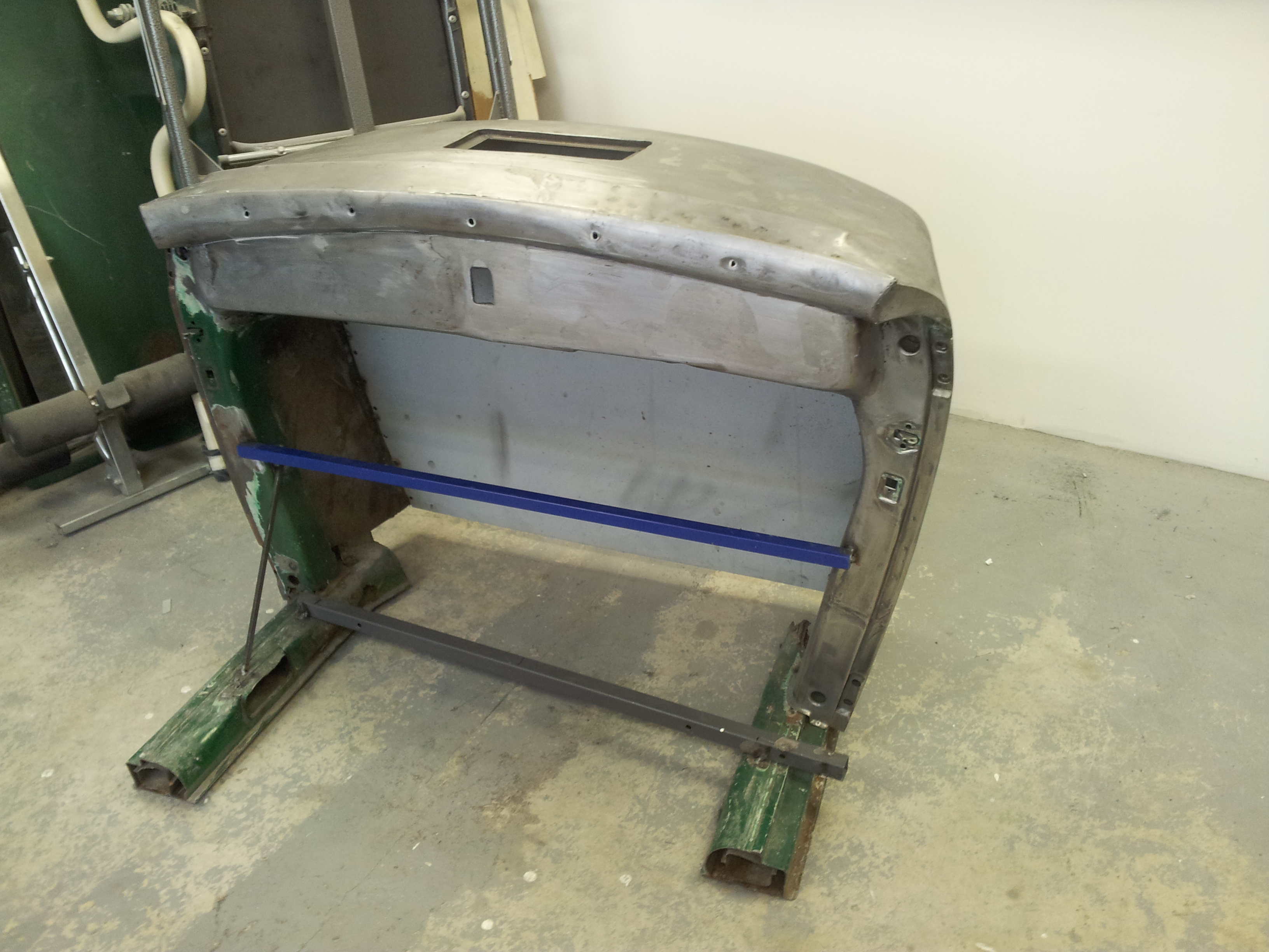

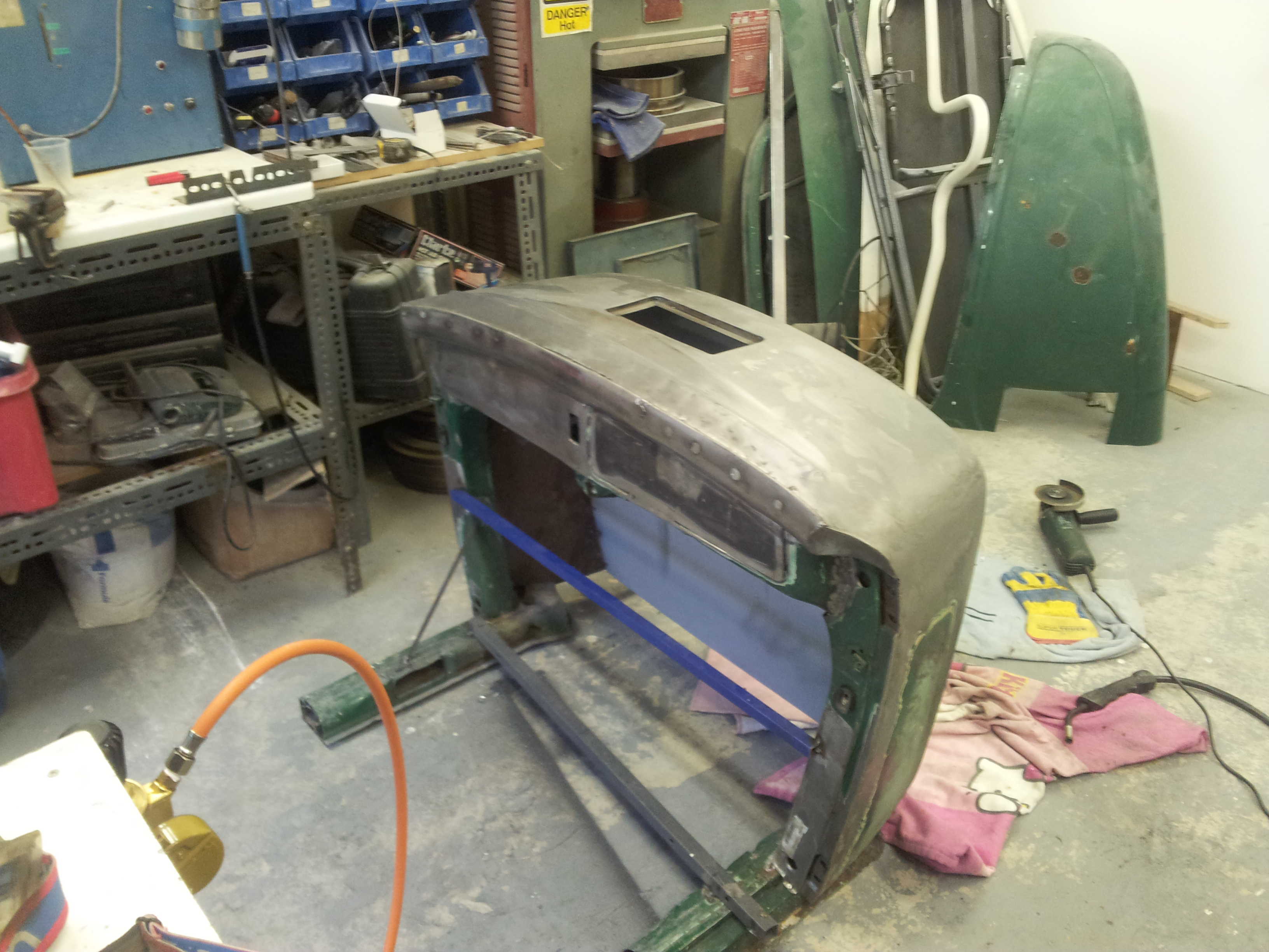

    20121001_131717a.jpg 20121003_145352a.jpg 20121003_145402a.jpg 20121004_145545a.jpg

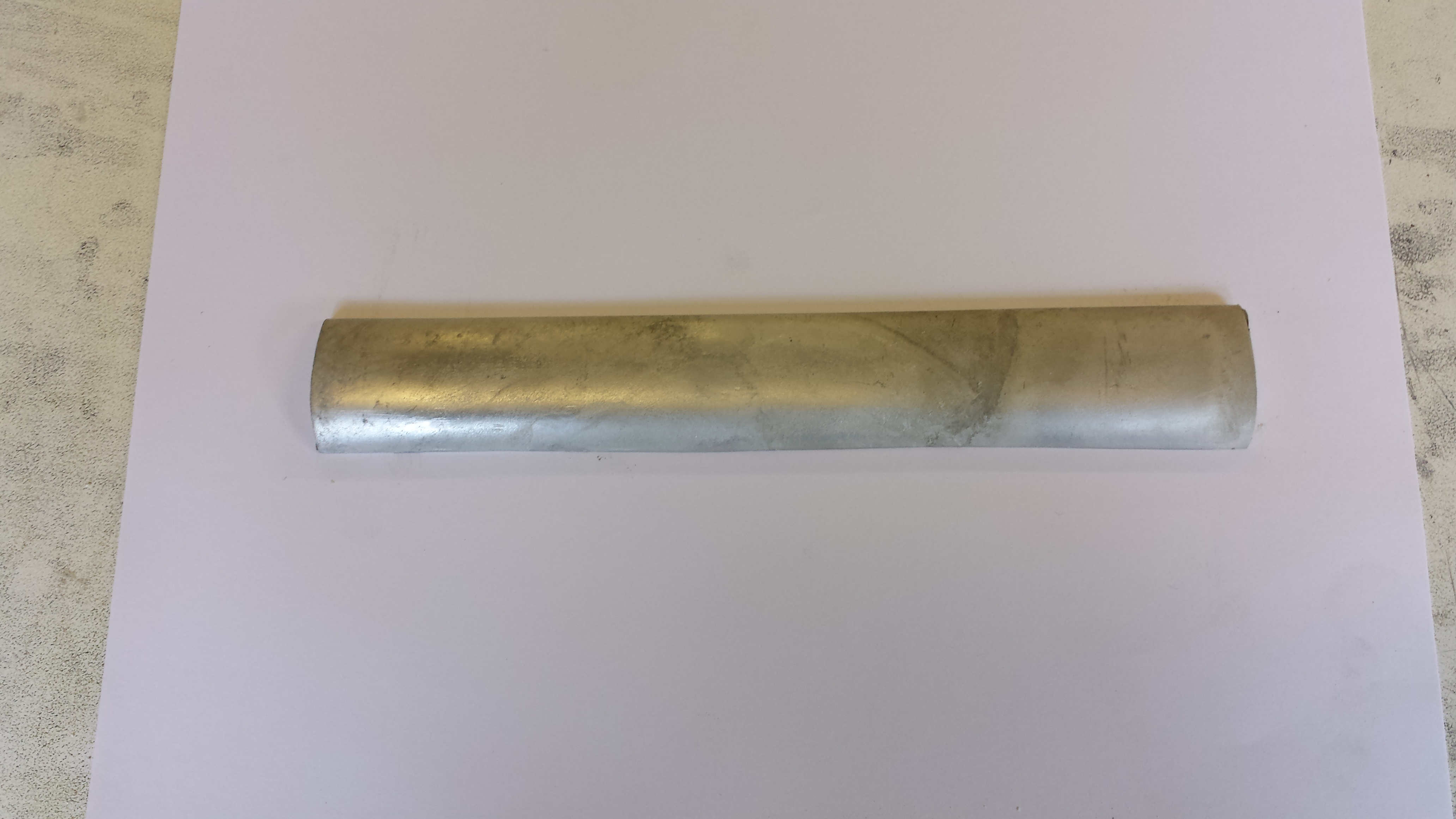

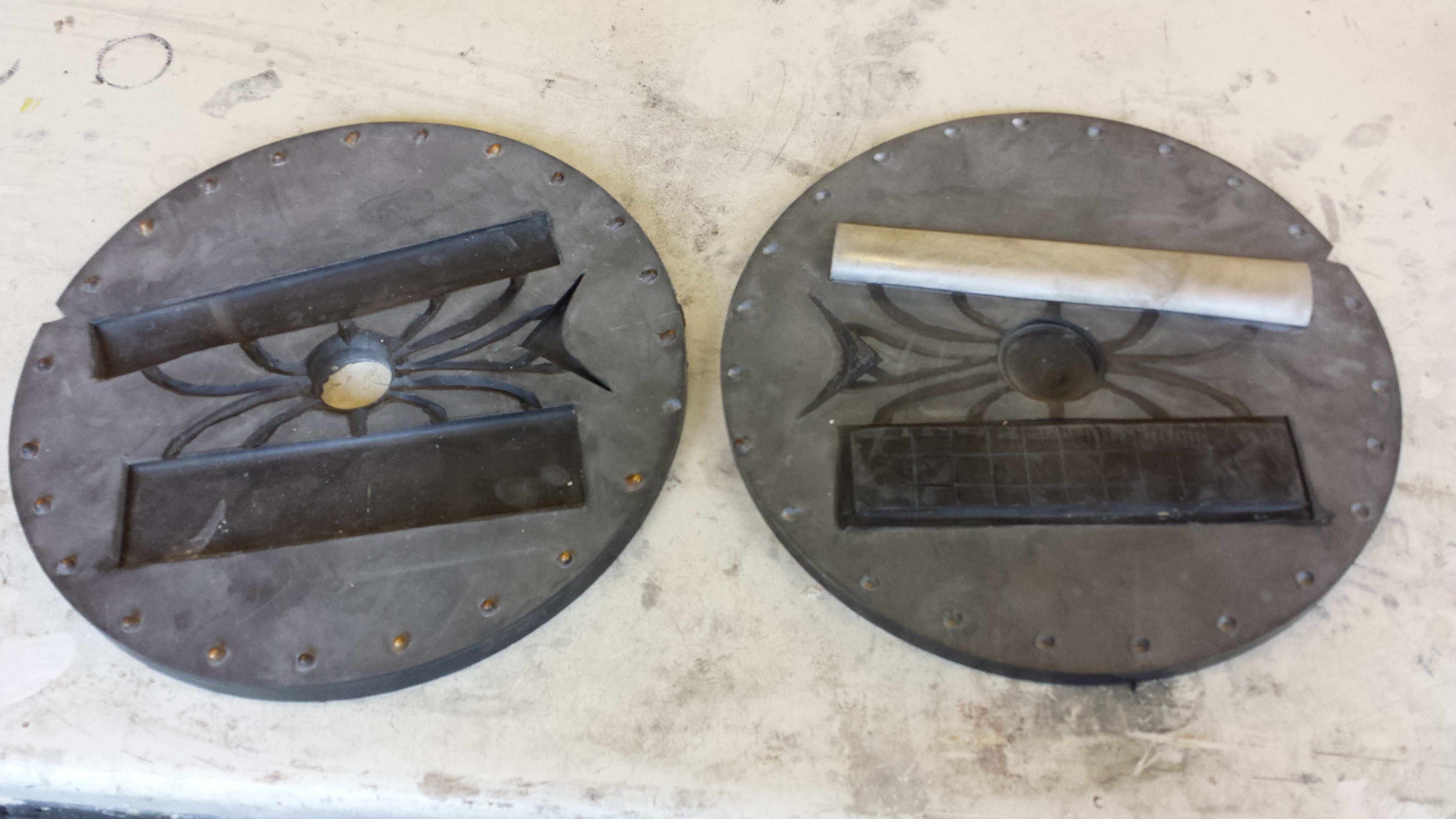

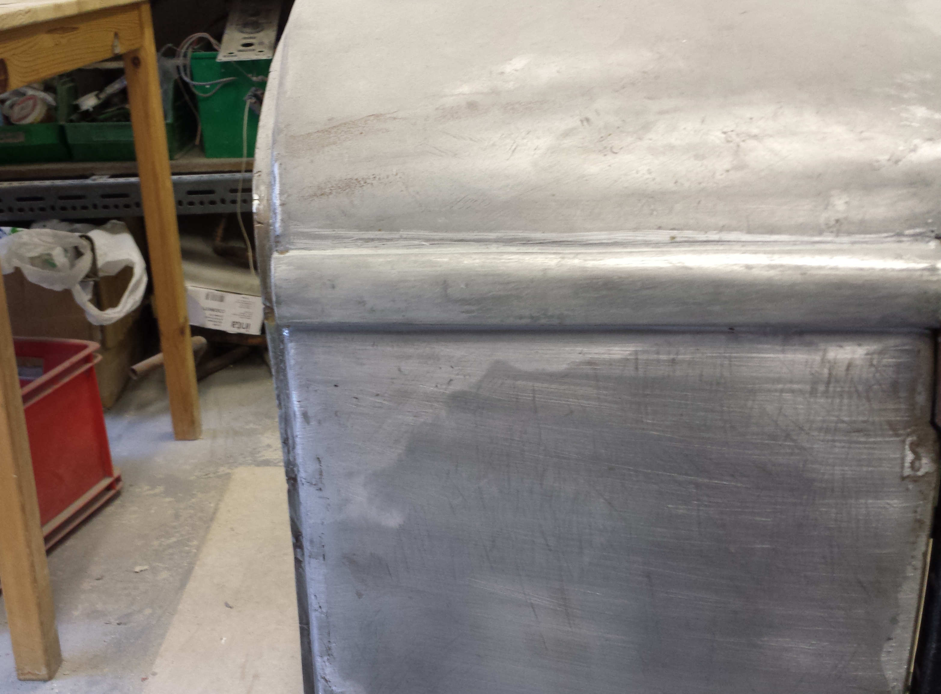

    As you can see by now, this is an alternative approach to building a hotrod, so my next move was also slightly different from the norm.
    In order to produce the distinctive bead along the beltline but without the use of a be 20141007_143700a.jpg 20141007_143857a.jpg 20141007_143913a.jpg ad roller, I made the required profile in resin. I then made a rubber mould. These moulds are used in centrifugal casting (mainly for jewellery). With the mould I could then produce the profile in white metal (also known as pewter, a mixture of tin and lead, although it can be lead free). I was then able to solder the cast bead onto the body in the required position.
    Now that the mould is made, I can produce more pieces for the rest of the body.

    Just wondering how thick the bead is. Pewter can be pretty soft and that's the outermost point that might get dinged or bent....

    Based on the look of the mold... I'd say the bead is solid.
