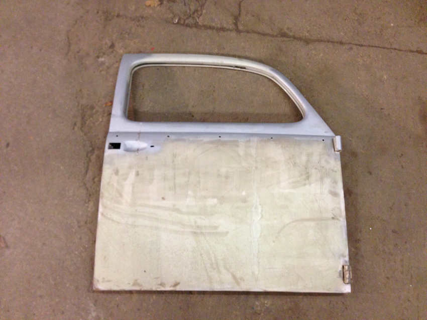

    Part 2. The Doors.

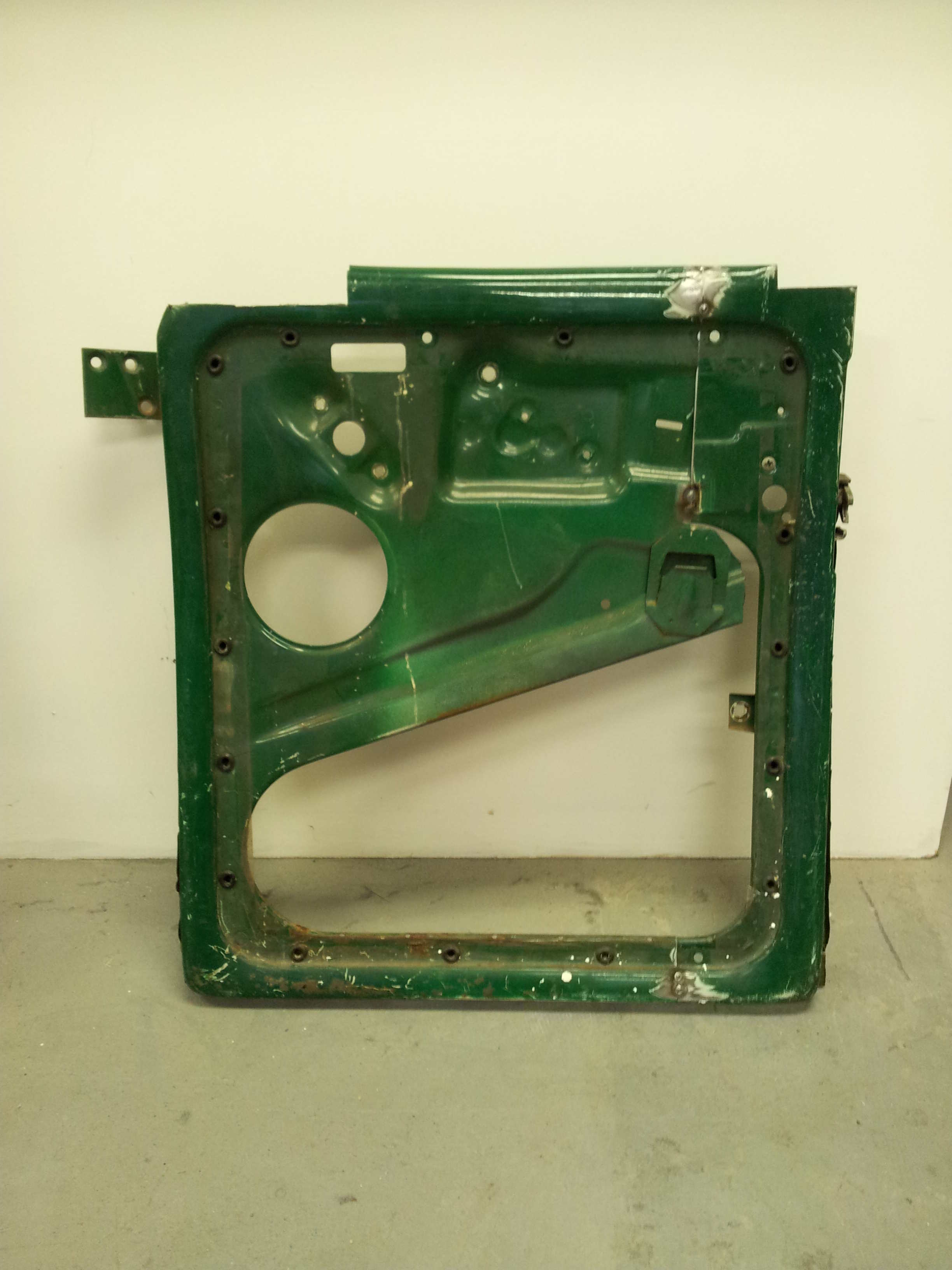

    Looking at the Beetle doors, what's required is to trim off the window frame and then to shorten it.
    AHotRod likes this.
  7. english gent
    Joined: Jun 20, 2012
    Posts: 226
    english gent
    from England

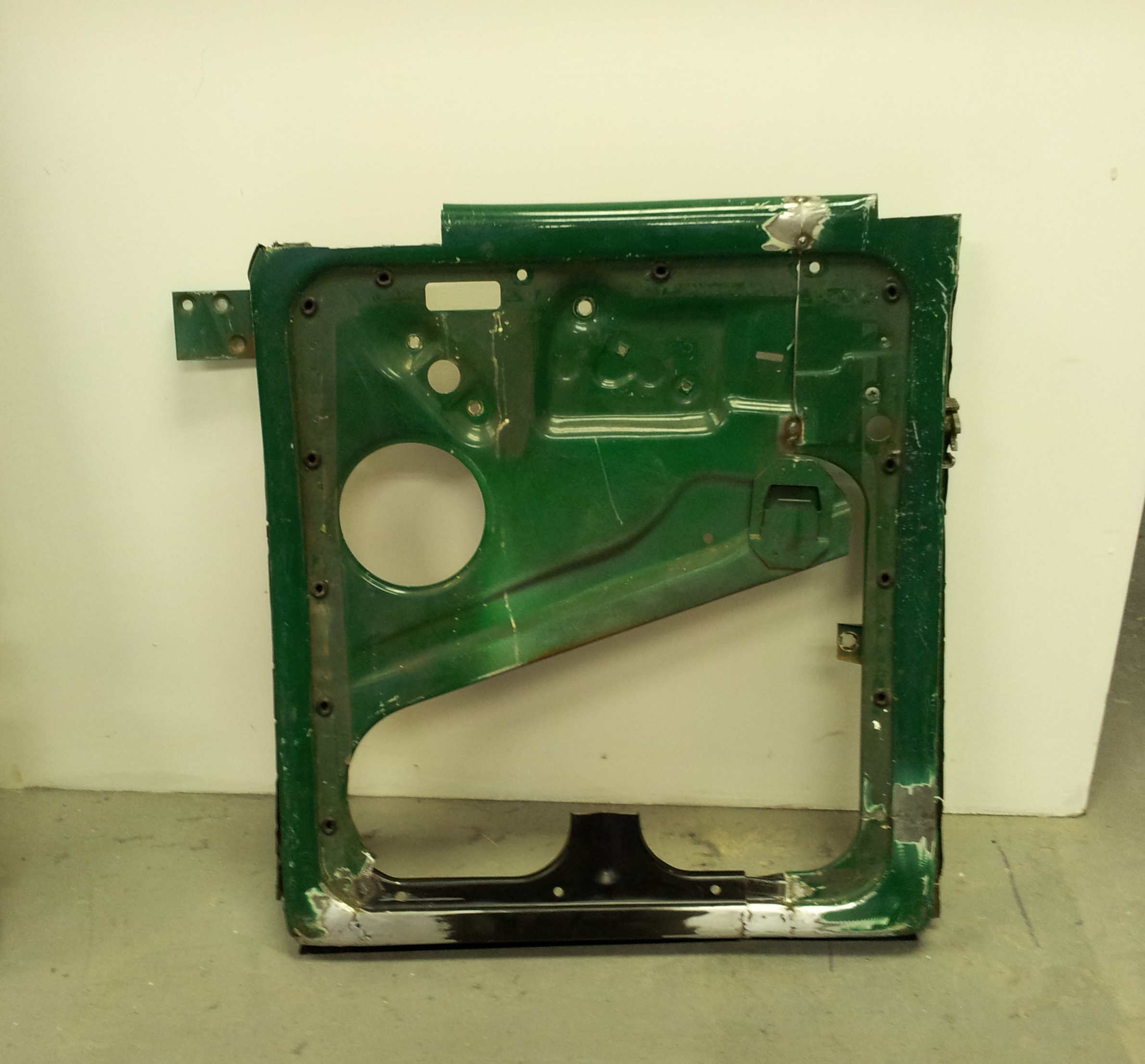

    This was my first attempt at shortening, but it soon became clear that the door skin was beyond saving, so off it came, leaving the frame.
  8. english gent
    Posts: 226
    english gent
    from England
    The bottom of the door frame needed repairing, but these repair panels are cheap as chips. 20121220_130738a.jpg

    from England

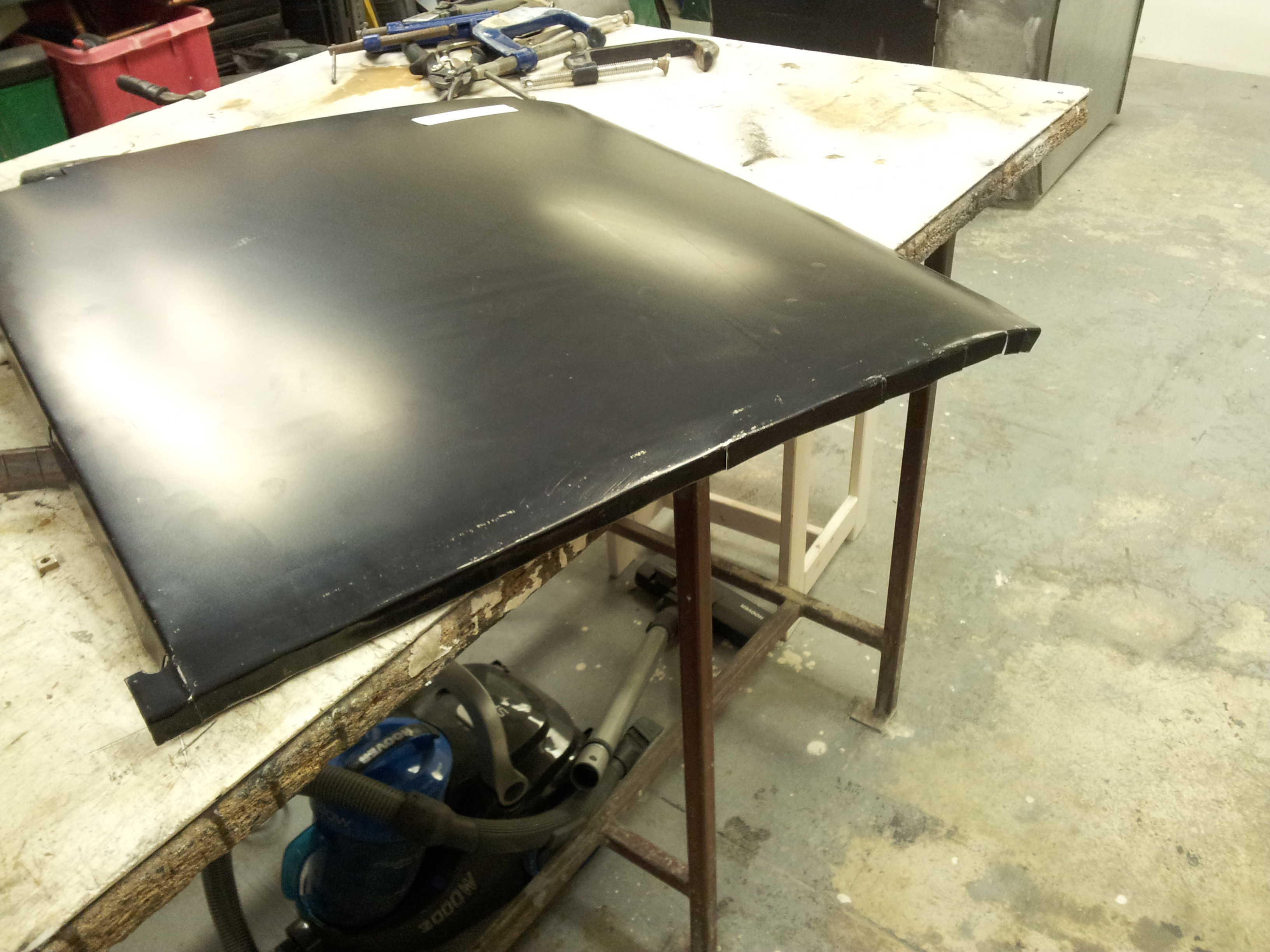

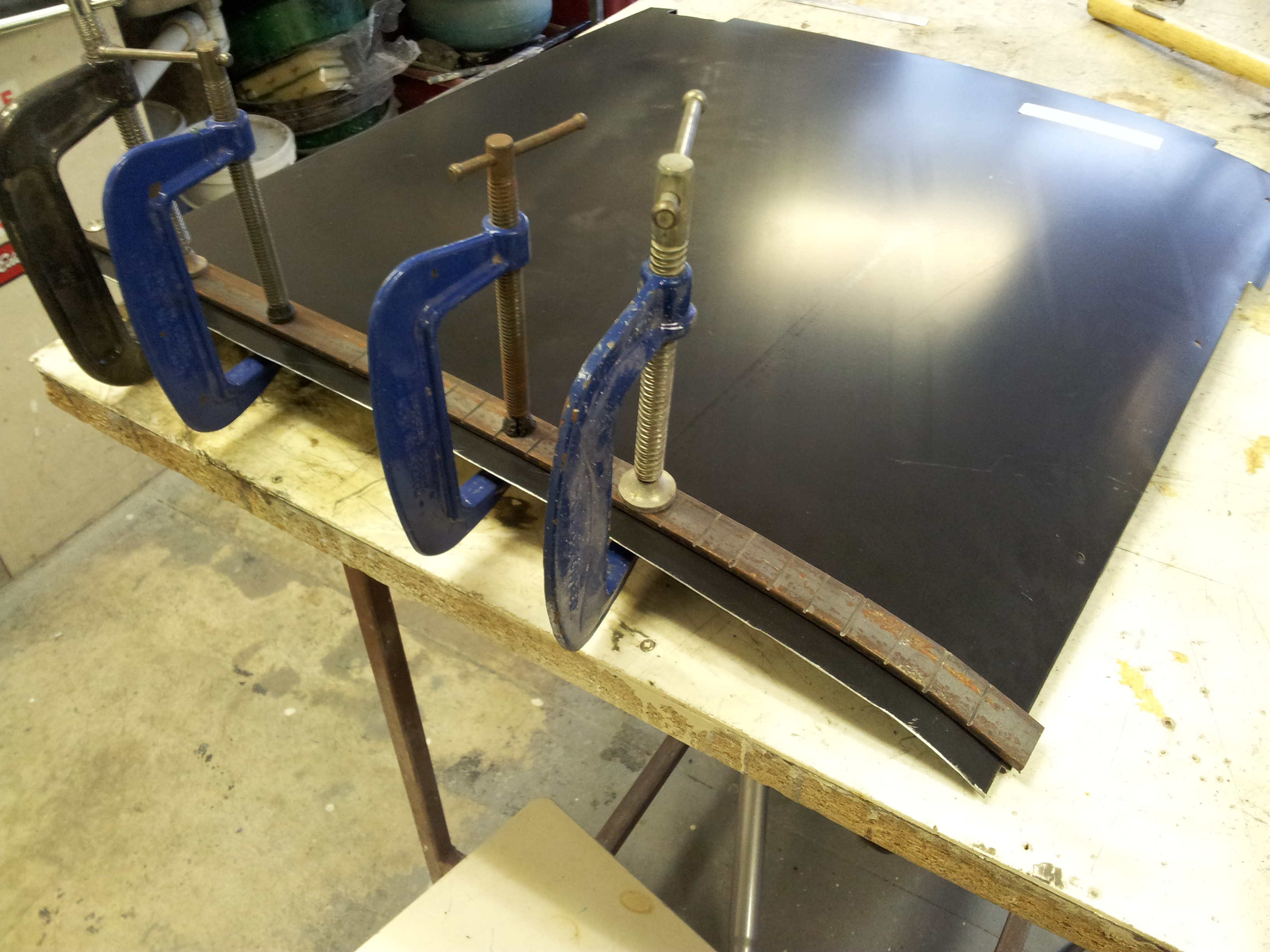

    A new door skin is relatively cheap and a lot easier than trying to repair a rusty one.
    Laying on the skin and sliding it up to the front edge of the frame means you can trim off the area of the beetle door handle. 20130116_113815a.jpg 20130119_140735a.jpg 20130119_163913a.jpg 20130121_105911a.jpg

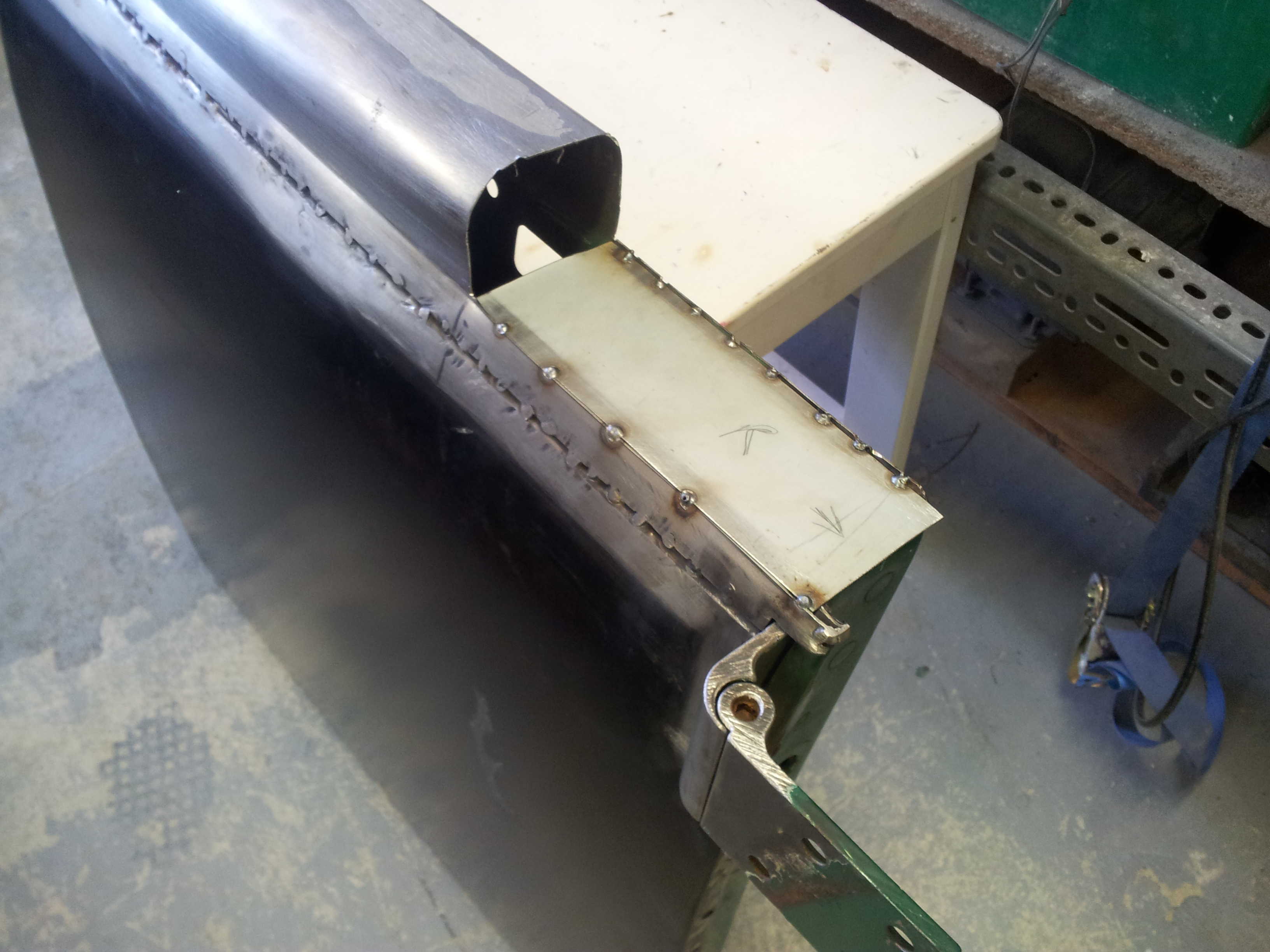

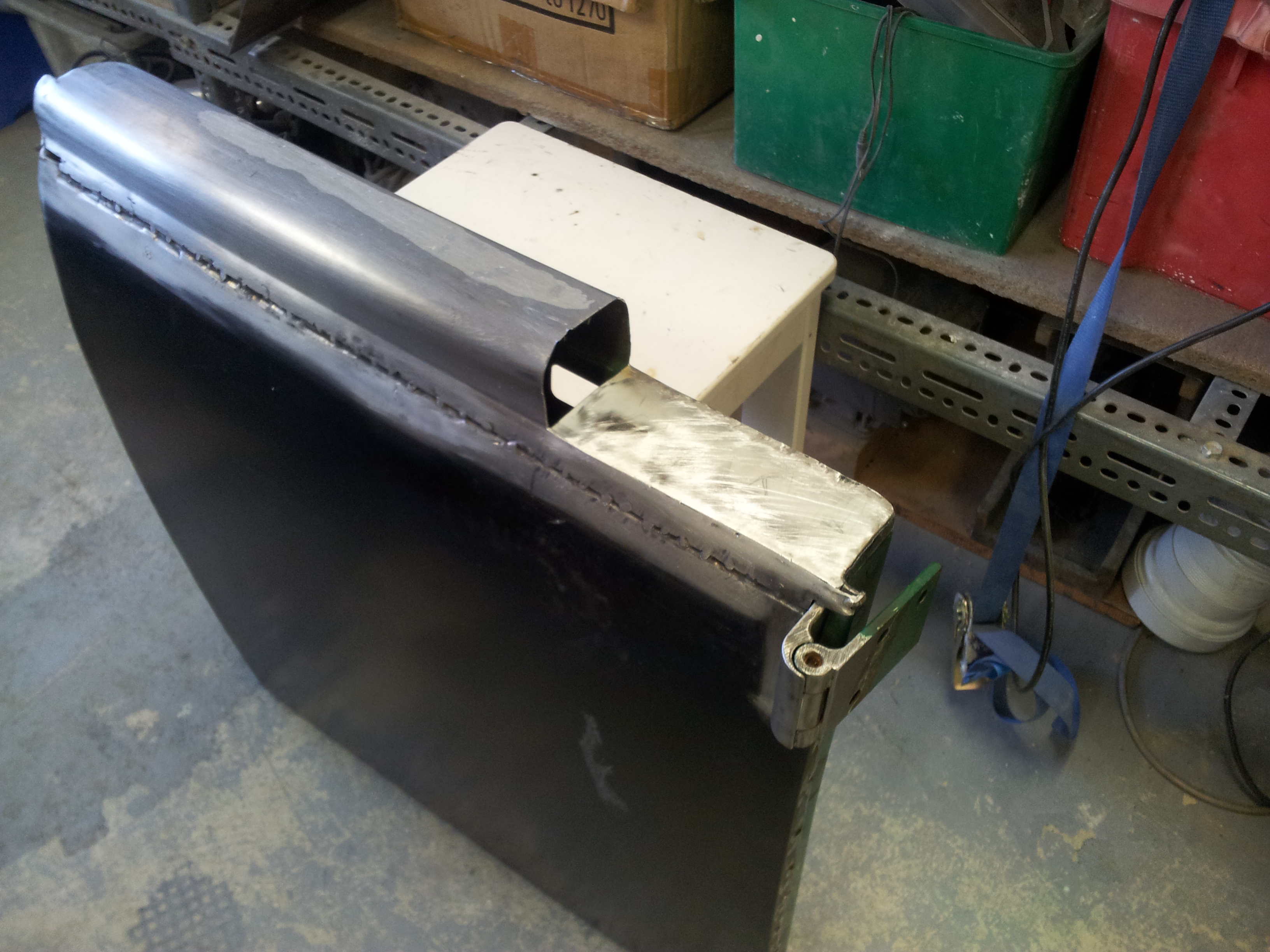

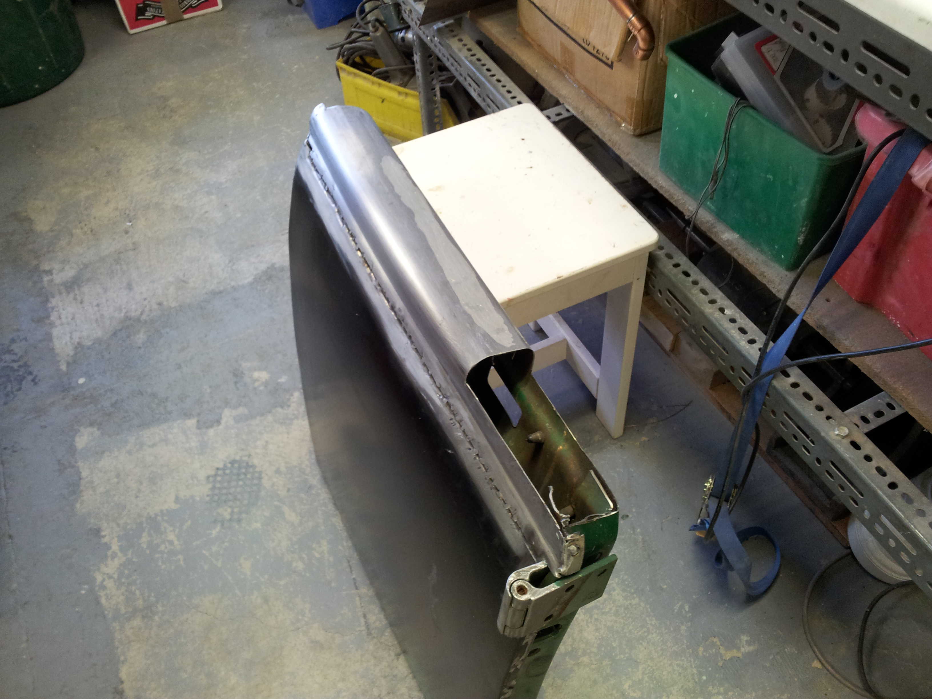

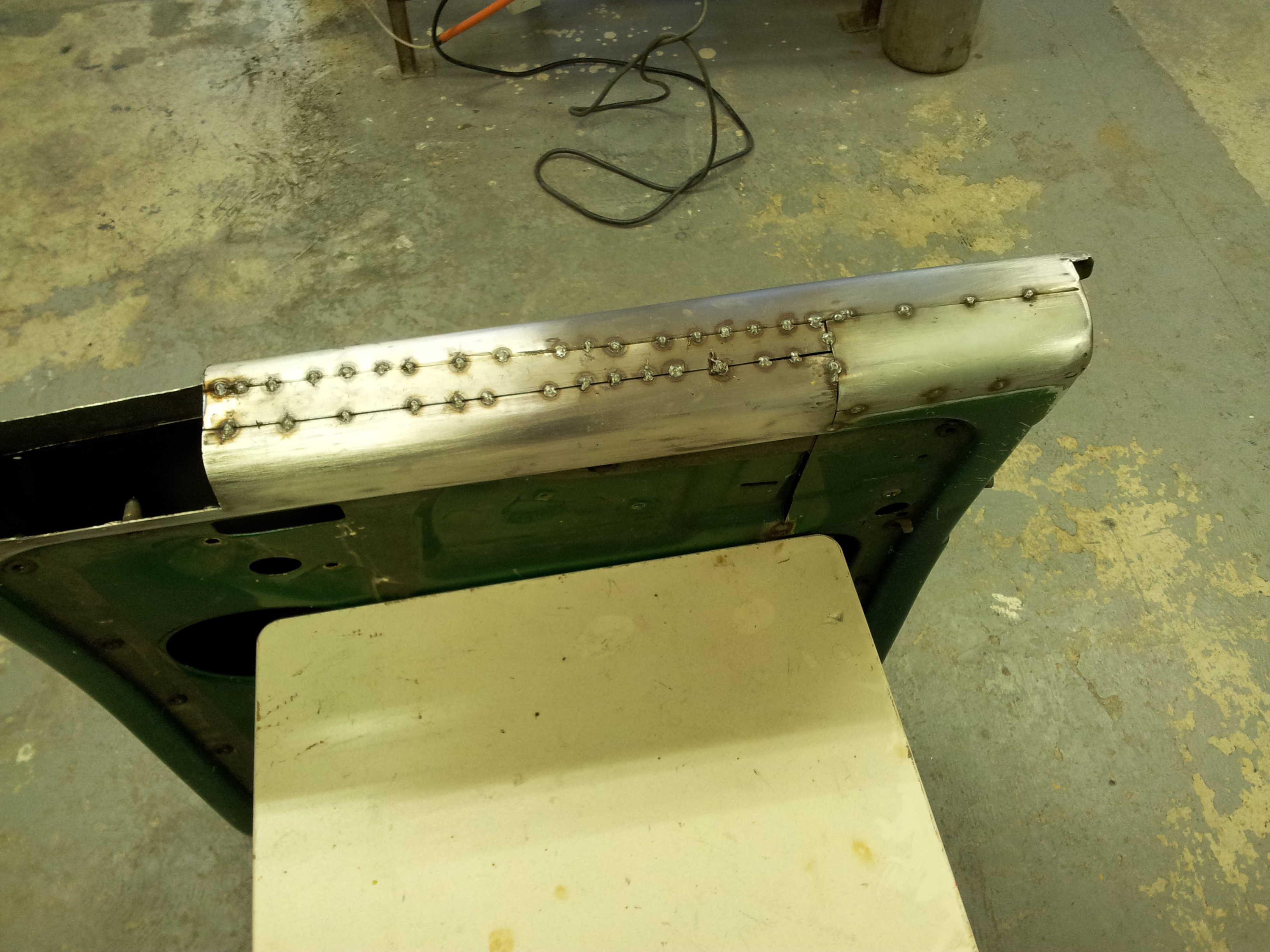

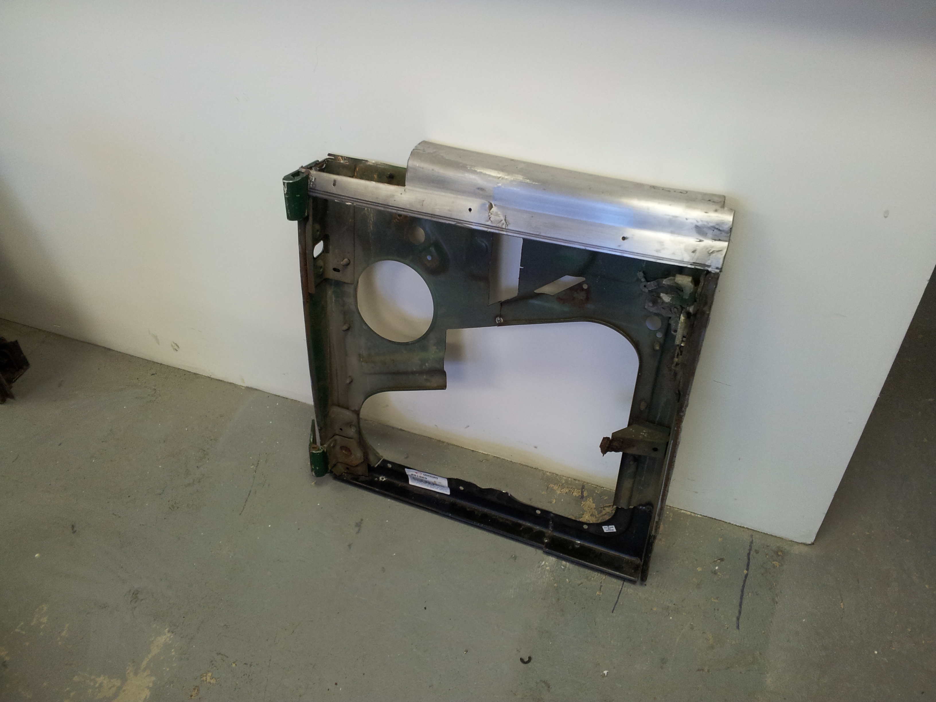

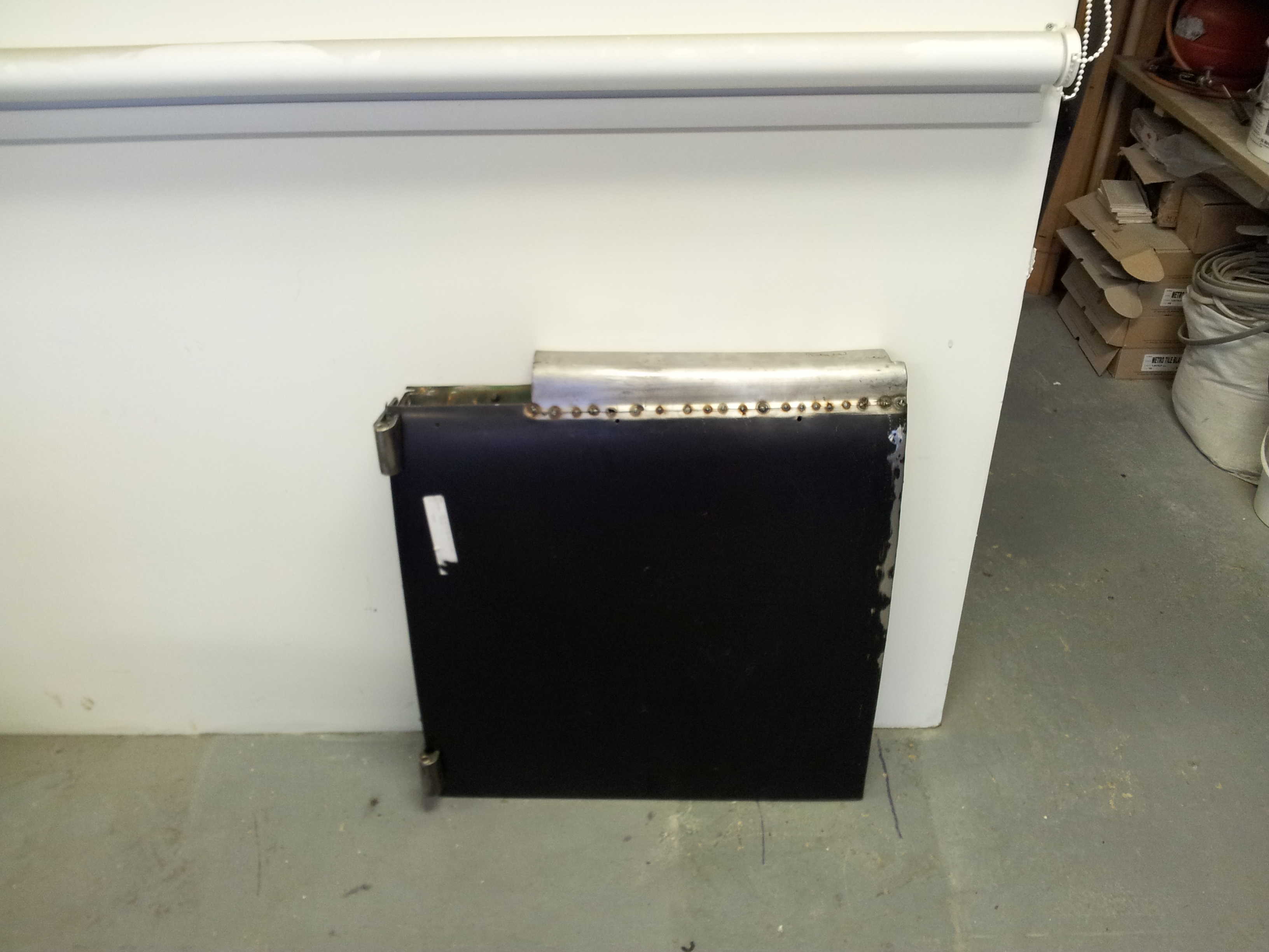

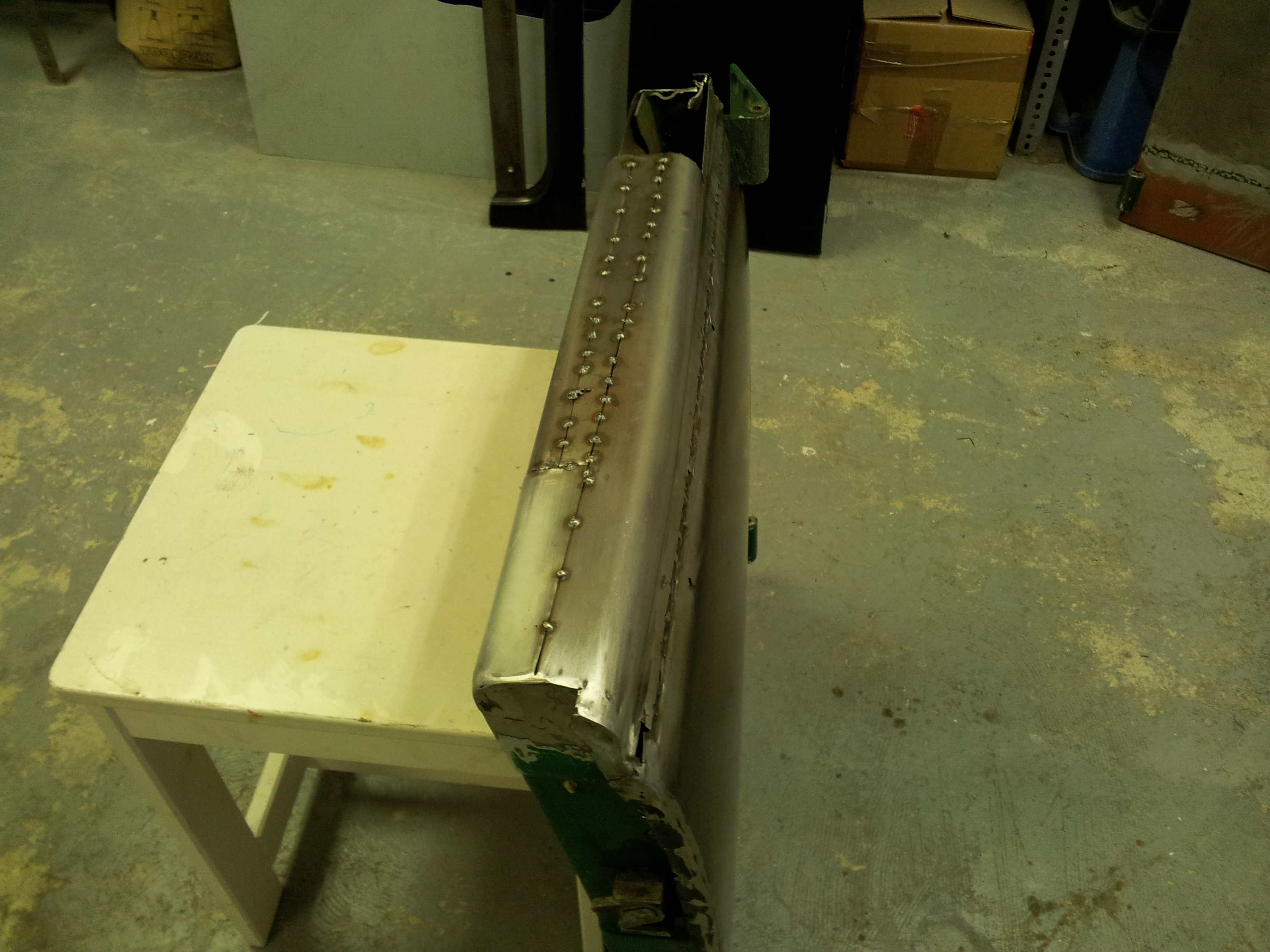

    Next to close the top of the door.
    20130108_143618a.jpg 20130109_142116a.jpg 20130109_142142a.jpg 20130110_144635a.jpg 20130111_131212a.jpg

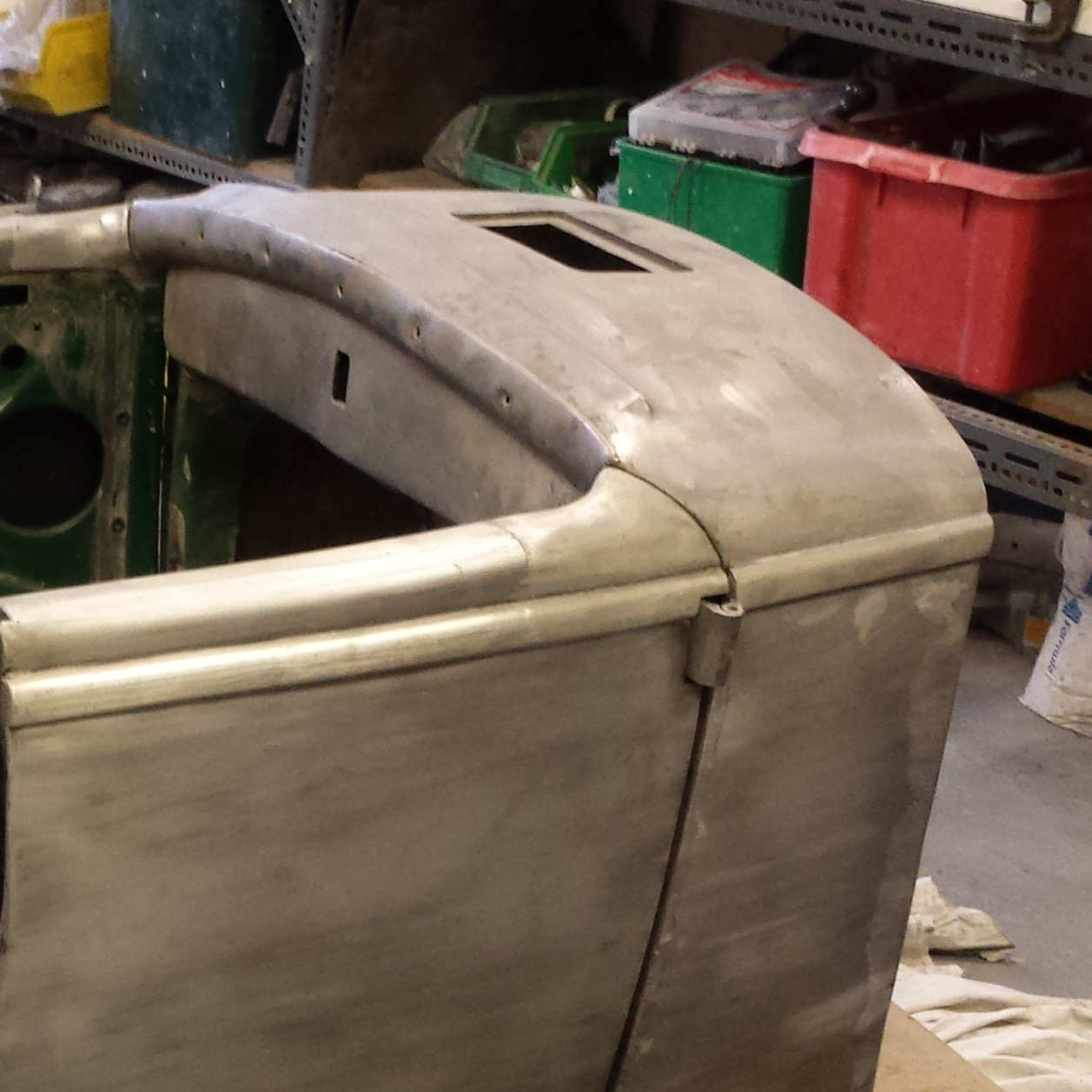

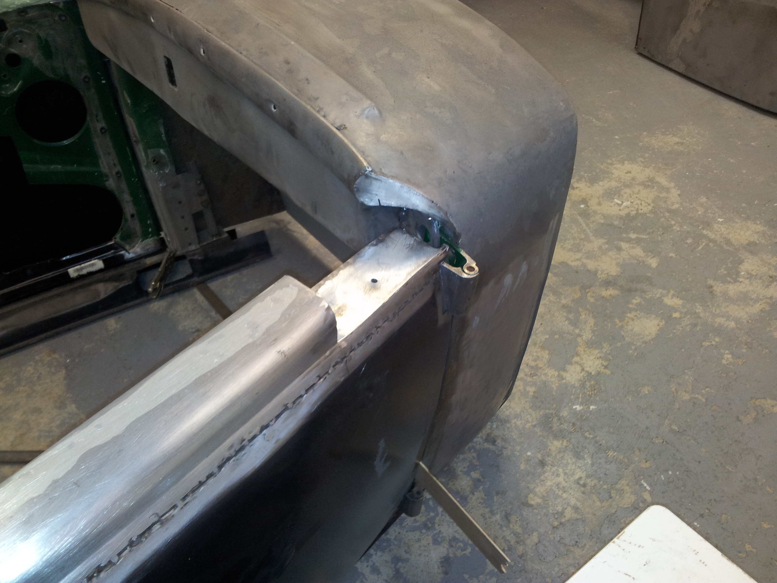

    This then leaves the area where the door meets the cowl.

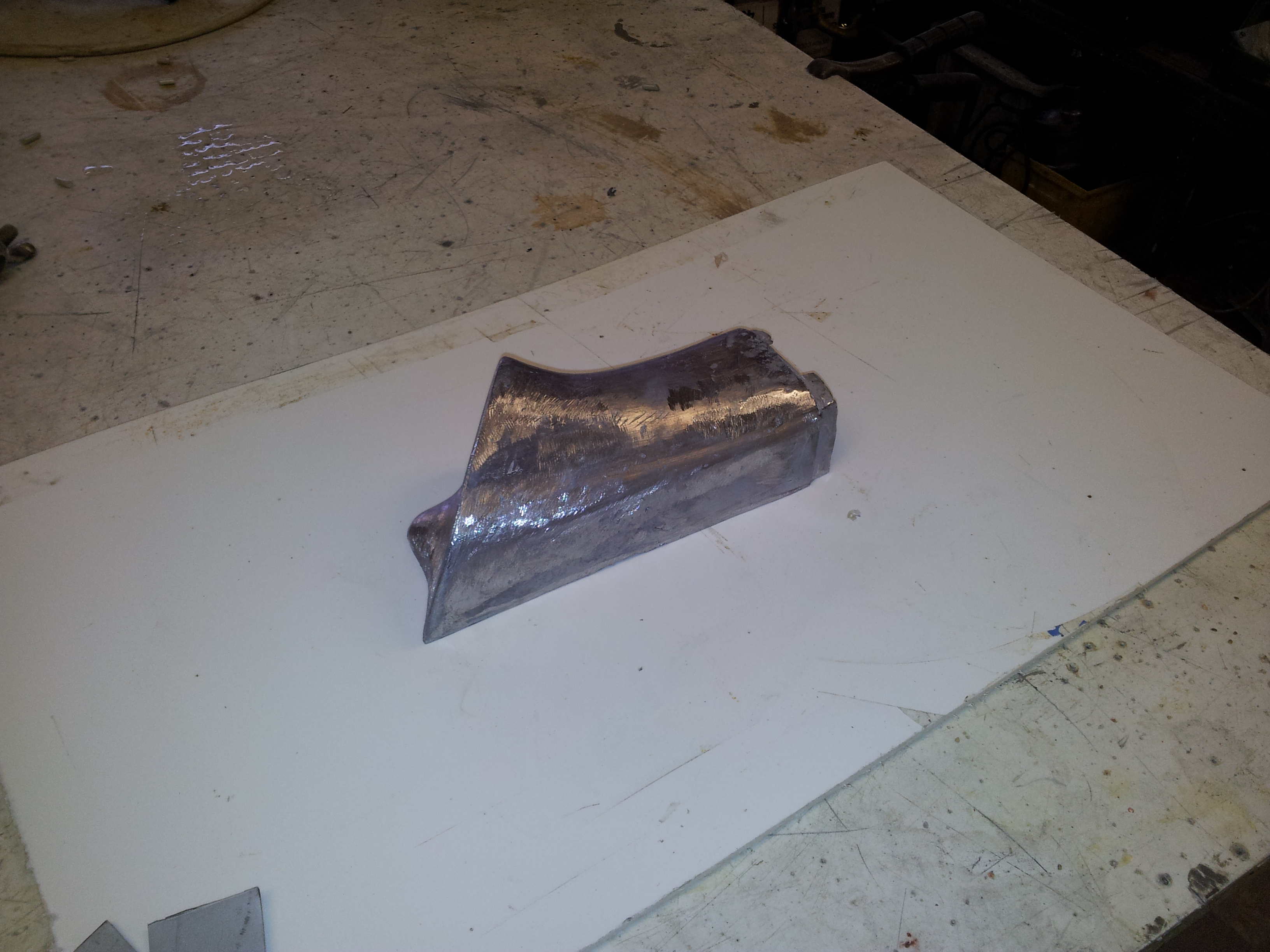

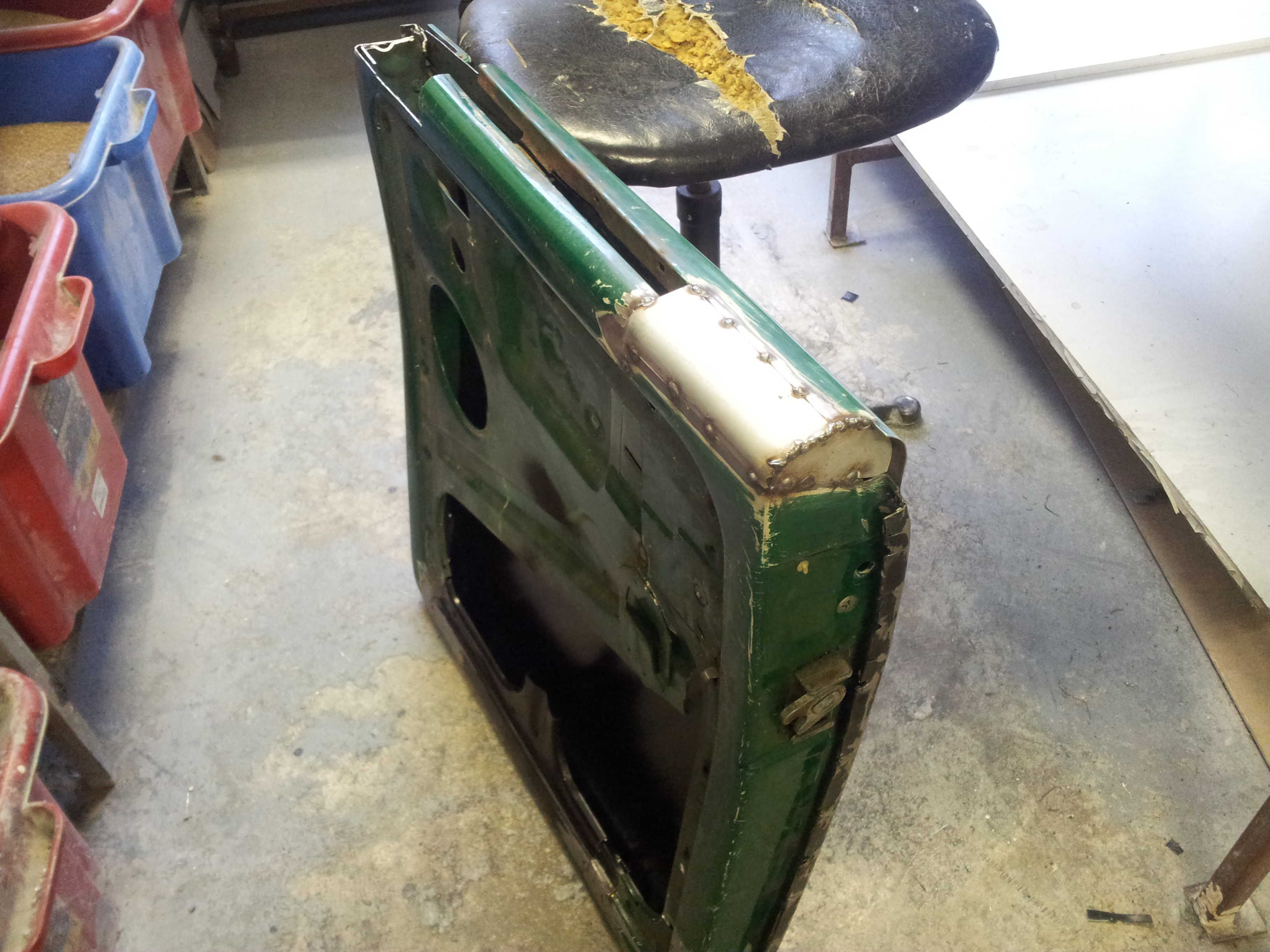

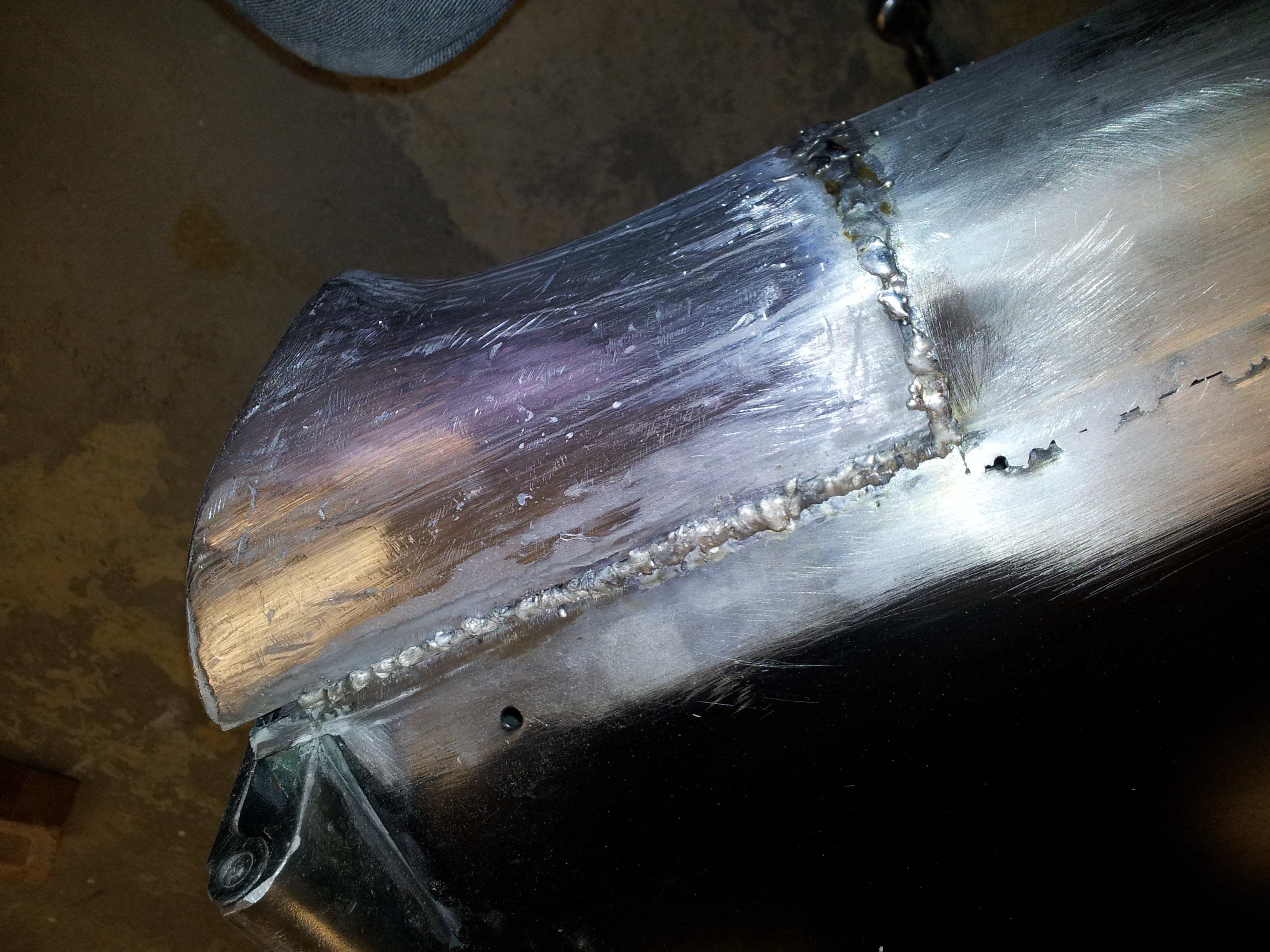

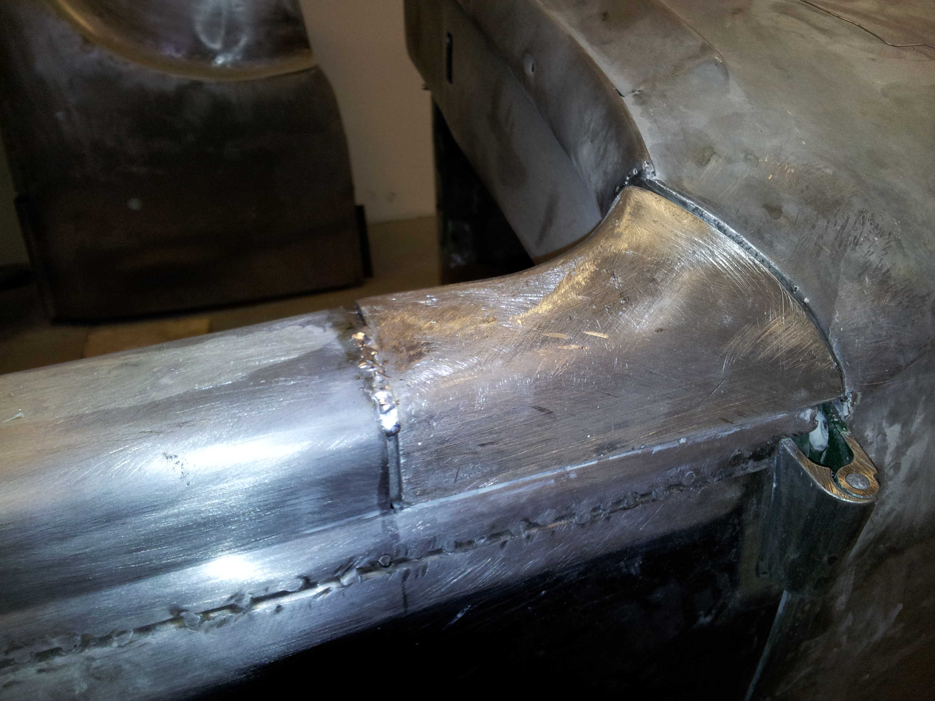

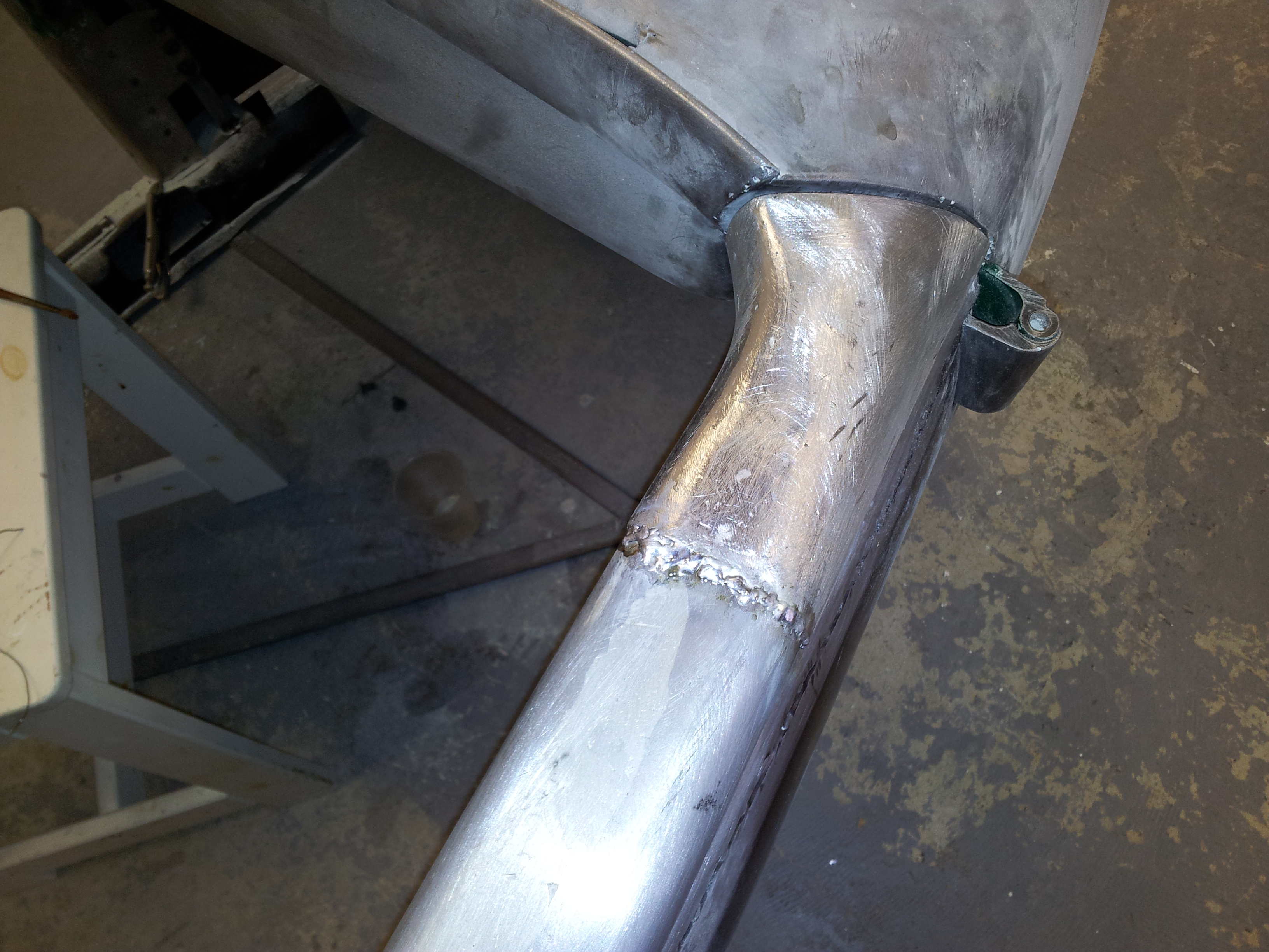

    This was the piece I shaped. First in Bondo, then, after making the mould, in pewter.

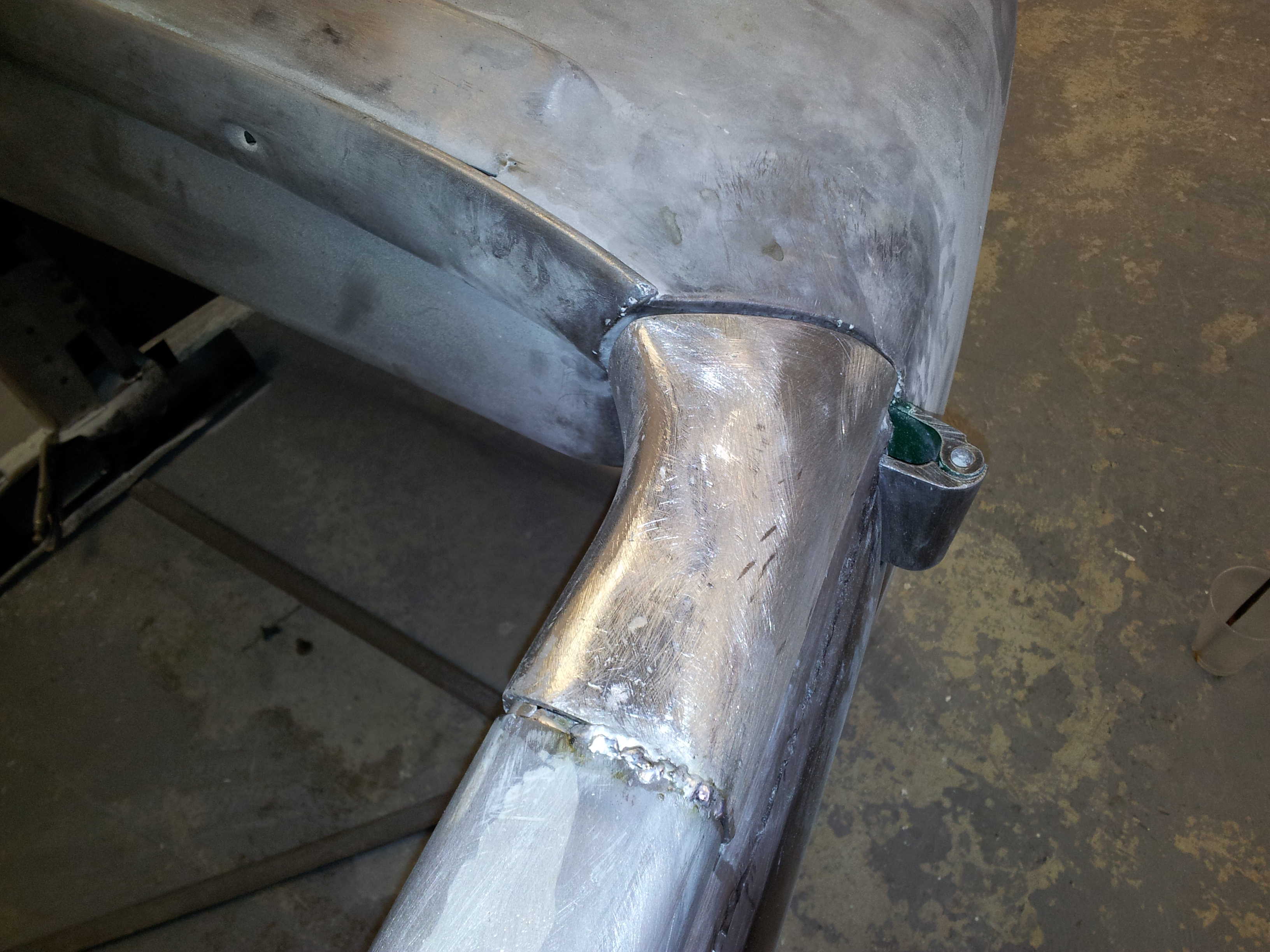

    I then soldered the piece into place.
    20130122_145202a.jpg 20130301_130118a.jpg 20130301_130128a.jpg 20130301_130803a.jpg 20130122_145202a.jpg 20130301_130118a.jpg 20130301_130128a.jpg 20130301_130803a.jpg 20130315_093427a.jpg 20130315_095633a.jpg

    This is how it looks with the cast bead soldered in place and the joints cleaned up.

  23. Atwater Mike
    Joined: May 31, 2002
    Posts: 11,618
    Atwater Mike
    That pewter 'roll' was what I was referring to a few posts back.
    Positively 'character defining'!
    Just love this project...(I have VWs, got onto them in 1957) Hot rods & VWs.
    MyCrustyVW likes this.

    I think you referred to them as 'gunwales' Mike, perhaps this is the correct name for this part of the door.
  25. Atwater Mike
    Posts: 11,618
    Atwater Mike
    Yes, 'gunwales' is a term carried over from the Nautical days. (top of the side deck railing)
    It refers to the tops of roadster/convertible doors from 'A' to 'B' pillars.
