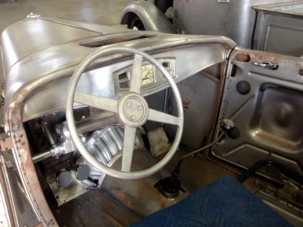

    Finally remembered to take a few more pictures.

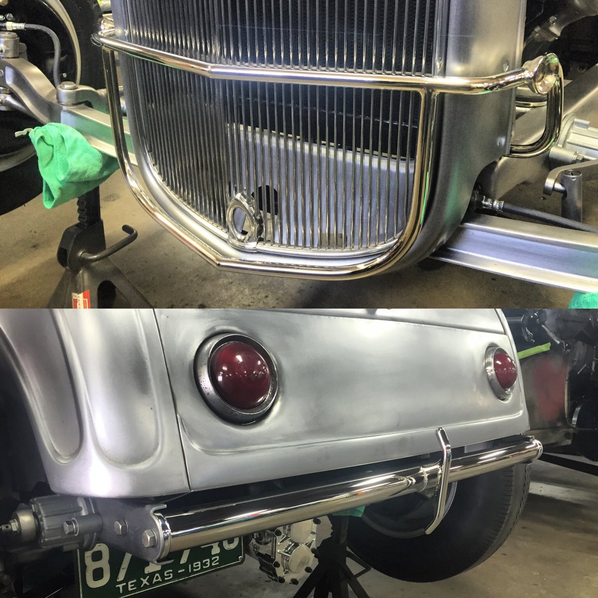

    I lengthened the bottom lip of the grill shell to fill the gap it had in front of the axle

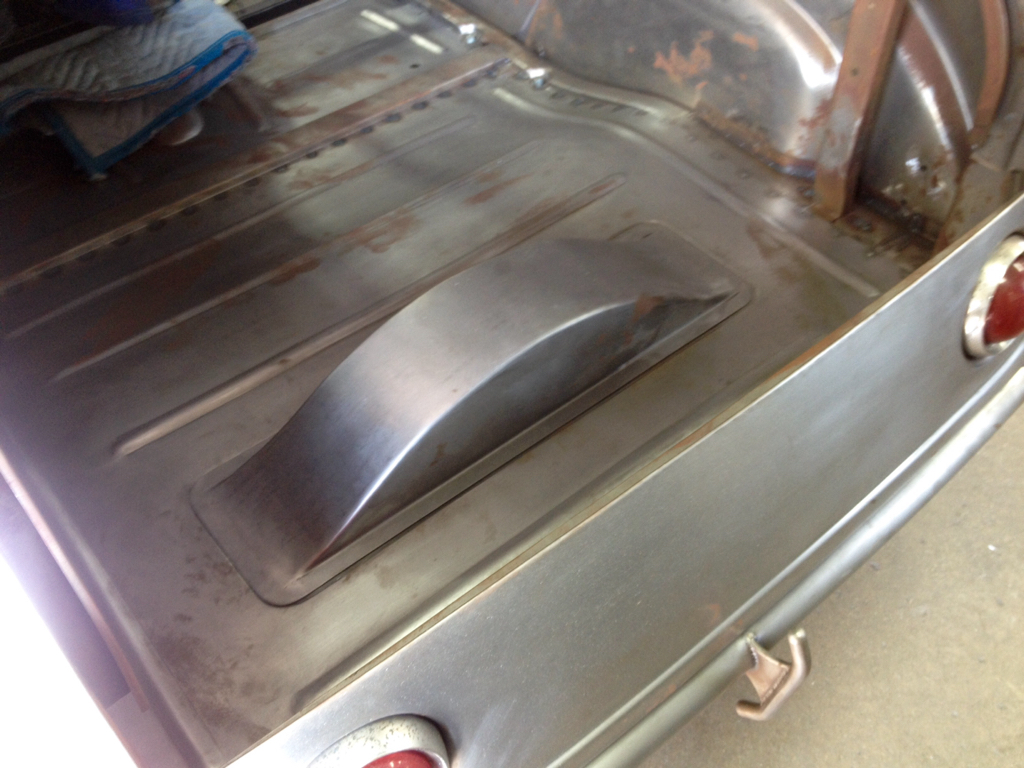

    The rear floor with beads, welded in, and the rear crossmember cover.
    Shifter handle made from an original Ford lever, modified to bolt to the Hurst T5 shifter and a "Safe Driver" knob from Lucky Burton
    The steering wheel showed up from Crafty B the other day. He just got them from the foundry and sent one our way so we could finish out the spokes and other details just how we wanted. I machined the back of the hub on the raw casting flat, drilled the mounting holes, and bolted it up.

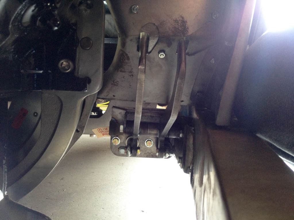

    And finally the new pedal ***embly. A Model A application from TCI but with a little modification to the mounting bracket, it works great. The bracket it just tacked in place in these pictures. Though I did have to do some modifying on the pedal arms to get the pedal pads in the right spot (and rounded all the corners so they almost look like a Ford pedal arm now), they arms came through the floor at the perfect spot. We will use a remote reservoir mounted to the firewall. The plan for exhaust routing will have to be changed a little.

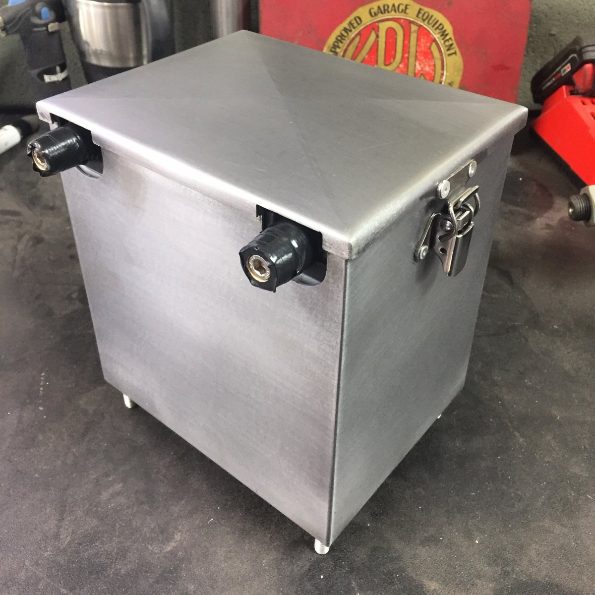

    Custom battery box, fits behind the seat

    Had the front nerf bar and rear spreader bar nickel plated

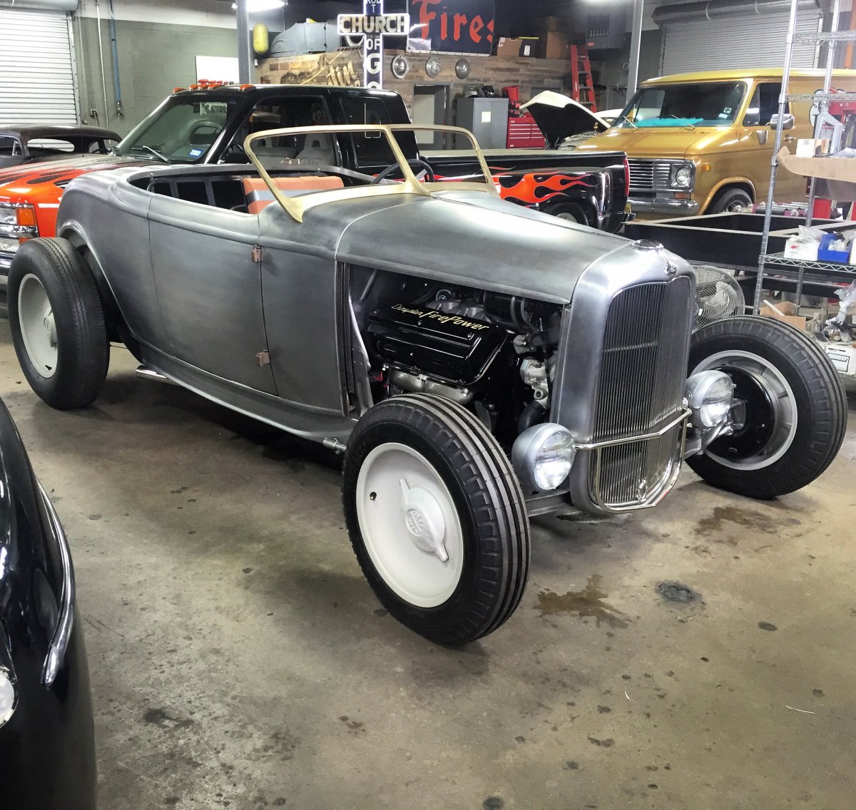

    Here's how she sits now. Still a couple mechanical issues to sort out but we did fire her up Friday and it sounds pretty damn good! I'm pretty excited to take it for a drive tomorrow. After the Roundup there are a few more details that need to be done, a bit more fabrication left. Then it's off to paint and interior and we've got some special people involved to finish this one out. You won't see much more until January.

    Very nice build. I do not like the billet reservoirs on the firewall, however. They do not fit with the rest of the parts used. No room on the other side of the firewall? I am sure you could find a creative solution. Perhaps with access through the glove box door? With all the effort to keep the car "traditional" looking, it's like a big zit on prom night.
