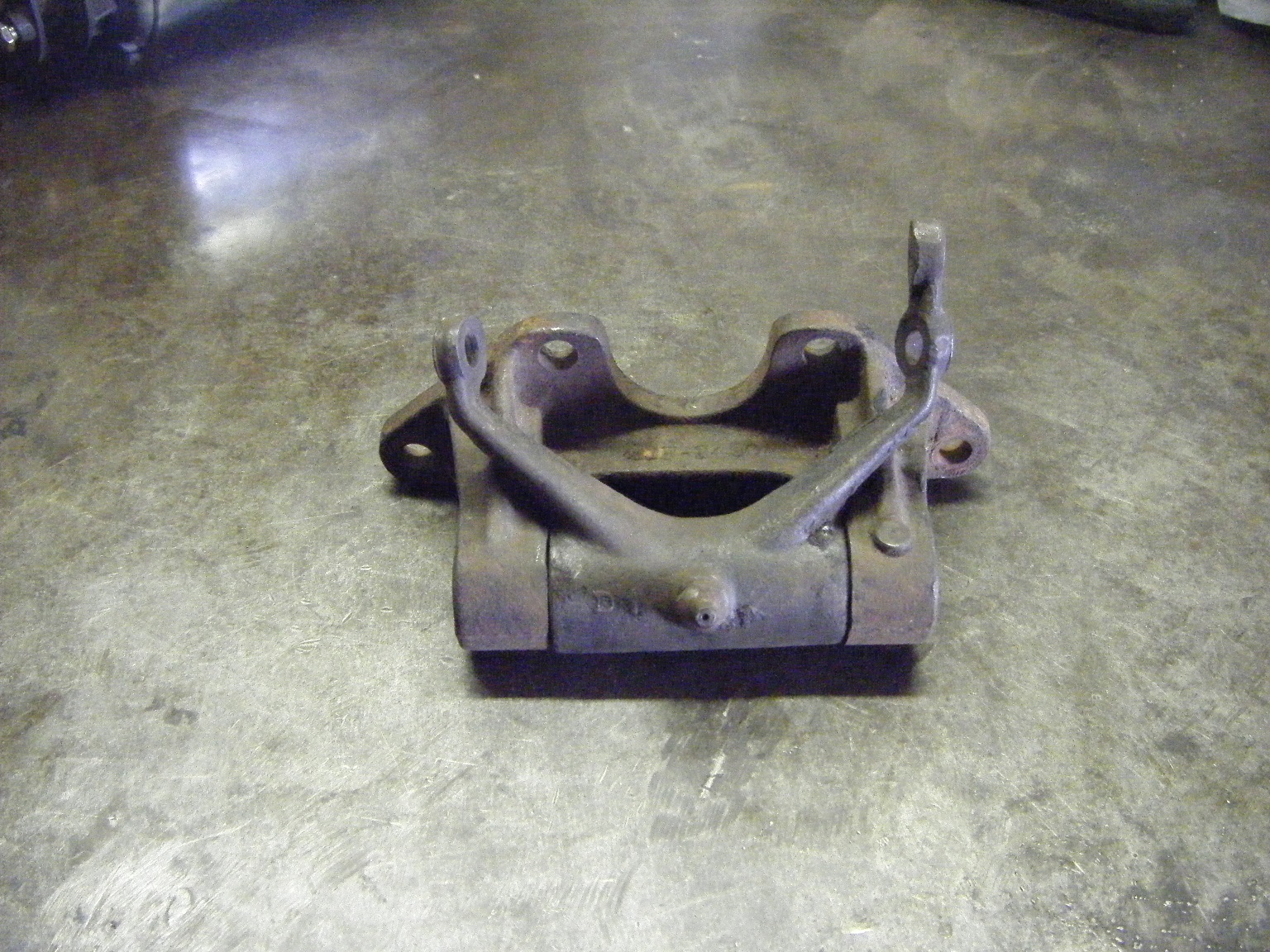

    Hardly worth updating but I managed to complete the emergency brake, truth is I have purchased a new property so have been busy with my current property getting it ready for sale, hence work on the roadster has come to a virtual stop. That and the fact that the new property has no shed/workshop, once I sell my place all my cars will have to go into storage until I can get the funds together to build a new workshop, but I hope to get a bit more done before that happens.
    Anyway this is how I did my emergency brake, I had this bell crank in my shop not sure where I got it from or what it is off, something with rear brakes only possibly a model T.
    It needed a few mods to suit my needs so will let the pics tell the story.

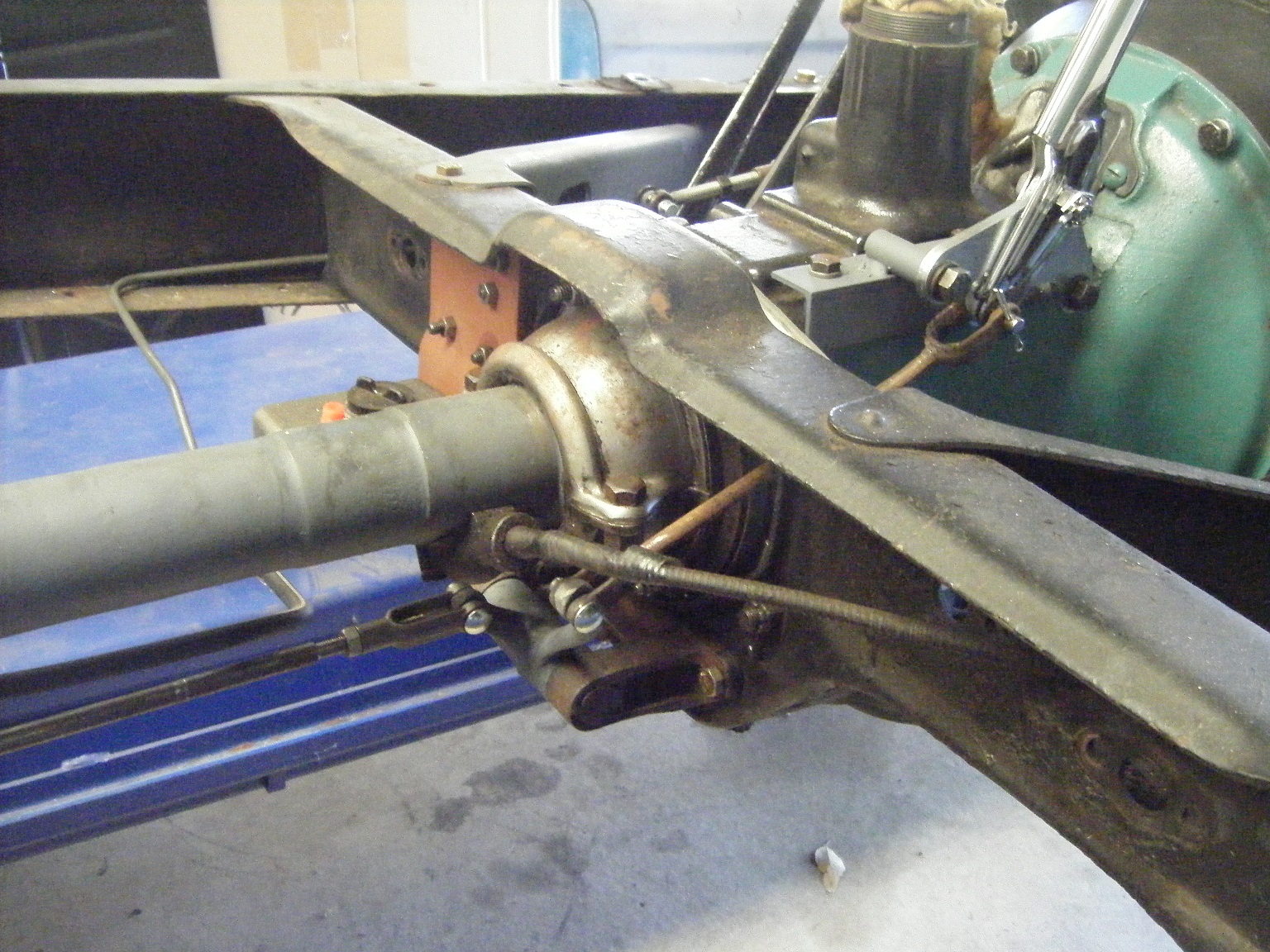

    Before and after shots.
  10. cully33
    Joined: Mar 19, 2007
    Posts: 769
    cully33

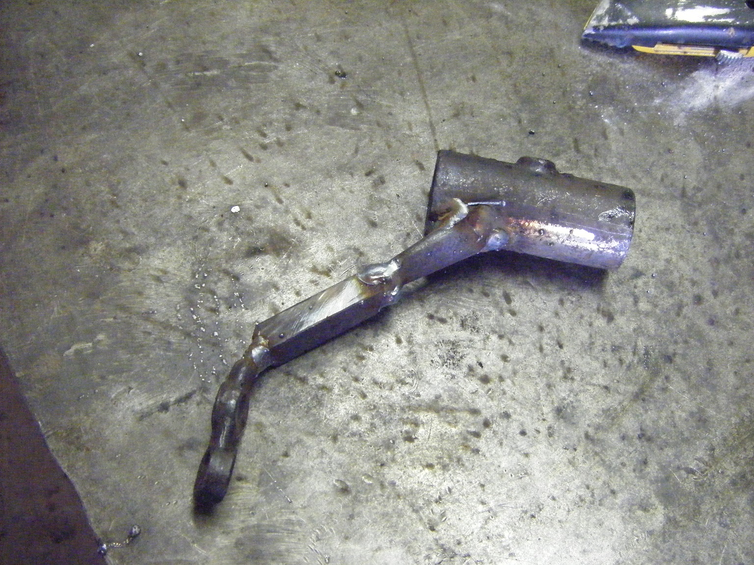

    K member drilled to suit new bell crank and bolted in place, threaded a piece of lathe stock for clevis, using a stock 42 - 48 cable and cable horseshoe form a junkyard 80s Ford Falcon.

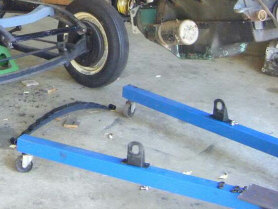

    Top shelf work you do there Cully, congrats. What are the black brackets used for on the legs of the engine hoist? IMG_20150107_080209.JPG
