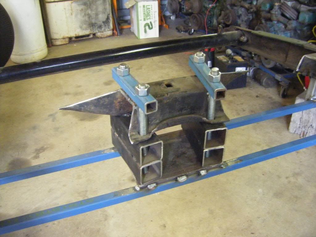

    Next was to start on the stance of the roadster it was just sitting a little to high for my liking, I know back in the day there were roadsters around with a high stance and I hummed and arred about leaving it as is or lowering it. I looked at the Don Montgomery books at a lot of early 50s hot rod mags and although there were some roadsters with a high stance there were more that had been lowered.
    I decided to flatten the rear cross member, been done lots of times before and different ways, I read a how to article on this in the now defuncked Chopped magazine and did just as in the article except I cut the rear center section and opened it up adding a pie section so the original cross member lines would line up better.
    First job was to make a jig, flat plate drilled to cross member u bolt hole pattern, 2 x 1" square tube and 2 pieces of 2" x 4" drilled to cross member U bolt and 1 length of 5/8" threaded rod cut into 4.
  3. cully33
    Joined: Mar 19, 2007
    Posts: 769
    cully33
    Next bolt jig to cross member.
    Weld some cross sections of 1" square tube to the plate with some uprights to the ch***is to hold it all in place.
  4. cully33
    Posts: 769
    cully33
    With the jig plate now held in place, remove the threaded rod and mark cross member ready for cutting.
    Cut out using 1mm cut off wheel.

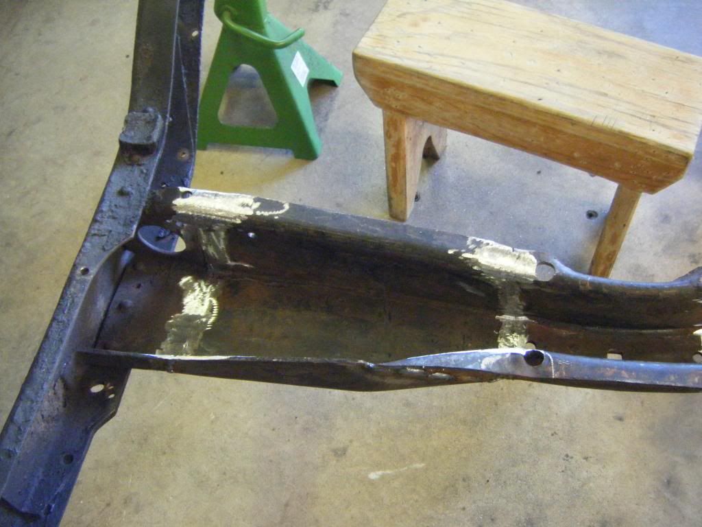

    When you have it all fitting good remove and grind areas to be welded grind a good chamfer on both sides for good weld penetration.
    Clamp back in place ready for welding.
  8. cully33
    Posts: 769
    cully33
    All welded both sides and ground back.

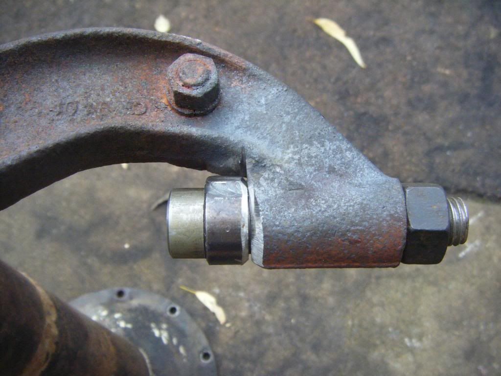

    This rear end has seen a lot of hard work in it's past life, one spring hanger was bent out of wak and both spring hanger eyes were chewed out on one end.
    Some heat and m***aging got the bent hanger back to where it should be, next job was to repair the chewed out hanger eyes.
    I just ground them up square, made some new sections and a tool to hold them in place while I welded the new sections in.
