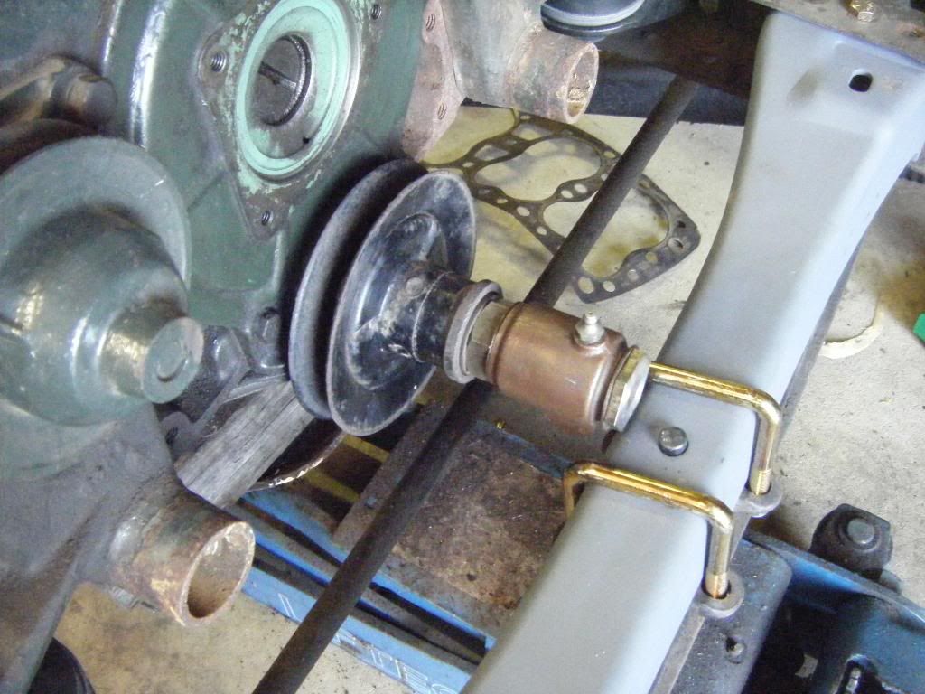

    While I was mucking around with the front of the engine, I decided to check fit of a rare SW crank driven tachometer drive that I pick up of a fellow HAMB member, as I will be running a mechanical tacho.
    These drives were obviously designed to be used with a stock cross member and motor mount location, I had clearance issues with the radiator, so had to machine down the crank handle bolt to clear.
