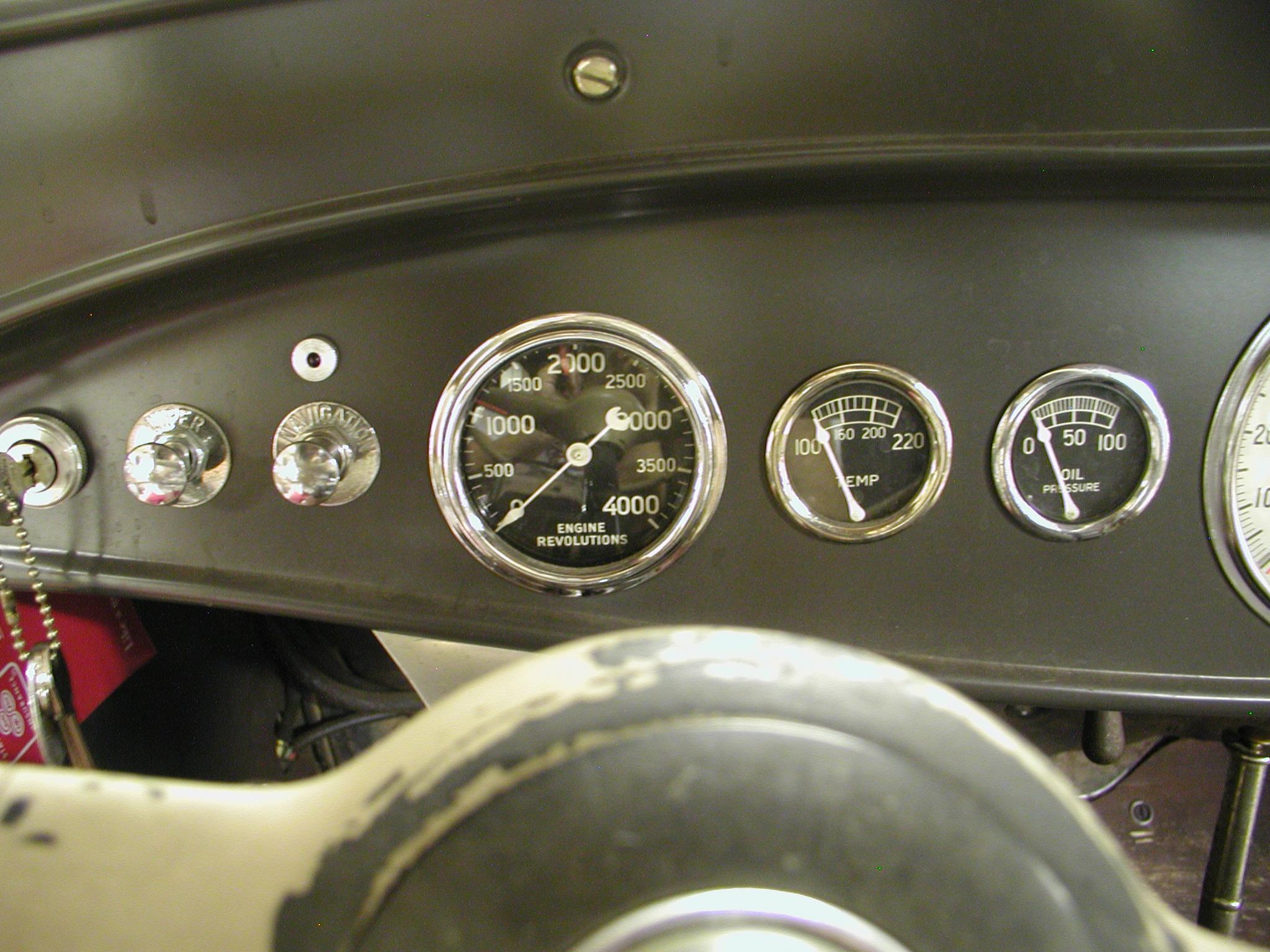

    Sorry mate, I was looking on my phone and it was a bit hard to tell the difference on the small screen but jeez didn't that start some conversation. What if you could find a yellow faced speedo to match the 4500 tach to sit between the black guages.
  5. cully33
    Joined: Mar 19, 2007
    Posts: 769
    cully33
    Yes I would mix and match option #1 & #2 only, due to the fact that the needles are the same style, except the obvious black faced gauge white needle, white faced gauge black needle.
    I would not mix the thin line needle black faced gauges would keep them as a matched pair.

  7. cully, really enjoying your build, personally i like the dash with all the black face gauges but there is only one person to please and that is you.

    Good job Cully, great thread. Glad to see a more traditional build here in West Oz. I vote for installing the Police Special speedo with the remaining gauges all black. keep up the good work.

    Cully, I like the Police Special set up looks neat, keep up the Great work

    As much as I like the police special gauge the last set-up with the all black thin line gauges looks killer. So I guess yuou might as well send me the PS gauge and I will use it in the 3 window. Fat chance I know....Trashing away on it and the 54 truck at the same time....Really dig the roadster...Wish I could come help ya.

    I do know a guy who mixed a white face Police Speedo with black face gauges.

    Alchemy do you know when this car was built with that gauge set, I love the 2" smooth bezel flat gl*** gauges, I have been collecting a few of them for my next build.
  24. alchemy
    Joined: Sep 27, 2002
    Posts: 22,998
    alchemy
    About 2005-ish.
