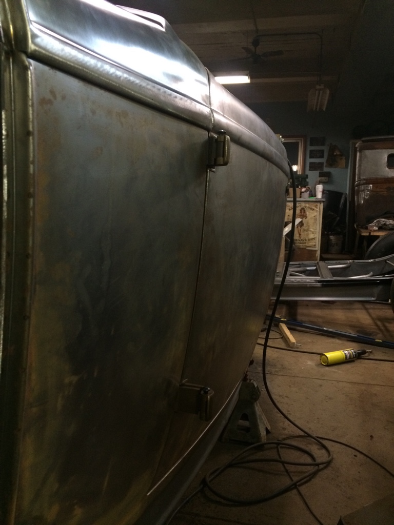

    Got another one built from another shop with all kinds of screw ups .
    That's not right
    Hinges placed in wrong spots making the doors not line up with the cowl .
    Decklid fit

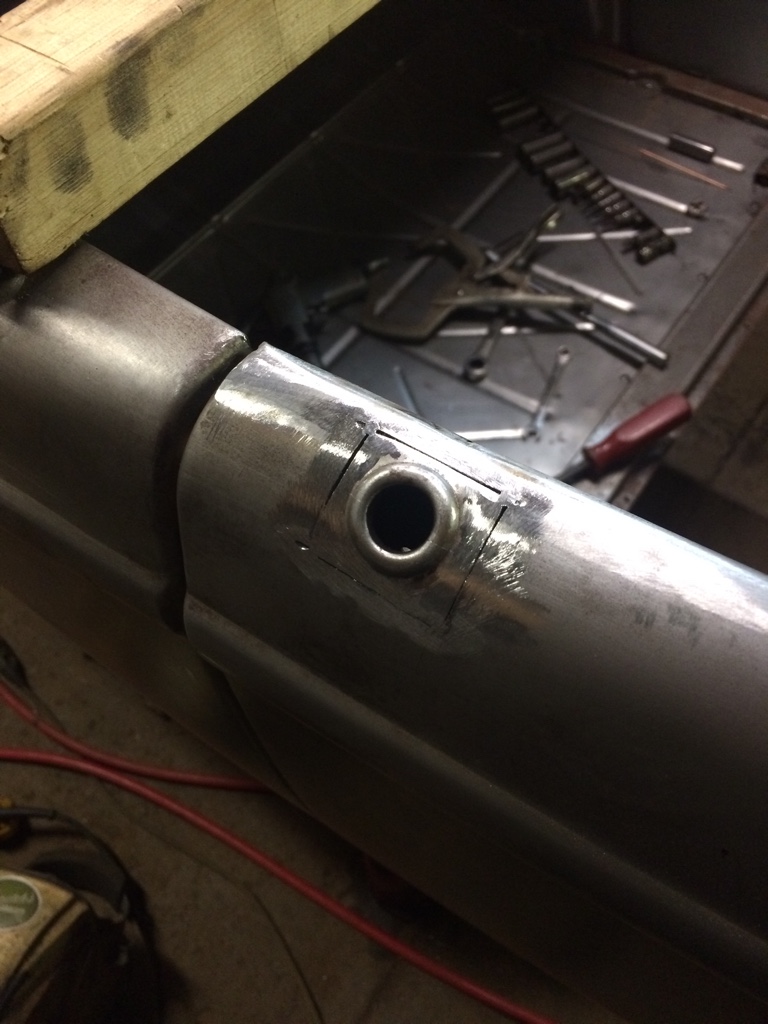

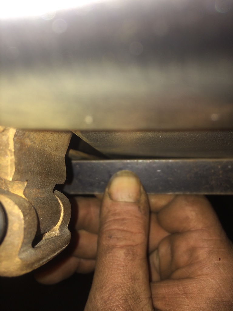

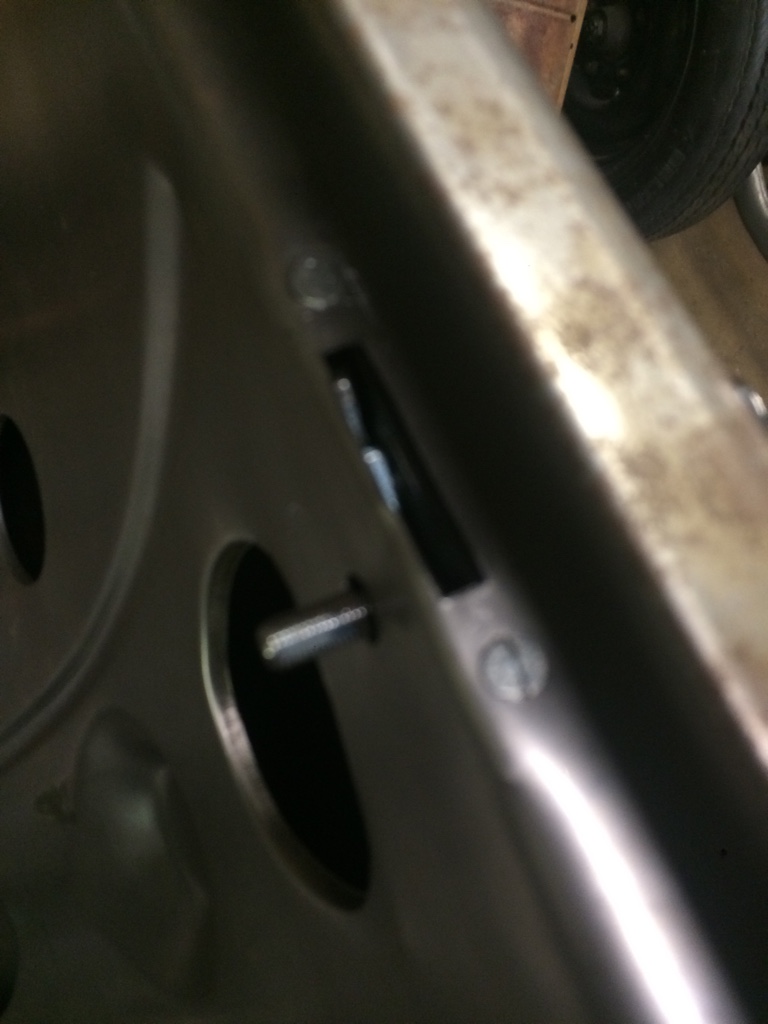

    Hinges welded and retapped so the doors fit the cowl
    Put a curtain rod hole in and gapped

    Flop

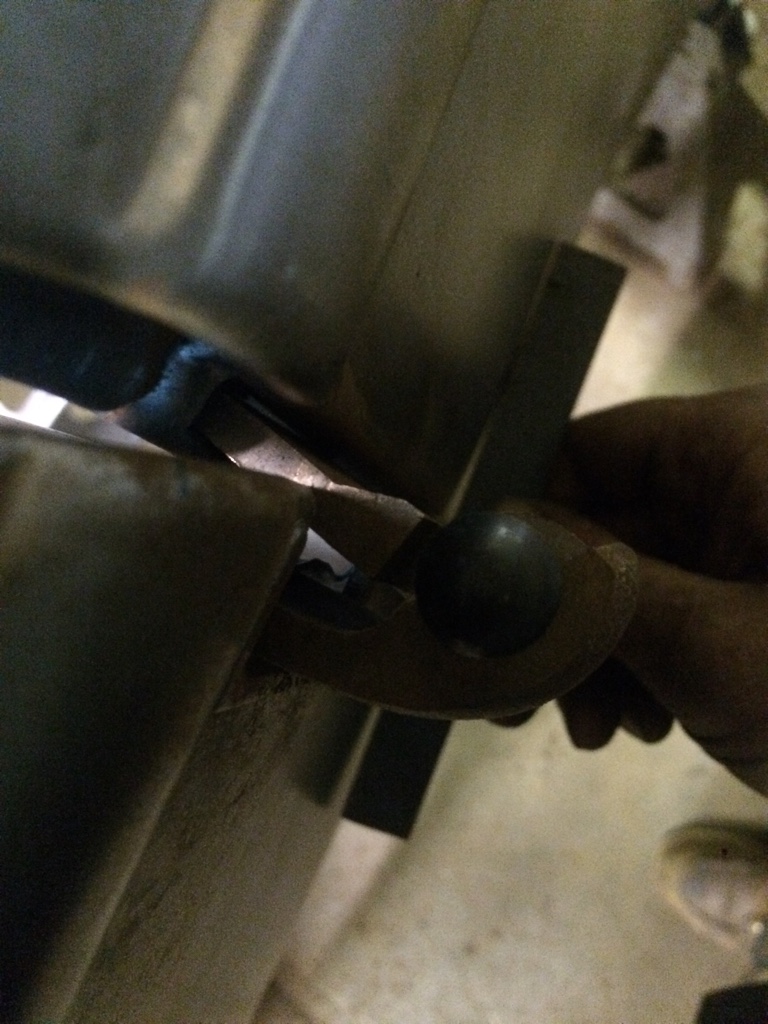

    Lots work to get that gap
    Curtain rod hole

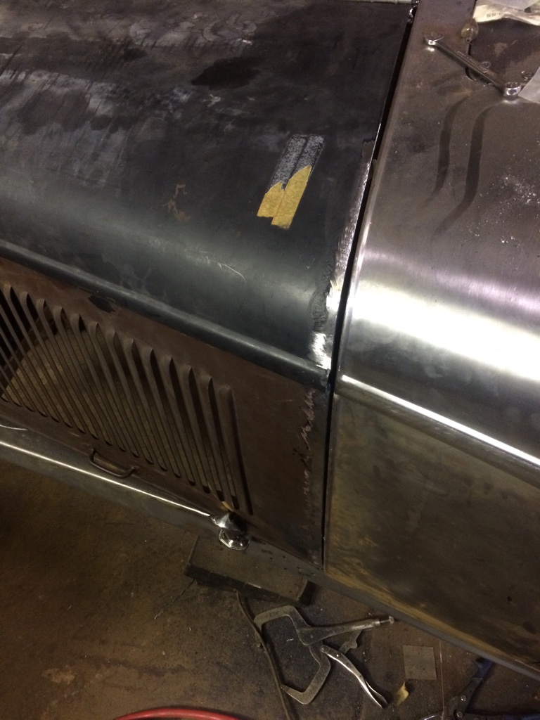

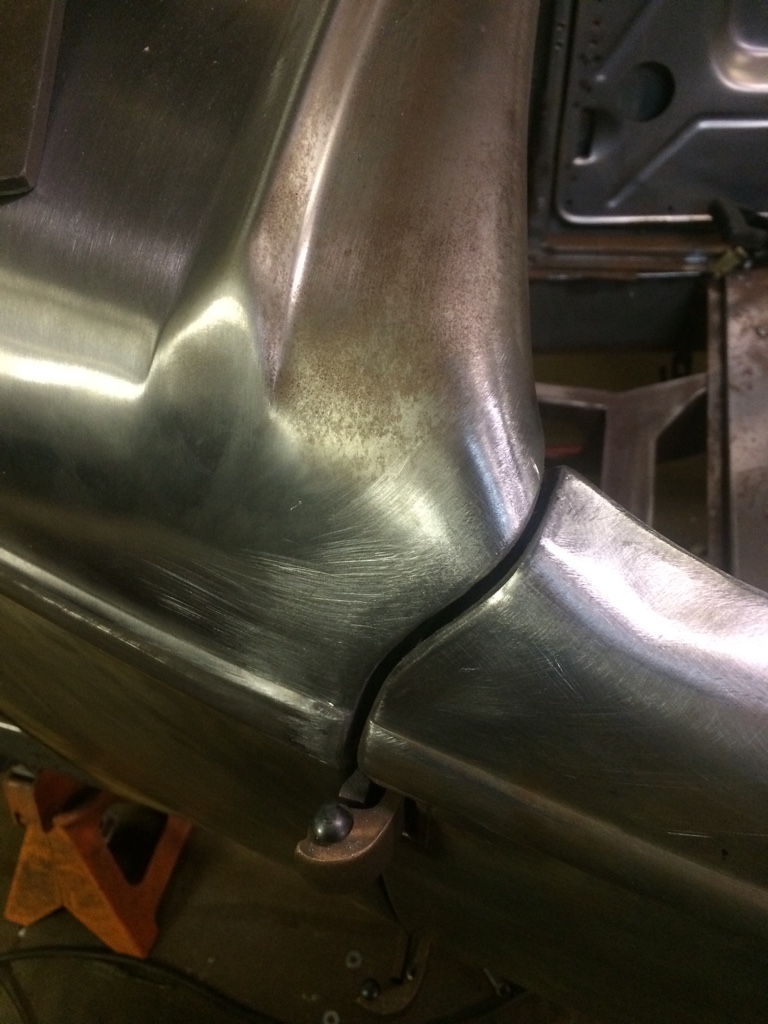

    Some gap work .
    And she's done . A lot more work then it looks to get this thing in shape . All in all came out pretty damn nice .

    Nice. I struggled with similar poor fit with my 34. Where did you source the side curtain pocket?
