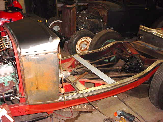

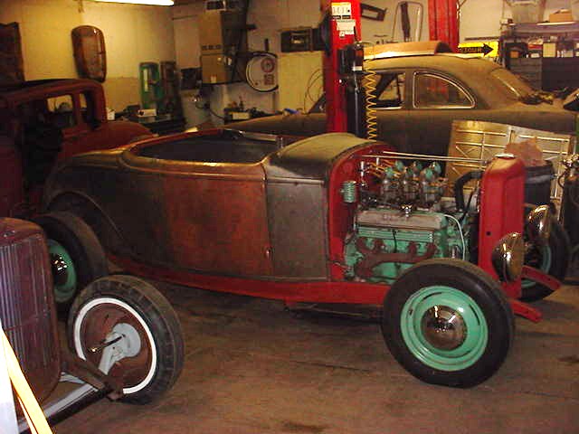

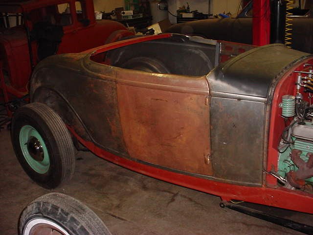

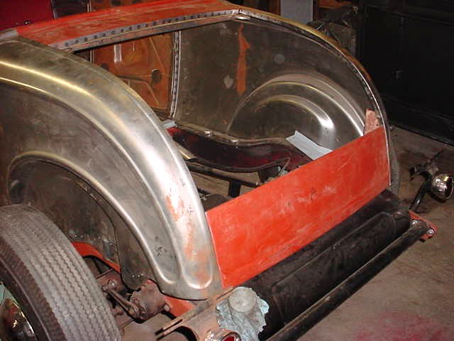

    Well some of my plans changed a bit on my 32 roadster "kit", i was gonna build it on a different 32 chassis that i pick up but decided to put it on my five-window chassis instead, (mainly cause i wanted to go a different route on my five window) that chassis was driving already so it wont take much to get this roadster going once all the sheet metal work is done.
    so here some progress, i worked on the cowl chrismas eve and got that all work out and had been working on the doors that last couple of weeknights, and saturday i worked on mounting the drivers door and got that done, then late saturday Eric (thrity-two) said he come and help me with the thing sunday, so he came over and we set about drilling a ton of holes and getting the whole back section assembled and then started fitting it to the chassis and doors, we got alot of it done but still have alot to finish, i still have the trunk drip rails to put in and the braces in the quarters to put in too, then i have to finish up the A and B pillar braces too. then i also have to get all the tops of the doors, cowl, quarters all to line up, i got the door gaps decent but they still needs alot of work, it will be alot of futsing around, but anyways, here are some pics.

    Mark, ill still buy the doors, just let me know. Im gonna use some 1x1 tubing for some added inner structures and attatchment points for upholstery.
    I actually traded a 32 tudor for all the roadster body panels, i got a few parts im missing but for the most part it was all there, i still have to get latches strikers and a dash and a few misc parts.
    I should be able to get it stiffined up this week, then finish the floors, then hook up the steering and a battery and a seat and it will be almost ready to drive.

    Looks great Jeff, man do you work FAST:D . Did you make any jigs to put her square?

    no, just lots of measuring, crossmeasuring, some bracing, some eyeballing, some standing back and eyeballing and even some more measuring!

    coupe did you mean? its the whole chassis and firewall from my 5 window.

    Im doing the same thing, building one from panels. Did you weld the cowl sides to the top or bolt them???

    Yeah, the cowl was probably the most fun part......im welding mine to the cowl side, what i would suggest doing, if your doors are assembled use them to gauge where the belt line needs to attatch to the cowl sides, mine are a bit higher than they are supose but worked ok, is your cowl top unfinished?
