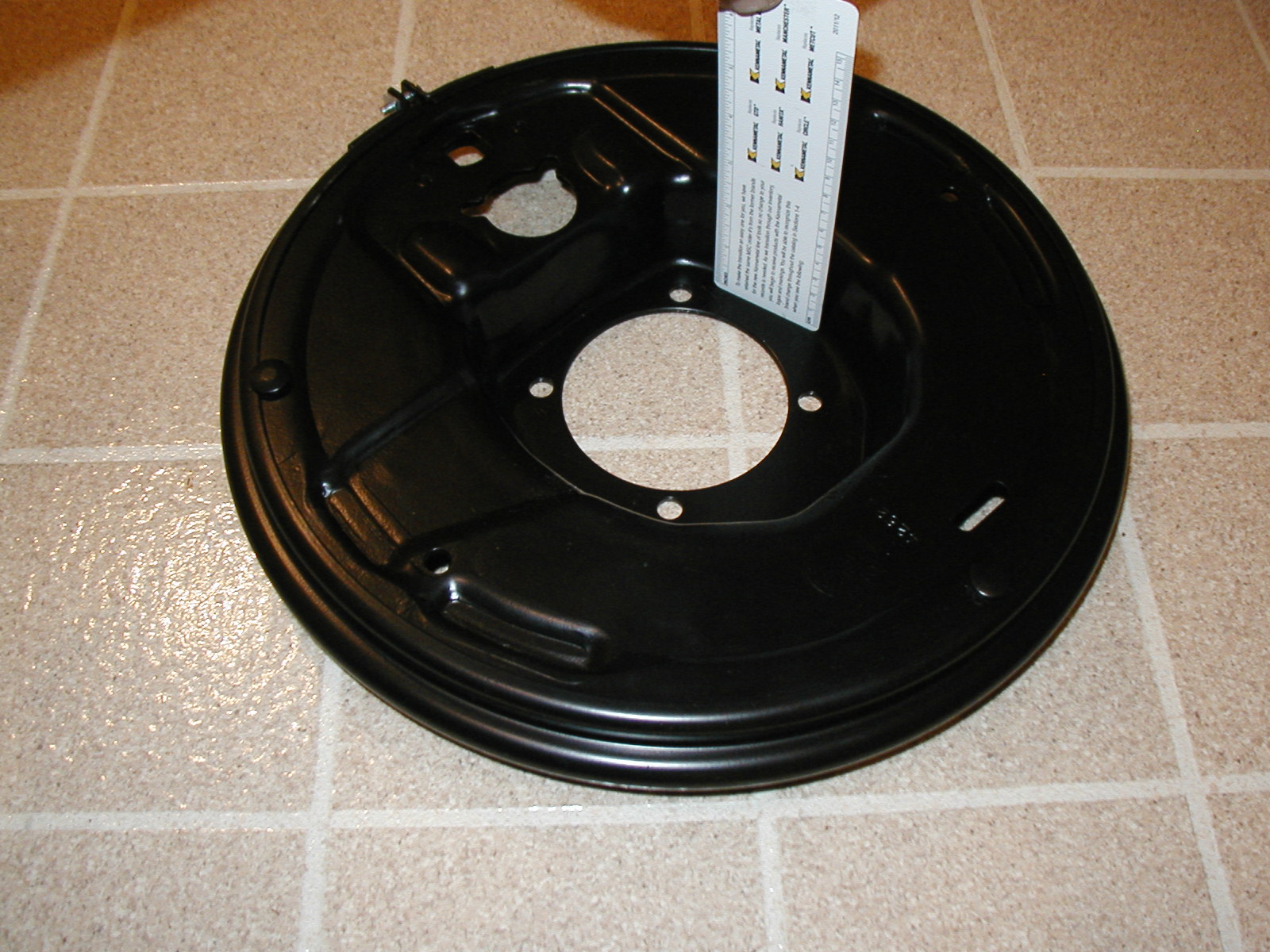

    the chassis looks great, i believe you have the more common `42-`48 lincoln backing plates. the `39 &`40 are identified by the three "rivets" that are used to locate the demountable water shields and also the `39 & `40 backing plates have a 1 3/4" deep offset. hope this helps. couple of pics included.
