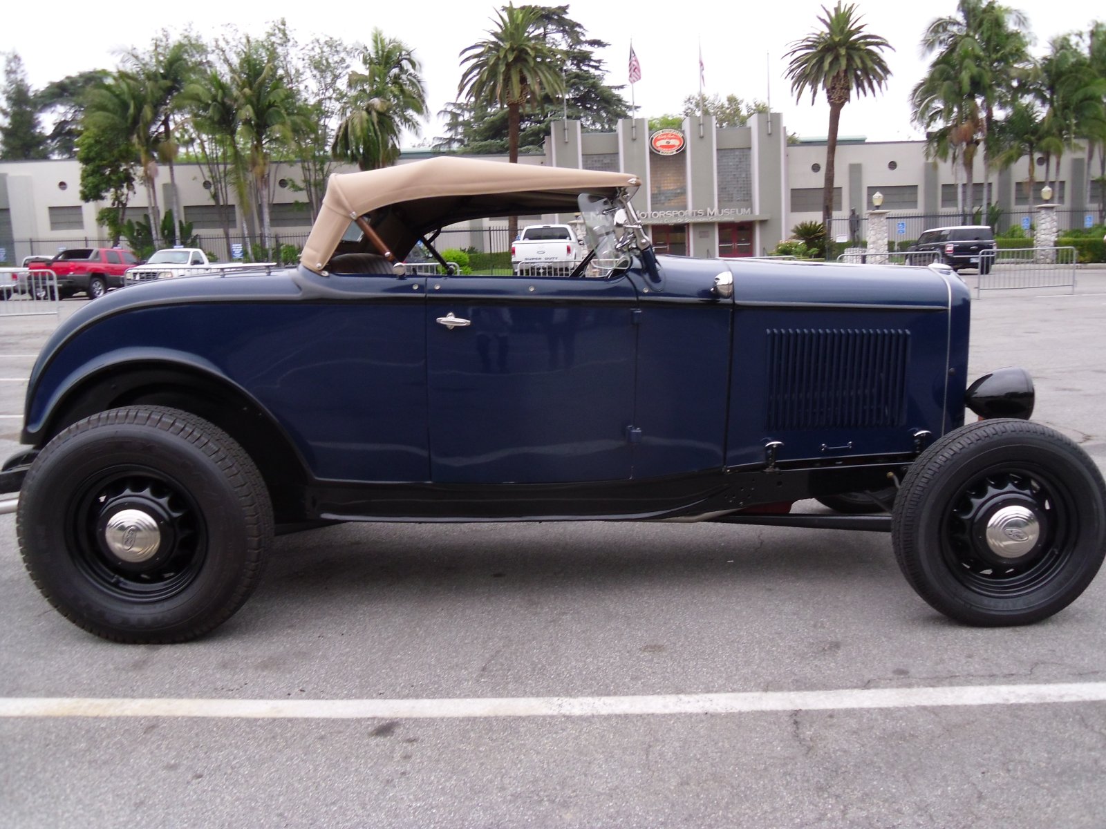

  3. RodStRace
    Joined: Dec 7, 2007
    Posts: 7,569
    RodStRace

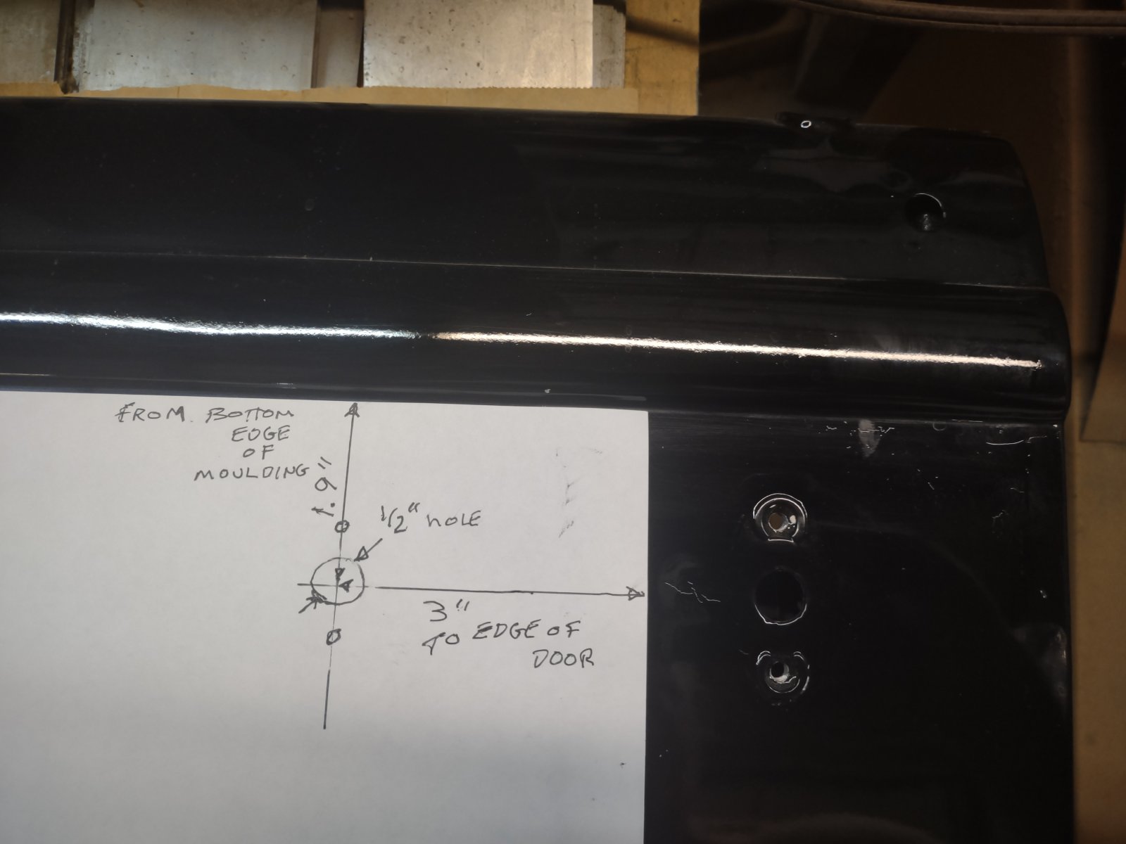

    Here is a photo of a sketch showing the location, setting on a roadster door.
    If the drawing isn't clear, it's 1.9" down from the bottom edge of the raised molding,
    and 3" back from the door edge. These dimensions are to the 1/2" diameter hole center.

  26. Thanks a lot xix32, that's exactly what I need ! Your dimensions are perfect !
    About the other suggestions, thanks too, but I haven't any square hole in my mechanism, just little plates on which we can fix rods from inside or outside handles !
