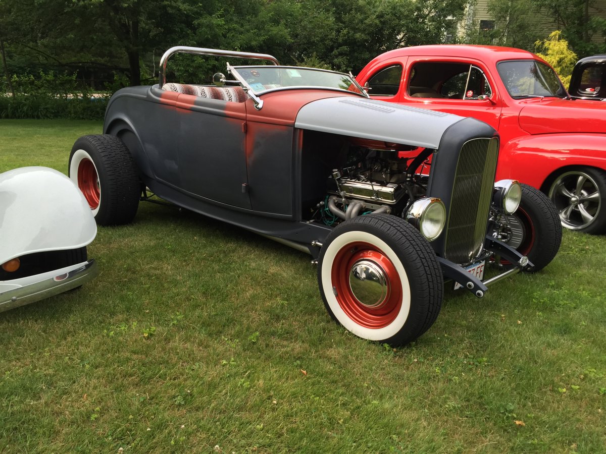

  12. This is mine with a 2" chop and modified irons and bows.
    It folds down like a stock 32.
