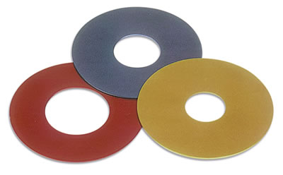

  24. Deuce Roadster
    Joined: Sep 8, 2002
    Posts: 9,519
    Deuce Roadster
    If it is doing OK without the thermostat and warms up with one ... you are having a coolant flow problem.
    The small hole in the block ( where the water pump bolts up ) and the small hole in the water pump allows coolant to move ( flow ) all the time ... no matter what the thermostat position. ZIPS do not have this feature :( That is WHY I always drill a pair of small holes in the outer edge of the thermostat. I also also only use Robert Shaw hi-flow thermostats.
    :D

  29. Deuce Roadster
    Joined: Sep 8, 2002
    Posts: 9,519
    Deuce Roadster
    http://www.summitracing.com/parts/MOR-63440/?rtype=10
    $7.95 at Summit Racing :D
