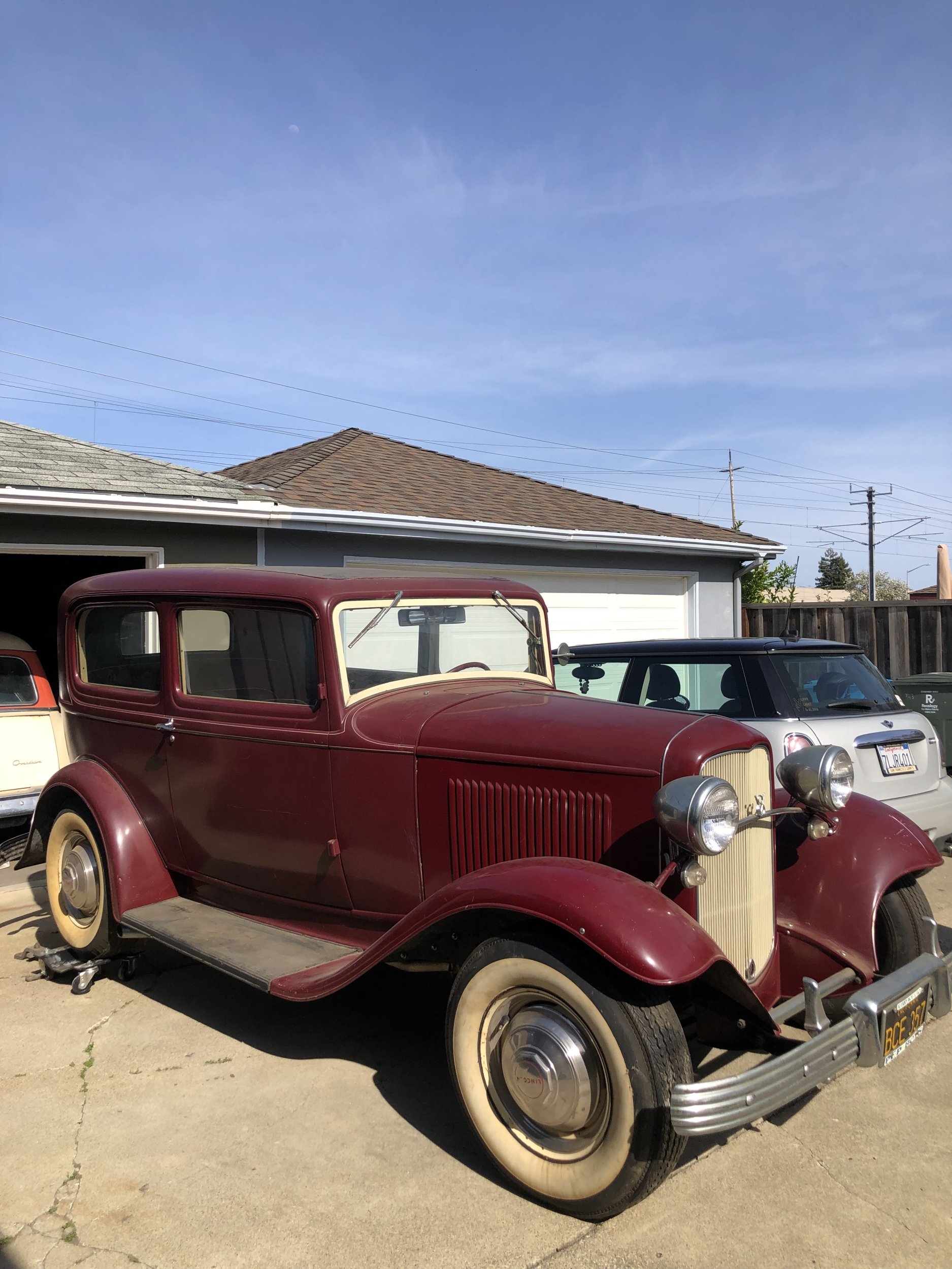

    I've known about this car for years. It was in a local private collection and recently became available. I just got it home yesterday. Overall pretty nice, painted 40 years ago, complete with a 25 louver hood. No plans ... just going to clean it up and we'll see. I do have a few questions. The car hasn't been run in about 6 years. I'm sure it has been discussed here time and again but I don't want to damage the engine so to play it safe I imagine I could shoot a little marvel into the cylinders. Anything else to do or look out for, please let me know. Is this long enough for gas to go bad? I don't have the original crank handle. Seems like it would be the easiest way to turn the motor over. Has anyone created a replacement handle? I'm sure I'll have more questions, but thanks in advance for your ideas. 20250506_120713.jpg 20250507_121103.jpg

    Gorgeous sedan! Drain the gas and oil, and replace. Squirt the Marvel as you said. I doubt it will fire off right away, so crank it a bit to get the new oil circulating.
    Before you drive it, check fluid levels in the radiator, trans and rear, and check the brake rods for looseness.

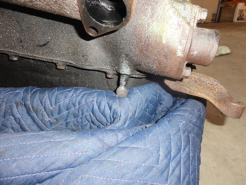

    A flathead question...this is in the 32. According to a little research, these heads are probably 1933-35. Could the block be 32 with later heads? I've also heard that some late 32 V8's were fitted with the 33 flathead. Anyone know about that? 20250608_121410.jpg 20250608_121504.jpg

    Look at the bottom of the block in front for the drain petcocks. If they point straight down, it is a 1932 block. If they point toward the outside, it is a 1933 or later block. The intake manifold is at least 1934 or later, as this was when the 2 barrel carburetor was introduced.

    Thank you. The petcock does point towards the outside, so 33 or later.
