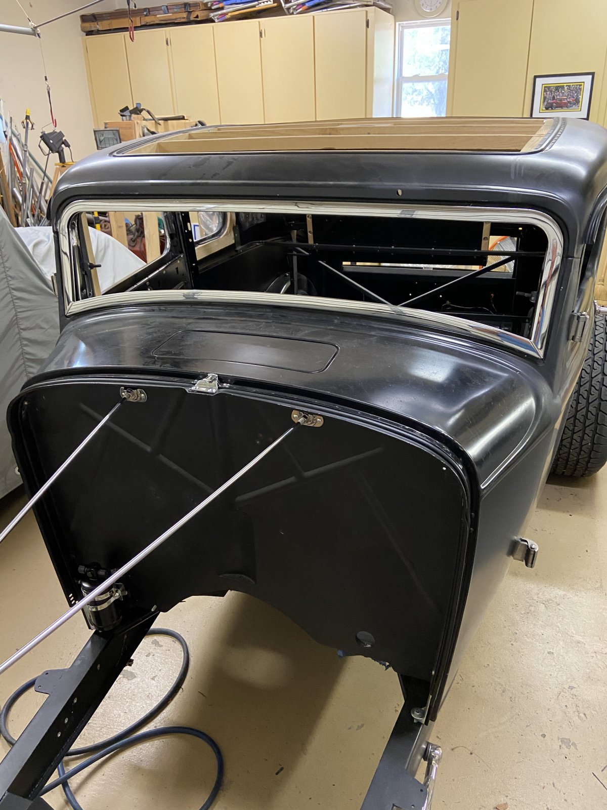

    9FB7893D-D8DC-40B5-BBBA-9B9F9CD62DE8.jpeg Not a sedan but I’m happy with this one from United Pacific.
