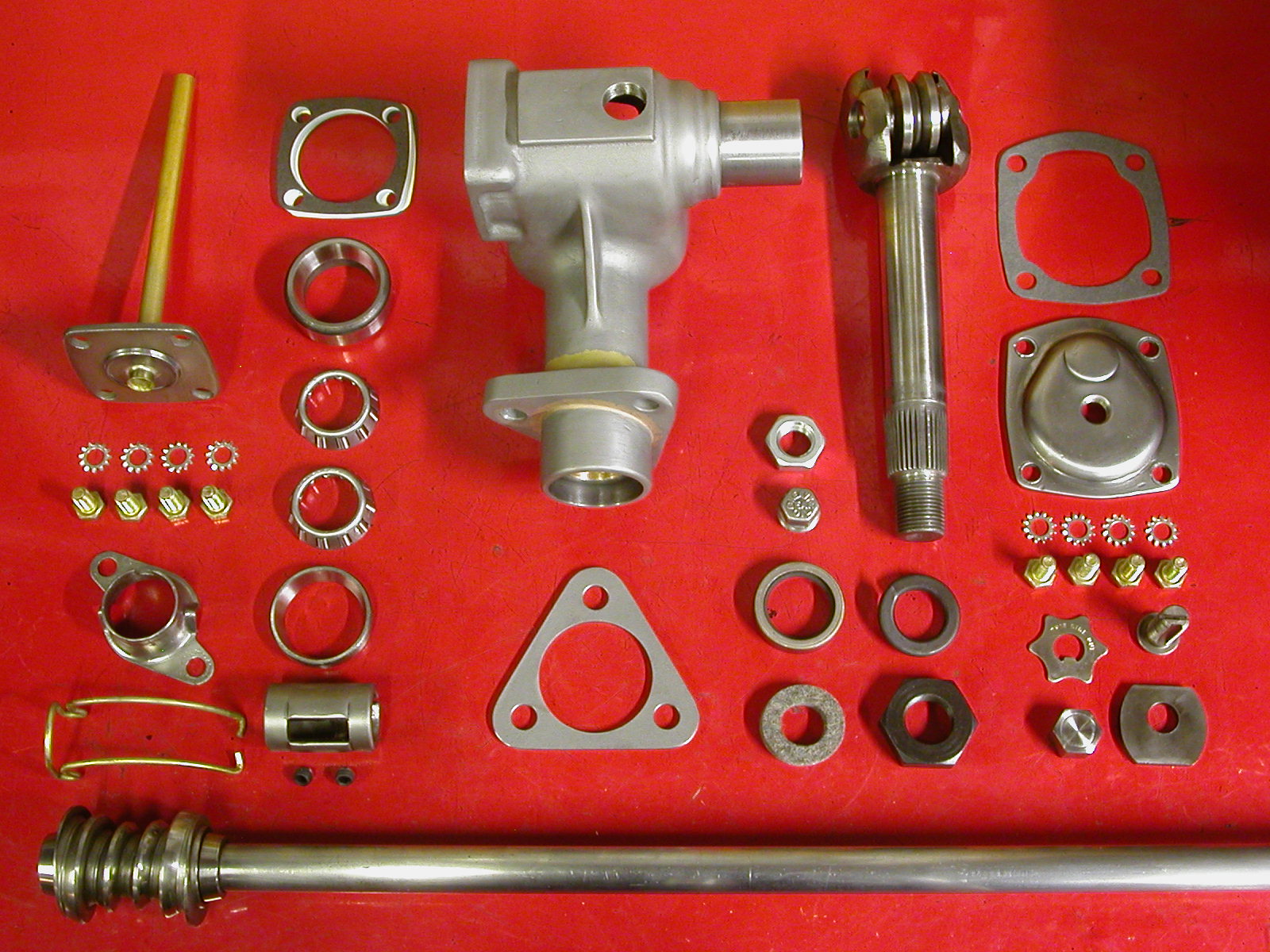

  20. Hudson Conversion - Another Option:
    I'm having Neal Jennings build a 37 Hudson conversion for my 32 - everybody I know that has his stuff is really pleased with it. He is setting it up to use the stock 32 light rod/switch setup, column, etc.. It is not an inexpensive conversion, but I wanted to have a better setup than the stock 32 (which I'm not a big fan off).
    I ran my 34 coupe with a stock 34 setup - can't say that I really liked it either (even at 15 - 1). But I had a 12" steering wheel on it too! :rolleyes:
    Guess we'll see how this Hudson setup works out - once the car is on the road, I'll report back.
    Here are comments from Neal:
    With the Hudson style boxes the sector housing has to extend through the frame. The original hole is 1-1/4 and has to be opened up to 1-7/8". The scanned page from the SR article shows the opened up hole in the frame and how the box looks installed. I know that fact has been a deal breaker with others in your situation. Others decide that they would rather enjoy driving their car and feel that out weighs the frame modification. That decision is up to you.
    Attached is pic of a typical steering box before ***embly. I use only excellent original, NOS, NORS, or new parts when available.
    As far as the steering improvement I could put you in touch with a few (****ie Burke, Tim Thompson, Dan Webb, Chris Swenson, a**** others) that have installed the boxes in their cars. The ratio is 17:1, vs stock 13:1, so steering effort is much improved. The car will steer much smoother and easier at low speeds...which can be difficult with a stock 32 box.
    Here are some pictures of his work:
    Happy New Year to All!
