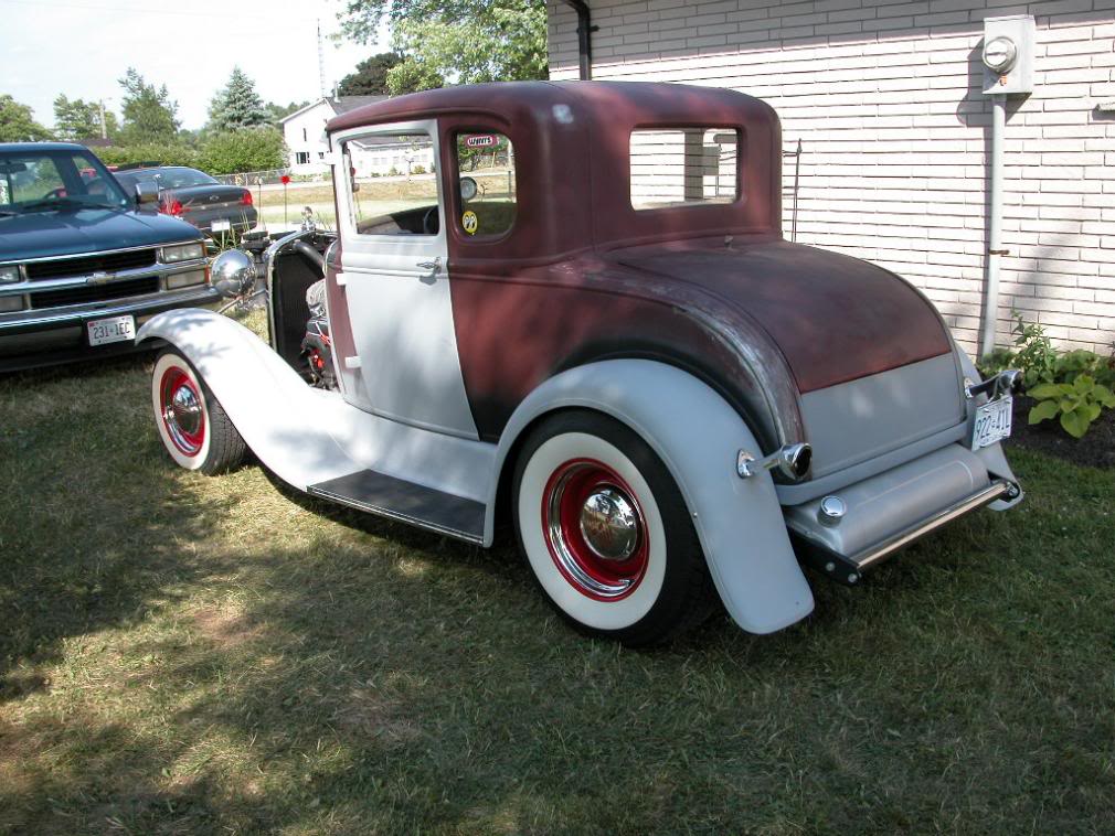

You think that looks like a hemorrhoid? I think it looks like it belongs there. When we did ours we mocked the tank in place without the fenders & it looked screwy, kinda like a duck dragging its ass. when we mocked the fenders into place too it looked good. Our frame has coilovers and the rear crossmember kicks out around behind the diff. We built a frame section to hold the tank and then put two pieces of 2X3 tubing down from the frame behind the diff. Worked out really well, the tank fits up really snug under the back of the car. the scrub line is such that even if the coupe were to lose both back wheels entirely, the tank would not hit the ground. The stub sections of the deuce rails are not on the same angle as they would be on a stock deuce frame, they are closer to level . We have yet to modify the frame horn covers to fit the model A fenders but it is on the list of to-do's. There is about an inch and a half between the tank frame section and the coilovers. Here's the pics.
