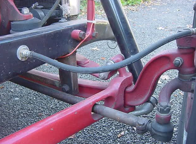

  5. Asking about traditional placement of over or under, sometimes it has to be be like this.
    Photo borrowed from user -- **DONOTDELETE** -- from a searched post from April 15, 2004.

    I've seen that done but man it looks scary to me! It is surprising how much front to back travel the tie rod does when turning side to side. I couldn't bring myself to chop up my '32 wishbone.

    Yikes , no way, there has to be a better solution. I

    people have been heating and bending steering arms for decades. I heated and bent them on my 40. they are forged and it will not hurt them to heat and bend them. yes the tie rod needs to be below the wishbone

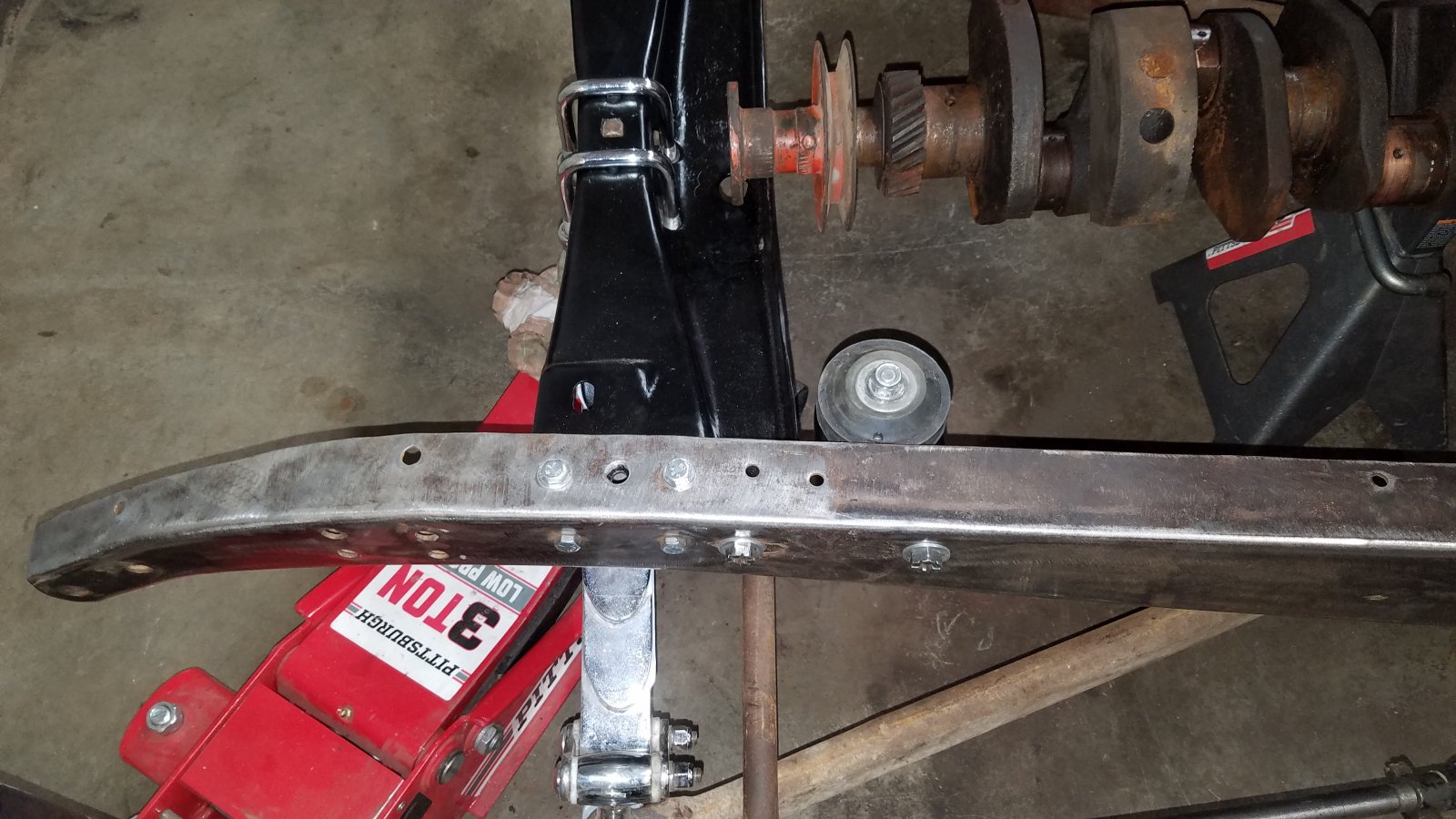

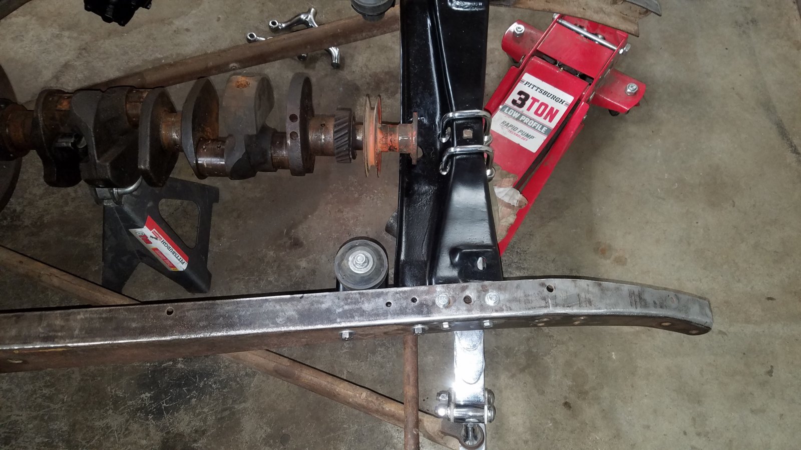

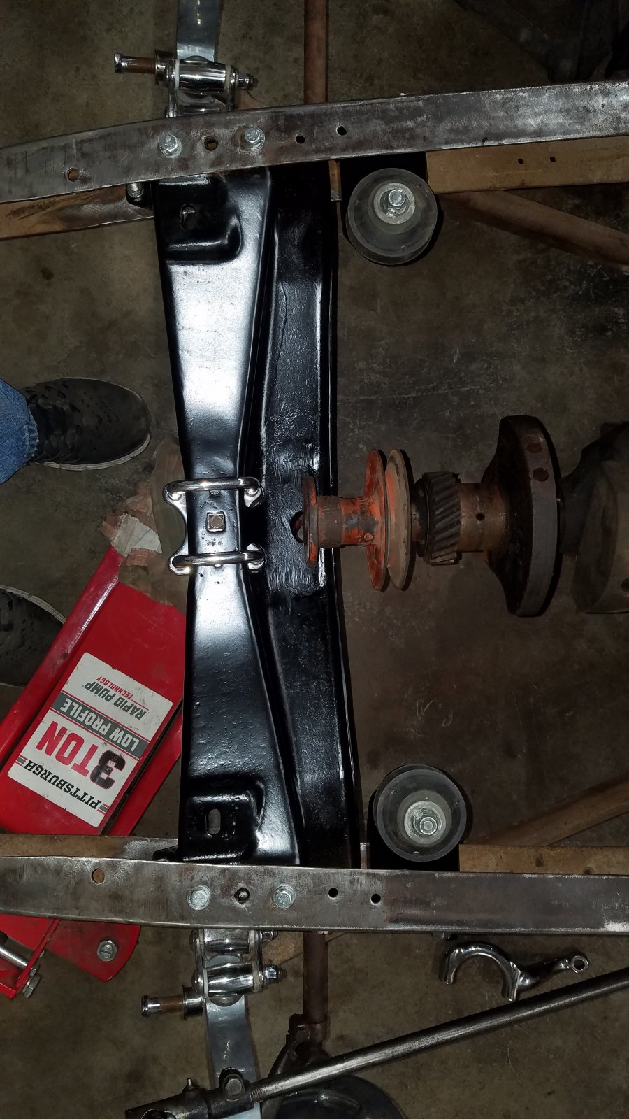

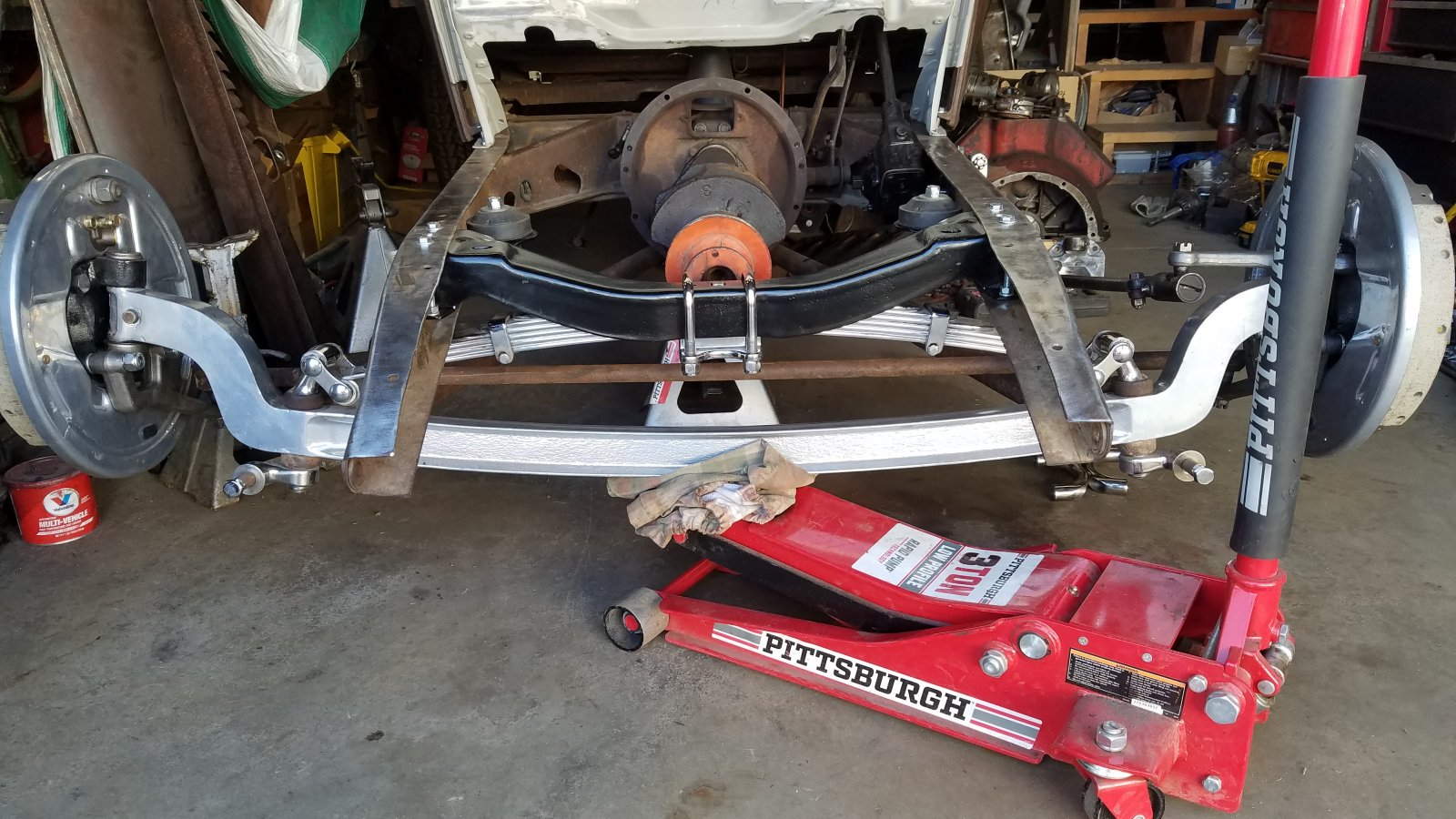

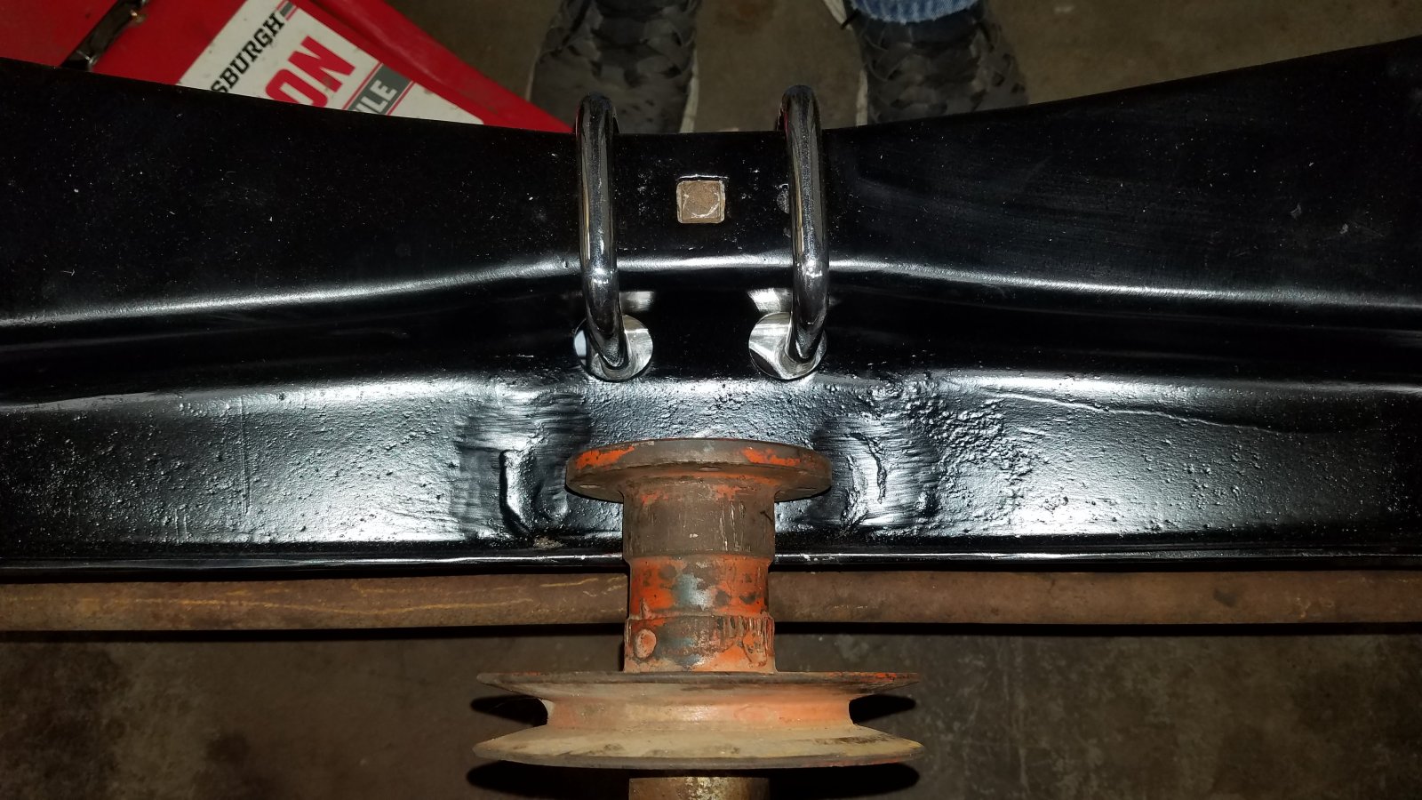

    Going under the wishbone isn't an option with the 5" drop as it will be below the scrub line. I went out and took some pics. Right now I have the CE dropped lower arms on it, which are tapered from the bottom, for a 4" drop axle. I have a '47 tie rod mocked up from the top, non tapered side and the tie rod is just a tiny bit above the wishbone. I could heat the CE arms to bring them up and taper them from the top and that would work as long as I can make it clear the crossmember. The spindles are new and came with the axle, etc. I want to run bolt on arms. There is also a pic of the polished AHR arms that are pretty close to stock drop. They would work with hairpins or 4 bar, neither of those options do I want to use on this. I'm not really up to dropping the stock '40 arms and they also need re bushed and reamed. So, I want to use the new spindles and bolt on arms. The CE arms are forged steel, so they can be heated and bent. That, I can do. Have 7 degree reamer available as well.
    Here are some pics. Ignore nuts and bolts and nylocks etc as they are all just mock up. Crossmember will be riveted in for final assembly. A few of the pics from above are wheels centered tie rod location and wheels turned full lock left and right clearances. If I went with a Shadow Rods rivet in crossmember there shouldn't be a clearance problem with tie rod. The other thought was to take a pie cut out of the rear valley of the Model A member and make it come in in front of the center 4cyl engine mount hole, which would also clear the tie rod. I'm concerned about that stock member being weakened by all these mods. I have already cut and filled the ends like Ed LLoyd? does on his '32 frame builds and also V'd out and welded the cracks in the center around the spring seat area.

    Oh yeah, the '32 tie rod ends interfere badly with the Lincoln backing plates at this time so later tie rods it is.

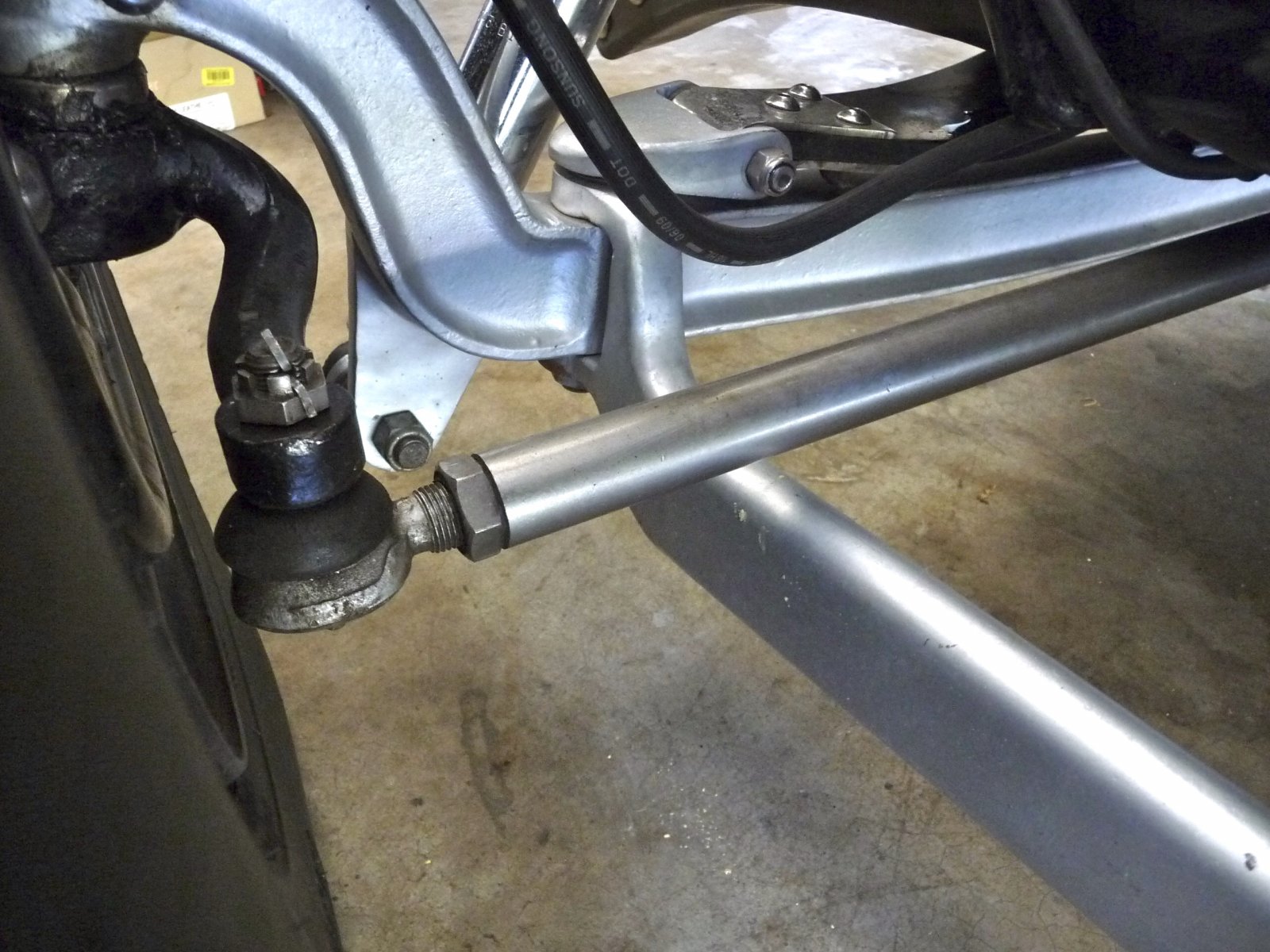

  16. Deuce Daddy Don

    Just like the dwollam pix says.----Did mine the same way.

    Don, can you clarify that a bit more? Did you go over the wishbone?

    @krylon32 , frame clearance isn't really a problem, just the crossmember center lower section. That's why I was considering either replacing it with a Shadow Rods unit or trimming mine way back. If I bent the lower arms a little the '32 tie rod would probably be fine. In fact because of the angle the CE ends sit at, just twisting them level should make them clear.

    alchemy
    The back edges of Model A crossmembers have been trimmed since the beginning of hot rodding. Trim the bare minimum and you should be fine.

    @'28phonebooth , Below is the link to @edwardlloyd 's '32 frame build thread and the mods of '30-'31 crossmember and at the bottom of the 1st page is a pic of the Shadow Rods crossmember. It is made to rivet in and has the end plates made into them. Others I have looked at online are either weld in or have the holes already drilled but those don't show show the ends or describe them fully so I don't know if they have end plates or not.
