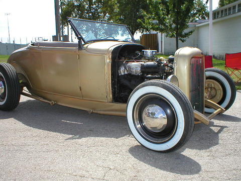

    I ran one for a long time because the 32 truck grills fit on a Model A radiator. The car grills don't. I was happy with it because I was running a hopped up banger.
    Once I did the flathead swap and got a 32 radiator, I switched to the car grill. They look nicer

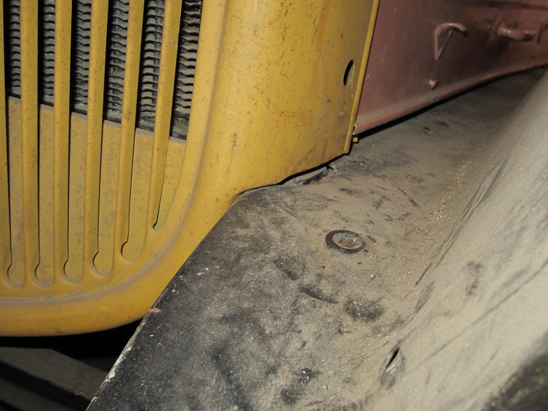

    Will a '32 commercial shell fit on a Model A radiator?
    We've got a '32 passenger car shell to put opn this A truck. The patina would match perfectly. We haven't switched shells, yet, because the radiator on this truck is great. We've got a '32 radiator, but it's not as good. It runs so nice and cool the way it is, we don't want to sacrifice dependability for vanity. If a commercial shell would fit this radiator, that might be perfect.
  22. here is a truck shell on my old 30A roadster I built several years back
    [still belongs to Hamb'r Legendary Lars]

    I've got a stock (or reproduction?) A radiator in mine. It hangs right on it. I don't have the hood hinge retainer supports on, so the hood is just laying on top, but it all lines up. The lower attachment hole lines up pretty good, the upper need to be lengthened. Matches right up at the fender and frame.

    That dont look original Henry unless someone welded up the filler hole on top.
    If the Radiator is too high:
    1- THere's two differet Model A front crossmembers. One has about a 1/4" drop at the radiator mounts. I've cut them out & flipped them around to lower the radiator.
    2 - Put a straight edge (maybe 2"X3"X90" metal beam) on top of the frame to see if its bent.
