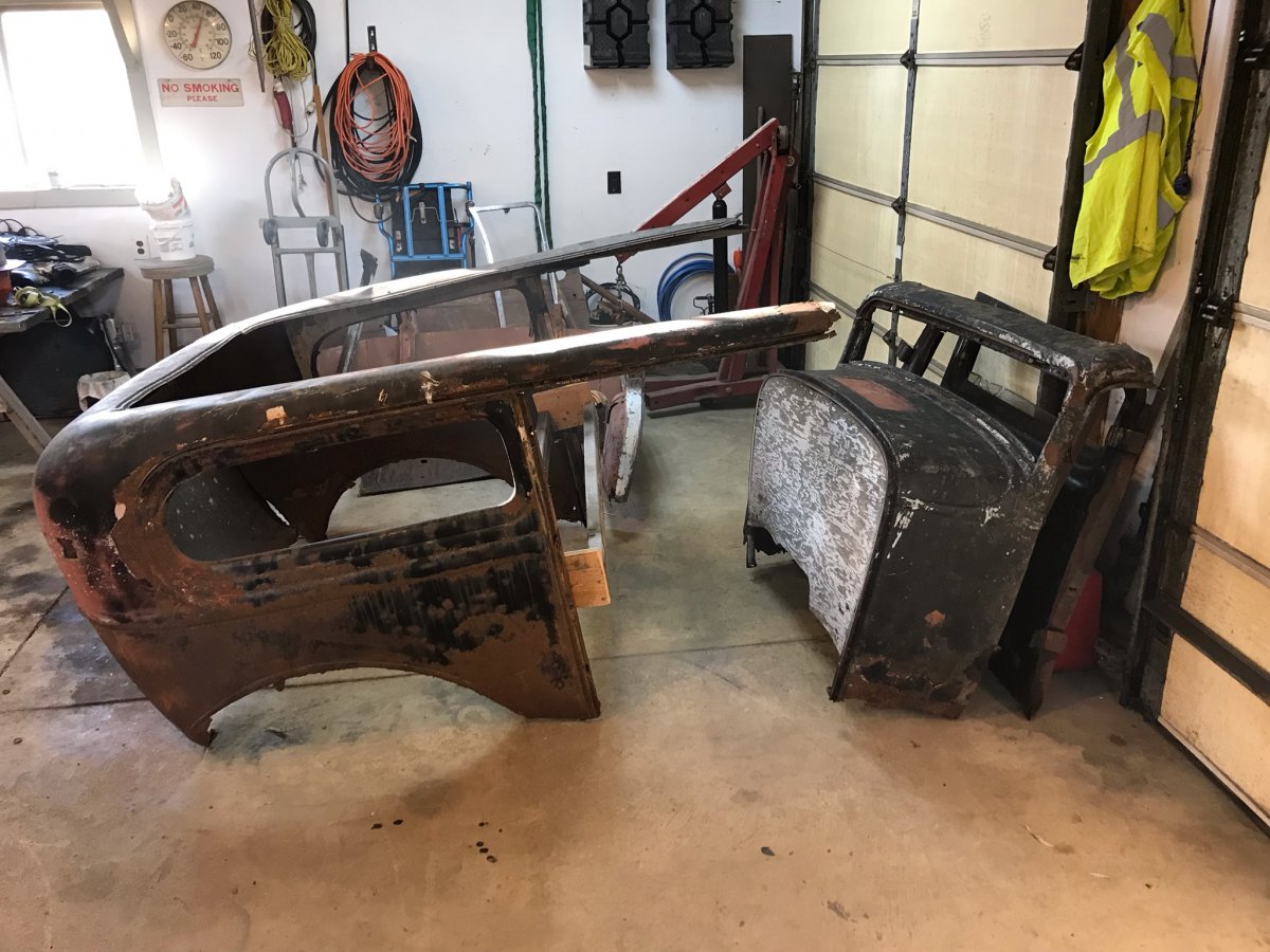

    I figure I'm far along enough to start a build thread on my 32.
    I found the body of Facebook in Eastern Tennessee. Made the deal and my Dad and myself made the 20 hour round trip to pick it up.
    My first plan was to build it full fendered, heavy chop, spindle mounts, and pull the blower motor and trans from my 34 truck and run that. As I started working on it my thoughts changed. I don't need to sell my truck, so I'll keep it and put it back together again. I want something I can drive daily, when the weather is decent. I also want something I can road trip in. I'm doing to Power Tour this year with my Dad in his Camaro. I want for us to do a road trip in the 32, hopefully Bonneville.
    The new plan is no fenders, full hood and satin paint. I'm a big fan of 51farmtruck's Tudor and Eastwood and Bakarat sedan. This one will be similar. I'm definitely not trying to reinvent the wheel, just a bad *** hot rod that I can drive the **** out of.

    It depends where you measure it. it looks like most of it is around 4-1/2" but its very uneven. The front side of the p***enger window is 5-1/4"!!
    It was so floppy we keep losing the door gap and the b-pillar. So, we kept adding to it. It's so much more study with the bustle tacked on.

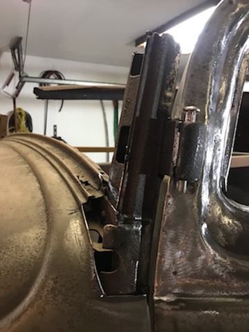

    I tend to bounce around on a project not to get to burned out. I started to fix the bad chop on the drivers door.
    The plan is to get the doors right then make the roof fit the doors. I got the idea watching the videos of Walden Speed Shop chopping a 32 3 window. The roof and chop were so bad on this thing, I figure it would be the best way to get it back in shape.
    I do have a stock height p***enger door. I used that to make a paper template of the window opening. The driver side was chopped 5-1/8" at the back and 4-7/8" at the front. The p***enger side was 5" at the back and 5-3/8" at the front. I wanted a slight wedge with the A-pillars laid back. I ended up with a 5-1/8" to 5-3/8" wedge.
    I made a wood buck off of my paper template from my stock height door with my measurements. This way I can make each window exactly the same.
    I cut out all the bad chop from the door and stole another top from a donor door. I used the buck to lay the pillar back and make the fit perfect. There was quite a bit of rework in the front to make it all flow. A lot more then I first thought. I basically rebuilt everything new from the hinge up on the inside.
    Once the door was done I hung it back on the car and sliced and laid back the A-pillar to match the door.
    I have the p***enger door going back to together and hopefully I'll be on to the roof soon.

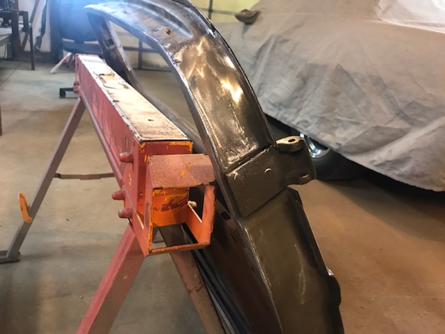

    It’s 16 gauge I had broke into a c-channel. I used my shrinker/stretcher to give the correct curve. Then it’s spot welded into the original b-pillar.
    In hind sight the 16 gauge was overkill. I think 18 would of been way strong enough, especially with the dimpled holes. Avatar1590007598.287174.jpg
