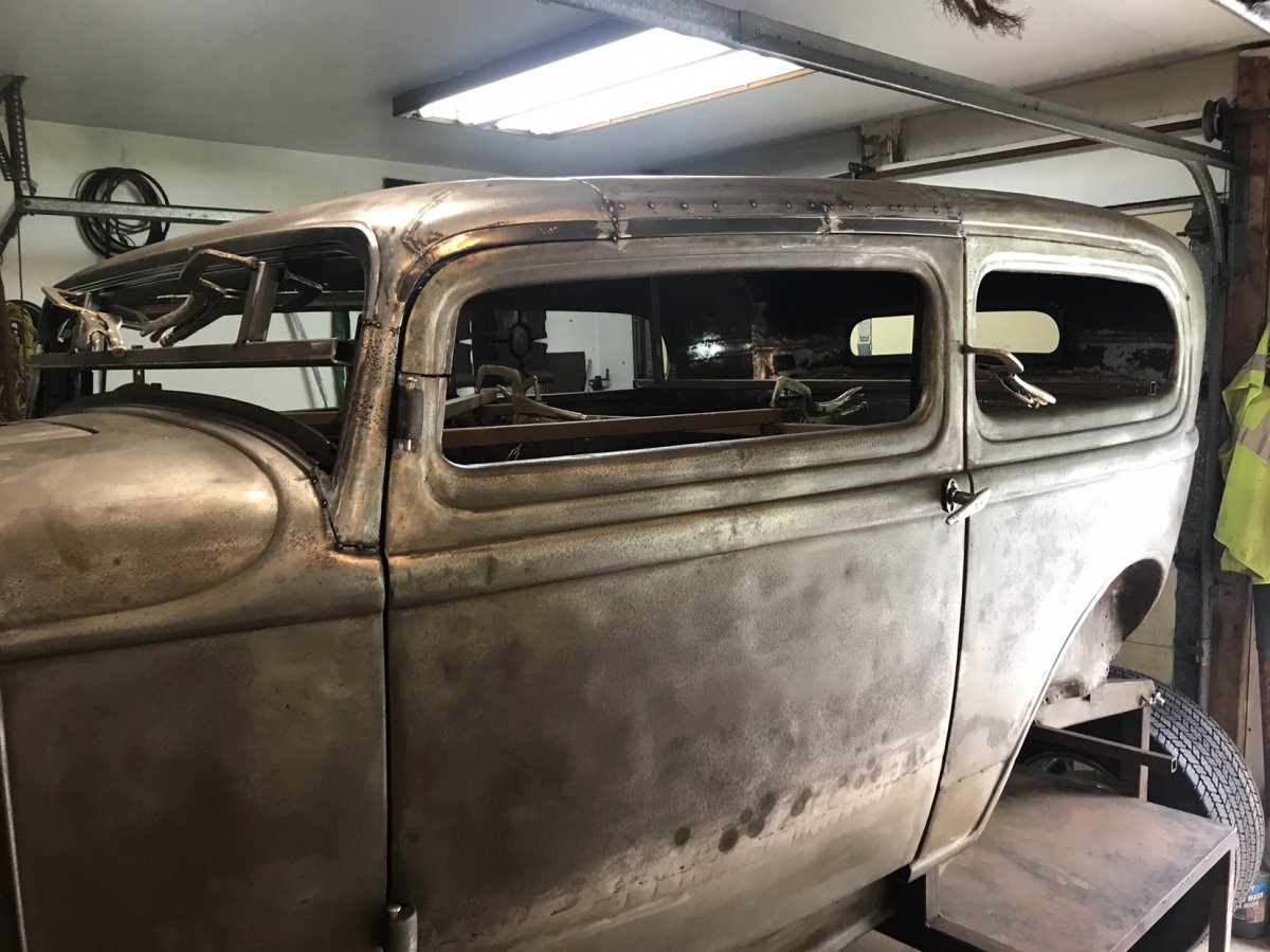

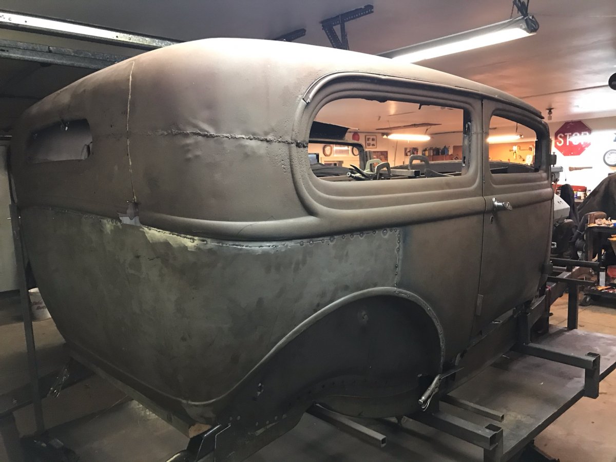

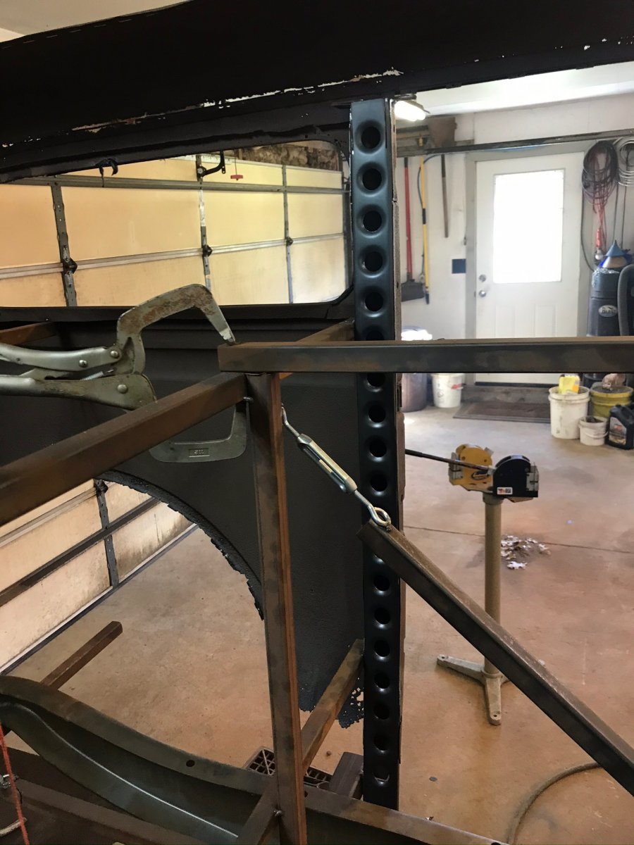

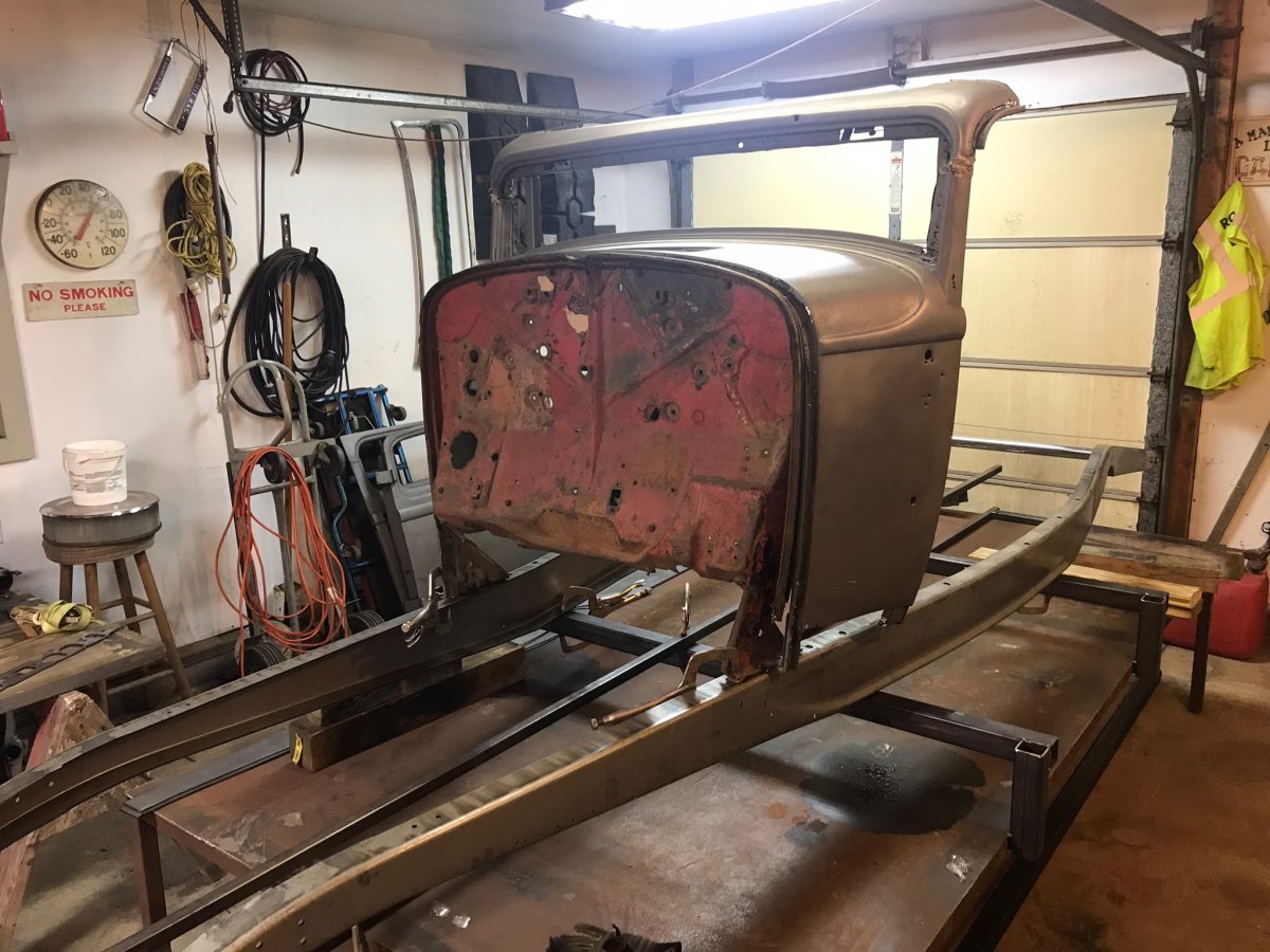

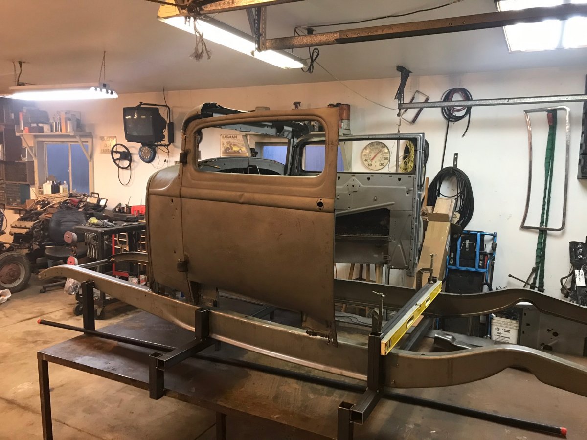

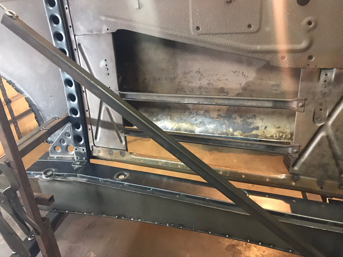

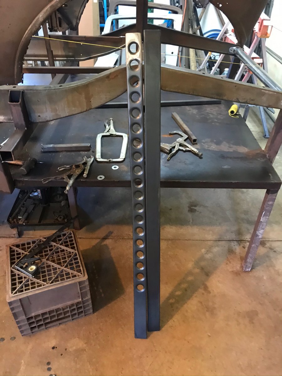

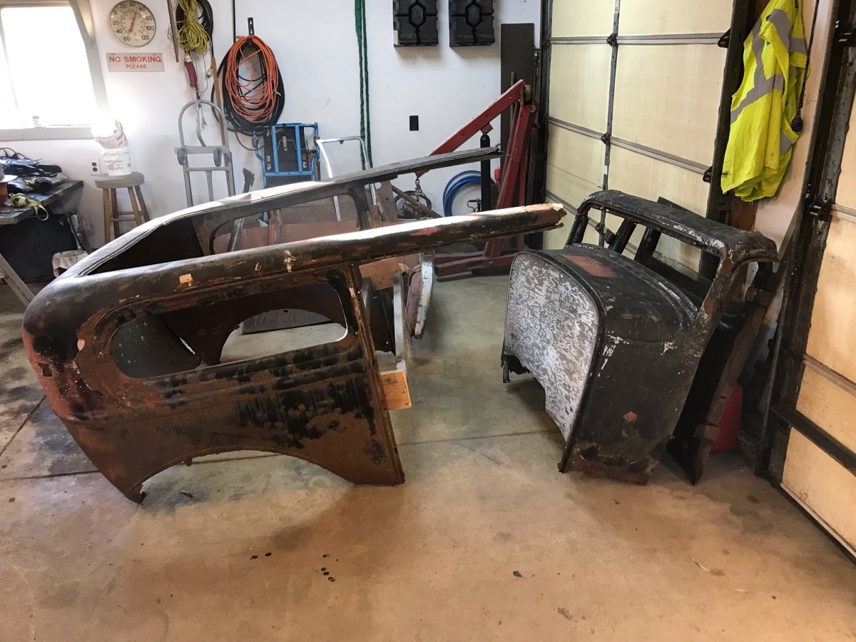

    I got my roof, so I figured I’d give it a go fitting it to the car.
    I did some searching before I bought it to see if anyone had used a coupe roof to fix a sedan. I found guys going from a fordor to a coupe. But not from a coupe to a sedan. I was a little nervous dropping almost a grand without knowing for sure the profile would be the same.
    It ended up being a smart buy. It fits great and as far as I know it looks right?
    The only difference I see is that the hole for the insert is back 1-1/2” farther then the sedan.
    Most of the bad chop is fixed and all the brazing is gone. The only part of the brazed in panel left, is the bead line under the window.
    I also straightened out the chop. It was 3/8” lower on the driver side at the c-pillar.

    Thanks guys, sometimes I forget how much it’s chopped because I don’t have a stocker to compare it to. Then I look through the the front windshield and realize, it’s hammered.
    ****, I have no idea how many hours. All I can say, is a lot! Its been quite a challenge getting the body to this point. I’ve followed a lot of threads on here of guys saving one and I thought I can I do that. It’s not as easy as I thought.
    Saying that, once the header is on. I think I’m at the turning point on this thing.

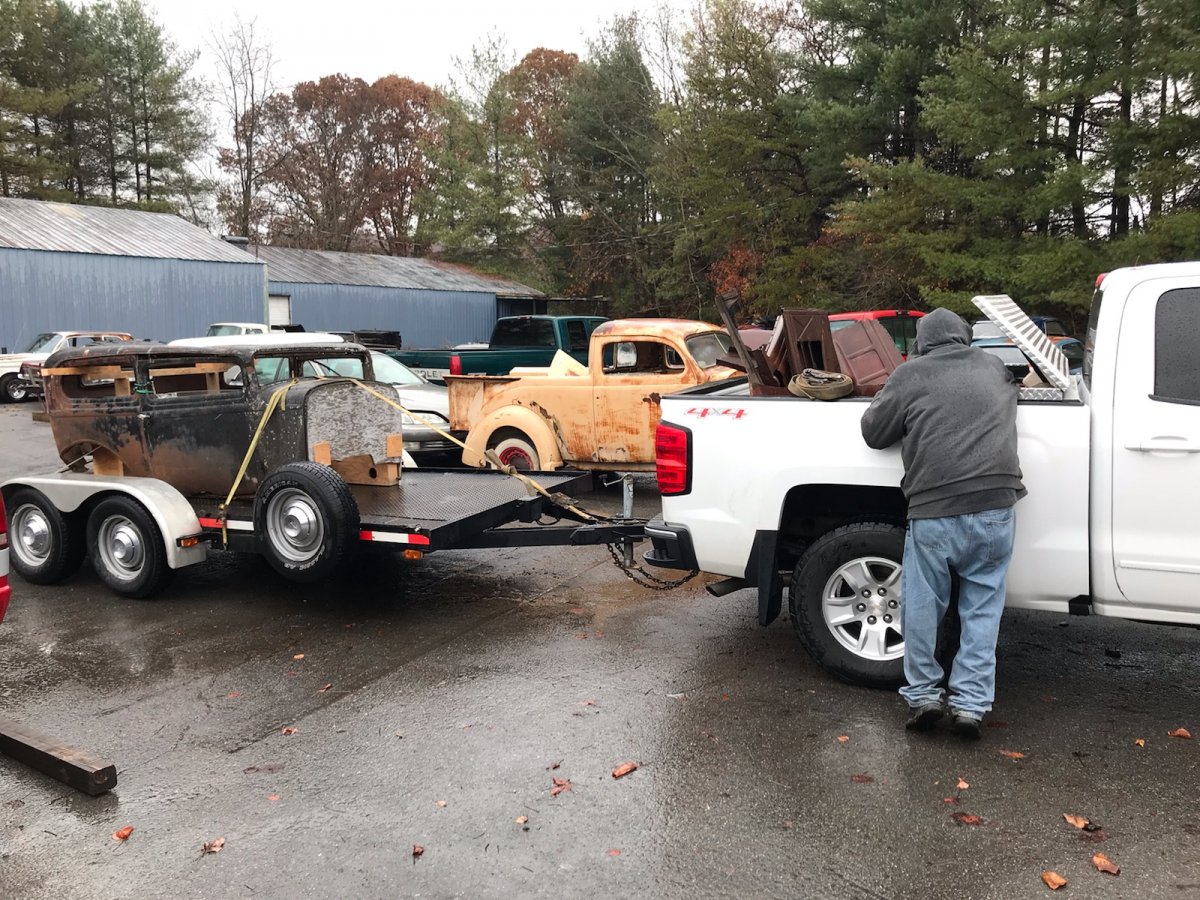

    The guy I bought off was named Patrick in Surgionsville. He had a lot of cars!!

    Thanks, Yep my new buddy Patrick, my dad had a field day checking out all his cars.
    He said some local guys looked at it and p***ed because it was so rough. I guess I’m the only one crazy enough to tackle it. Haha

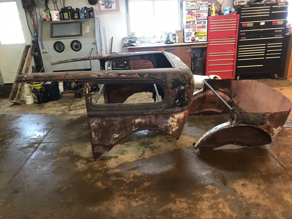

    The story I got on this one. The guy I bought it from, got it out of Asheville NC. It was built in the 50’s as a drag car. The property where it was at had a bunch of cars and the city was on the owner to clean it up. Someone came in and offered to clean property if they could keep the cars. I’ve talked to Patrick who I bought it off of to get his contact info. But he p***ed away a few years ago. I’d love to know more about it.
    I think these images are from when it was in NC.
    Thanks Dan hay, I probably should of p***ed too. I didn’t realize the roof was as bad as it was. And that the back panel was a brazed in mess. But I had made the deal and a thought I’d better figure it out. My dad was actually really positive when we first saw it. He said “you can fix it.” I guess he has more faith in me than I do!
