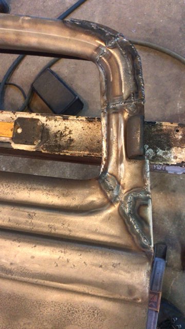

    Update time....

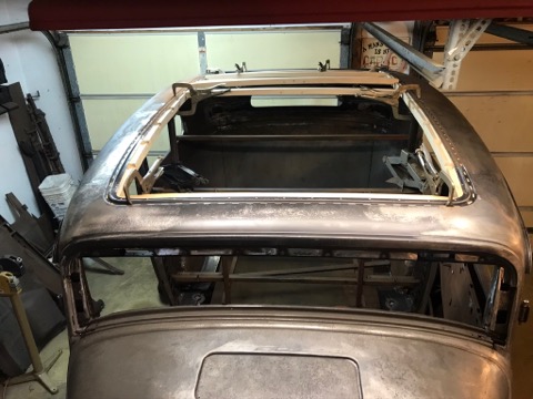

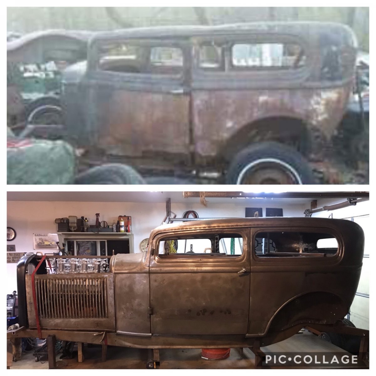

    I've got the p***enger side roof, door, and drip rail caught up to the drivers side.

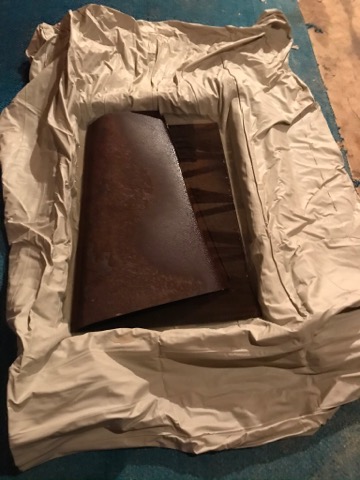

    I de-rusted my set of 25 louver hood sides in vinegar. This was my first attempt using vinegar. It was super happy how it worker. The hood sides are rough but so was the rest of the body, so why not save them? I've had these for about 10 years. I bought a 32 BB parts truck and they were on it. I've hung on to them for all that time. I'm excited to actually use them.
    I picked up one nice hood top from @hotrodhoodlum and I'm soaking the other one that came with the sides.
    The inner header panel is in and tied into the A-pillars. Plus I finally got some bracing out of the inside. It's starting to get nice and solid.
    Finished welding in the header panel and fixed the insert channel with what was left of the UPAC roof.
    Chop ended up 4-7/8" to 5-1/2".

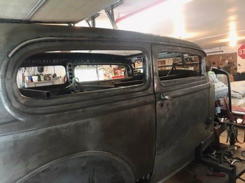

    One last update, then I’m moving again......for the the 6th time in 5 years! The updates will slow a bit until my shop is ready and I get the 32 moved over there. Hopefully in a couple of months I’ll be at it again.

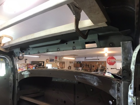

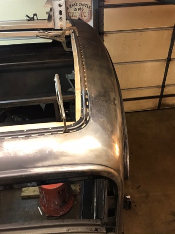

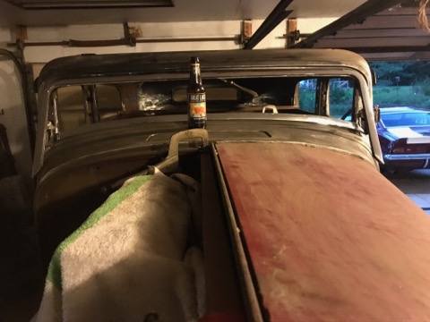

    I got the roof wood glued, screwed and polyed.
    I also stumbled my way through woodworking. I had to extend the main rails 1-1/2” because the coupe roof insert opening is back farther.
    This thing was rusted everywhere. I fixed the back of the A-pillar under the door.
    I finished the welding around the insert channel and straightened the rest of the roof.
    Next, I made the inner pieces over the doors. I didn’t have anything to start with so I built the pieces with my shrinker/stretcher and brake. I was thinking about buying the wood for over the doors. But I figured Id build something cool. Plus I got to use my dimple dies again. It took me 3 tries. It was a ***** getting all the holes even and straight. I used a “drill guide” to get it right.
    All of this will be exposed. I really want a raw look for the interior. The holes will continue past the quarter windows.
