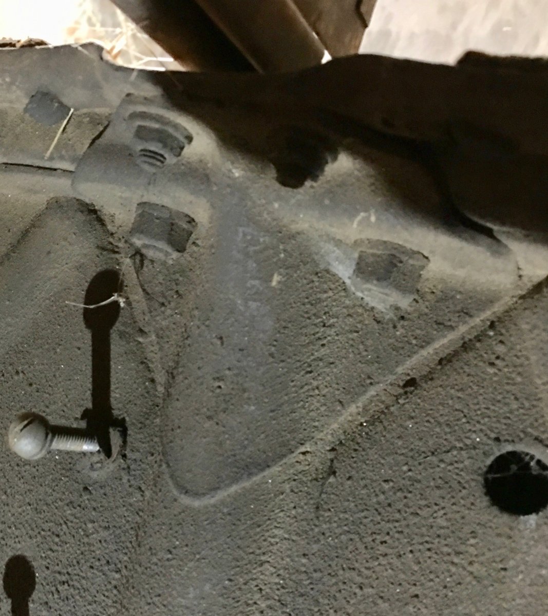

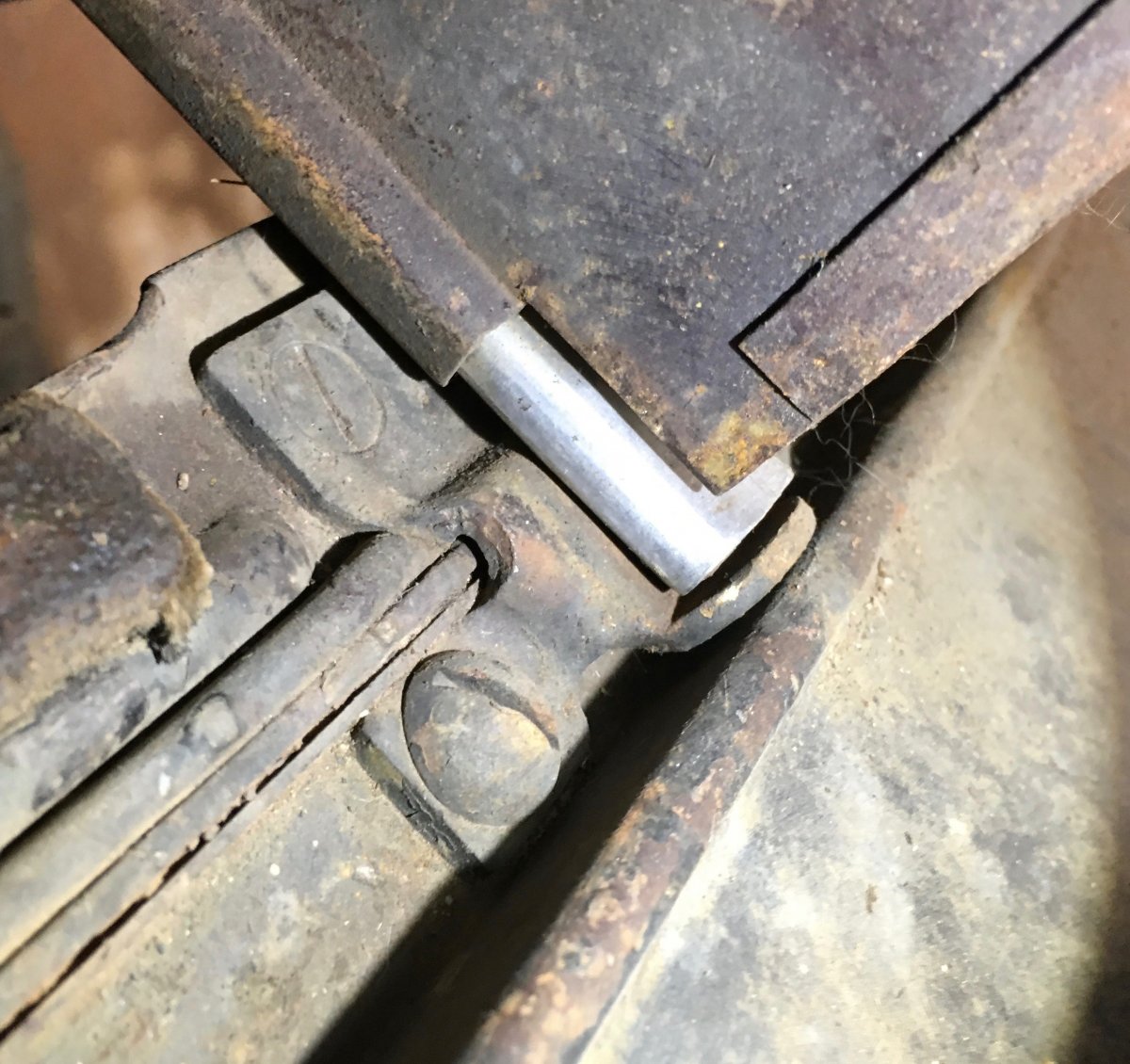

    Besides the body pull down brackets at the bottom of the cowl the rear hood hinge bracket has 4 bolts, 2 front bolts that bolt to the firewall and the 2 rear bolts go thru the firewall lip on the body and thru the firewall.
    Johnny Gee and Fordors like this.

    @krylon32 is correct, the rear bolts are 1/4-20’s and I’m pretty sure the fronts are 12-24 thread.
  9. Photos to illustrate above comments. First the hood bracket from the top and then then from the bottom.
