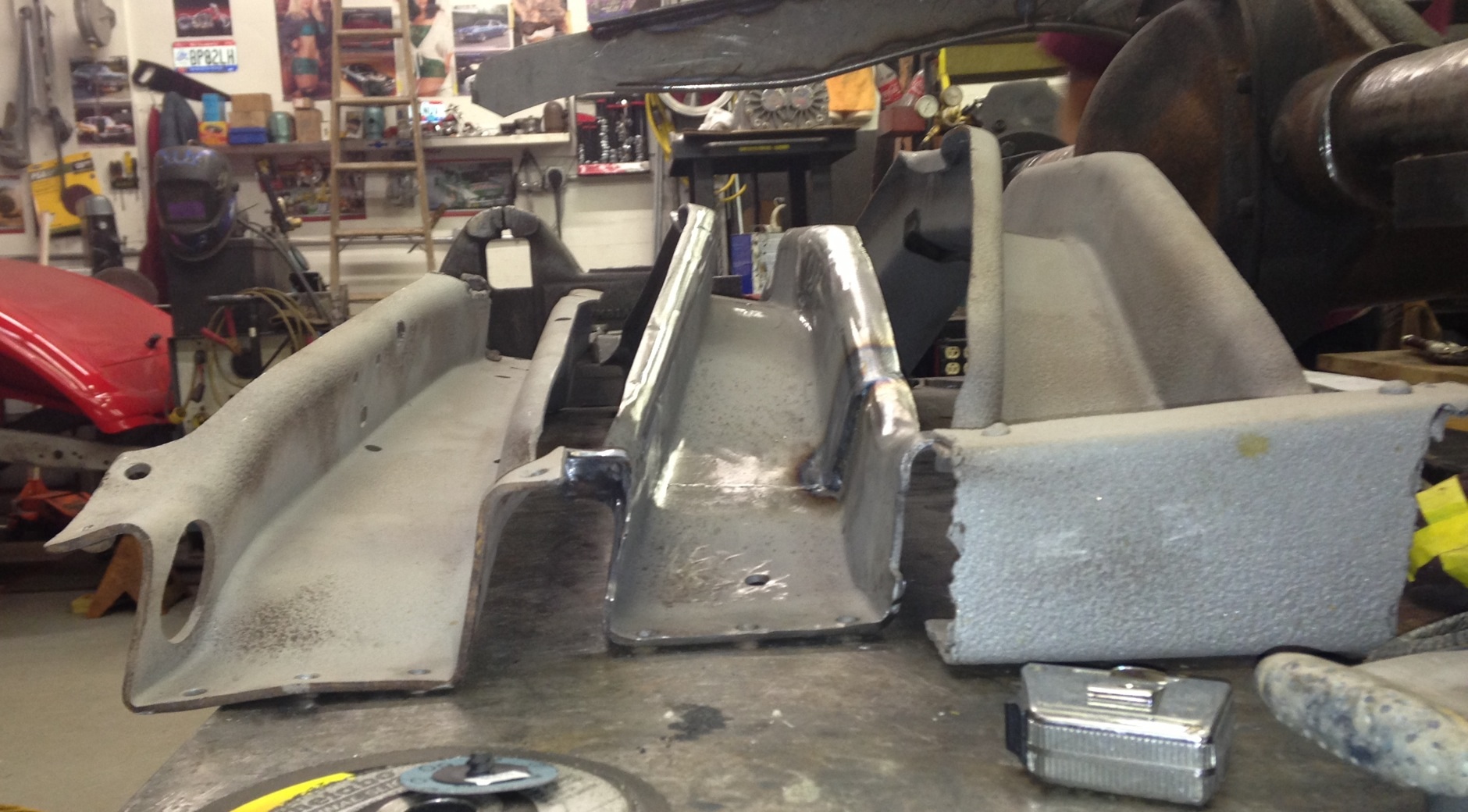

    I was in the garage comparing an original 32 cross member to a rather crusty 40 cross member and I thought I would take some pics in case anyone else is interested in seeing the difference.

    Wow that would really lower your ride height fast .

    Helpful thread for sure. I have a 40 that was sawzalled out flush to the frame rails and it still looks wide enough for a 32 application. Might need a little added but definitely would work on pre boxed rails. If I was to flatten it it would be wide enough as well.
  4. alchemy
    Joined: Sep 27, 2002
    Posts: 22,697
    alchemy
    The stock 40 looks deeper than the 32 by a couple inches. Meaning a higher rearend. I've read of guys using a 33-4 rear crossmember in their 32's to lower an inch or so over stock. I think the 33-4 might need a little trim of the ends to fit in the 32 frame, but is a rather simple conversion otherwise to retain the stock curved spring..

    Yeah the 40 is couple of inches deeper than the 32. The 33/42 is shallower than the 32 and would give you a slight drop without having to flatten the rear cross member.

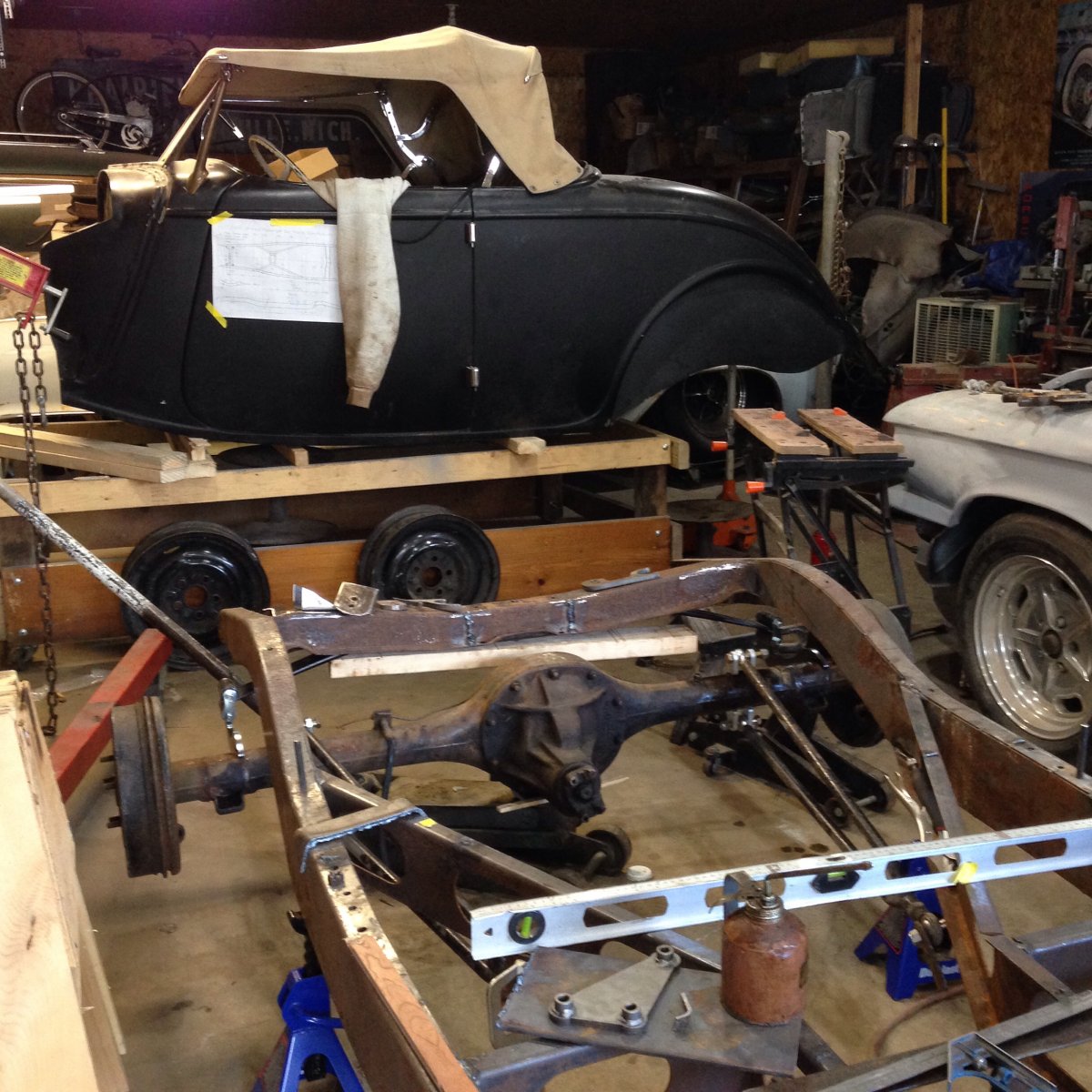

    Here's my '34 ch***is with a flattened (a bit too much) '40 crossmember. It came with a Model A, but since I wasn't going to run a QC, no need to see the pig. Flattening it turned out to be an exercise in futility, as I had to flip the spacer pac on the mono-leaf '40 spring over to raise the rear, despite the C notch in the frame. Ooopsies... IMG_0001.JPG

    I cut it twice and it was still too short!

    The '40 rear cross member allows the use of a straight rear spring, the '32 is not straight but "curved"(33-34 also I believe)
