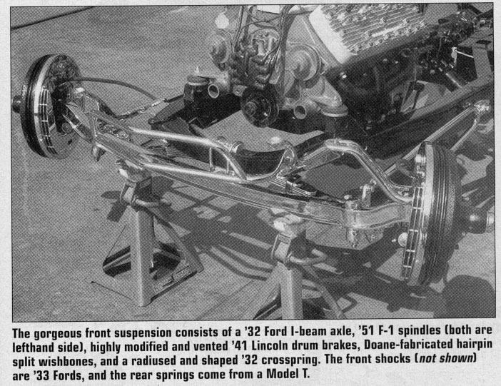

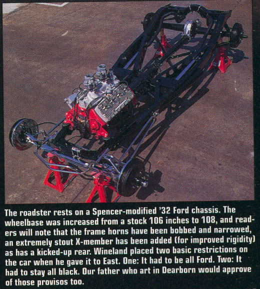

  29. slick a&t
    Joined: Dec 31, 2008
    Posts: 365
    slick a&t
    Here are a couple chassis shots of The Doane Spencer Roadster.Hope this helps.Looked through my pic's for a channelled 32 5 window's and really didn't see any.There could be some in my pic's but from the angle of the pic's,I couldn't tell if spring over or behind.
