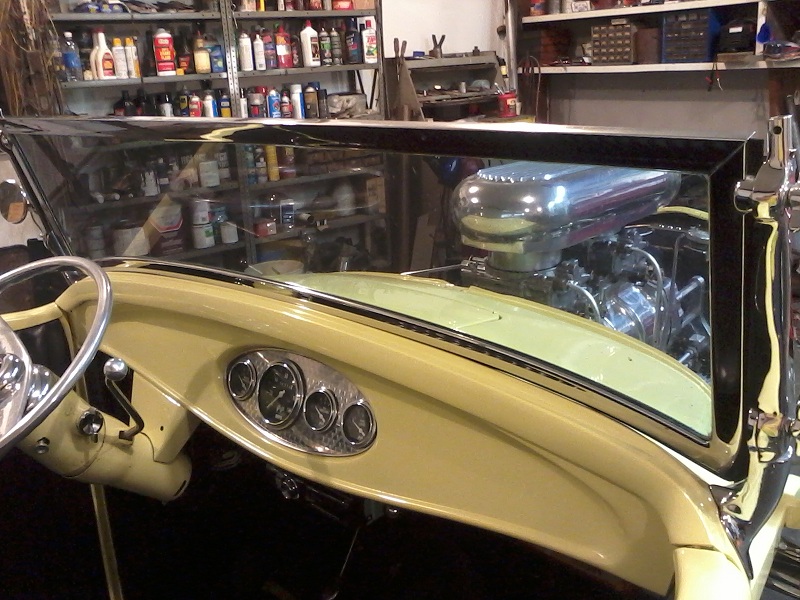

  3. 32 windshield posts bolt directly to 30-31 stanchions.
    The pair shown here are chopped 2".
    Note as well that the 32 stanchion stud, washers etc. are identical to the A's.
    Only thing you have to do is grind the A stanchion so the 32 post can lean back.
    You'll go through the stanchion base metal in the grinding area, but it's easy to weld up.
    As far as the windshield goes you'll have to use the Model A with its round tubing frame.
    The curve of the cowl eyebrow under the bottom of the windshield frame is different between 32 and Model A.
    If you want the rectangular tubing frame 32 windshield style you'll have to make your own.
    An easy project once you get the bottom curve of the windshield frame properly bent.
    If you do use the A windshield frame you may have to move the 3/8-NF mounting stud up or down, but JimA can tell us if that's necessary.
    Probably not.
    Be aware there are four different height Model A windshield frames for the 30-31s.
    Standard, chopped and un-chopped, Deluxe, chopped and un-chopped.
    Check the Speedway or LeBaron-Bonney catalog for details.
    If you order re-pro posts, you can get them with right side drilled and tapped for mirror - a good idea.
    As well as drilled and tapped for windwings.
    Another good idea and if you don't run windwings the holes are not bothersome.
    kidcampbell71 likes this.

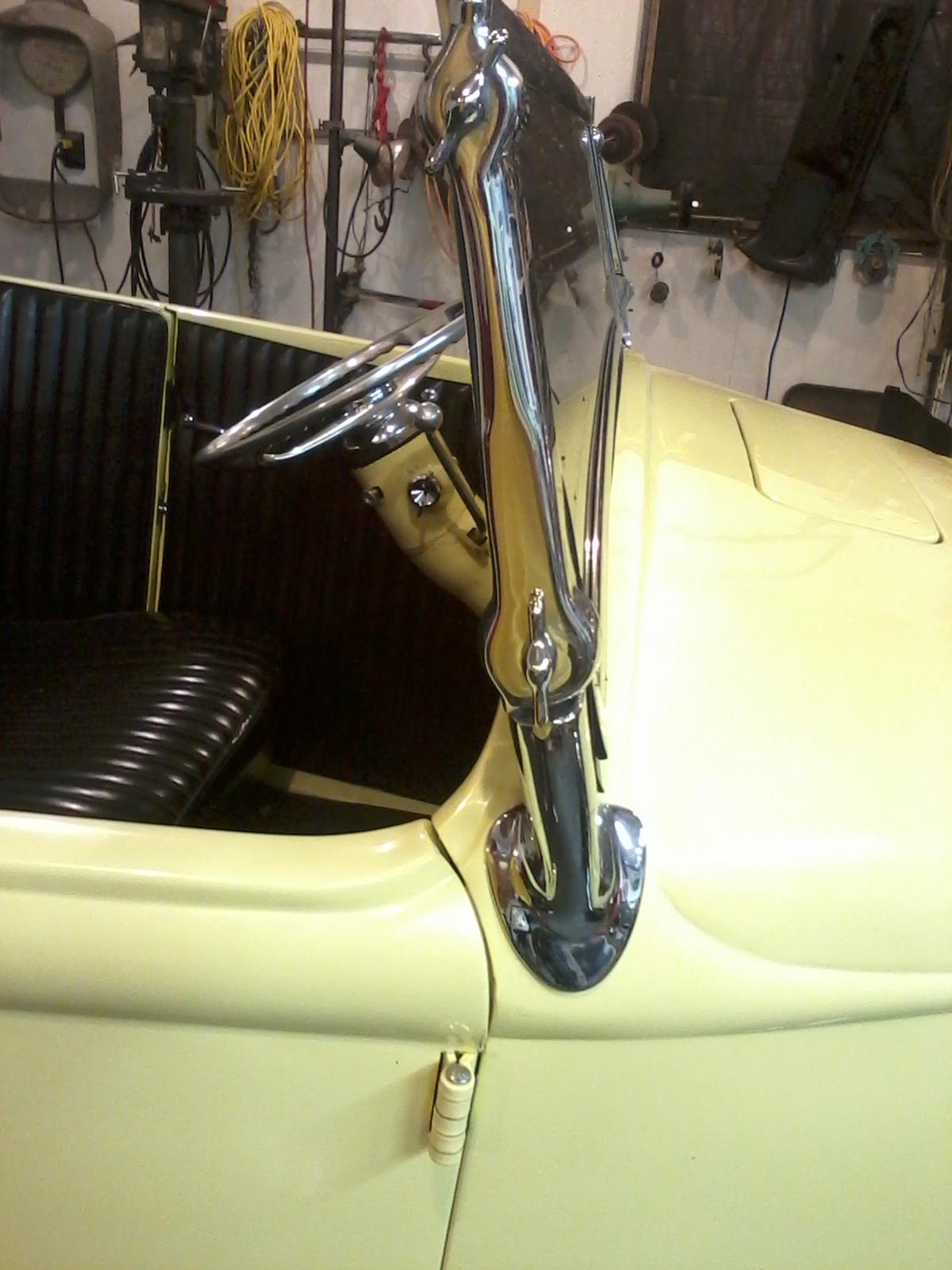

  4. Some pics of the 32s windshield.
    Note the different style stanchions.
    Note too, the different shape of the (chopped 2") windshield.
    Especially at the sides near the bottom.

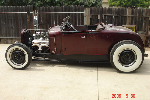

  11. I've seen a few A roadsters here on the HAMB with a fairly leaned back windshield using A stanchions and A posts.
    Looked pretty good.
    Granted, not as extreme as shown above, but you can go too far on the leanback bit.
    It works on the car above since the grille shell is tilted back as well.
    Why don't you start a thread asking for pics of A roadsters with leaned back windshields?
    The "Do-a-Search" police may jump on it, but most times you get a good response.
  12. I've seen a few A roadsters here on the HAMB with a fairly leaned back windshield using A stanchions and A posts.
    Looked pretty good.
    Here's a good looking 29 as an example.

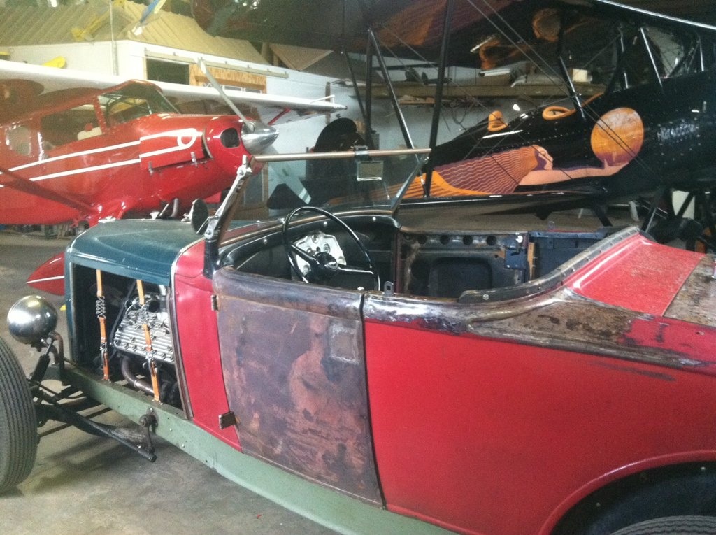

  23. AeroCraftsman
    Joined: Jul 29, 2004
    Posts: 336
    AeroCraftsman
    I used '32 stanchions on mine with a '31 deluxe windshield. The '32 stanchions were significantly less expensive than '31's.
    Using this combination, the windshield sits a little bit lower on the cowl and let's you lean the windshield back without having the outside corners stick out.
    I made a pie cut at the top so the studs are vertical in case I install a top later on.
    Not the greatest picture, but you get the idea.
