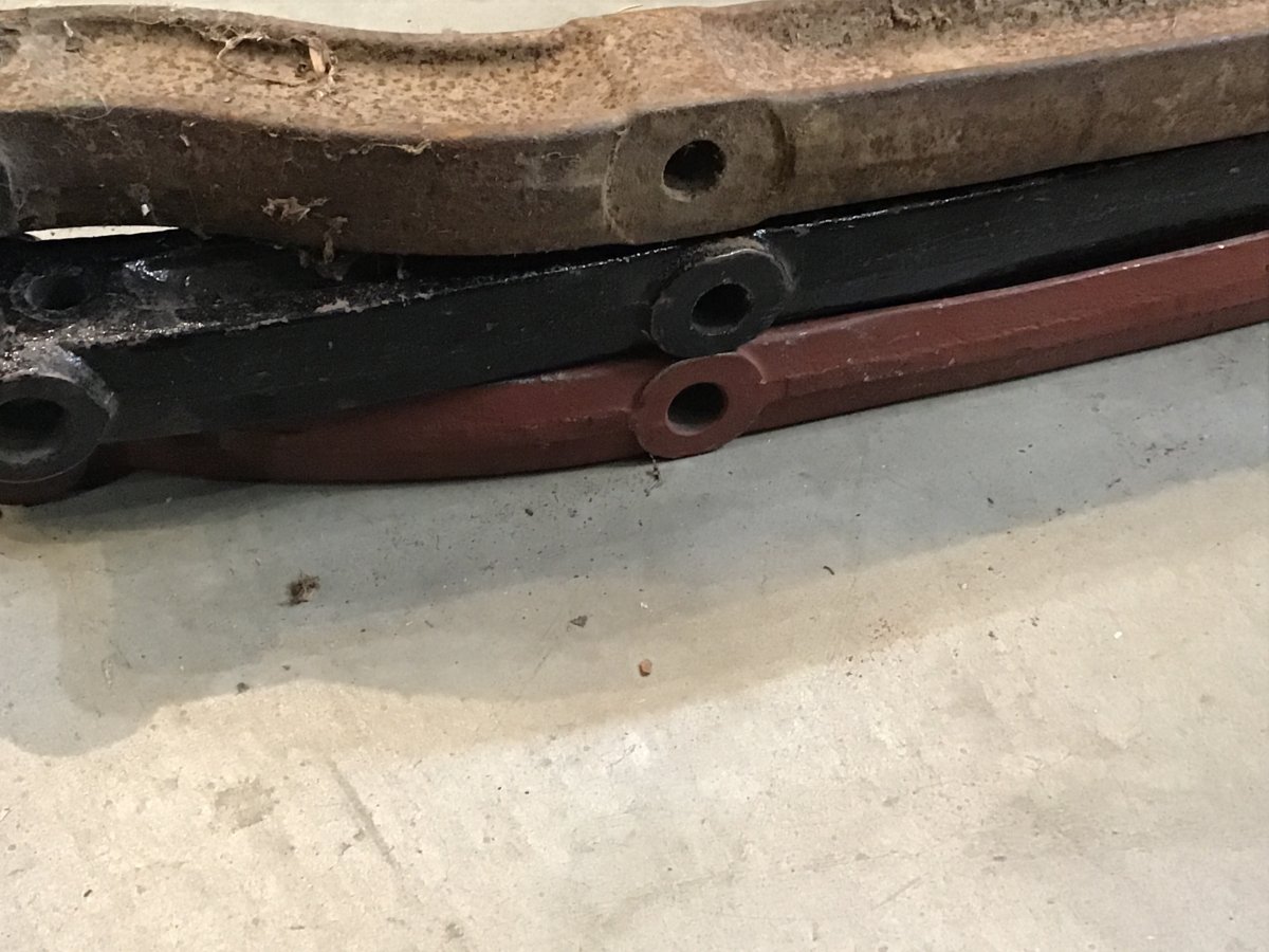

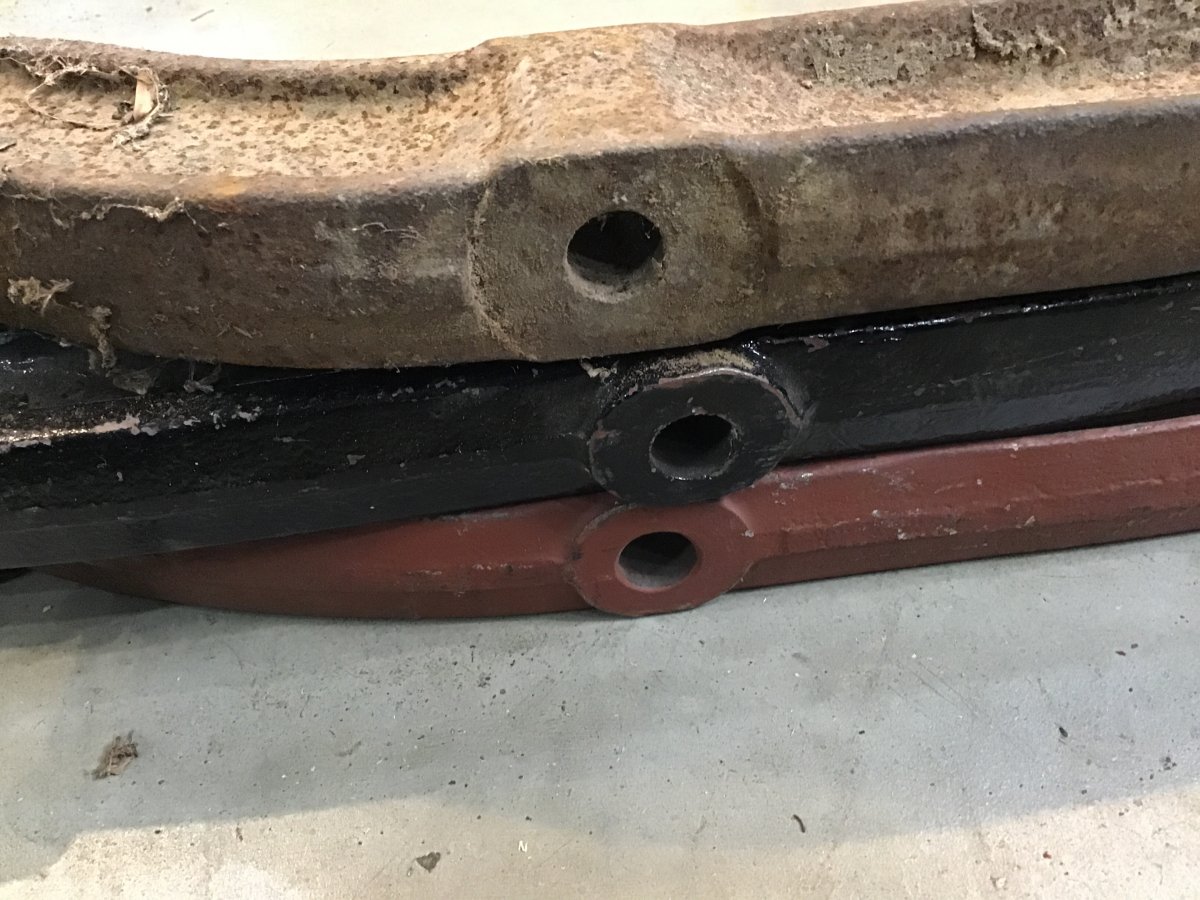

    This is the reason why I say I would look for a different axle. The difference between the model A axle to a 1932 1934 length axle is over a inch in width. This will change the axle angle by pinching the 1932 wish bone a inch to fit your axle. This may cause bumbsteer with the axle angle being changed . It doesn’t sound like a lot but when driving it does and as it wears the death wobble gets worse.
    The top picture shows one end lined up and the other shows the difference over all with smaller differences but are off = red 1933-34 ,black model A and Brownish !932 image.jpg image.jpg

    Lay the axles ON TOP of each other. Measuring the spread on the bottom of one axle to the narrower top of the other is not correct.
