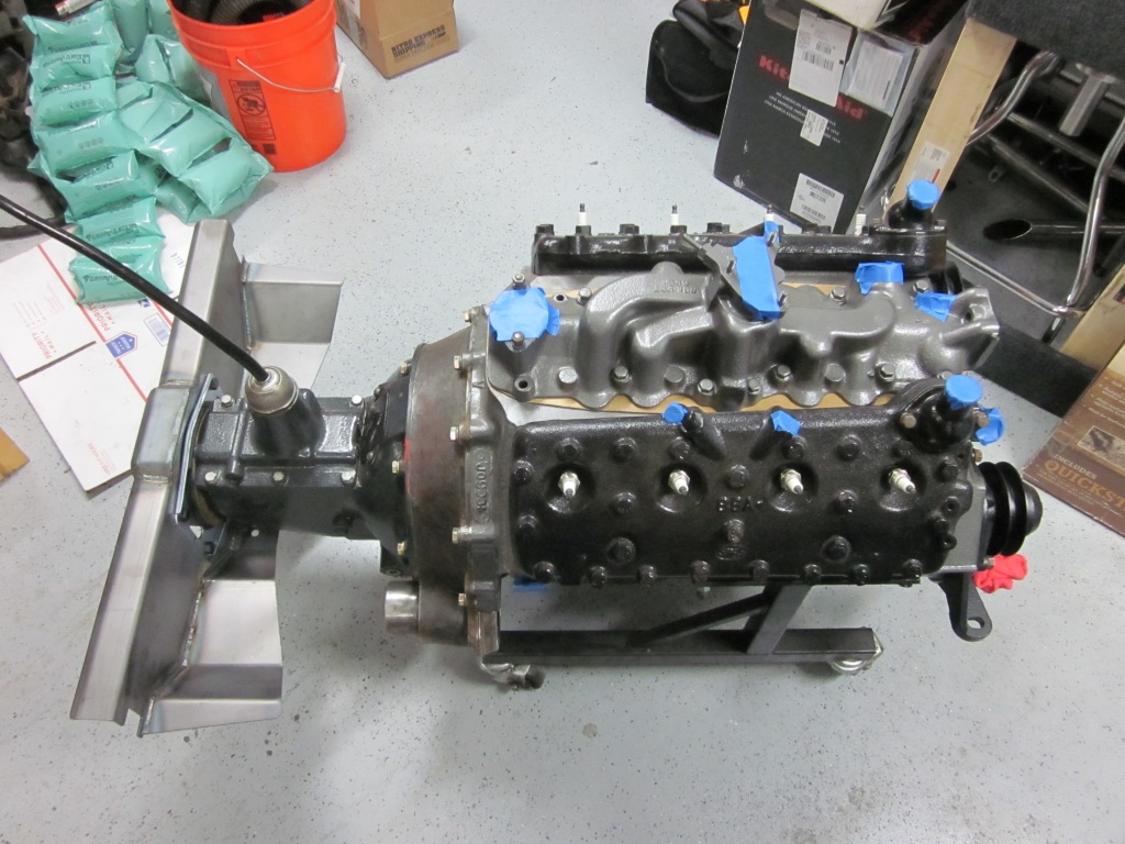

  18. So Cal Brian B
    Joined: Apr 3, 2017
    Posts: 295
    So Cal Brian B
    from Pekin, IL

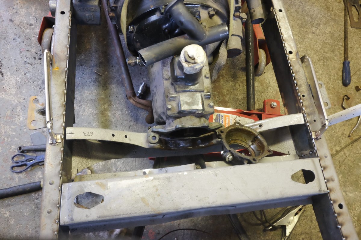

    Here is the setup that I am running as far as the drivetrain is concerned. I'll be swapping out the stock intake and heads for new Navarro ones. Will run dual Strombergs.

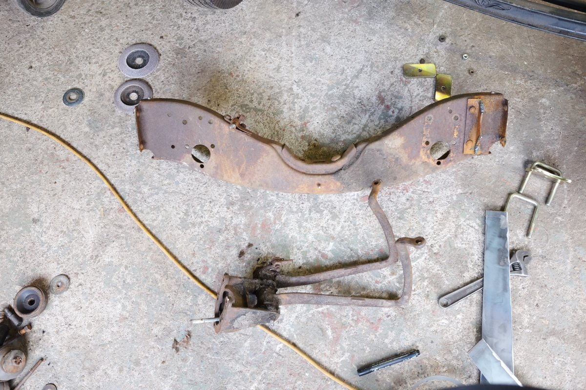

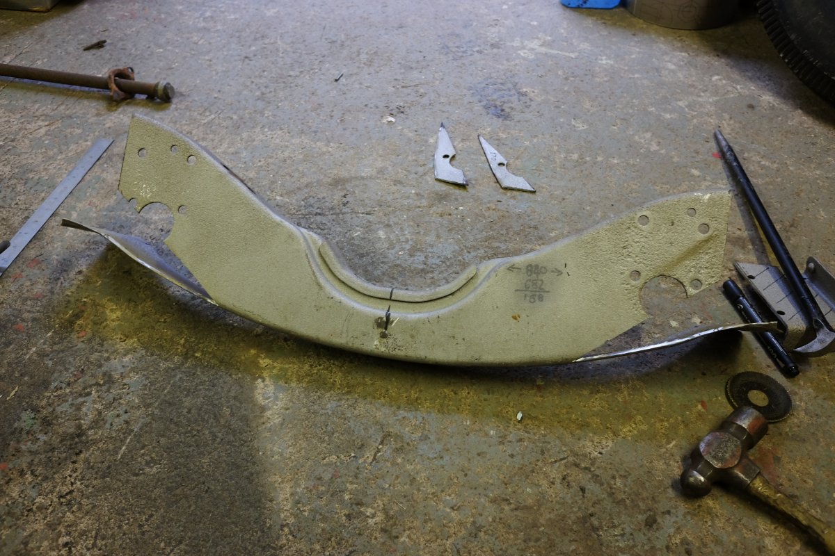

  21. Blues4U
    Joined: Oct 1, 2015
    Posts: 8,221
    Blues4U
    from So Cal
    Anyone know how I can get the pictures to display on the jalopyjournal thread linked here? When the thread first opens the images are visible, then they disappear. I know they're there, but I can't get to them.

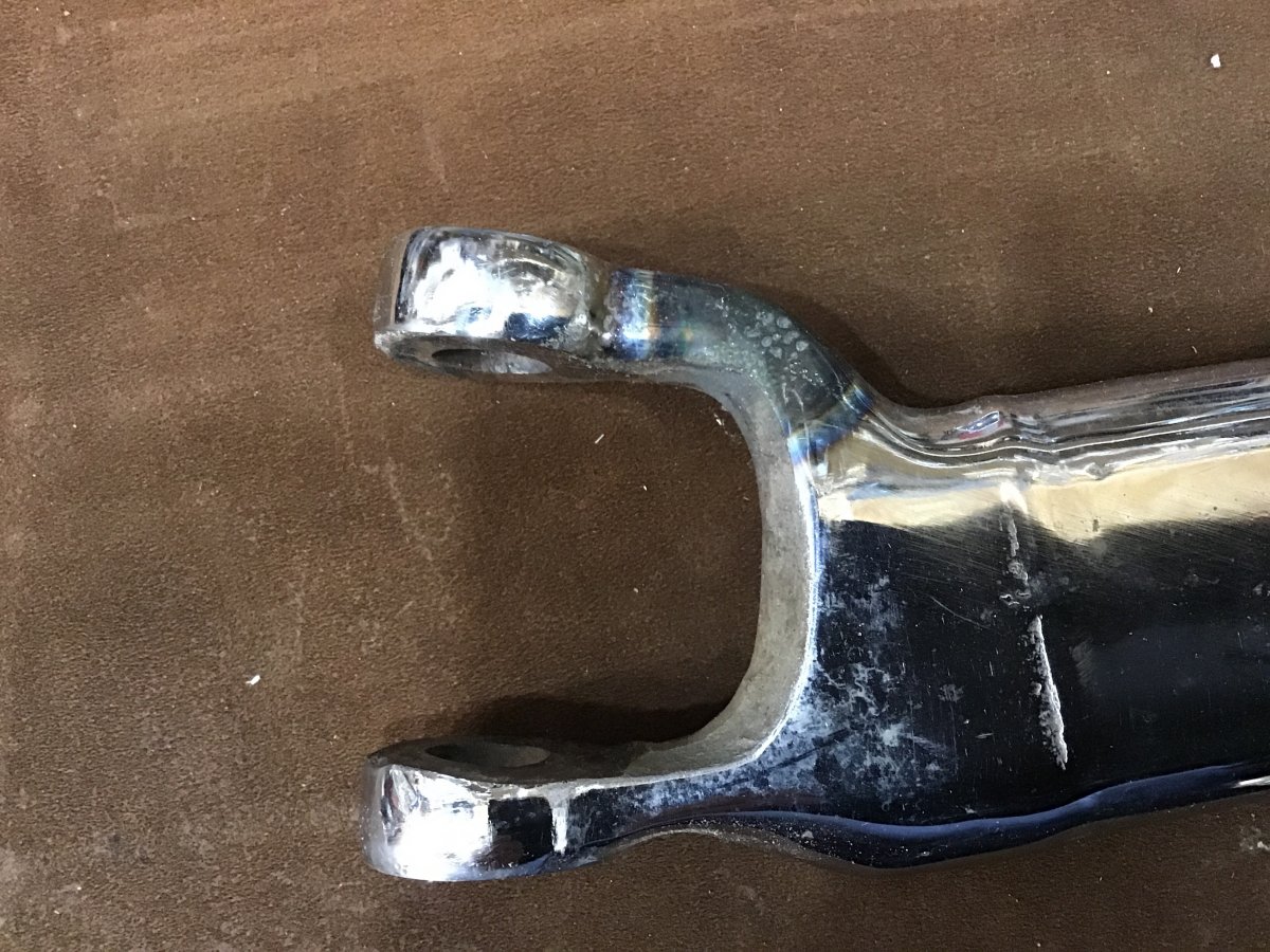

  26. 4ever18
    Joined: Nov 1, 2007
    Posts: 623
    4ever18

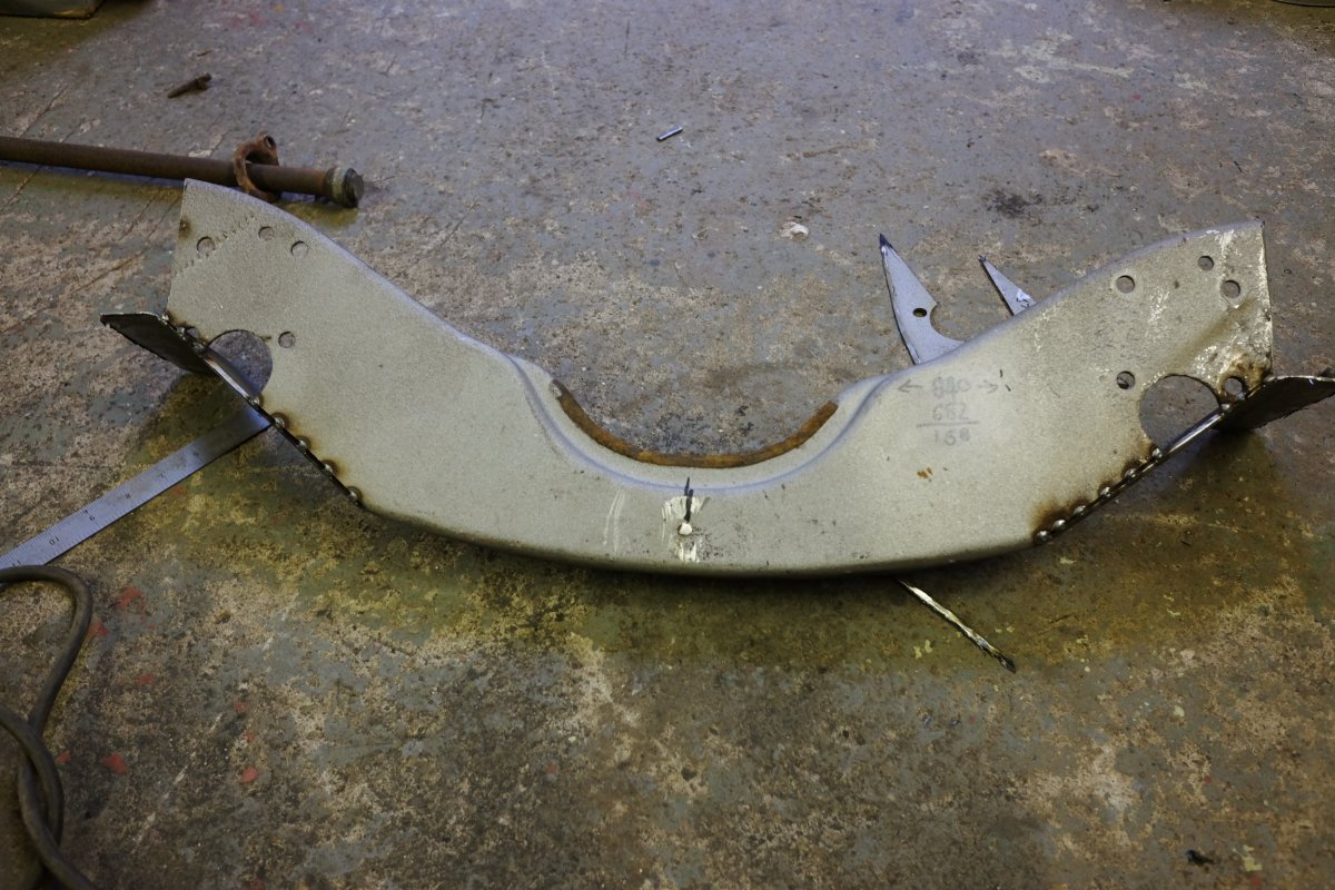

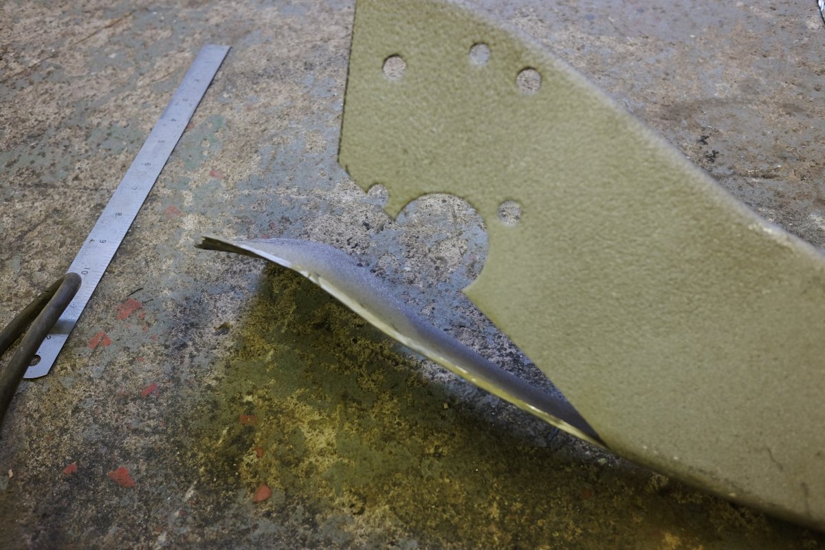

    88CEEBA5-E301-4BDF-B53A-4FFF26347D42.jpeg 5A161ECD-9EF7-4A5E-97B4-D17A45E93920.jpeg 2FFBE035-9BC7-44EF-8D6E-CC81E01C36B3.jpeg 171D855B-1A89-4EC8-AABF-C944FB8B021D.jpeg 7BA17352-265A-4F5A-B3F8-848875835335.png This is a timely & interesting thread for me. Some of you will recall my garage find, mint condition, ‘33 Ford 3 window coupe. I’ve installed new tires & wheels on the coupe and am now ready to address the al***ude of the nose. In my stash of stuff, I have a new, chrome, 5” dropped tube axle. The problem is that the axle is designed for a 2.25” batwing/wishbone boss, while my original wishbone accepts only an axle measuring 2” at the mounting point. I’m considering heating & stretching the wishbone opening to 2.25”. Since we readily heat and reshape spindle steering arms, why wouldn’t heating and stretching this wishbone opening work for me & and the original poster?

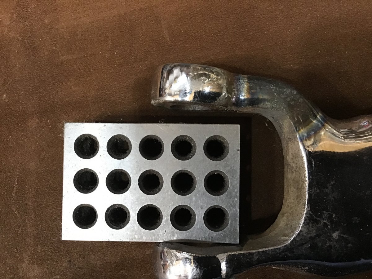

  29. 4ever18
    Joined: Nov 1, 2007
    Posts: 623
    4ever18
    Thank you for the photo. My fixture that I’ve designed will allow me to stretch the opening, while maintaining correct alignment of the upper & lower legs of the wishbone.
    continentaljohn likes this.
  30. alchemy
    Joined: Sep 27, 2002
    Posts: 23,471
    alchemy
    Hey 18, you will also have to pay attention to the distance between the perch holes on the tube axle. It is probably narrower than the stock axle, so the stock wishbone and spring can't be used as is.
