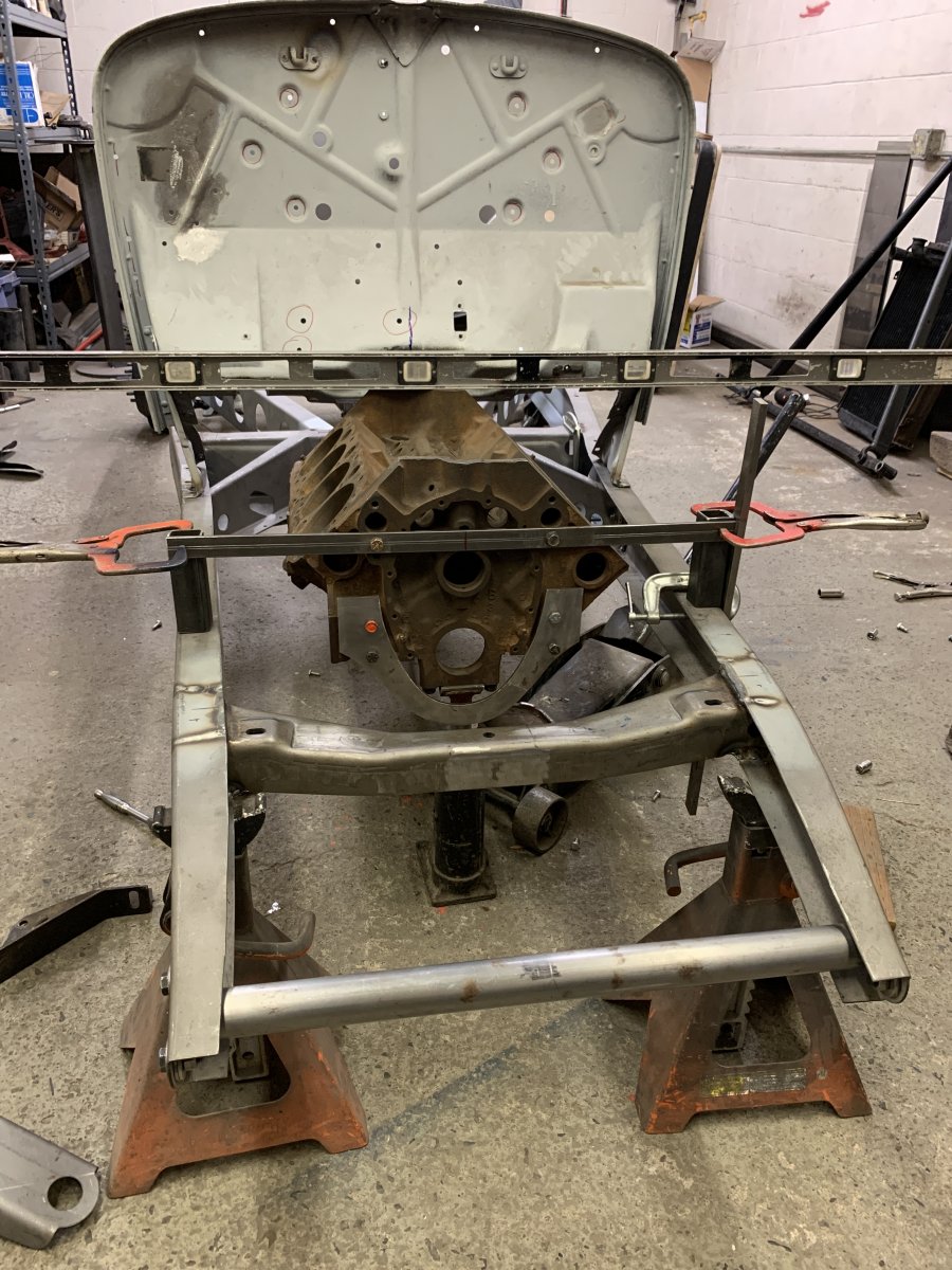

    Can anybody with a small block/39 trans and stock kmember in a 32 tell me the height of their crank center in front ? Measured to the top of the framerails? I’m building motormounts. Trying to make them work with a mechanical fuel pump, and not get in the way of the houdaille shocks. Harumph.

    Yeah I had adapted the forged mounts myself, but i couldn’t get a cradle situation that I liked enough to keep. I also bumped my crossmember forward a little for fan clearance ,and just extended the wishbone ball, and that further complicated the houdaille and motormount situation

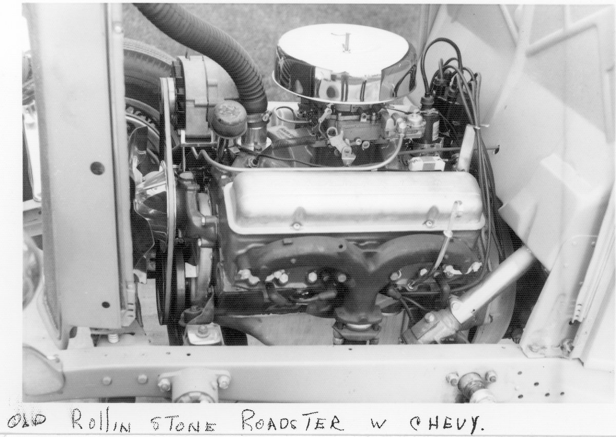

    Not my car. This is a friend's photo taken around 1960. The engine sits low when mated up to the '39 transmission. The fan has to be cut down quite a bit!

    Yep. Looks like they used stock early chev motor mounts. Cool pic!

    Can anyone enlighten me on the mounting of the motor using the stock motor mounts as shown. Is their a Hurst motor mount that attaches to the frame rails. Therefore requiring an electric fuel pump.

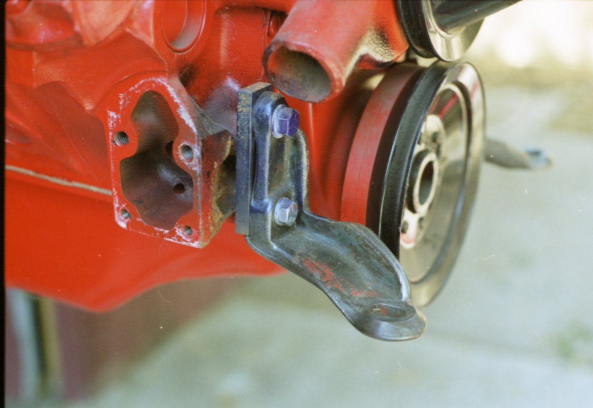

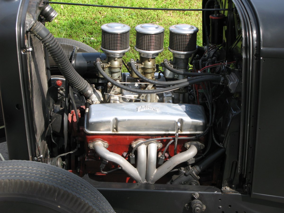

    Here is the 265 mounted in my roadster. It mounts to a '39 trans and a torque tube driveshaft to 1941 Ford rear end. Notice the fan size. I've driven it to LA and back in the summer. Driven a total of about 10,000 miles and it only had a higher than usual heat reading one time. That was when I was in stop and go traffic at about 100 degrees F outside temperature. I used a modified (spring pocket raised 1") IMG_5818.JPG MotorMount.jpg '32 cross member and used the stock '32 Ford motor mounts with an adapter plate to tie them into the engine block. Brian B*** built a bichin' 283 and used a water pump riser and it looked like it fit right in place.

    I did the same as you at first, but since I’m not using a 32 crossmember it would have been too weird. I’m trying to come up with some custom type hurst mount that doesn’t look cheesy. I imagine if you were to use the stock early chev mounts you would need to make a hurst style mount or additional frame crossmember

    I also noticed in the pic the shock mount bolts are backwards. Maybe they tacked the flat bolt heads to the inside rail, as a front mount blocks access to the bolts.....
